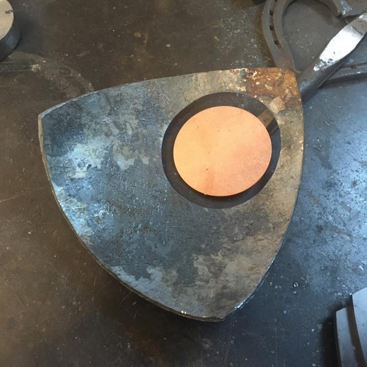

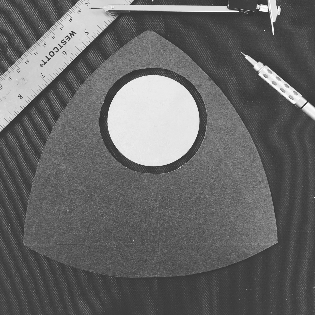

RogueRugger Posted June 14, 2018 Share Posted June 14, 2018 I'm stumped . I have a reuleaux shaped piece of 3/16" plate. The reuleaux is 8" on the side. There is a 3-1/2" circle cut with a bias toward one corner. I am trying to forge a bowl from the plate and then 'suspend' a 3" brass plate inside the circle in the bowl. Currently I am forging the bowl shape using a fly press and 'smushing' the plate between two bowl shaped swages. The result is a nice bowl shape from the reuleaux plate. The plate is heated thoroughly to try to keep the metal flowing evenly during forging. Unfortunately the original circular hole is distorted during the smushing. I'm thinking I might be able to reforge the hole if I had a cone. However, no one within 4 hours of me has a cone I can borrow. Short of making a conic section from some strap, I'm a bit stumped about how to maintain the circular characteristics of the hole. Is there any thoughts on how to selectively heat portions of the plate to recover the circular shape? Image 1 (far left, B/W) is the flat reuleaux plate with the brass disk. Image 2 (middle) is the best I've been able to achieve and the pic looks better than it is. Finally, the image on the right is sort of a before and after picture of a second attempt which ended up even worse. Thanks for any suggestions, Dave Iron Rain Forge www.IronRain.us [For the curious, these are awards for a juried sculpture show in our artsy little town. The brass plate will be etched with info related to the show, date, place, etc. and will be suspended in the hole using small copper loops.] Quote Link to comment Share on other sites More sharing options...

anvil Posted June 15, 2018 Share Posted June 15, 2018 If you want to cut the hole first then backwards engineer your finished sample. This will tell you how much "bad" draw you got (Out of round). Subtract the "bad" surface area from your original round hole. Meaning, and as a quick guess, you need to start with a horizontal oval, not a circle. Actually, if you have a lot to do, this will save you much heartache and cleanup. Quote Link to comment Share on other sites More sharing options...

RogueRugger Posted June 21, 2018 Author Share Posted June 21, 2018 Thanks to all for the suggestions. While the hole saw seemed to be the consensus as the easiest approach, it got a bit complicated when considering the safety aspects of drilling through the bowl. I almost tacked a couple of cross pieces, somewhat like the suggestion by +IronWolf. I should have kept the slugs for no other reason than I could have used them for something else; hindsight is always 20/20. I think the cross pieces would have worked pretty well. I ended up simply accounting for the differences in the expansion of the different sections and finished all three pretty quickly. Some selective cooling and heating. Not prefect, but pretty close. (someone suggested this was not possible and I don't understand that word as well as I probably should.) There still some clean up to do on the ironwork, the etching, and of course, the attachment. Thanks again for the great suggestions. Dave Iron Rain Forge www.IronRain.us [Edit: the large distortion of some of the holes in the picture is due to perspective.] Quote Link to comment Share on other sites More sharing options...

RogueRugger Posted July 18, 2018 Author Share Posted July 18, 2018 Thought there might be some interest in the final result. Ran into a time crunch due to a series of health scares, so i had to compromise on the design a little bit. Still reasonably happy with the results. FWIW - These are the awards for the Creede Sculpture Show this weekend. Quote Link to comment Share on other sites More sharing options...
