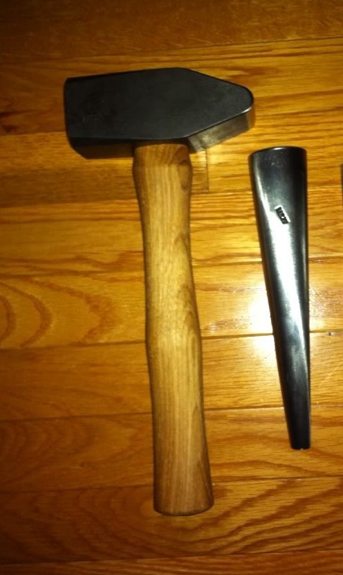

Jon Kerr Posted May 29, 2018 Share Posted May 29, 2018 Hi all, I've had a look at both these posts and they're very informative: Does anyone have any further recommendations in terms of modifying a hammer into something more useful/suitable for forging? Please excuse my ignorance, I'm very new to all this, but it appears as though a really good "workshorse" hammer is a Hofi-style or German style shape.... cross pein, with a square face, dressed as per the description in the above thread. Is it reasonable to assume that one could grind a hand-sledge into a similar shape to a Hofi/german hammer for a similar effect? I guess you'd have to watch out for the balance, and ensure the face was dressed properly? I bought a couple of old hand sledge's this weekend (at a car-boot sale, for 50p each). I'm hoping I can grind them into a cross pein, balance by removing material from the front, then dress the face. See the attached image (stolen from another thread on here) as an example of the basic shape I'd hope to achieve (then dressed according to the above post, 24" radius etc) What needs to be done in terms of hardening etc? Would this result in a good hammer? Any tips, warnings, pitfalls? Cheers, JK Quote Link to comment Share on other sites More sharing options...
Charles R. Stevens Posted May 29, 2018 Share Posted May 29, 2018 I have a set of 3 3# double jack hammers I modified, one with a full radius cross pein, one with a full radius strait pein and one with a full radius ball pein, used with the horn as a bottom fuller they are my go to drawing hammers. I also have a pair with mor conventional 1” radius pein made from 3# double jack hammers as well. As a farrier I grab my rounding hammer it my cats eye cross pein most often. Quote Link to comment Share on other sites More sharing options...
JHCC Posted May 29, 2018 Share Posted May 29, 2018 I modified a 3lb. double jack into a very nice rounding hammer that was my go-to before I started making my own. Whatever you do to modify yours, make sure you grind slowly, so as not to build up heat and ruin the temper. Quote Link to comment Share on other sites More sharing options...

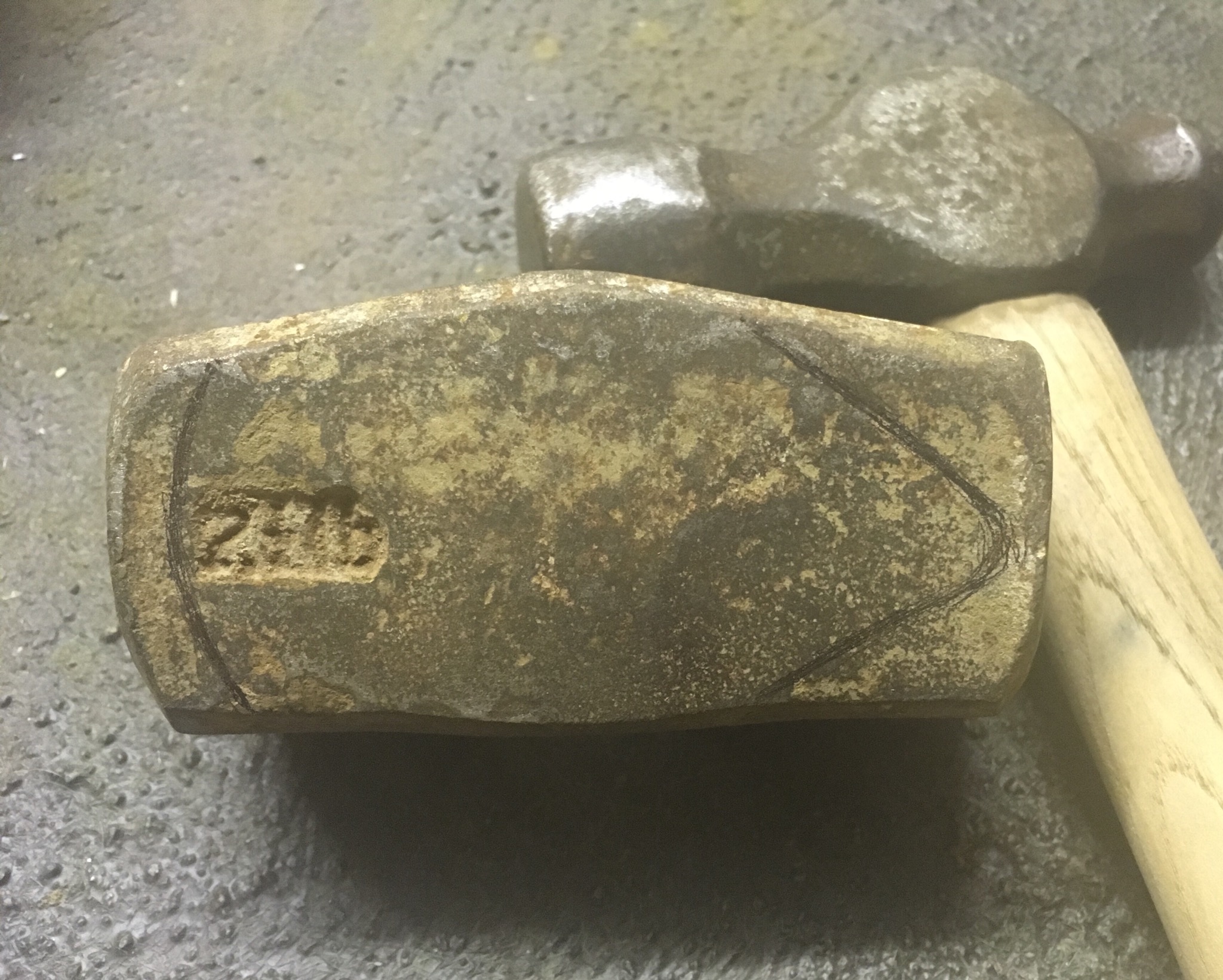

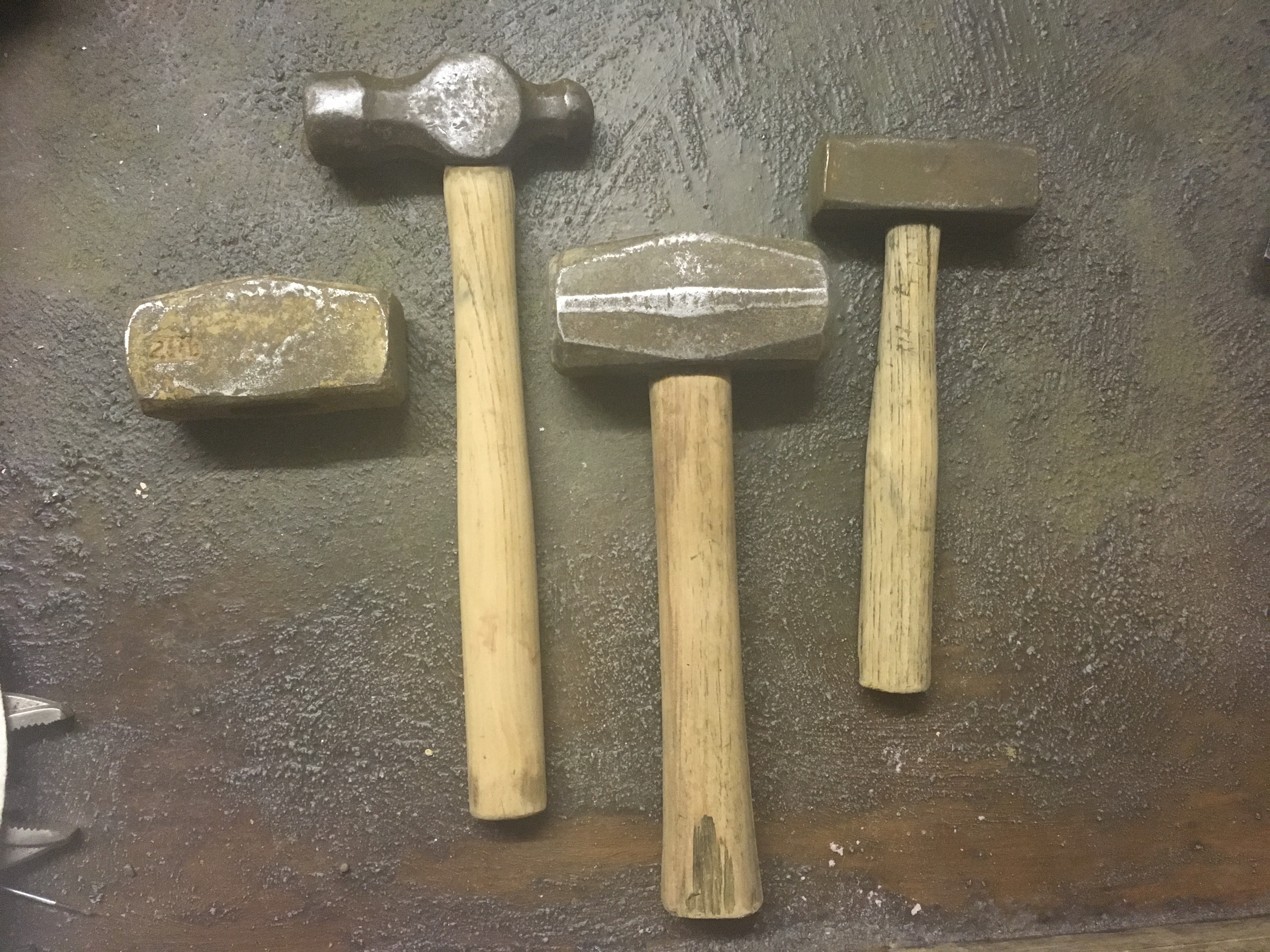

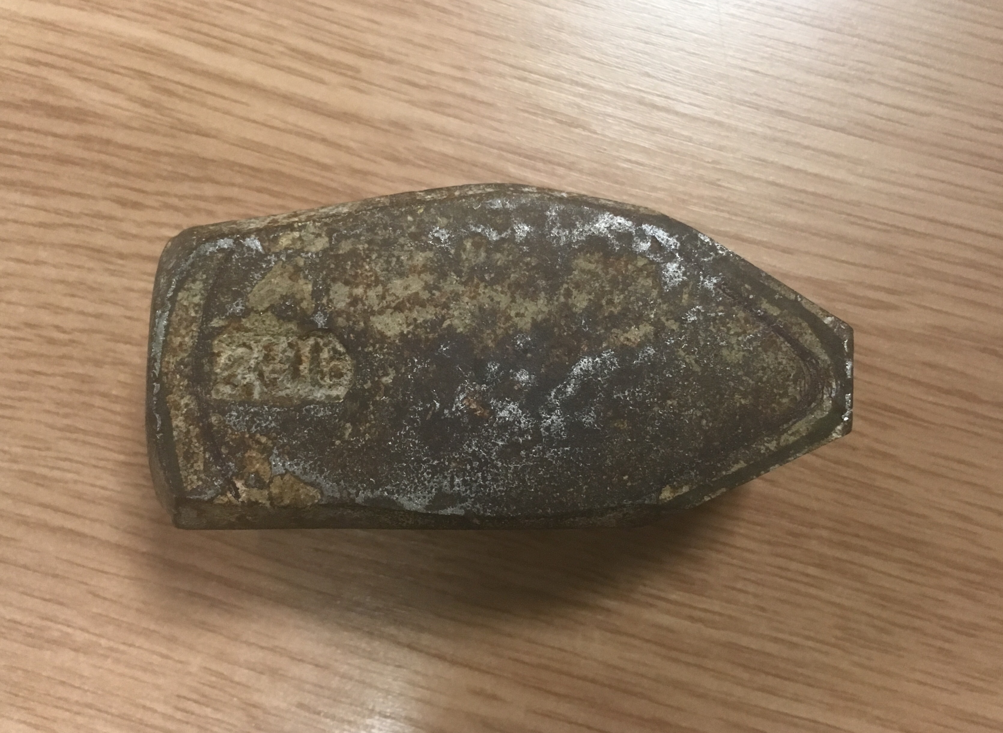

Jon Kerr Posted May 29, 2018 Author Share Posted May 29, 2018 Here’s the hammers I got cheap. Any recommendations for modifications? I’m thinking of grinding the handle-less sledge as shown in the image. Its only 2lb to begin with so I’d only be left with about 1.5lbs. Not sure its worth it? I might just dress both sides of the sledge with the handle, but I’d really like a hofi-ish style cross peen for drawing out. Suggestions welcome. Quote Link to comment Share on other sites More sharing options...
TwistedCustoms Posted May 29, 2018 Share Posted May 29, 2018 That little drilling hammer you did the lay out lines on, does that stamp say 2, or 2 1/2? looks like two and a half to me but it may be my old eyes. You can radius one face without removing nearly as much material as indicated by your lay out lines. As for the cross peen, it would be a lot less work to look for a cross peen hammer and re shape from there. You could cut away that much material with a chop saw and then grind and polish but with that much cutting I would count on having to re harden and temper. Quote Link to comment Share on other sites More sharing options...
Jon Kerr Posted May 29, 2018 Author Share Posted May 29, 2018 Its very hard to read but I think you’re right, 2.5lbs. I’m keen to try the cross pein- I can probably get it band-sawed at work to start with and grind from there. How critical is balance? any tips for re-hardening and tempering? I’ll have to read up. Quote Link to comment Share on other sites More sharing options...
ThomasPowers Posted May 29, 2018 Share Posted May 29, 2018 Anneal before sawing! Save the offcuts to experiment with hardening and tempering on. Start with a non-magnetic oil quench and move on from there. Read up on Turley's ring tempering tool. Quote Link to comment Share on other sites More sharing options...
TwistedCustoms Posted May 29, 2018 Share Posted May 29, 2018 Balance may be more an individual preference than absolute necessity. I buy Swedish pattern cross peens which have a long slender and thin cross peen. I nub them down until the hammer head is so off center it almost looks like a dogs head hammer with a slight protrusion for the cross peen. I purchased the hammer based on "I really like the way that looks". After using it I realized the cross peen was way too narrow for my purpose so I cut/ground until I had the radius I was looking for on the peen end. I wondered if the hammer was a total loss because I had so drastically altered it from what it was. After forging with it for a while I discovered it is a delight to use. The weight distribution is "different" when using the peen but it has become my favorite two pounder. Since the happy accident of discovering I like the shape I have purchased and modified several more. That's not to say you will absolutely love it if it's balanced off center but you wont know till you try. That's what cheap hammer heads are for. My most expensive hammers are in the $300.00 USD price range and I do love them dearly. I knew what they were before I purchased them and I never regret bringing a tool home! Some of my favorites are chop jobs/re profiles I've done with junk sale finds at a couple of dollars each. The old rusty hammer heads are a lot more bang for your buck because you wont be afraid to experiment with them and it's a thrill when you come up with one that just feels right and moves metal the way you want it to! Quote Link to comment Share on other sites More sharing options...
JHCC Posted May 30, 2018 Share Posted May 30, 2018 Keep the drilling hammer (the sledge with a handle) for hitting chisels and punches. That way, you don’t have to worry about messing up the face of a good smithing hammer. Quote Link to comment Share on other sites More sharing options...

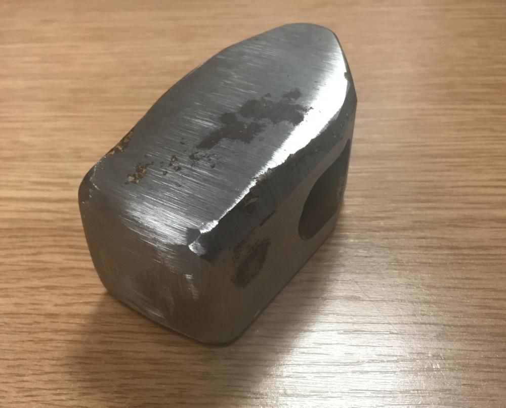

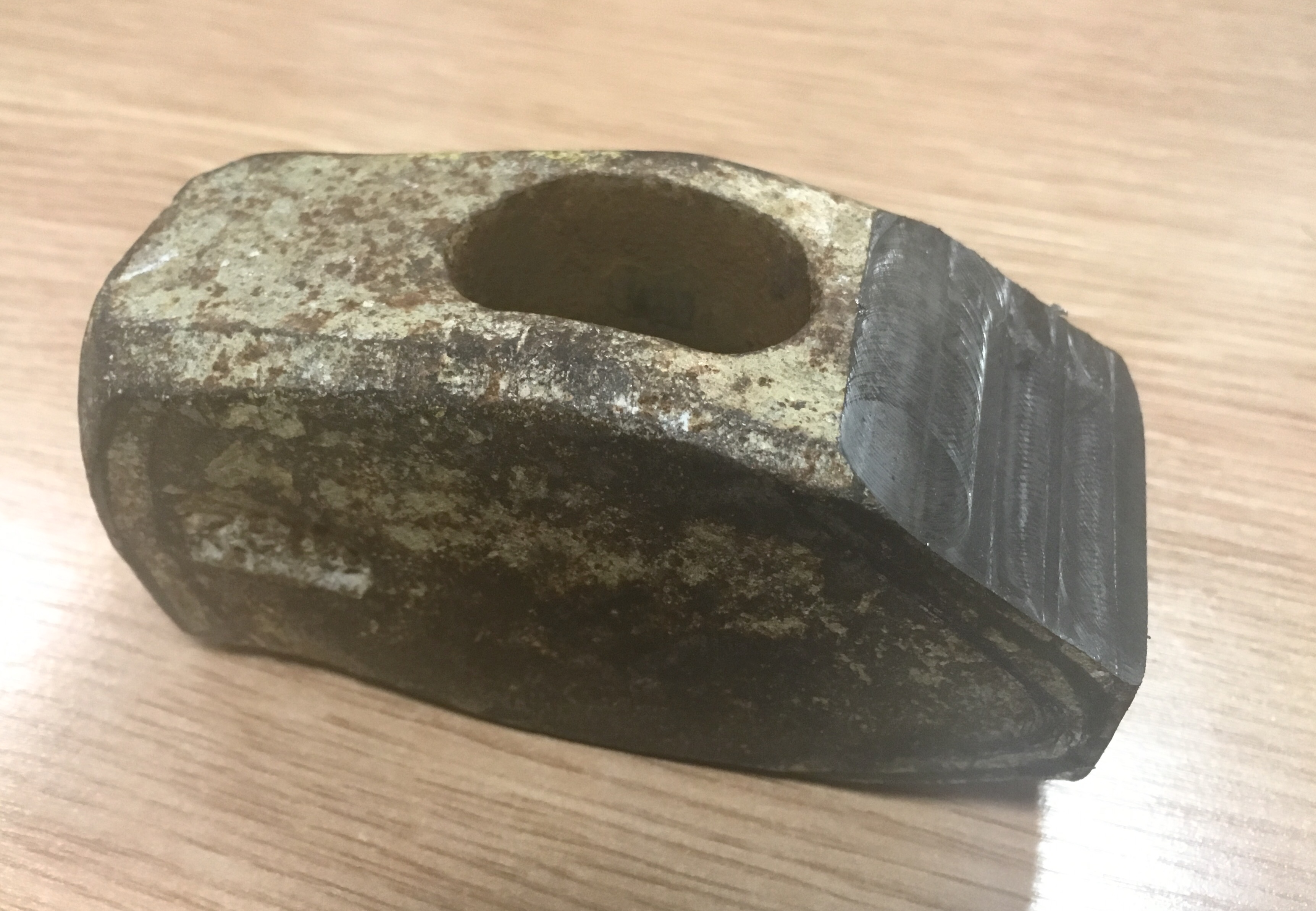

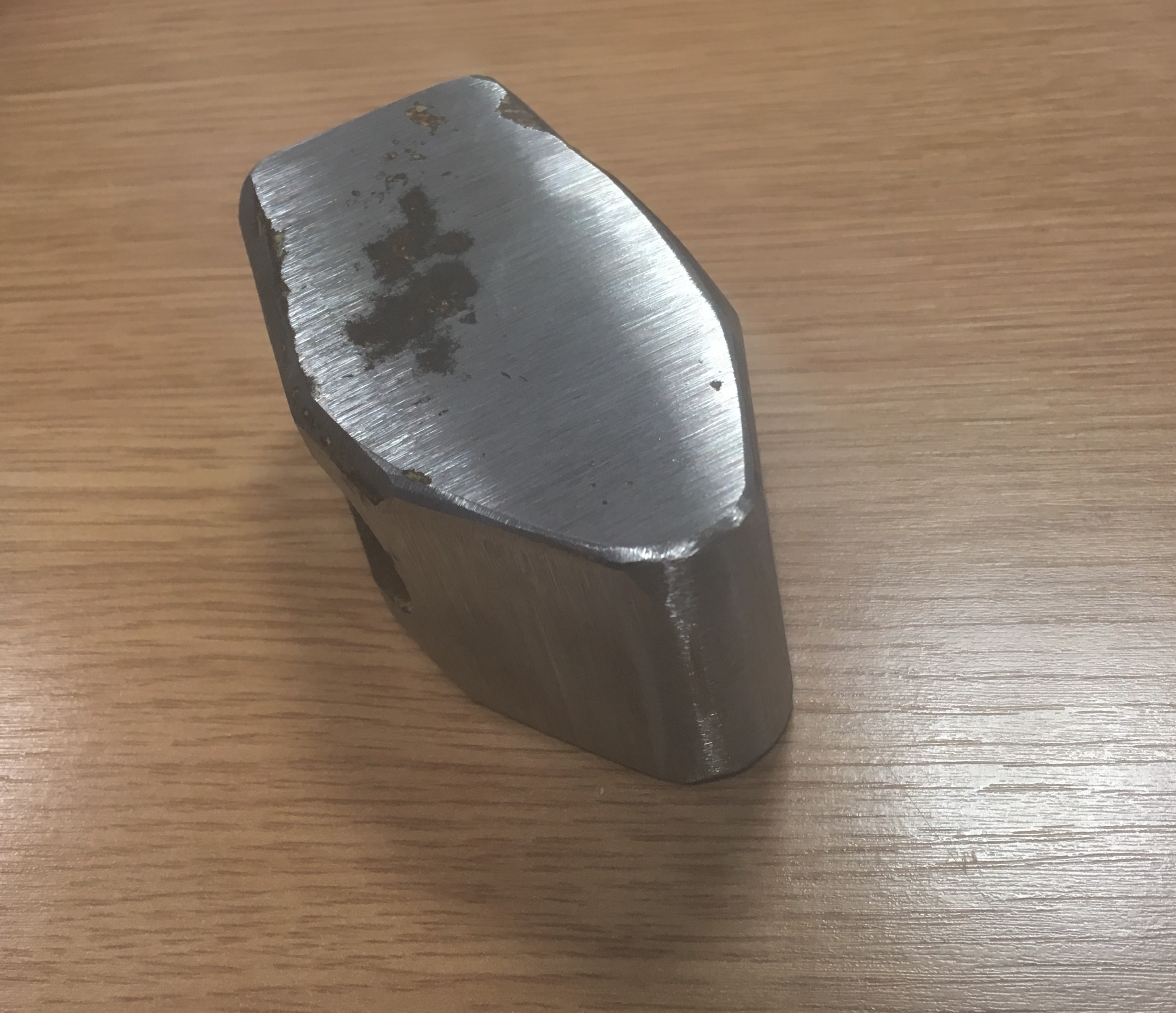

Jon Kerr Posted May 30, 2018 Author Share Posted May 30, 2018 Here we go... step 1- milled the corners off. Was easier than cutting. Quote Link to comment Share on other sites More sharing options...
JHCC Posted May 30, 2018 Share Posted May 30, 2018 Quote Link to comment Share on other sites More sharing options...

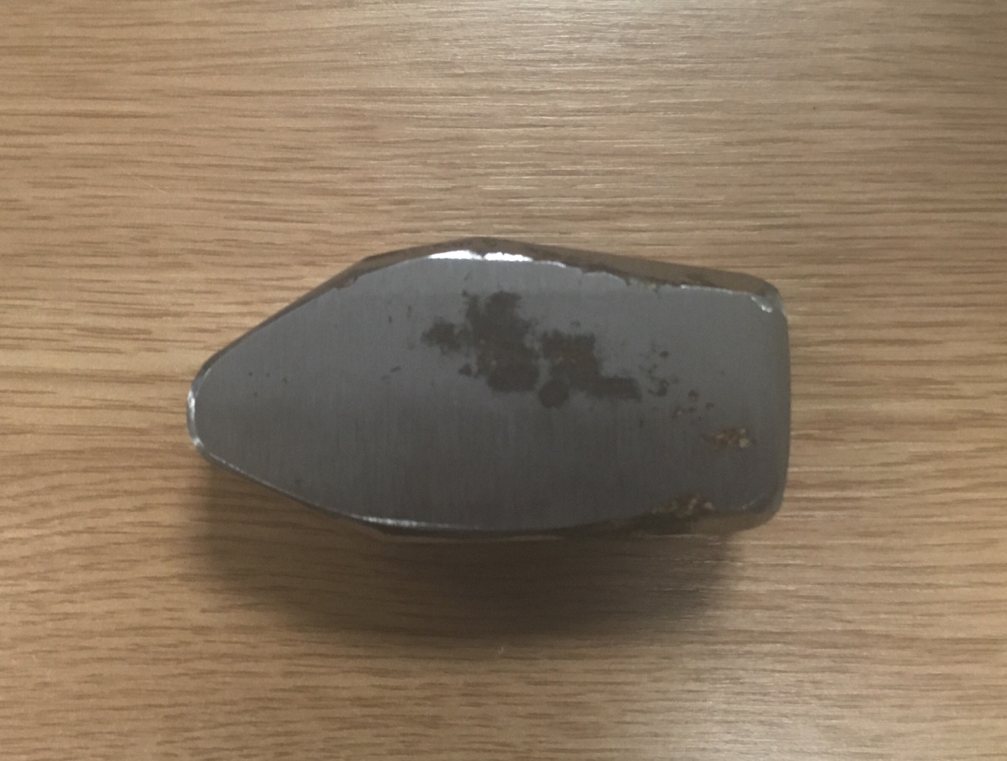

Jon Kerr Posted May 30, 2018 Author Share Posted May 30, 2018 Haha. I’ve just finished belt-sanding the hammer head. Matched the 24” radius and 1/2” corners as best I could. How do I tell if I’ve ruined the temper? Most likely i have! Quote Link to comment Share on other sites More sharing options...
JHCC Posted May 30, 2018 Share Posted May 30, 2018 14 minutes ago, Jon Kerr said: How do I tell if I’ve ruined the temper? When steel is heated to tempering colors (between 390°F/199°C and 575°F/302°C), the surface oxidizes and produces colors on a spectrum from straw to brown to purple to blue. At any point in the grinding, did the steel change color and run through that spectrum? If so, you affected the temper; if not, you probably didn't. The shapes of your face and peen look good. Sanding the sides was unnecessary, but if you prefer that look to the previous patina and wear, that's certainly a valid choice. Quote Link to comment Share on other sites More sharing options...
Jon Kerr Posted May 30, 2018 Author Share Posted May 30, 2018 No it didn’t change colour, even during the milling. I did have the coolant running. Perhaps I got away with it? Yeh I wanted to polish the sides up a bit as it was pretty manky before. Those rust pits went fairly deep, as you can see since there are many pits remaining. It will weather off again in time Thanks for all the tips etc- glad the face and peen look right! Quote Link to comment Share on other sites More sharing options...
