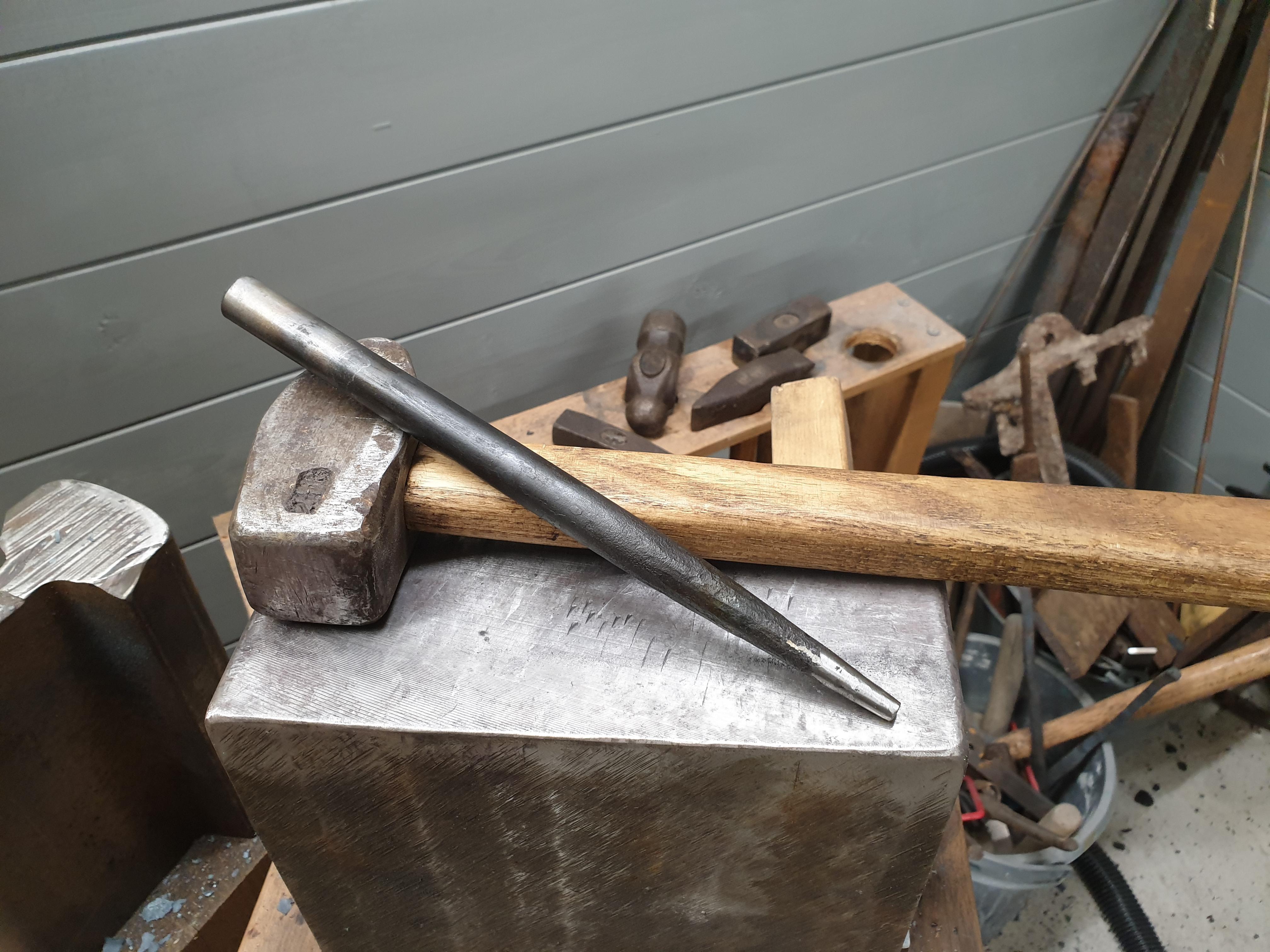

First up I forged a new pair of punches; one round and one square. My original round punch was rebar, and the second (pictured earlier in this thread) had cracks from quenching in water, so both needed replacing.
I tried to focus on clean forging, not burning the steel (while ensuring the heat was soaked through to the middle), and making sure my square was.... square. It seemed to go well.
The heat treatment (as per the advice from everyone earlier in this thread) went well. I know you guys love the details so.... : I quenched the tip (1"-2" depending on up/down motion) in oil (rapeseed aka/ canola) and then used the residual heat in the shank to temper the tip. This tip quench> polish> run colours method was repeated until the colours stopped running, then it was allowed to cool fully in air.

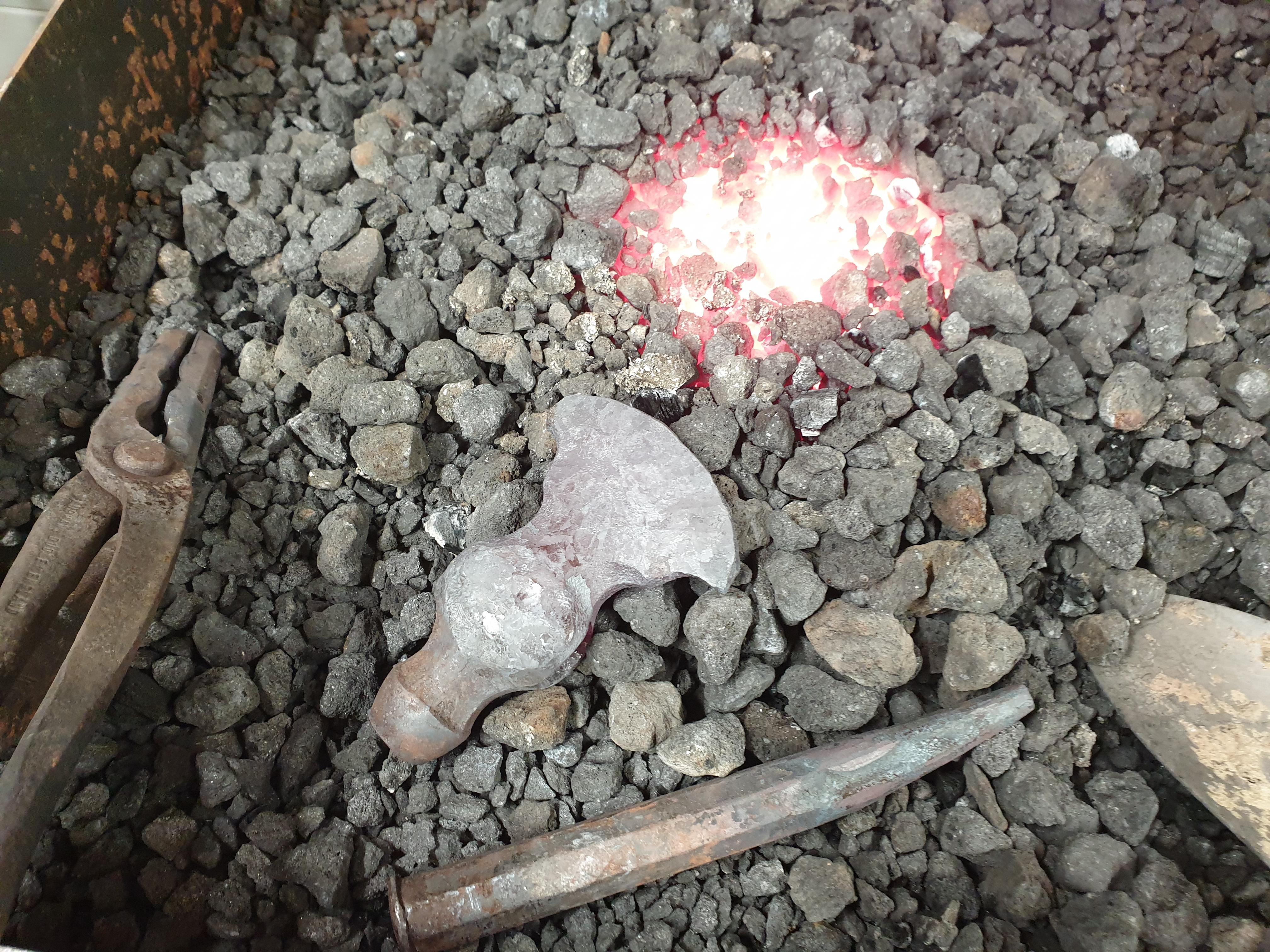

Finally I started forging a horn/bicker for my portable hardy anvil, so we'll see how that goes. Won't show pictures till its done. I've also been working on another hammer to axe conversion for fun.

Thomas- No, I didnt preheat the oil. Is that necessary or is it dependant on the grade of steel?
This was EN19.
Pnut- Wow, I really feel for you grinding with a dremel! Its bad enough with an angle grinder. I havent tried a grinding disc- perhaps thats what I should do. Interesting that part of your family is called Kerr. It's not a common name outside Scotland. I've met very few people in my life with the same name, given that I've lived in England all my life.
The answer is, of course, "that depends".  As EN19 is rather like 4140, and the tool is for punching; you may want the lower hardness.  Others may prefer a greater hardness for edge tools.  If it yields what YOU like it's perfect.  If it doesn't then preheating the oil to around 140 degF can get it a bit harder.
The differential temper can help support a harder end in use than a constant temper.
I work with a number of beginners and decarbing the workpiece is a VERY COMMON thing with them; so we are often fighting to get a decent hardness with their tools and so the preheat helps.
For oil I generally heat using a chunk of steel attached to a steel wire with a hook on the end.   Heat the chunk in the forge and drop it to the bottom of the can with the hook over the top edge for retrieval.  When the oil becomes hot, (I check the side of the can and when barely touchable; but not solid contact);  remove the chunk.   Having a place where it can drip helps too.

I heat my chunk to glowing and do a fast plunge to avoid flare up.  2.5 liters is a very very small amount of oil. My regular quench tank holds a gallon or two and was made by cutting off the top of a fairly small welding gas tank, argon, O2, etc; NOT ACETYLENE!
I don't like thin cans as they tend to leak when a hot pointy items gets accidentally dropped in them---a common occurrence with new students not comfortable with the flame up. I also have a frame to hold the tank to make it much harder to tip over. I know a smith that managed to burn down his shop and was injured by flaming oil in a quench accident.
This is a experiment and see what works for you type of deal.
And the reason warm oil cools faster is that warm oil is less viscous than cold oil and so convection currents bringing in cooler oil to cool the metal run faster and stronger.   Of course you don't want it too hot; if it gets above the tempering temperature you will be using you will have problems.
