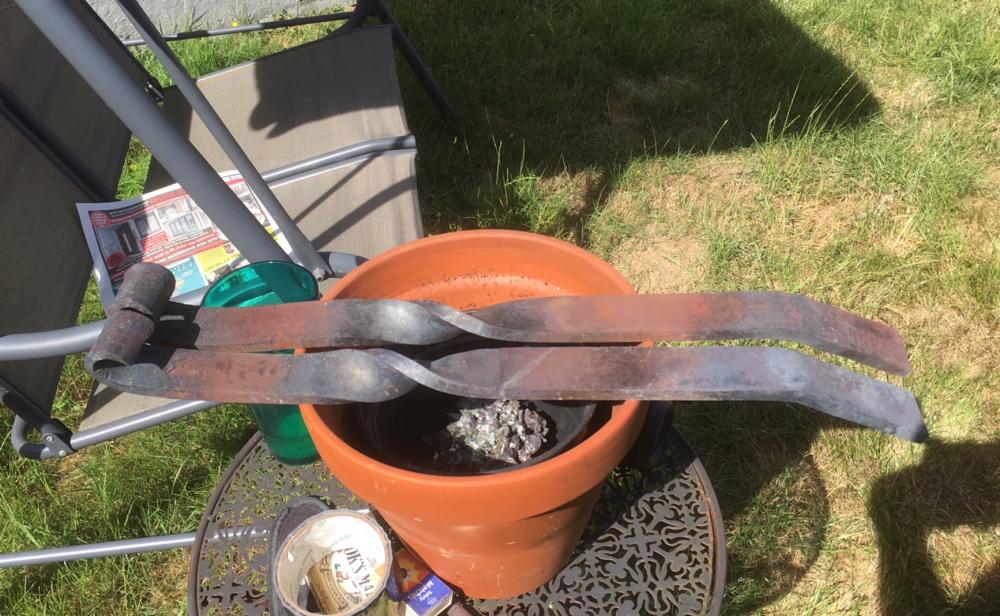

Progress shots of my firepit legs below. The second leg matched the first reasonably well! Success. One more to go!

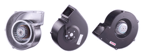

I fitted the new "proper" forge blower, although there were lots of less than ideal duct-tape joins while I gather together to different hose/pipe adapters I need.
Unfortunately I still burnt 4kg of charcoal in approx 2 hours, and am still struggling to get metal hot while I literally stand and watch the charcoal disappear before my eyes.I turn the air supply off between heats, but I find myself adding new fuel EVERY time I put the metal back into the fire because I lose so much so fast. I've tried varying the air flow (on a ball valve) between nothing and full blast and I have no ideas whats "right".
The new blower is this one: Link removed
 Motor Type:External rotor motor / shaded pole
induction IP44
 Nominal Supply:230V 1Ph 50/60Hz

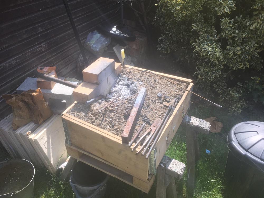

Please post a photo of your current forge. It will help us see what you are doing and provide better answers.
Sorry gents, I AM running a JABOD. I've followed Charles' design pretty much to the letter.
I've upgraded to the forge blower shown above (NOT PICTURED), attached to a 1" ID Tuyure.
I wonder whether the size of my charcoal is now an issue? Some pieces are 2" x 3" pieces? I try to break it up a little as I go by bashing it with my rake.
Since the edges of my fire bowl have broken away with use, the size of the bowl is growing a bit. I guess that could be one of the problems?

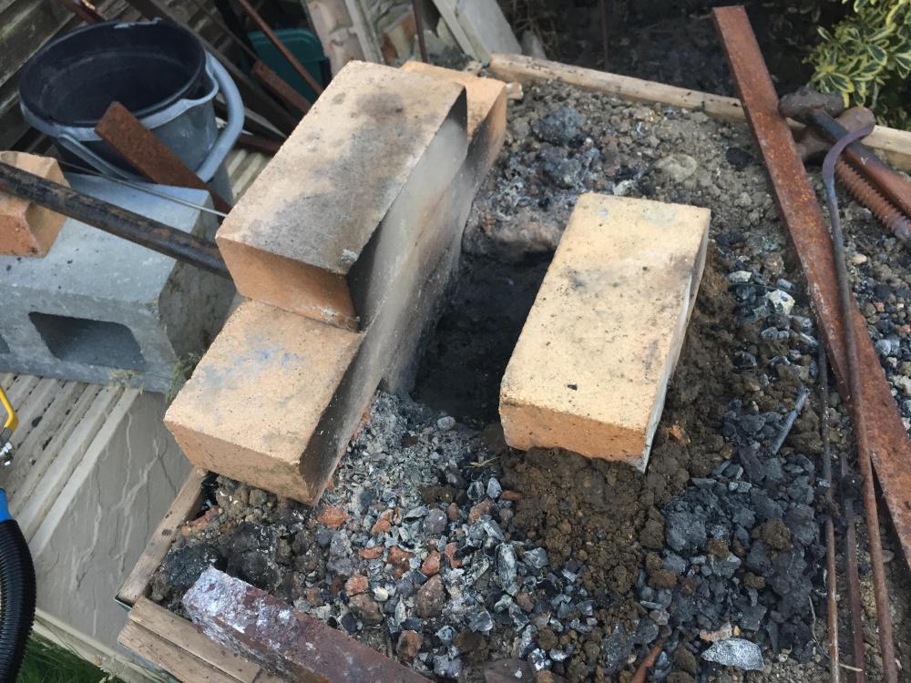

Yeah, you want to break your charcoal up, I prefer it down to say 12-20mm. The greater surface area per volume means faster chemical reactions which means it burns hotter and consumes the oxy sooner. This makes a hotter fire for less depth and helps prevent scaling in the fire. Hot steel will scale when it's exposed to the air but we don't want it scaling IN the fire. If it does you're putting it too close to the air blast.
Another brick wall across from the fire back wall to it forms a trench will help preserve the fire pot(?) and help conserve fuel.

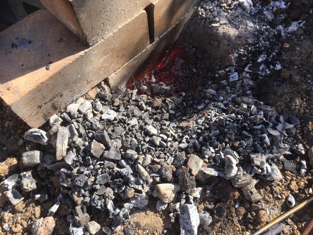

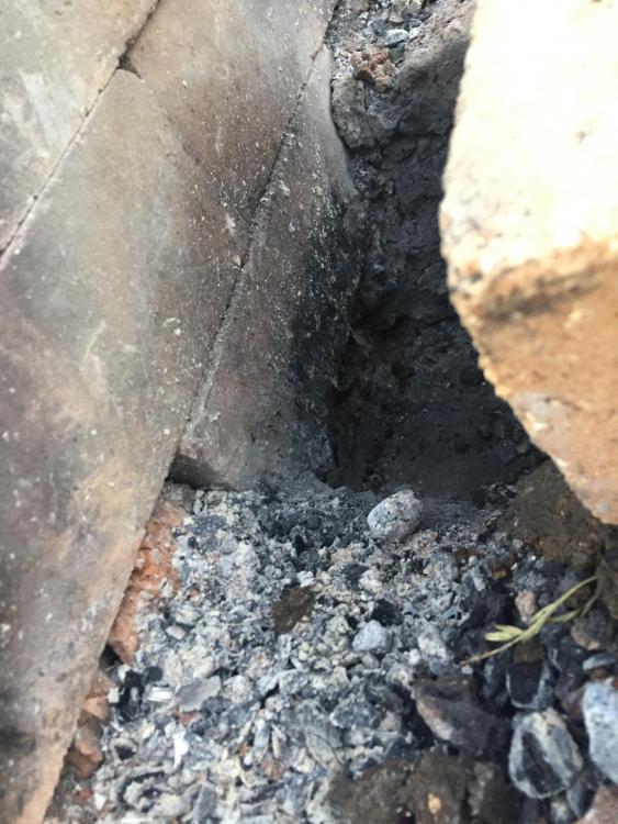

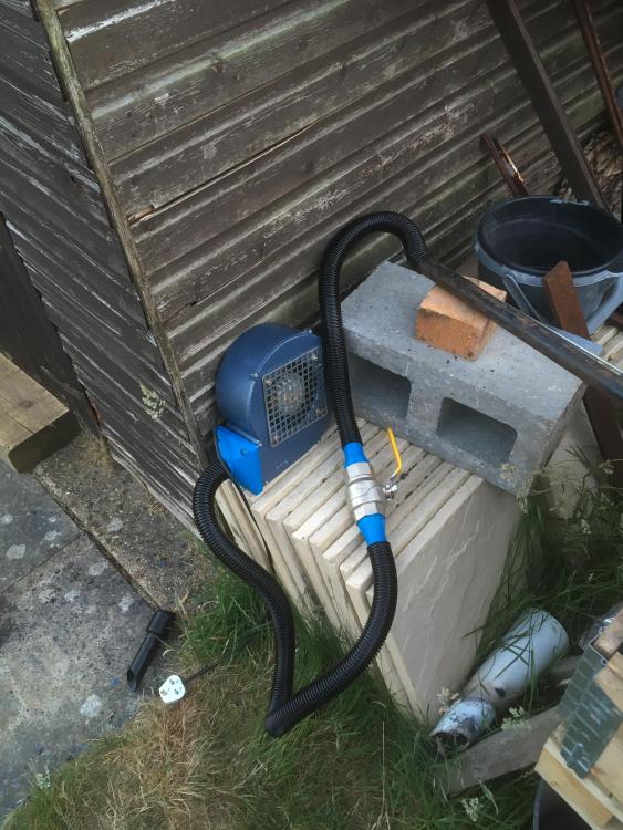

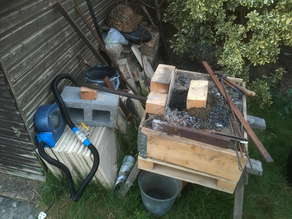

I 3D printed a nozzle and adaptors for my new forge blower. Attached a picture of it all hooked up.
Also attached a pic of my current set up, for what its worth.
Took Frosty’s “trench” suggestion and added the extra brick. Hopefully that will help my consumption issues.
Will try breaking the charcoal up next time and hopefully that will solve my metal heating issue.
Hopefully with the trench, new blower and smaller charcoal next session will be less frustrating!

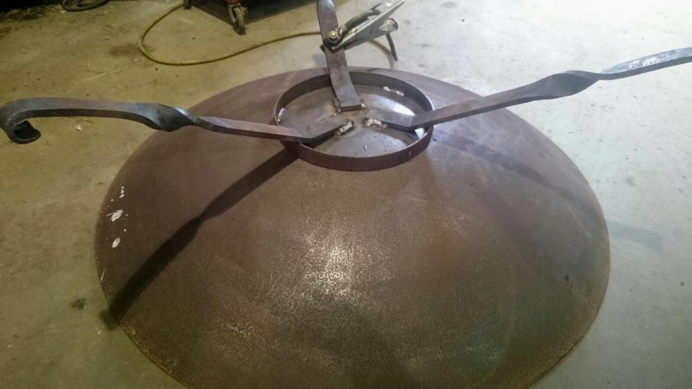

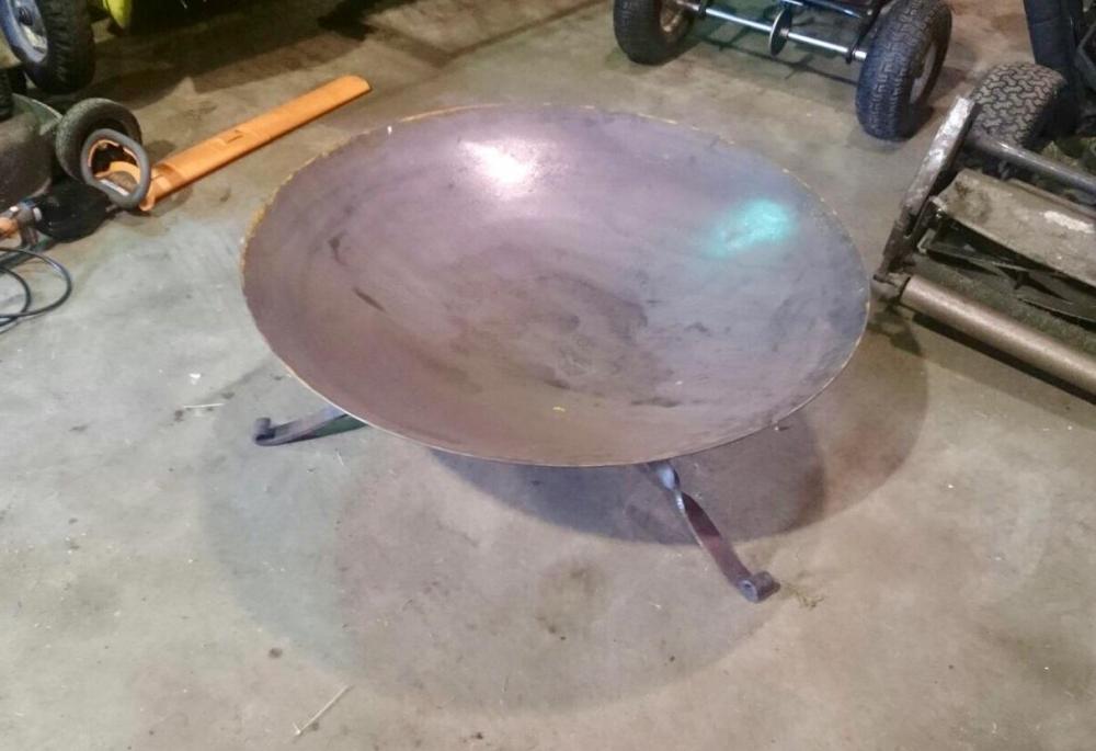

Well, I finished the 3rd of the firepit legs and handed them over to my friend. He's got them welded up straight away and is really pleased.
First happy customer. I feel like a real blacksmith :D (I say customer in the loosest sense, although he did pay me with four bags of high quality charcoal!)
The pictures make it look small, but its actually huge. The dish is over 3 1/2' feet diamater, and each of those legs are forged from 1 1/2" by 1/2" stock.
(Note. The dish was obviously not forged by me, only the legs. He purchased the dish online.)

To deal with heavy logs being dropped/thrown onto the fire I think I would have made each leg terminate at the bowl with a scroll that would contact the ground and take the weight/impact.  Of course if it's a light duty item, not an issue!  Is there plans to add a drainage hole in the center?
Like I said, the picture makes it look smaller than it is. Those legs will be easily strong enough to survive logs being thrown onto the fire. Scrolls to contact the ground is a good idea though, and definitely something I'd consider in future if I made a smaller version with thinner stock legs.
I believe my buddy has already added a drainage hole, and has purchased a small circular grill to add into the bottom to allow some ash to settle out.

Bending Stress is S=My/I (where M is Moment, y is distance from neutral axis, and I is Second Moment of Intertia).
For a rectangular bar as in my firepit legs, I=bh^3/12 (where b is the width, 40mm, and h is height, 20mm).
Since we're interested in maxiumum allowable mass in my firepit, we can rearrange S=My/I to give M=SI/y.
The yeild strength of mild steel is in the region of 370MPa (so S=370MPa).
Therefore, the maxumum allowable Moment M= 986642.
Moment= Forcex distance, and Force=massxgravity. So F=1973N.
Therefore...... The allowable mass on each leg before bending is (believe it or not) 200kg. Since the firepit has 3 legs, thats a total allowable mass of 600kg.
There's no way we'll be putting more than 25kg (50lbs) of wood in the firepit at any given time, so we have a healthy Factor of Safety of 24.
