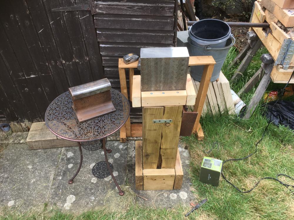

Jon Kerr Posted June 15, 2018 Author Share Posted June 15, 2018 Another freebie- an anvil upgrade. Apparently its a piece of breech steel, leftover from manufacturing a Howitzer.... don’t ask It weighs 44kg (97lbs) so ideal for my requirements as its still fairly portable for tidying away. The difference between this and the rail track is phenomenal. The ring and rebound is great. I haven’t tried a ball bearing yet. The material is so hard the workshop at work didn’t want to try cutting a hardie hole for risk of breaking the CNC tools. So I still dont have any way to mount hardie tools. Open to ideas for that- my best one yet is to grind the rail track into a fuller and hot cut for those jobs? And possibly drill holes for bending jigs. I can make a larger anvil stand and mount them together. Quote Link to comment Share on other sites More sharing options...
JHCC Posted June 15, 2018 Share Posted June 15, 2018 I guess the word got out that you were gunning for a new anvil. Nice that it's free and you didn't have to shell out for it. The price was definitely in your range! I would suggest rounding the edges of the block with a series of radii from 1/16" to 1/2". You still have the RR track, and you could easily grind a hot-cut into one end of the web. Remember also that you have a couple of different interior curves that will prove useful. A hardy hole is great, but you can also make a series of saddle tools that fit over the anvil rather than in. Quote Link to comment Share on other sites More sharing options...
Daswulf Posted June 15, 2018 Share Posted June 15, 2018 Nice upgrade. I agree with John that you should radius the edges on the face you will use. When you get more ideas you have 3 more faces to use or modify. actually 5 more. 3 with more steel under the hammer. I would grind the rail like Charles made his swiss army rail anvil. Quote Link to comment Share on other sites More sharing options...
Jon Kerr Posted June 16, 2018 Author Share Posted June 16, 2018 17 hours ago, JHCC said: A hardy hole is great, but you can also make a series of saddle tools that fit over the anvil rather than in. Do you have any pics of examples? I did something similar with my G-clamped pritchel hole so i guess I need to make “saddle hardie” tools similar to that! Cheers Das- yes it was Charles’ “swiss army railroad anvil” I was thinking of taking inspiration from!! Thanks both for advice re/ rounding the edges- I’ll do that. Quote Link to comment Share on other sites More sharing options...

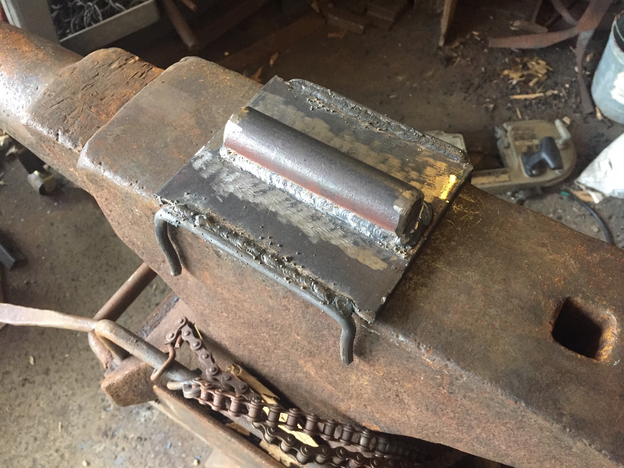

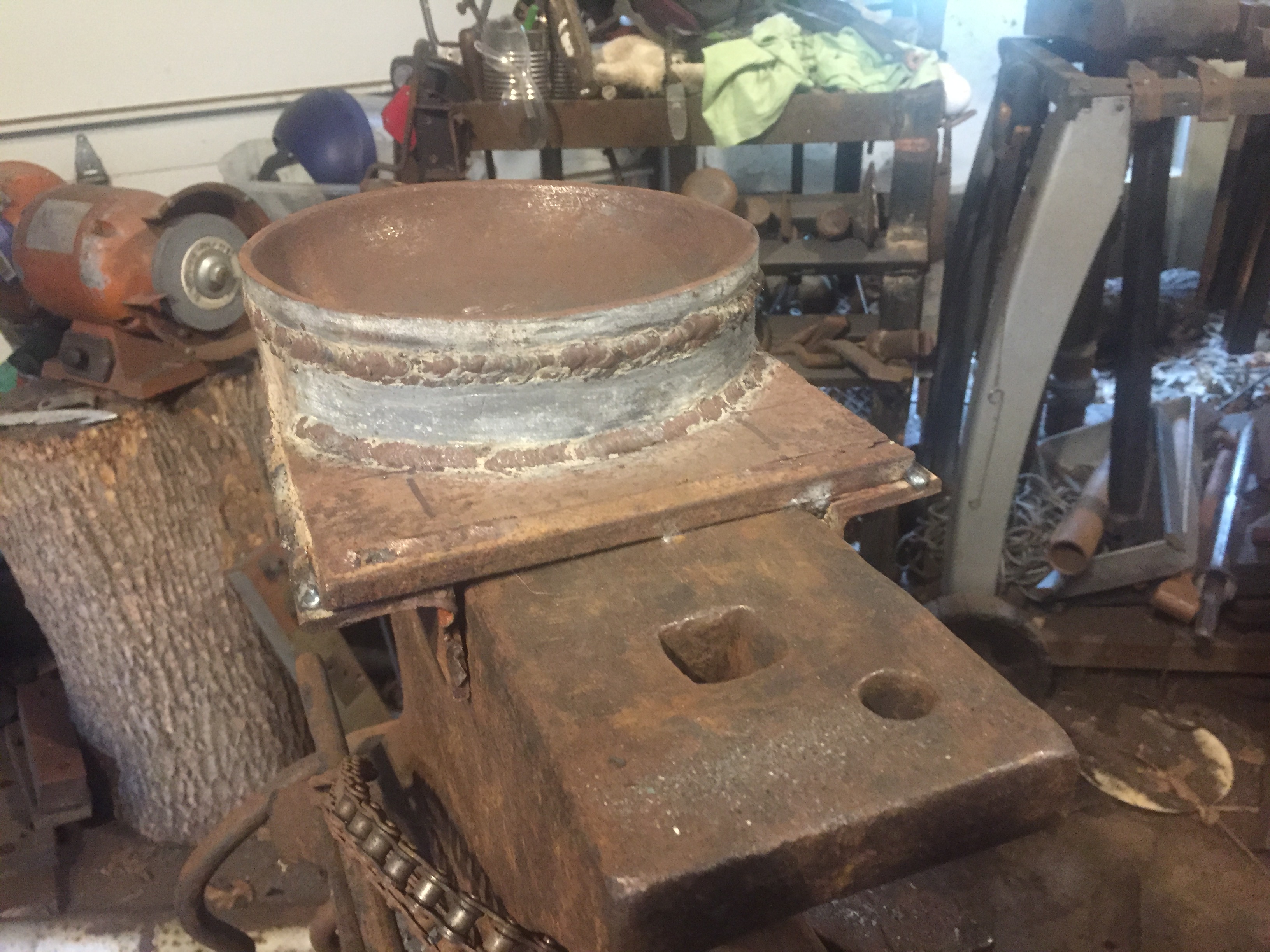

JHCC Posted June 16, 2018 Share Posted June 16, 2018 Here’s the bottom half of a pair of fullers that I use with the treadle hammer. I designed it to be capable of being turned 90 degrees, but in retrospect, that wasn’t necessary: you can always turn the stock, and it would have been more rigid with solid sides. I may end up modifying it one of these days. And here’s an cutting saddle in A36 that fits over the anvil to protect it during chiseling: And here’s a dishing form that’s on a saddle: The fit on this last one is really snug, so much so that I have to put it on and take it off with a hammer. That’s actually really good, because I can hammer on it in any direction without it bouncing around. Quote Link to comment Share on other sites More sharing options...
JHCC Posted June 16, 2018 Share Posted June 16, 2018 5 hours ago, Jon Kerr said: I did something similar with my G-clamped pritchel hole You could always weld up something like this: (Just a mock-up; not something I actually use.) Quote Link to comment Share on other sites More sharing options...
Jon Kerr Posted June 16, 2018 Author Share Posted June 16, 2018 Awesome ideas! Will definitely copy some of these in future. Thanks for taking the time to mock up the hot cut! Thats definitely on the list of items to make soon. Quote Link to comment Share on other sites More sharing options...

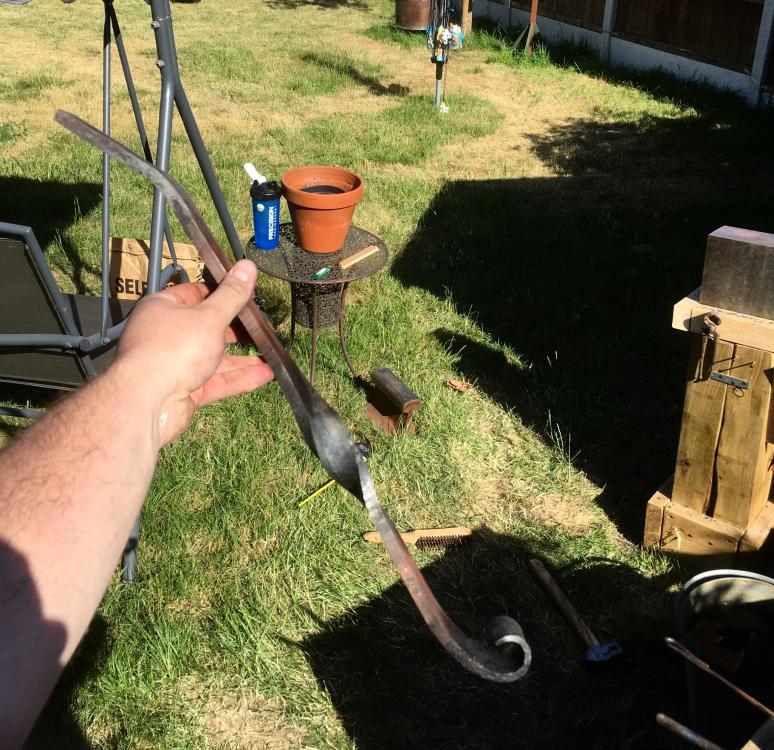

Jon Kerr Posted June 22, 2018 Author Share Posted June 22, 2018 I finally got time to ACTUALLY hit hot metal with a hammer rather than just think about doing it all day.... First run out for the almost-kindve-inspired-by-hofi-ish-style hammer. It was brilliant. Much better than just a ball pein, and I tried out using the cross pein to draw out etc. After reading the “how metal moves” post on IFI I did still pick up the ball pein at certain times to get the metal to shift just how I wanted. I made a leg for a friends firepitz He’s making the firepit for his sisters wedding, and its pretty big (1m diameter) so he wanted heavy duty legs to weld on. Really pleased with the result- especially since this is pretty much the first thing I’ve made after a hook....! In other news: - I got a supplier of charcoal- a local place. Its hornbeam charcoal, which apparently burns hotter, apparently the romans used it and sent it back to the empire. Its MUCH better than the awful instant-light and no more crazy spitting and sparking. - Unfortunately my fire is still not good and I spend more time faffing trying to get metal hot than I do hitting it. The bed pump is simply too much pressure, not enough volume. Fortunately I found an old forge blower and just need to wire it up, and fit a ball valve. I might 3D print some adapters so it all fits. - I burned an entire bag (4kg) of charcoal in about 2 hrs. Is that normal? In the end (again) eventually the fire was popping fireballs out and the pot was full of very small bits of charcoal which were just choking it up. At the bottom was the mother of all clinkers which had literally filled the pot past the tuyere. Is this just because I’m blowing too much air to compensate for the rubbish bed pump volumetric flow rate? The pot being full like this basically stopped me forging in the end until it cools and I can scoop it out. Is that normal? I took the clinker out and its bigger than my fist. Quote Link to comment Share on other sites More sharing options...
Irondragon Forge ClayWorks Posted June 22, 2018 Share Posted June 22, 2018 6 hours ago, Jon Kerr said: faffing Had to google this. Love it when I can learn a new term. Sounds like you have too much air going to the charcoal. Never had a "clinker" with charcoal, looks like the fill is melting (vitrified) to me. Quote Link to comment Share on other sites More sharing options...
ThomasPowers Posted June 23, 2018 Share Posted June 23, 2018 You can get clinker with charcoal especially if it's a high silica charcoal and the forge runs hot enough to melt the ash and scale together. Quote Link to comment Share on other sites More sharing options...
Jon Kerr Posted June 23, 2018 Author Share Posted June 23, 2018 Does this mean the charcoal is bad? Or the forge is *too* hot? It didnt seem to heat metal fast. I did have a layer of clay/soil that was added (wet) to the firebowl later. I had hoped it would smooth it out. Maybe this layer vitrified and dripped to the bottom. Quote Link to comment Share on other sites More sharing options...
