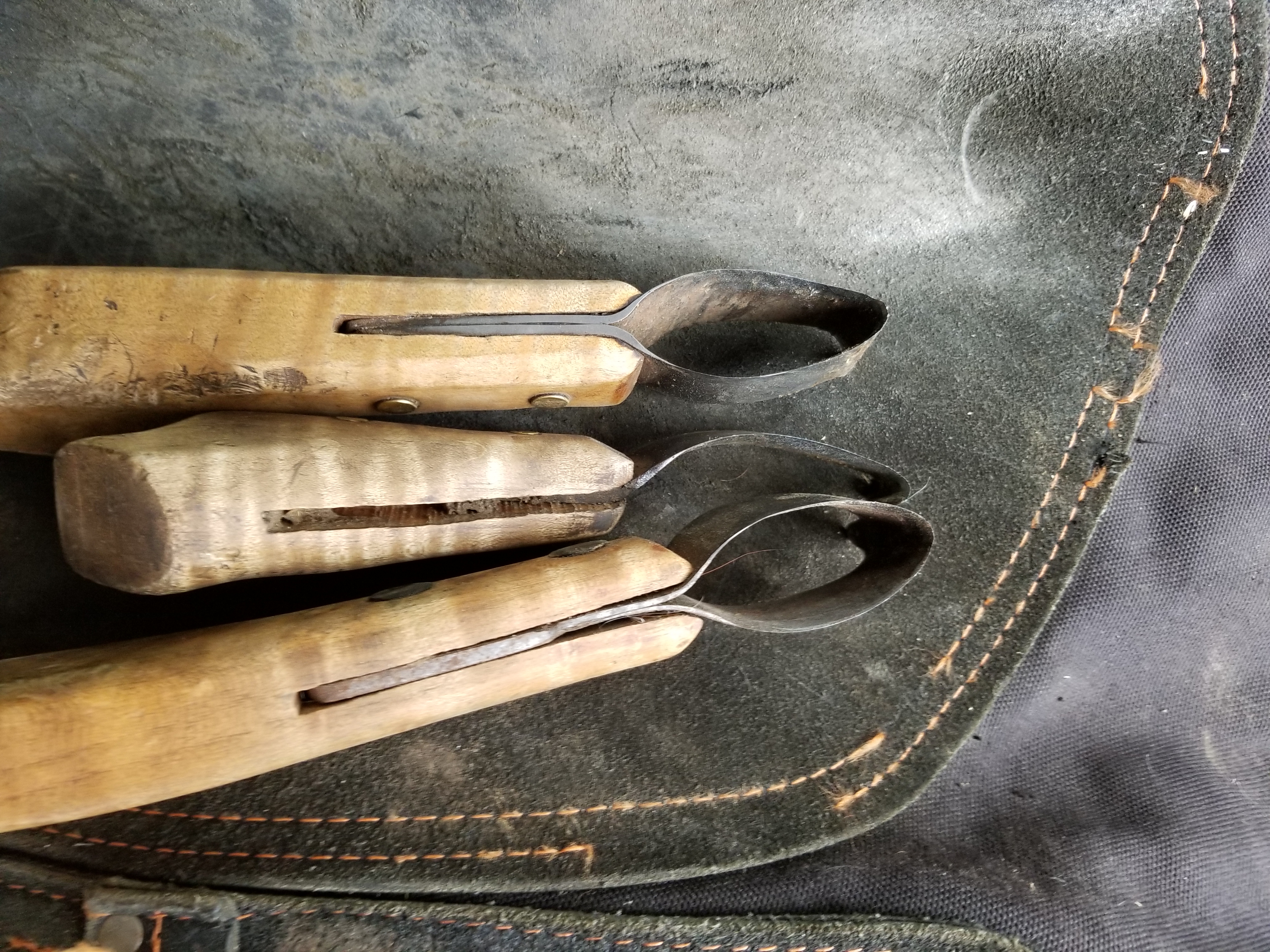

jlpservicesinc Posted June 4, 2018 Share Posted June 4, 2018 Makes 2 of us.. That knife is an injury to me or the horse just waiting to happen.. I also agree with your methods and with a well trimmed foot one is never to invade the live sole structure.. Better left alone for it to correct through proper weight bearing, rather than through me taking what " I " think should come out. The markers are there for exactly what should come out.. on the knife note.. These are what I use daily and the hoof pick on the back of the blade is the most efficient way of getting the results.. Charles I to used to only use the back of a standard hoof knife to clean out the commisures and found these designes to be far more effective.. At some point I will be making you one to have an use to give feedback on.. I've just been to busy to find the time to make it.. It will have a Hastings type handle on it as you mentioned that is the style you like.. Link to comment Share on other sites More sharing options...
