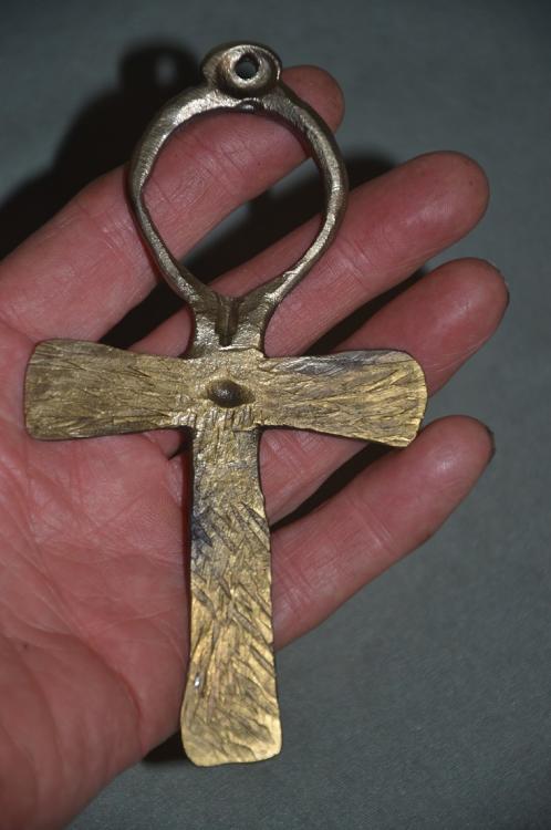

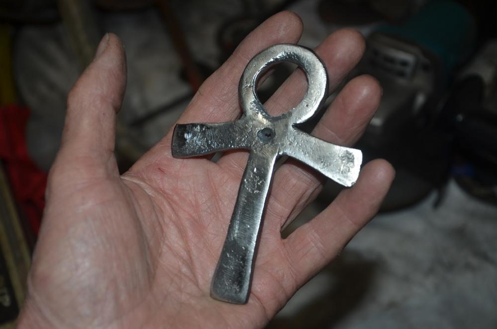

ausfire Posted May 11, 2018 Share Posted May 11, 2018 I have a niece who is big on Egyptian stuff so I thought I would have a shot at making an ankh cross for her. A bit tricky and I'm not 100% happy with my first try. My method: Prepare a short length of 12mm square bar as for a Frederick's Cross but don't overlap the cuts. Forge into a plain cross which will not have the four point star in the centre. Split and drift the top half of the cross to make the loop. Flare the cross bar ends and lower end a little and texture. Has anyone else forged these ankh crosses? Perhaps there is a better way and I would be interested in all suggestions. Here is my attempt: Link to comment Share on other sites More sharing options...
JustAnotherViking Posted May 11, 2018 Share Posted May 11, 2018 Looks like it would make a nice Egyptian style bottle opener! If there was enough thickness left in the 'head', I would personally try flattening it down a bit more to match the profile of the rest of the cross rather than being rounded. Rather than the textured hammer marks, perhaps use a small fuller to uniformly depress the centre rather than random marks, so it's a bit of a cleaner/decorative finish? Either way, a great first version! Link to comment Share on other sites More sharing options...
Daswulf Posted May 11, 2018 Share Posted May 11, 2018 Well There's an idea I will have to borrow. And the bottle opener version is a great idea. Good first go Aus. I'm betting there will be more. Link to comment Share on other sites More sharing options...
ausfire Posted May 12, 2018 Author Share Posted May 12, 2018 Thanks, Das. I will try more. I find the preparation takes the time before the piece gets near the forge. I suppose I could weld the pieces together using a perfect ring, but it's not the same as forging it from one piece. Viking: Thanks for the suggestions. What you say would definitely lead to an improved design. Note taken. Link to comment Share on other sites More sharing options...
JHCC Posted May 12, 2018 Share Posted May 12, 2018 I like it, but the thinness of the loop is a bit out of proportion with the other limbs. Perhaps if you upset the top limb lengthwise before splitting the loop, that would give you some more thickness to play with. Link to comment Share on other sites More sharing options...
ausfire Posted May 12, 2018 Author Share Posted May 12, 2018 Yes, the loop became thin quickly. I did allow a bit more metal there by making the original long cut off centre and using the thicker section as the top limb. It wasn't enough. Perhaps some upsetting and a smaller loop may have been better. I'm sure I can improve on this one. Link to comment Share on other sites More sharing options...
JHCC Posted May 12, 2018 Share Posted May 12, 2018 First tries are always good for identifying things to improve. Link to comment Share on other sites More sharing options...

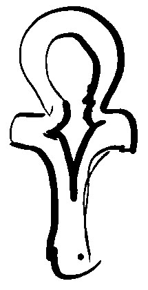

Shabumi Posted May 19, 2018 Share Posted May 19, 2018 I think it would look nice if you did the overlapping cuts on the Fredericks cross, making the North/south cut deeper. It would help balance the size difference between the the round part and the main body. Sorry for the poor drawing Link to comment Share on other sites More sharing options...
ausfire Posted May 19, 2018 Author Share Posted May 19, 2018 Ah, yes. I see what you mean. I didn't intend it to be a Fredericks cross, as I didn't overlap the cuts. Thanks for the drawing - that's a variation I would like to try. Link to comment Share on other sites More sharing options...

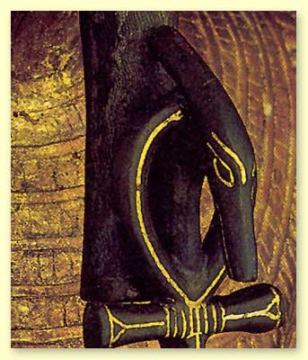

Shabumi Posted May 23, 2018 Share Posted May 23, 2018 On 5/21/2018 at 10:45 PM, SFC Snuffy said: Er, you know what an ankh represents, right? Seems an odd thing to gift to a family member. Not too odd a gift, if its meaning could be sumed up in a single word, it would be 'life'. As one of the most widely used symbols in ancient Egypt. Among its many uses, it could be used as a charm against sickness and disease, to promote prosperity in life, a fertility symbol or was buried with their mummies to ensure an easy transition between life and the afterlife. Because there are many ancient gold ankhs, and no/few silver ones, it is agreed that it was a symbol of the sun. Symbolizing the meeting of the sun and the horizon, or the heavens meeting the earth. It was also associated with many of the Egyptian gods, and when combined with the djed and was symbols becomes a symbol of the creator God Ptah, patron of Smith's and Craftsmen. I always the ankh-was-djed scepter would be an interesting piece to try and make once my skills are better. Here's a closer look at a pottery version of a was-ankh found in one of the tombs. Looks like a simple enough animal head to do Oh no, I just realized I said the famous last words 'looks simple enough' Link to comment Share on other sites More sharing options...

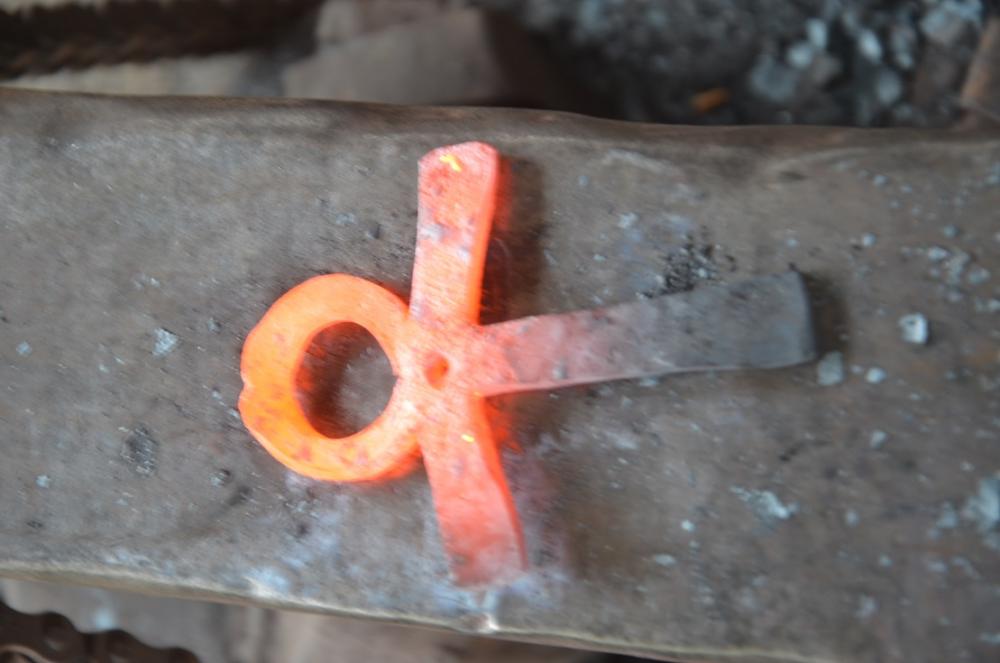

ausfire Posted May 23, 2018 Author Share Posted May 23, 2018 Shabumi, thanks for the history lesson. I always thought the ankh was a fertility symbol. I had another look at your drawing and got a piece of 12mm square bar to make another one. However, I can't see how you can make the "north/South cut' of a Frederick's Cross deeper. There is only one overlap which creates the 'square' diamond in the centre. I guess it could be made longer by heating and then stretching the diamond. I'm going to try John's method next - upsetting the top arm to create enough mass. A well proportioned ankh remains a challenge. Link to comment Share on other sites More sharing options...

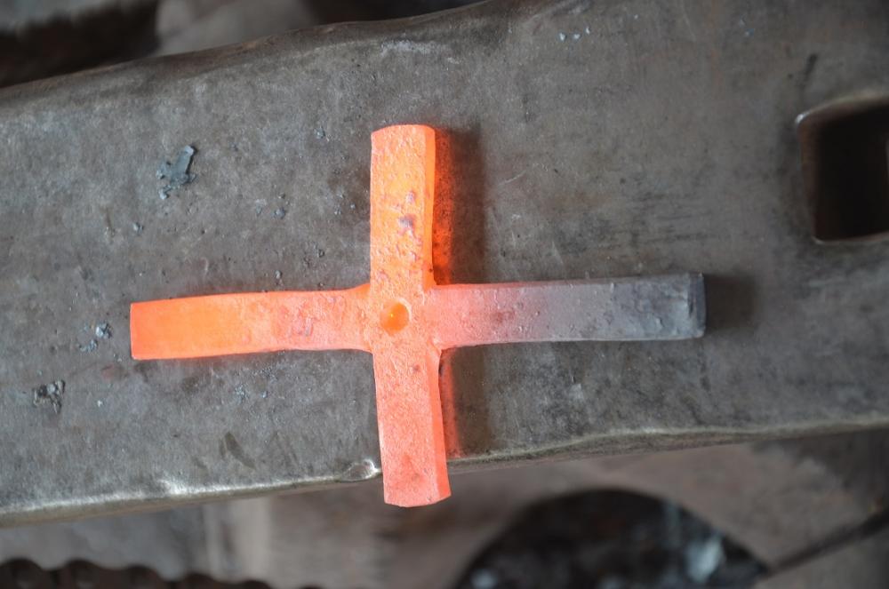

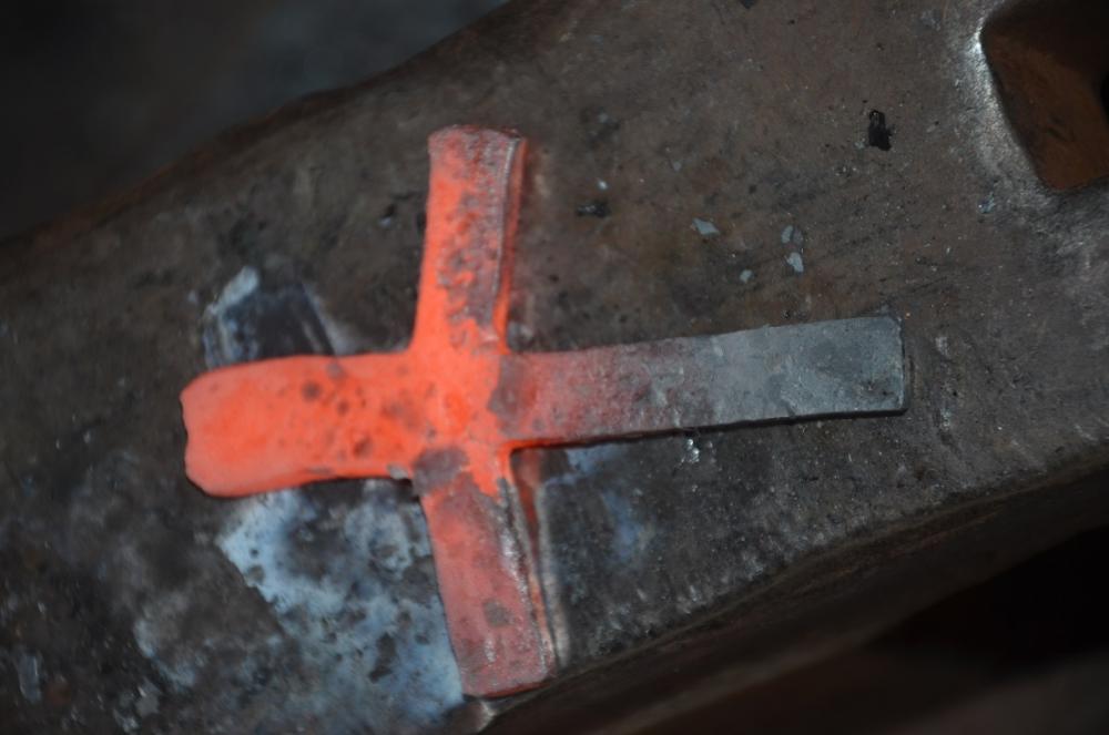

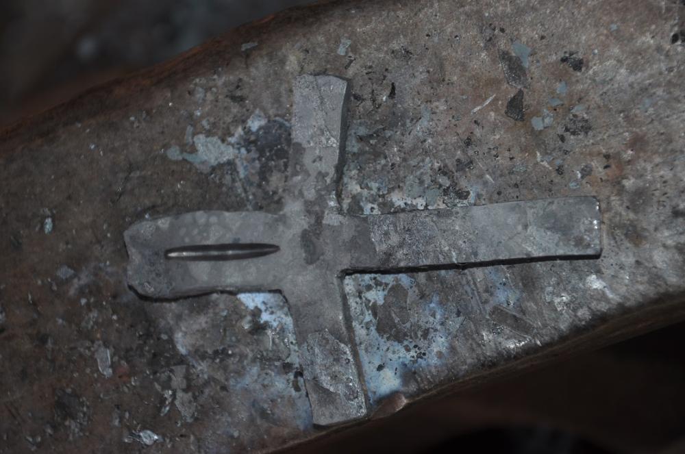

ausfire Posted May 24, 2018 Author Share Posted May 24, 2018 On 12/05/2018 at 9:06 PM, JHCC said: I like it, but the thinness of the loop is a bit out of proportion with the other limbs. Perhaps if you upset the top limb lengthwise before splitting the loop, that would give you some more thickness to play with. I tried that today, John, but you will have to let me in on the secret of how you upset the top limb. I tried everything, lots of heat, part quenched etc but it just wanted to bend. I must be missing something. Upsetting 12mm x 5mm just didn't want to happen. In desperation, I took an alternative path to getting the mass for the loop. Folded the top over and fire welded the parts together. Then I made the split and drifted it round. The weld must have been OK because it didn't delaminate. It needs a bit more tidying up, but I think I have much better proportions than my first try. Here's the process: (Apologies for poor pics) Link to comment Share on other sites More sharing options...
Daswulf Posted May 24, 2018 Share Posted May 24, 2018 And you said you couldn't fire weld. That turned out nice Aus. Link to comment Share on other sites More sharing options...
JHCC Posted May 24, 2018 Share Posted May 24, 2018 I'm not particularly good at upsetting, but the best success I've had comes from remembering the wise words of Alexander Weygers and Rowan Taylor: "Little corrections, little corrections. With the little corrections, we avoid the big corrections" and "When it comes to upsetting, think short and hot." In other words, only heat the part you want to upset, and correct it the moment it starts to bend. However, that fire weld turned out great, and that last ankh looks fantastic. Maybe just stick with that, since it works so well. Link to comment Share on other sites More sharing options...

Frosty Posted May 27, 2018 Share Posted May 27, 2018 You had me scratching my head when you said you were trying to upset the upper limb. I'll try almost anything to avoid having to upset stock. Folding and forge welding was what came to mind when you posted your first Ankh. Nice ankh Aus or maybe I should say Atta Ankh Aus? . . . Hmmm. . . Yeah, I like that better it has a better lyrical ring, nice cadence. Frosty The Lucky. Link to comment Share on other sites More sharing options...

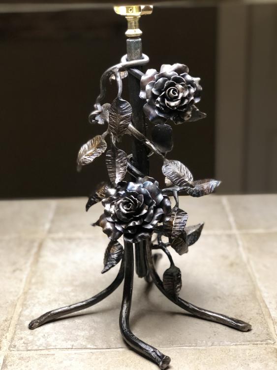

58er Posted May 28, 2018 Share Posted May 28, 2018 Rose lamp. Link to comment Share on other sites More sharing options...
