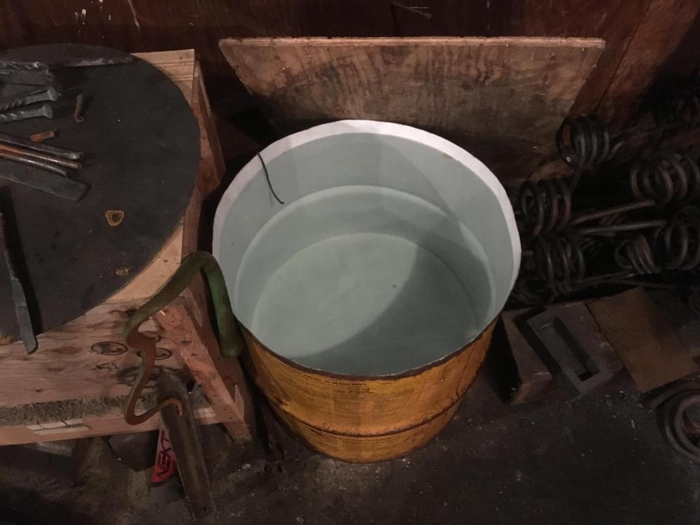

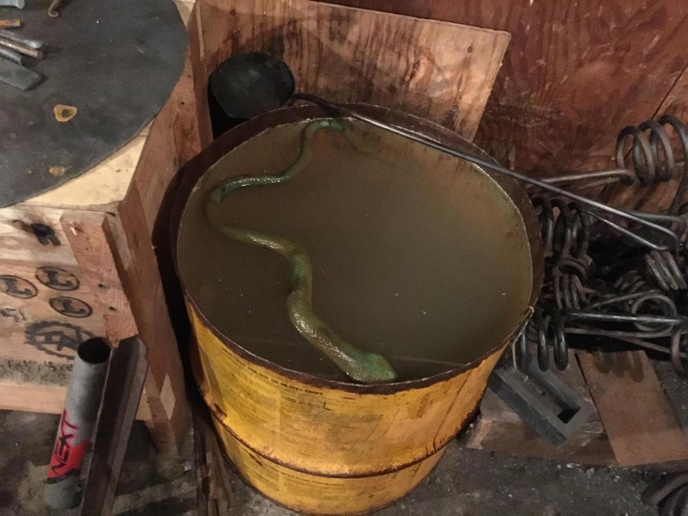

Ramsey26 Posted May 10, 2018 Share Posted May 10, 2018 So a few weeks ago after the snow had melted (yes that just happened recently where I'm from) I decided it was time to fill up my water barrel again. It's sooo much nicer having a huge barrel of water compared to the ice cream Pail that I have to make do with in the winter but the water always gets real weird. Last year due to my barrel being metal the water quickly became brown with rust but a just dealt with it for the rest of the year. This year I coated the intire interior of the barrel with canola oil to prevent rust. The oil that was supposed to keep the barrel water nice has already done the opposite. It's developed a strange white slime which is making the water turn white. It's also starting to rust as the slime wears off.. So what I was wondering is if anyone has had similar problems and found solutions? If anyone has any recommendations I would love to hear them. (Pay no attention to the green snake he's friendly) Quote Link to comment Share on other sites More sharing options...
Frosty Posted May 10, 2018 Share Posted May 10, 2018 You put FOOD in your slack tub?! Your friendly green snake probably used to be red and black before s/he discovered grazing in your slack tub was easy dinner. Next time have it sprayed with "Rhino liner." They have to spray out a surprising amount to clean the guns after doing a pickup bed, bribe them with doughnuts to spray the inside of your barrel. It might take a little while and a couple boxes of doughnuts but bed liner isn't food and it's really tough. It's also really good in a tumbler, lasts a lot longer than a clean 55gl. drum and it really quietens it down. Good stuff Rhino liner. Frosty The Lucky. Quote Link to comment Share on other sites More sharing options...
olfart Posted May 10, 2018 Share Posted May 10, 2018 Oil is lighter weight than water, so any oil inside the barrel will rise to the surface. That's what the scum is on top of the water. The barrel also needs to be covered and/or dumped periodically to keep down mosquito and algae infestations. Quote Link to comment Share on other sites More sharing options...
Charles R. Stevens Posted May 10, 2018 Share Posted May 10, 2018 You can buy cheep bed liner in a spray can, this is very similar to the coating used in water towers. This will prevent the rusty water issuer. A hand full of copper scrap will help with the algae and skeeters Quote Link to comment Share on other sites More sharing options...

SLAG Posted May 10, 2018 Share Posted May 10, 2018 Charles, Good morning good guy. A little bit of copper sulfate, (CuSO4), will do the same job. That will avoid locating copper bits & placing it in a steel mesh bag. And also periodic water replacement, is not necessary. And it is much faster acting than plain copper. The tub needs only a small amount of a 2 or 3 milliliters CuSO4 solution in water, for a half tub full of water. Put a barrier on top of the tub, as the chemical is poisonous, for people, animals, insects, algae etc. CuSO4 was used as a rat poison in Victorian times. You can get it from the net, or a pharmacy will order it in for you. SLAG. Quote Link to comment Share on other sites More sharing options...

Ramsey26 Posted May 11, 2018 Author Share Posted May 11, 2018 I actually keep a square of plywood over the barrel whenever I'm not useing it and that's been enough to keep out mosquitoes, other bugs who end up drowning, and algae. Do you think that's why the oil is turned to slime and making the water cloudy? This happened within 24 hours of adding water so it's seems pretty fast acting for algae. It doesn't smell weird or at least not yet.. I think I'll throw a old copper pipe in next time around to be on the safe side. My real problem is the rust I think I'll try to find some of that Rino liner or do you think a can of normal rust paint would hold up? Quote Link to comment Share on other sites More sharing options...
SLAG Posted May 11, 2018 Share Posted May 11, 2018 R-26, The oil is being used as a food source by bacteria, and also fungi such as yeasts and other groups. Many such micro-organisms can break down oil and other hydrocarbons. The oil in water is a feast for many of them and they will get to work very quickly. Algae are "primitive" plants. They make their own food by using CO2, water, and sunlight. They need sunlight like higher plants. So they will not thrive in a tub whose top is covered for much of the time. Cheers, SLAG. Quote Link to comment Share on other sites More sharing options...
