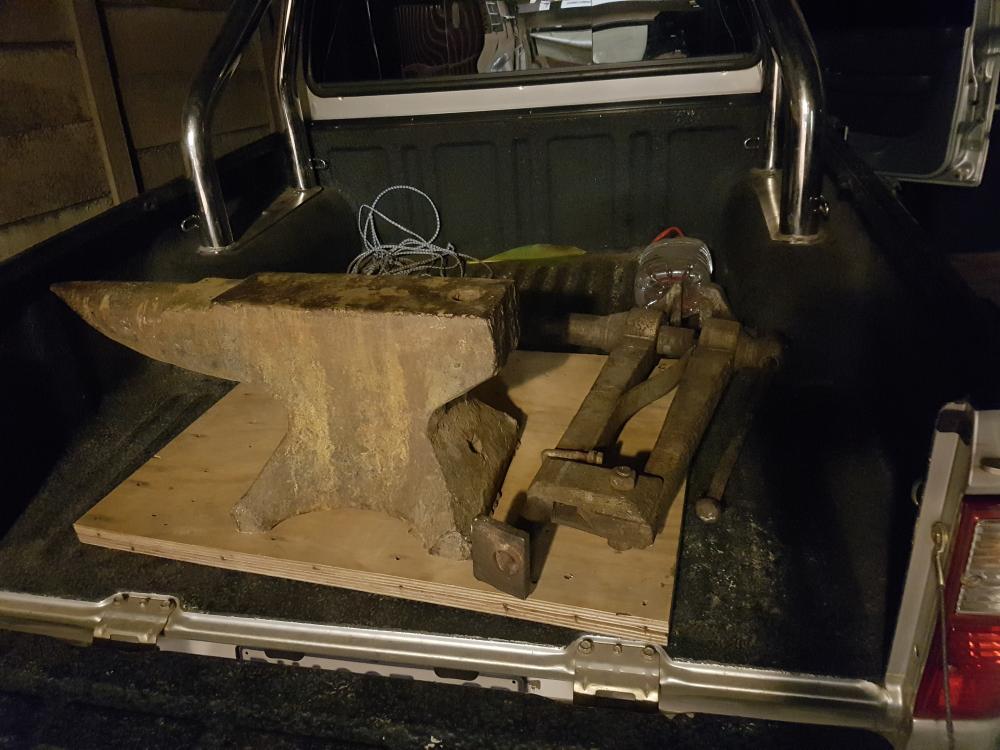

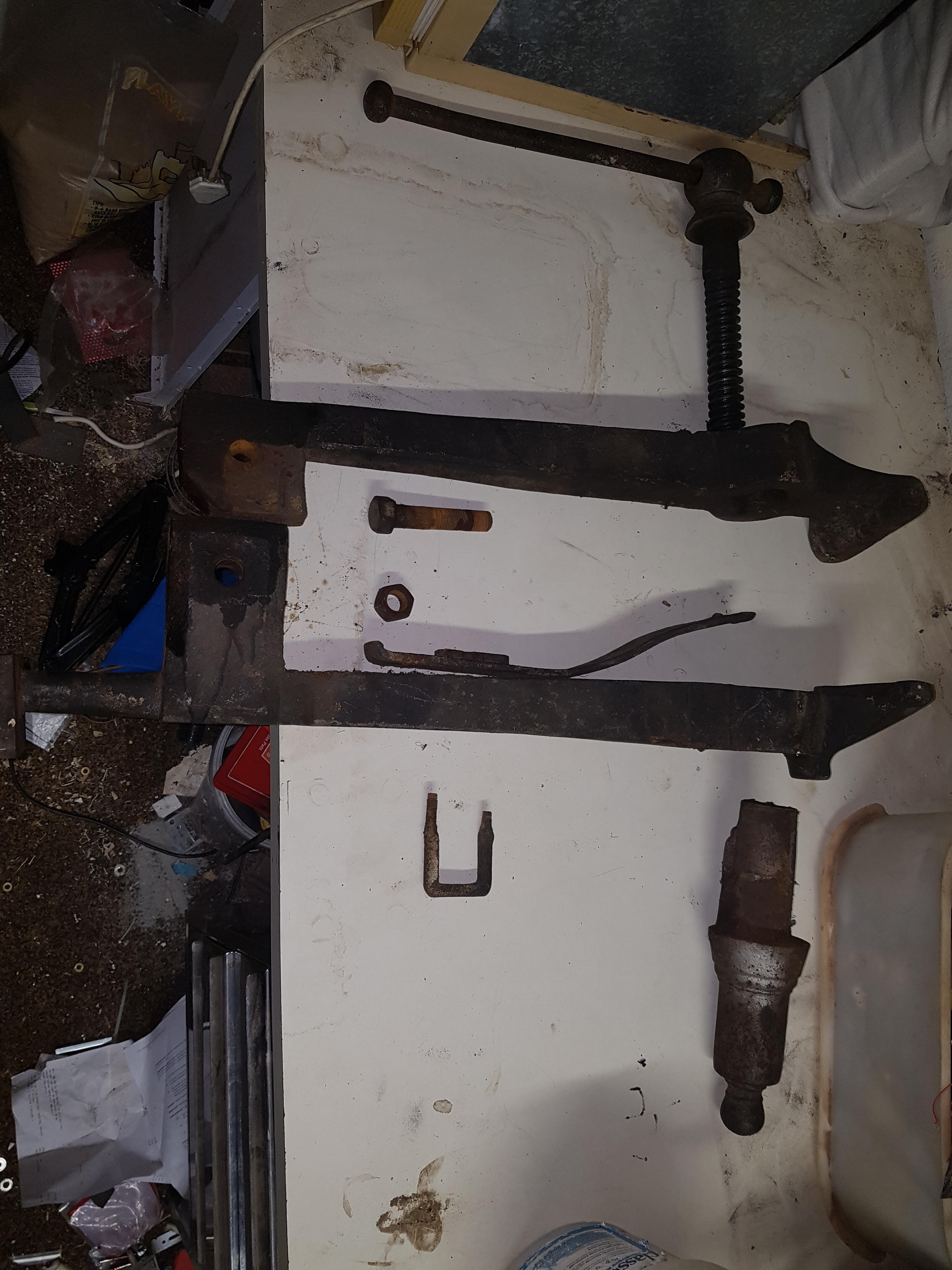

Dark wing Duck Posted May 16, 2018 Author Share Posted May 16, 2018 Hi guys Just a update got the anvil this weekend and it looks great. It is +- 197kg so that is awesome. I started stripping the vice to clean it up and the screw box is 100% Quote Link to comment Share on other sites More sharing options...
BIGGUNDOCTOR Posted May 16, 2018 Share Posted May 16, 2018 You can make bottom tools with a round shank, and just add a tail that hangs over the heel to keep them from spinning. Is that a wrought iron body with a top plate, or is it cast steel? Quote Link to comment Share on other sites More sharing options...

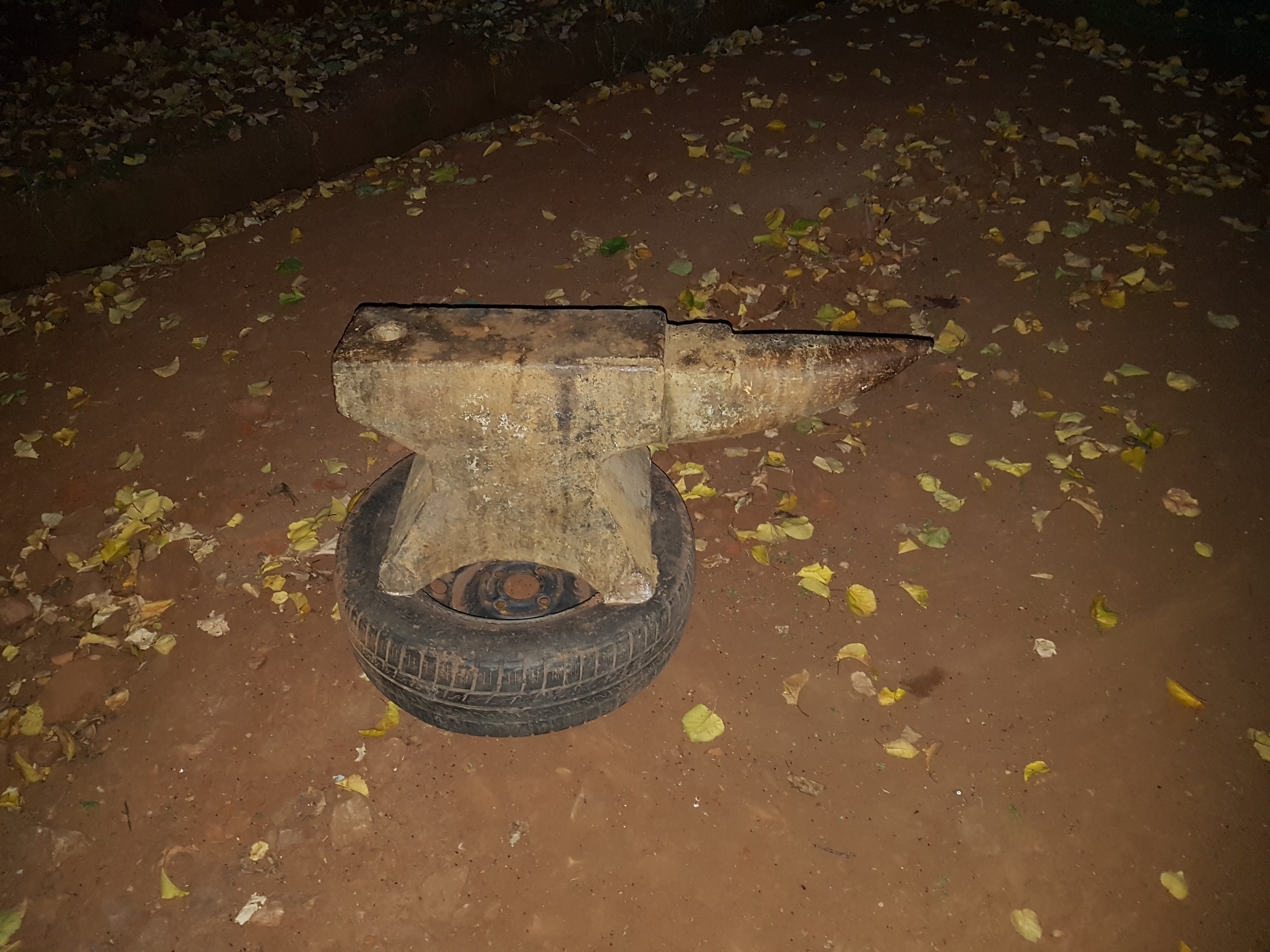

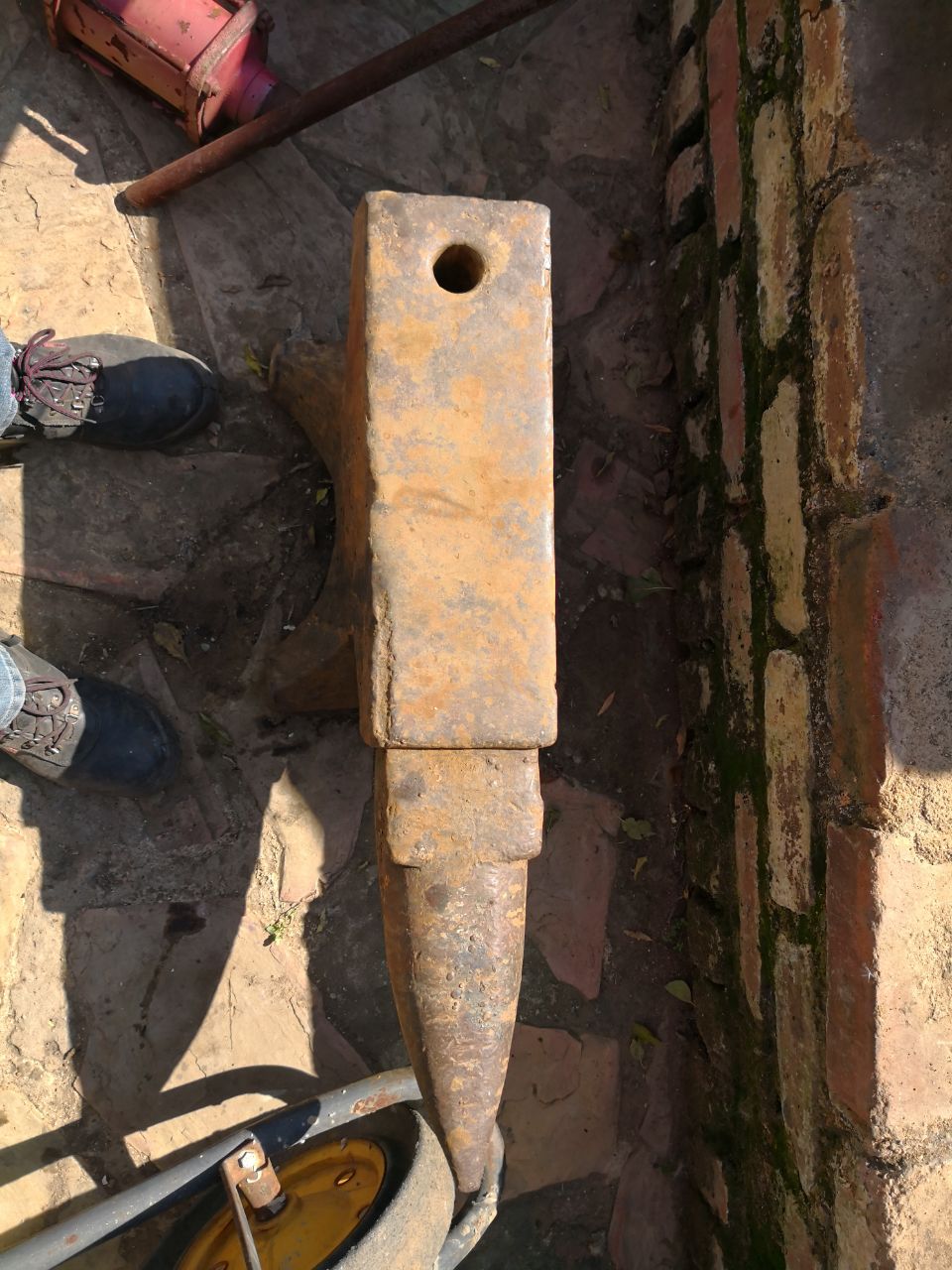

Dark wing Duck Posted June 19, 2018 Author Share Posted June 19, 2018 Hi guys thanks for the advice I have been working on the anvil and loving it. One thing that is a problem is that there is some welding on the horn and it looks like the anvil took a good bang on the horn and it looks like the horn has a mushroom on the tip. Any advice would be appreciated how do I did this ? I just feel like grinding off the welding and mushroom but I would like to consult with the professionals first . Quote Link to comment Share on other sites More sharing options...
Irondragon Forge ClayWorks Posted June 19, 2018 Share Posted June 19, 2018 Most older anvils have the tip of the horn/bick flattened a little. Done to prevent getting punctured if bumped against by the smith. Before grinding the weld, I would try a file if its soft. Quote Link to comment Share on other sites More sharing options...
ThomasPowers Posted June 20, 2018 Share Posted June 20, 2018 Bout the 3rd time you run into the horn (they generally are at an unfortunate height!) in the same week you may find yourself grabbing a hammer and dulling it down a bit more... If you need a small sharp horn---make one for your hardy hole! Quote Link to comment Share on other sites More sharing options...

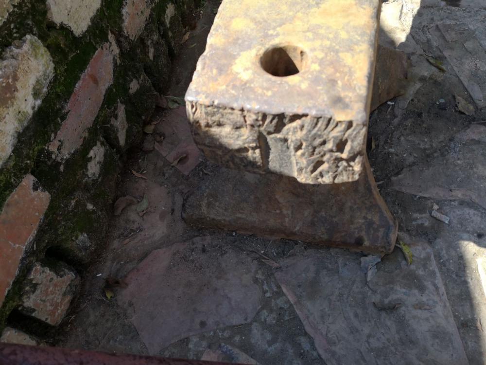

Dark wing Duck Posted June 20, 2018 Author Share Posted June 20, 2018 Thank you guys I have some rail track that I will turn onto a small "hardy horn" the other thing that is funny my anvil has a round hole for a hardy I'm not sure if the previous owner drilled it out or if it is a different type of anvil. But I am thinking of making a hardy stand and mount it next to my anvil Quote Link to comment Share on other sites More sharing options...
ThomasPowers Posted June 20, 2018 Share Posted June 20, 2018 May we have a picture of it and it's round hardy hole? Quote Link to comment Share on other sites More sharing options...
Buzzkill Posted June 20, 2018 Share Posted June 20, 2018 Go back a page TP. He has some decent pictures of what he's referring to on page 1. Quote Link to comment Share on other sites More sharing options...
Dark wing Duck Posted June 20, 2018 Author Share Posted June 20, 2018 I will tomorro Quote Link to comment Share on other sites More sharing options...
ThomasPowers Posted June 20, 2018 Share Posted June 20, 2018 My guess is that when they lost the original hardy hole---still see part of it on the heel scar, they drilled one and made it large enough to drop in their original hardy tools rather than go to the trouble to make is smaller and square. Perhaps you could measure the scar and then multiply it by the square root of two and compare that number to the size of the round hole? (or without math cut a piece of cardstock square to match the hardy hole scar on a side and compare with round hole.) Quote Link to comment Share on other sites More sharing options...
Dark wing Duck Posted June 20, 2018 Author Share Posted June 20, 2018 Yes that makes a lot of sense. Do you think making a separate hardy stand is the best i am Scared of doing work to the anvil Quote Link to comment Share on other sites More sharing options...
ThomasPowers Posted June 20, 2018 Share Posted June 20, 2018 depends if spinning hardy tooling causes problems with your methods and type of work. the contact plates on bulldozers and road graders often have good sized square holes that can be used. I found a nice 50# piece of one with 2 1" sq holes that I picked up at the scrapyard (us$10) in case I had a student wanting to sledge a bit... Quote Link to comment Share on other sites More sharing options...
Dark wing Duck Posted June 20, 2018 Author Share Posted June 20, 2018 To be honest I'm still learning I don't have any hardy tools yet but I will get some soon , I used a chisel as a hot cut and it worked fine but the spinning made it a bit difficult Quote Link to comment Share on other sites More sharing options...
Smoggy Posted June 20, 2018 Share Posted June 20, 2018 Find a bit of heafty plate or similar to make a 'saddle' to sit atop your anvil and cut a square hardy hole in it, Sit it over the existing replacement hole and the jobs a goodoun, it will double as a cutting plate or you can even drill a series of holes in it to use it as a bolster for punching holes. Quote Link to comment Share on other sites More sharing options...
ThomasPowers Posted June 20, 2018 Share Posted June 20, 2018 Or find a piece of sq tubing that is a snug fit in the round hole and have it mig welded around the top. Don't forget the preheat to avoid HAZ cracking.. (In older days I would have suggested sealing the bottom of the square tubing and pouring lead in the gaps.) Quote Link to comment Share on other sites More sharing options...
