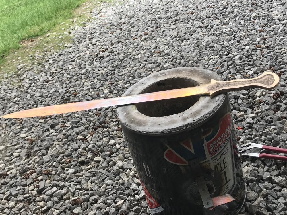

Andrew Golabek Posted May 7, 2018 Share Posted May 7, 2018 Today I successfully cast a bronze sword, this was my second attempt. 1.86kg of 12%tin bronze was used in the casting Not a perfect finish, but I’m pretty happy! will update as it is finished Quote Link to comment Share on other sites More sharing options...

Smoggy Posted May 8, 2018 Share Posted May 8, 2018 You can't just post a few pics of a mold and a lump of bronze! As much as we like pictures we need detials! What was the mold made from? is that a solid fuel furnace? How are you intending finishing the blade, just a grind or will you be hammering the edge to work harden it? And last but not least......Will it kill! Quote Link to comment Share on other sites More sharing options...
Andrew Golabek Posted May 8, 2018 Author Share Posted May 8, 2018 The mold is made from greensand, in an oak flask I made, with the particle board faces so the sand doesn’t crack outwards. Greensand mix was 75grit silica, 10% western bentonite, I’m guessing it was about 70-80lbs to fill the flask!! The foundry is propane fired, I used a graphite crucible, and the only flux was charcoal, both powdered and in chunk form (charcoal was made in the foundry prior in a heavily reducing atmosphere) i used a wooden pattern that I ground out on a bench belt grinder. this is my sixth bronze blade, although it’s about 4 times larger than anything I’ve cast before haha, I’m planning on grinding it smooth, and then annealing the spine with the propane torch (undecided whether or not to anneal yet), and then I have a little jig I use to harden the edges whether or not it will kill remains to be seen haha, definitely planning on testing it once it’s done, perhaps a chicken is on the order Quote Link to comment Share on other sites More sharing options...
ThomasPowers Posted May 8, 2018 Share Posted May 8, 2018 Annealing the spine of something that has been cast and then NOT workhardened---why? Quote Link to comment Share on other sites More sharing options...
Andrew Golabek Posted May 8, 2018 Author Share Posted May 8, 2018 It will be work hardened, and I’m still not sure if it will be annealed or not before, it is quite stiff already, and some pieces I cast beforehand were slightly brittle, although perhaps brittle is an exaggeration as they were beat on with a sledgehammer haha the bronze knives I’ve made so far we’re cast, and then the edges were work hardened, no annealing was done at all. Quote Link to comment Share on other sites More sharing options...

Andrew Golabek Posted May 9, 2018 Author Share Posted May 9, 2018 Did some grinding today; break down of the casting -sprue weighed 523g -tip thing I made weighed 36g -sword weighed approx 1250g once cleaned off as of this picture it weighs 1151g (2.53lbs) balance point is about 5.75 inches forward of the guard going to lighten it up at the front some more, handle is planned to be made of bubinga wood Quote Link to comment Share on other sites More sharing options...

Andrew Golabek Posted May 11, 2018 Author Share Posted May 11, 2018 Done most of the grinding, putting the handle on now, also work hardened the edges and annealed it prior to work hardening Quote Link to comment Share on other sites More sharing options...
Andrew Golabek Posted May 12, 2018 Author Share Posted May 12, 2018 The blade has been final work hardened, ground, and polished. The handle has been rough shaped, almost ready for final shaping and sanding, then oiling Quote Link to comment Share on other sites More sharing options...
Andrew Golabek Posted May 19, 2018 Author Share Posted May 19, 2018 Nearly done, only final polish for the handle and oiling is left. brought it to the forest to test chop some bushes and stuff, works pretty well, I’m going to make a video in a little while showing what it can do. -the weight is 1.23kg or 2.71 lbs -the point of balance is 5.25 inches from the guard now or 13.3cm. -maximum width of the blade is 43mm. Quote Link to comment Share on other sites More sharing options...
