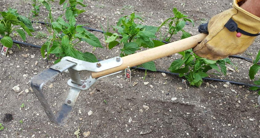

Danjmath Posted May 2, 2018 Share Posted May 2, 2018 My dad really wants a hand-forged push-pull hoe for his birthday, so I get to try something new. First of all, what steel should I use. I have 1080, 52100, mystery-metal in an old lumber saw, and somewhere some 5160 that is really thick and will be a pain to forge by hand. I need to order some steel soon as well, so I could get anything that isn't too expensive. Second, does anyone know a good way to attach the how to a handle? My thought was to use a garage spring, and weld it to the hoe, then weld that to a "cup-sleeve" (I'm sure there is a better term for this) and put a rivet through the sleeve/wood, but am open to suggestions. Thanks! Quote Link to comment Share on other sites More sharing options...

John in Oly, WA Posted May 3, 2018 Share Posted May 3, 2018 Here's a picture of a push pull hoe. Looks like a pretty simple connection to the handle - three rivets or bolts. Quote Link to comment Share on other sites More sharing options...

Kozzy Posted May 3, 2018 Share Posted May 3, 2018 Couple of notes on this because I use one all the time--it's my weeder of choice in many areas. 1) Be sure the profile is designed to allow for easy sharpening. These work 500 times better when well sharpened and DO tend to wear the cutting edge quite a bit. Odd shaped versions can be a pain to sharpen and a simple stirrup shape with fairly square corners is pretty easy. 2) Fairly square bottom corners makes it easier to get close to the "good" plants when whacking out weeds. Those with hugely rounded corners on the "stirrup" are frustrating when trying to weed close to the good stuff. Since weeds seem to have an evil brain, they love to hide close to the good stuff and make themselves harder to get. 3) No matter what you do, the stirrup will come a little loose on the handle over time. Handles shrink, stuff wears, etc. I'd attach it similar to the photo above but use bolts that can be re-tightened as needed--Lock nuts are probably best but you have to chase a wrench. Wing nuts are handy to tighten in the field but that's sort of chasing your tail because they are also self-loosening, even with lock washers. Many versions of these actually have the stirrup a little loose so it can tilt a hair between the pull and push stroke, keeping the blades in a cutting mode digging downward a hair). One common name is "Hula-Hoe" due to this movement. I'm not completely sold on that "action" but it might be something to play with when designing. 4) Longer handle than you think is necessary---shorter handles will turn you spine to pudding quickly so these work best when you can stay in a fairly upright position. Most handle lengths commercially make you hunch over too much. Be sure the angle of the stirrup to the ground matches that upright position fairly well so that it can cut both push and pull without much handle joggling. Oh...and an addendum--handle diameter that works with gloves on. These things are blister makers. Quote Link to comment Share on other sites More sharing options...

Danjmath Posted May 6, 2018 Author Share Posted May 6, 2018 On 5/3/2018 at 1:20 PM, Kozzy said: Couple of notes on this because I use one all the time--it's my weeder of choice in many areas. 1) Be sure the profile is designed to allow for easy sharpening. 2) Fairly square bottom corners makes it easier to get close to the "good" plants when whacking out weeds. 3) No matter what you do, the stirrup will come a little loose on the handle over time. Handles shrink, stuff wears, etc. 4) Longer handle than you think is necessary---shorter handles will turn you spine to pudding quickly Oh...and an addendum--handle diameter that works with gloves on. These things are blister makers. Thanks, great advice. Quote Link to comment Share on other sites More sharing options...
