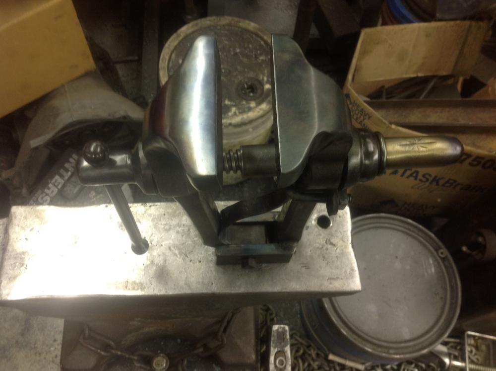

gaylan veater Posted May 6, 2018 Share Posted May 6, 2018 Hi All, I made this small vice several years ago. My reason was also for the experience and I wanted one that would fit in my hardy hole to take with me when I did demos. I started with a piece of 1” square bar and I slowly upset the end until I had a good 4” face that part took some time and patience. I knew it wouldn’t get done quick so I just went with the experience. After the jaws were formed Ibent them at the 90 degrees you could do them at less than that and adjust the jas face to match. I then decided how far down to make the hole for the screw box. I made a slot punch and knocked out the picked then drifted the hole to size. I used a screw from a welding clamp that was bend but the screw was still good and cut off the threaded part to use on the other end. I did not really take any measurements at the time I built it I just did it as I went. Here are some pictures. Quote Link to comment Share on other sites More sharing options...
Horacekincannon Posted May 6, 2018 Author Share Posted May 6, 2018 Thanks for the great pics and info that is almost exactly what I want. And great work by the way Quote Link to comment Share on other sites More sharing options...
gaylan veater Posted May 6, 2018 Share Posted May 6, 2018 Thanks, As a note I used mild steel. If you use 4140 it will be a lot harder to upset but possible. Good luck with the experience. I had a lot of fun and learned a lot as always. Quote Link to comment Share on other sites More sharing options...

Daswulf Posted May 6, 2018 Share Posted May 6, 2018 48 minutes ago, gaylan veater said: Hi All, I made this small vice several years ago Wow what a nice little vise! Very cool. Might have to give one a try one day. That Is a lot of careful upsetting to get that much. Quote Link to comment Share on other sites More sharing options...
jlpservicesinc Posted May 6, 2018 Share Posted May 6, 2018 gaylan veater: nice work.. did you insert the jaws or just leave them mild? Quote Link to comment Share on other sites More sharing options...
gaylan veater Posted May 6, 2018 Share Posted May 6, 2018 I just left them mild. They seem to grip the forged metal better IMO. Quote Link to comment Share on other sites More sharing options...
