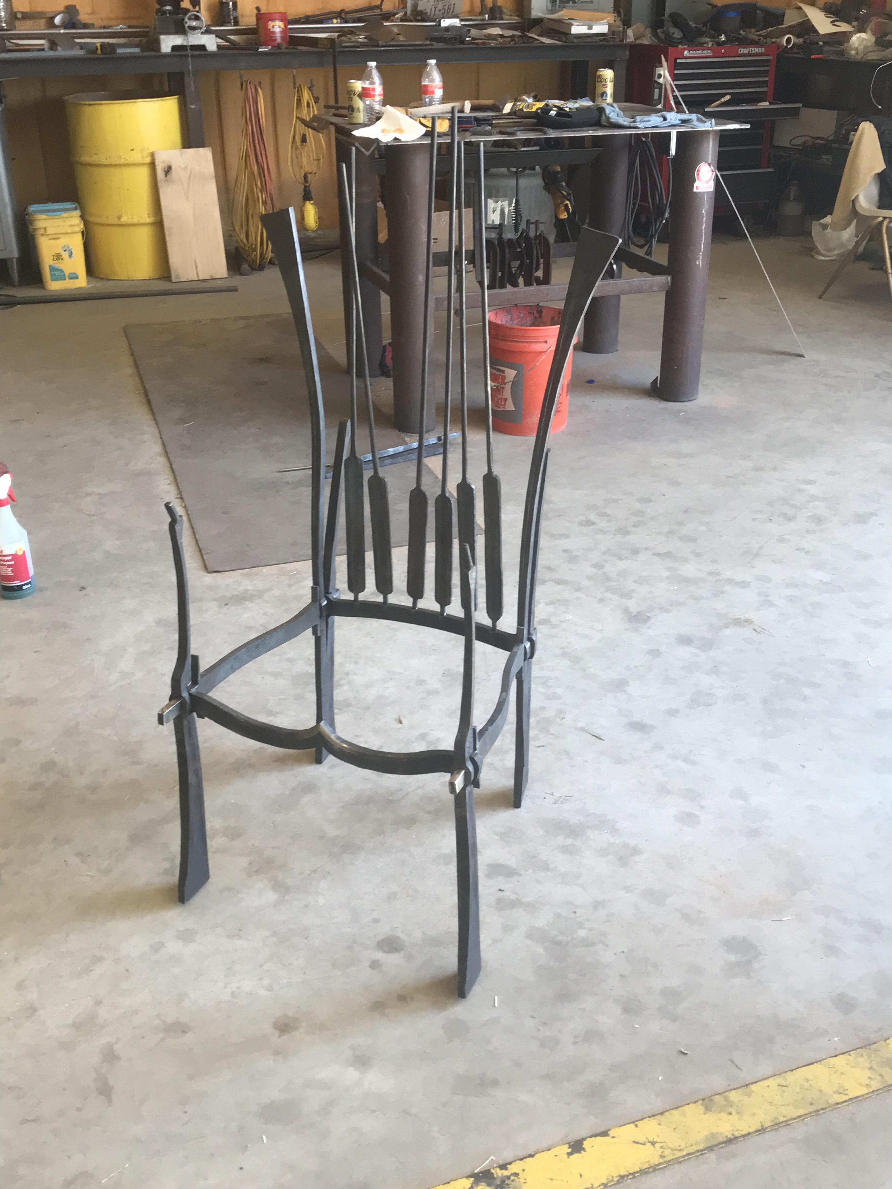

On the recommendation of JLpservicesinc, I’ve decided to make a work in progress thread as I build a forged rocking chair using primarily  traditional joinery. The reason I’m building this chair is for a blacksmithing contest being held May 5-6, 2018. I was sort of press ganged into this contest by some friends but once entered I plan on making the very best go of it that I can. This is by far the biggest and most complex smithing project I tried and to be honest, it is above my skill level. I’m doing my best to rise to the challenge. I’ve had to learn a new process or technique for nearly every part. For some processes I’ve gotten it just right on the first try. For other, it has been numerous days of extremely aggravating, discouraging failure before I’ve gotten the desired result. Unfortunately for everyone, I haven’t got a sketch or drawing to show the desire result, got an idea in my head and working with that. This project is inspired by a chair built by Brett Moten and Tim Cisneros who were inturn inspired by Sam Maloof
I’ll add pictures as things become post worthy and a brief description on occasion. Since I’m on a time crunch, it should get updated every few days.
Not really knowing where to start on some thing like this I decided to start from the top down. Conveniently, I had just purchased a power hammer and we got to know each other working on the top of the chair back. I don’t remember the starting length of 3”x1/2”  0F1CA726-83B1-4F17-A787-E1A86F5DCC5A.thumb.jpeg.358855a574f07578e9ca687dad61f7fe.jpeg

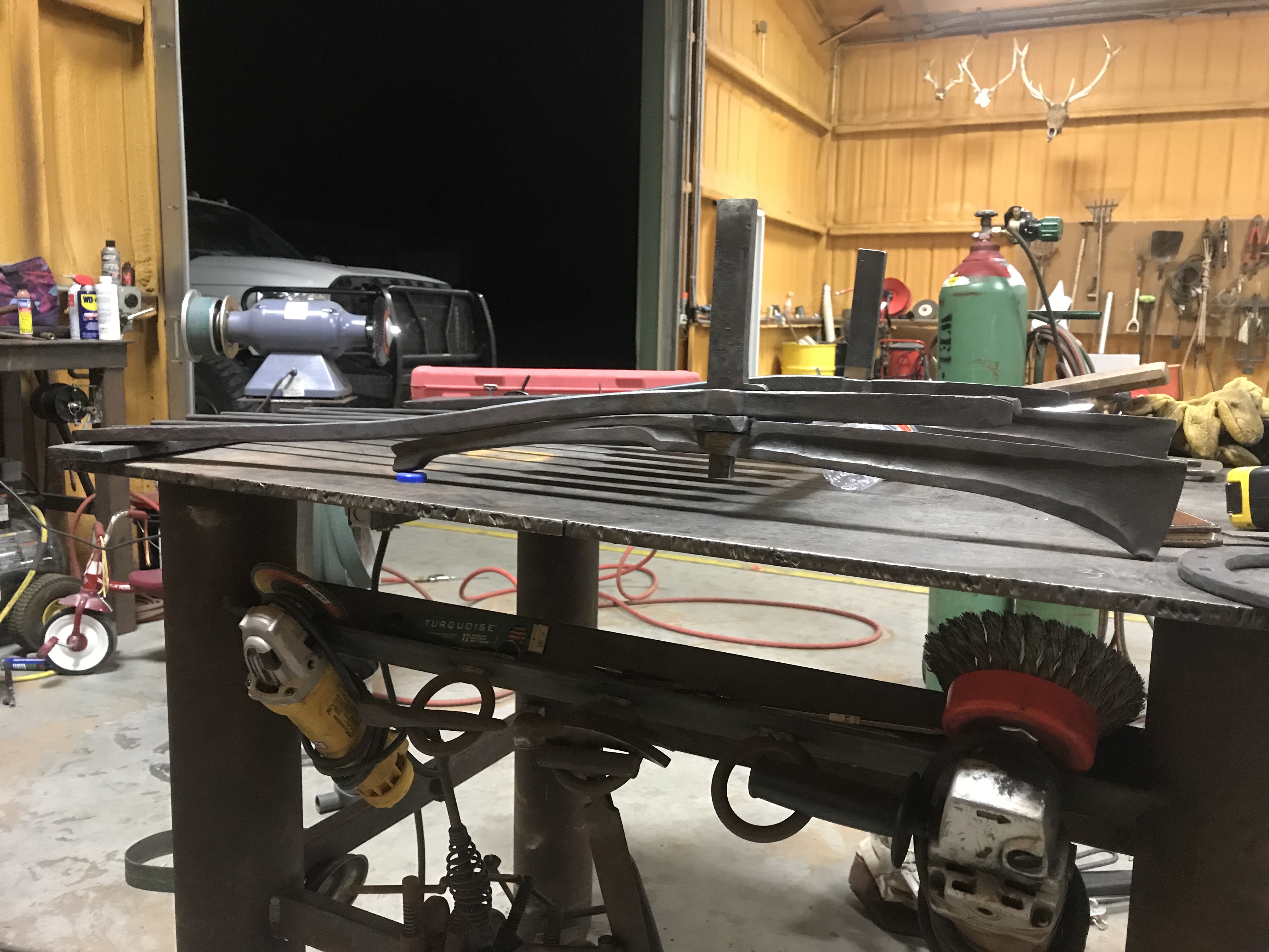

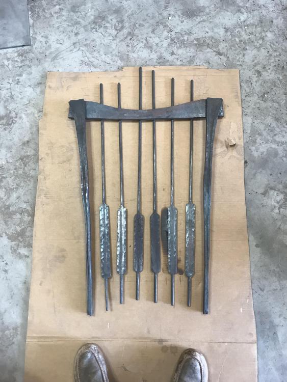

Next I began working on the sides and slats of the back. The slats gave me an incredible amount of trouble. Failure after failure to get the look I was after. I think I had 8 or 9 rejects, some of which are still around the shop. The others were thrown as far as I could and one was intentionally burnt up in the forge. Part of my problem was inexperience using a power hammer. Chair back sides starting stock was 15” of 3”x1/2”. Starting stock for each slat was 11” of 3/4” square.
939B8C77-AFB6-4640-839D-C1FD922F536D.thumb.jpeg.339e171b4451cd22a0d2c3404d0fd570.jpeg8C0C5846-09DD-4843-8775-4771DE13D6A4.thumb.jpeg.3bde7ee3f7aad0bc0c3a6056819c7751.jpeg

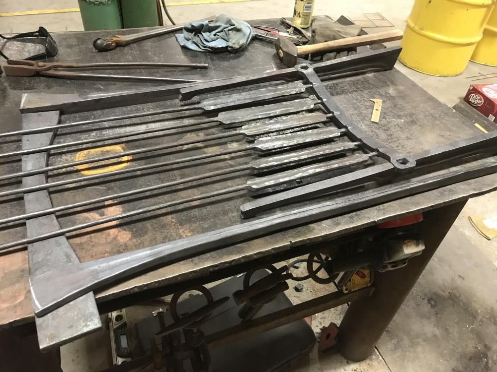

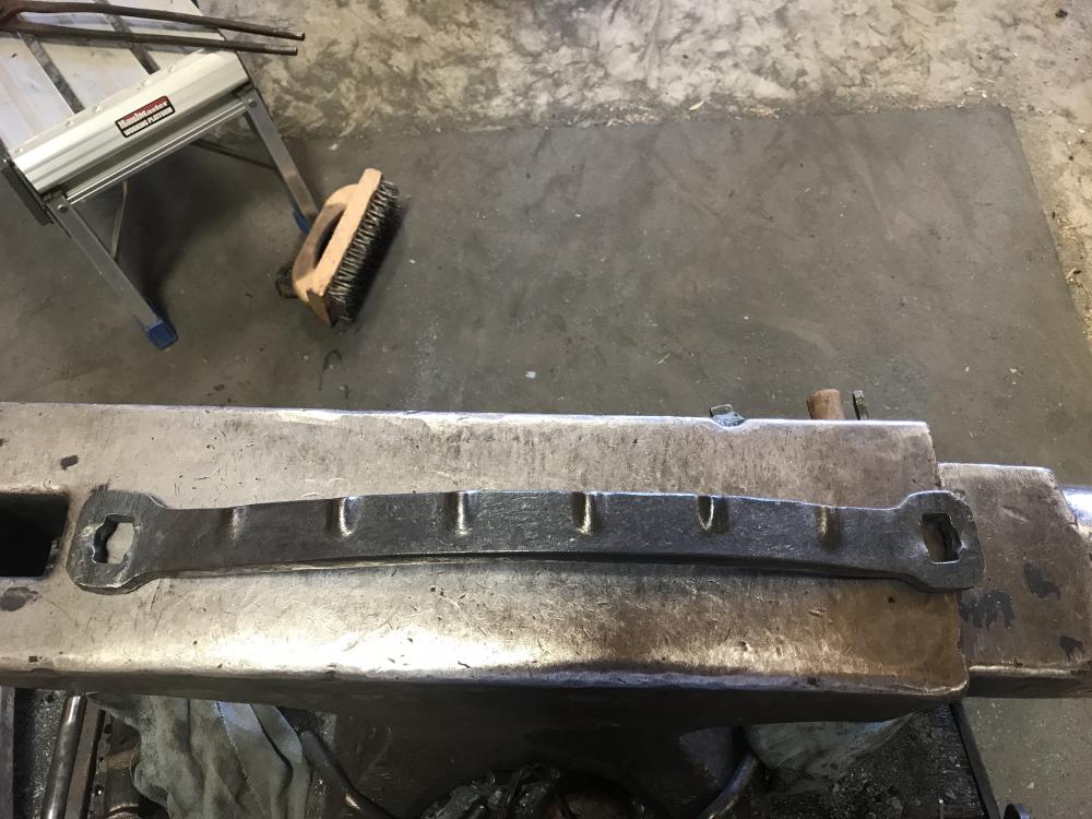

Next I started working on the back piece of the seat that the slats will attach to. I used a slit and drift punch a friend made from S-7 for me. I had to make a 1” slitting chisel and matching drift for the holes in the ends. Starting stock 18” of 1 1/4”x1/2”89B58F42-18B3-4657-B37D-5280B4286BDB.thumb.jpeg.a2ef9bf034e0cde222bbcac596e69269.jpeg8A00B39F-59DC-449B-BCD1-E22C64101DCE.thumb.jpeg.fe45c6fa48d16115a6bc3862778aa8d9.jpeg2BA8B249-F524-4C1C-9AA5-FF27484E283C.thumb.jpeg.acfd6346643326daeddf88fac56f92f5.jpeg4966792C-795C-4BF5-B9CA-DDC68972FF0E.thumb.jpeg.6faa62dc3791d19711576002cbd77aa7.jpeg

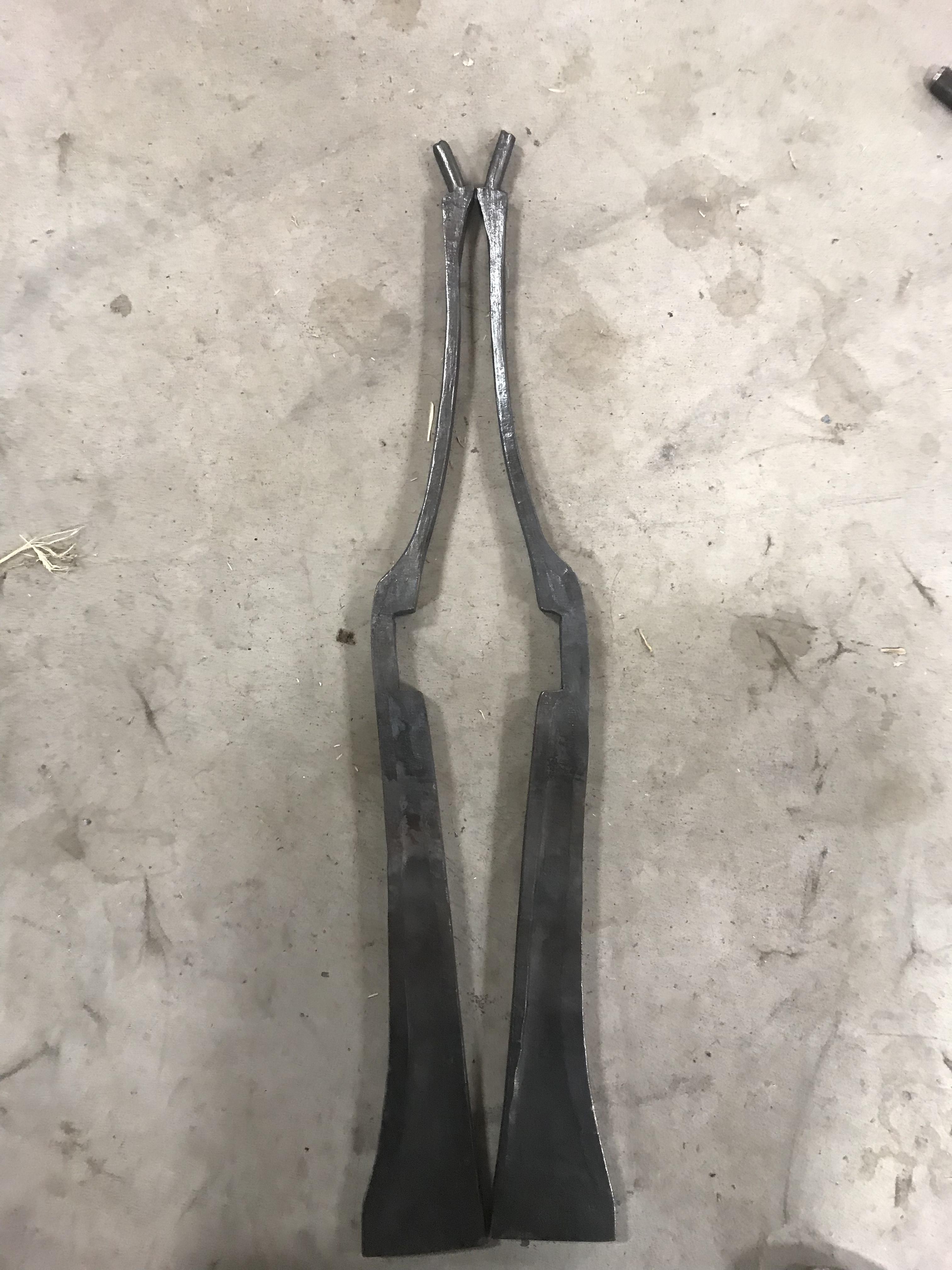

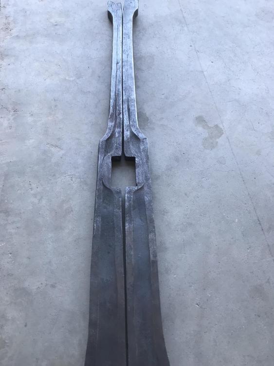

Next was the back legs which will attach to the rockers on the bottom and the seat and back on the top end. Starting stock for legs 11” of 3”x1/2”
38D9FE4E-EB7A-4266-A546-C32097971328.thumb.jpeg.9c8e73c9b174ce0247e7c2bd5b1119b5.jpegEE58EEEA-63FC-46B3-952A-2851B1A19FC8.thumb.jpeg.95b164751d79269825ccad660bf4619d.jpeg22AE7DF8-EF3A-4875-96F3-D2F57DB6319C.thumb.jpeg.93f74f97df652a0f7dd9c27218d837b5.jpeg8B36829B-7365-4A32-B18F-1C9EFC6C921D.thumb.jpeg.8c269204257e1811382d711933e47898.jpeg
Holes have been punched and drifted through both the legs and back stay. Also back stays and back legs have been bent close to final position. No point getting nit picky when I’m so far from being done.
