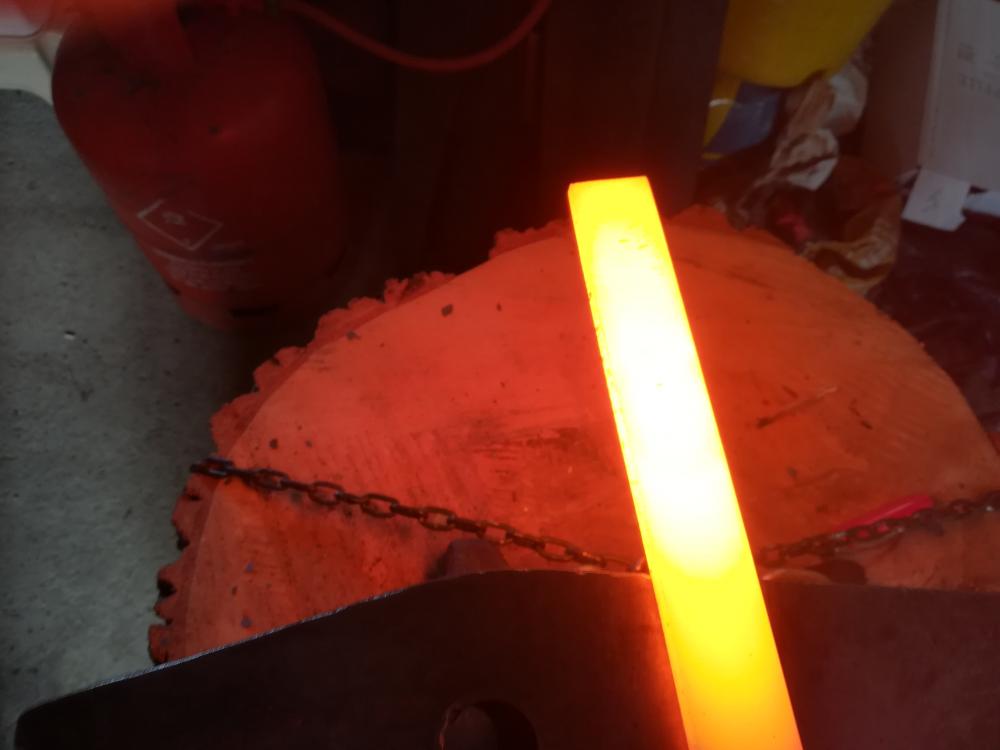

Vandle Posted April 13, 2018 Share Posted April 13, 2018 I've made a few nice blades from O1 steel, but this week thought I'd make some from recycled metal. First off an old file that went well until I noticed a crack in the tang. I heated it again and the tang just fell off. After I cooled the blade and cleaned it up, realised (sorry - UK spelling) a massive crack across the tip was also a problem. Started afresh with a length of coil spring and the same thing happened - small cracks appearing as the blade edge was being formed. Tried a third time to make a letter opener from a small file, and the same thing again. So, I understand the coil spring could have deformities in it already, but three on the trot makes me thing I'm forging incorrectly. Any thoughts? Quote Link to comment Share on other sites More sharing options...
ThomasPowers Posted April 13, 2018 Share Posted April 13, 2018 looks overheated to me. Quote Link to comment Share on other sites More sharing options...
Vandle Posted April 13, 2018 Author Share Posted April 13, 2018 Really? I've tried forge welding and can't get it hot enough - thought I'd need a second burner. It's usually very bright red. I'll try lower temperatures. Thanks. Quote Link to comment Share on other sites More sharing options...
Jclonts82 Posted April 13, 2018 Share Posted April 13, 2018 it LOOKS overheated, but that pitted/bubbly texture may be from too oxidizing of a flame and just excess scale being formed, are you hammering it too cold/when there is no color left in the steel? Quote Link to comment Share on other sites More sharing options...
Vandle Posted April 13, 2018 Author Share Posted April 13, 2018 Sometimes I'm hammering lightly to take out any bending in the steel before returning to heat, but I thought you could tidy up metal when dark? I do have the steel directly under the flare, should it be to one side in the gas forge? Quote Link to comment Share on other sites More sharing options...
Frosty Posted April 13, 2018 Share Posted April 13, 2018 If you're only heating to bright red and it's blistering the surface like that the flame is oxidizing. The excess oxygen in the forge could be burning your steel. The higher the carbon content the lower the melting and burning temperature. Bright red is close to putting it back in the forge temperature, I'm thinking the cracks are from forging cold. We're discussing forge burners in the "Burners 101" thread, if you post pics of your burner in operation we might be able to help you out. A pic in the forge when you light it, one when it's as hot as it'll get. and one across the opening with a dark background so we can get a look at the exhaust. Oh, and a picture of the whole burner so we know what you're working with. Frosty The Lucky. Quote Link to comment Share on other sites More sharing options...

ThomasPowers Posted April 13, 2018 Share Posted April 13, 2018 OK lots to dig through here: You do realize that different alloys require different forging temps; what may be great for one can result in total destruction of another? (Ask me about the first time I was forging H13 and "cottage cheesed" it...) Do you set your forge up to have a reducing atmosphere when forging knives? (and beware of extra CO when using it!) In general DON'T HIT KNIFE GRADE ALLOYS WHEN THEY ARE NOT GLOWING! Are you not leaving the blade in the forge for long times? Working it as fast and in as few heats as possible? (Helps with grain growth, scaling and decarburization.) Break that blade and examine the grain size; large grain indicates too hot for too long. Please show it to us if possible. (yes he's *that* Frosty...) Quote Link to comment Share on other sites More sharing options...

Vandle Posted April 14, 2018 Author Share Posted April 14, 2018 Forge set up with door closed. 6 ceramic kiln bricks top and bottom, two each side, inner lining of ceramic wool and cut down ceramic bricks as inner replaceable liners. Garage doors kept shut to keep things darker. Front entrance when just lit. VID_20180414_105139.mp4 Quote Link to comment Share on other sites More sharing options...
Vandle Posted April 14, 2018 Author Share Posted April 14, 2018 After 5 - 10 minutes with an old oily file. Temperature that I start to work at. When the tip dulls to black and the centre is still cherry red I return it. Sometimes I'll lightly work it black to smooth out any large deformities. Normally, after 30 minutes with the front door down, the exhaust is blue. One final question, i tried welding metal unsuccessfully and found that the Borax turns the ceramic brick into toffee. The manufacture recommended a Zirconium paint, but they only sold it in quantities large enough to do 50 of these forges at least - and at $70 a time. Any other way of protecting the lining from Borax? Quote Link to comment Share on other sites More sharing options...
ThomasPowers Posted April 14, 2018 Share Posted April 14, 2018 Tray of cheap clay based cat litter, As cameras and eyes are not calibrated the same---not to mention monitors and picture software it's very hard to make good estimates on the internet; but you may be overheating for a file alloy; I'd go pie cherry orange and NOT yellow. For true mild steel I love a good yellow and for wrought iron yellow to white usually works well. Quote Link to comment Share on other sites More sharing options...

Frosty Posted April 15, 2018 Share Posted April 15, 2018 The "dragon's breath" flames coming out the forge opening say it's burning slightly rich. It's unburned fuel burning to make dragon's breath. It's probably close enough for now but use it with the garage door open the orange flame says CO is being generated at a high rate. Modern blacksmiths are all head cases, some of us just have a medical excuse. Truth is I had no idea how common head injuries are till I joined the ranks. Frosty The Lucky. Quote Link to comment Share on other sites More sharing options...
