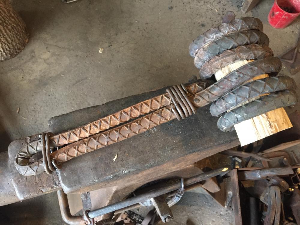

JHCC Posted March 24, 2018 Share Posted March 24, 2018 Walnut’s fine. Softer than maple or oak, harder than pine. Consider an Andy hammer: a metal handle with a holder for a wooden head. Mine is made from rebar and ash: Quote Link to comment Share on other sites More sharing options...

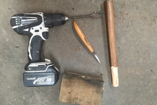

Daswulf Posted March 24, 2018 Share Posted March 24, 2018 You can go simple or elaborate. As long as it gets the job done. Here's a very simple one I made with an old used hammer handle and a chunk of pallet wood. Just drilled the pallet wood most of the way through with a round wood bit and carved the handle to fit the hole and press fit " lightly hammered in" and done. It's still working fine. No glue or anything and it doesn't rotate on me. Same could be done with a chunk of a tree branch. Quote Link to comment Share on other sites More sharing options...
