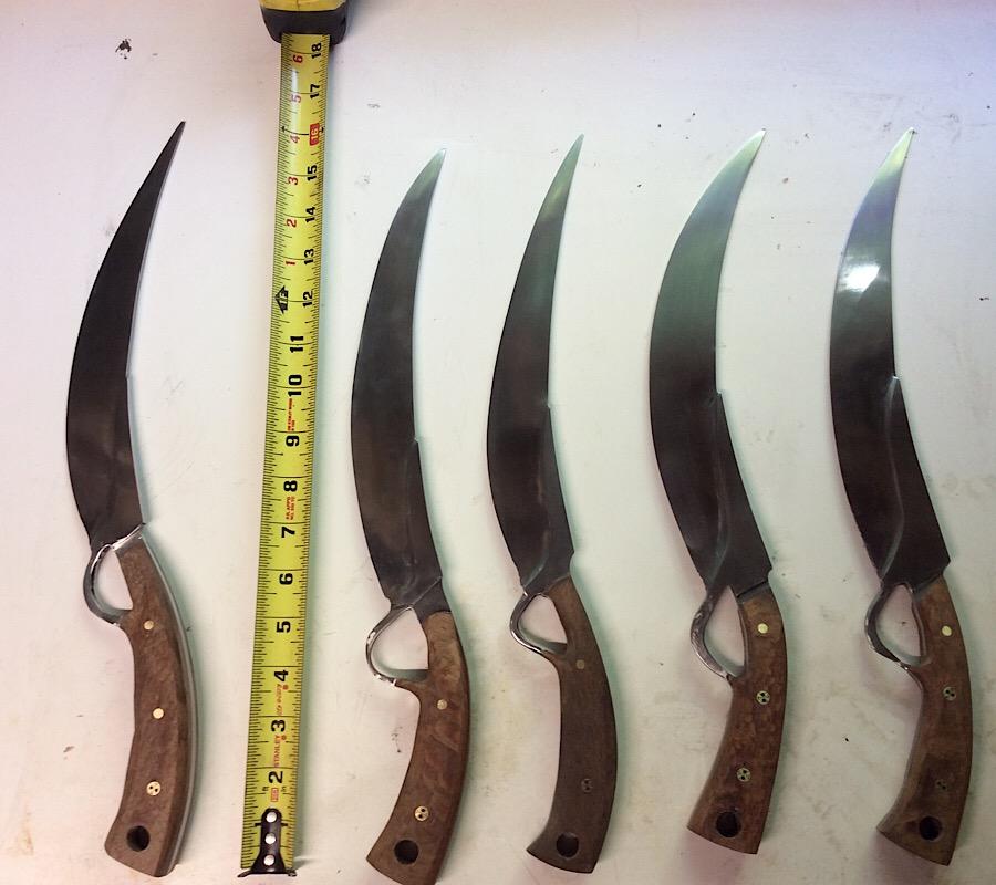

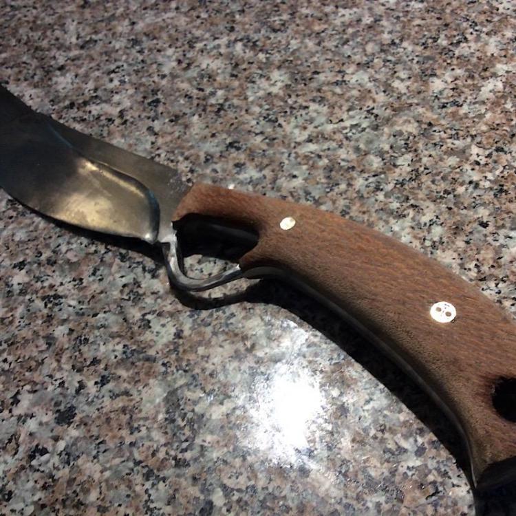

Lou L Posted July 4, 2018 Author Share Posted July 4, 2018 I got the first one handled and roughed out. My friend intends to do some shaping with a dremel so I left it unfinished. The handle is leopardwood. Should look cool when finished. I’m not entirely happy with the shape but it does match his picture...mostly. I made many mistakes making this one and I think the next four will be much better. There is some cleaning and polishing do do on the blade as well...I’m aware Quote Link to comment Share on other sites More sharing options...
Lou L Posted July 19, 2018 Author Share Posted July 19, 2018 I’m as close to done as I’m going to get. My biggest gripe with this entire process has been the impossibility of evenly grinding the blade. I own no tool that can grind those angles. So the areas around the base of the blades have minor but glaring differences in thickness. If I polished to a mirror finish they would create a funhouse mirror effect. I should have kept a notebook on the project to log all of the things I’ve learned in this process. The biggest lesson was mental. I learned that, if I keep my head focused and just get to work, I can accomplish more than I think. I had many moments of doubt thinking I wouldn’t produce anything remotely worthy of being called a knife. These at least earn entry level designation...I hope. My buddy told me he expects highly imperfect work and it’s what he wants. I wish I was aware of his this low bar from the get go.... The handles are only roughed out and ready for his artistic expression. Each was meant to be slightly different but share most of the DNA with the lot. I experimented with handle lengths and hole sizes for different sized people. I also settled on keeping the oblong finger hole. The tighter angles actually made the first one easier to spin...and my buddy wanted them to spin. Quote Link to comment Share on other sites More sharing options...
