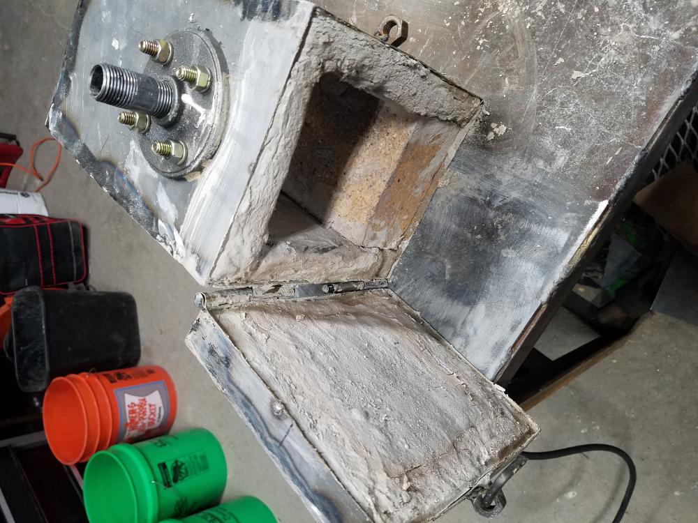

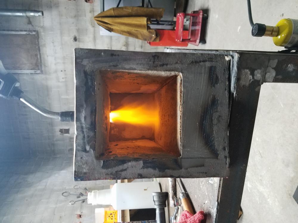

Mellin Posted March 19, 2018 Share Posted March 19, 2018 I am new at this and wanted to add forging capabilities to my metal shop so I decided to start small and work my way up from a soup can forge. Any and all recommendations are appreciated and if I am doing something wrong I always like to know. The soup can is lined with some kao-wool I got from a local pottery store, they did not stock any refractories, rigidizers, or products like plistix or itc 100 however the gentleman kindly advised me of a mix of fireclay with sodium silicate and water. My main concern was stopping the degradation of the kaowool which is evidently a heath problem. I don't have a lot of pictures of the building of the first forge because it was actually really quick and I also think I combined multiple plans. I used a short fatter soup can and drilled 2 holes in the side for mounting to a piece of stock that I had bent a 90 degree bend into and a slightly larger hole than the half inch nipple I use to hold the burner at about 2 o'clock when looking into the can. I lined the inside with 1 inch of kaowool on the bottom and sides using the seam of the side to allow the burner to come into the chamber tucked into the cloth. After I had the can bolted to the stand and the liner in place I mixed the clay, sodium silicate and water to a chocolate milk consistency and poured onto the fabric in a very thin layer which was aided by the thin viscosity of the mix. I took my mappro torch and with the lightest flame setting and dried the surface of the clay then put the torch in the burner port and heated it up to essentially what you hopefully see in my picture. To avoid flames coming out the mouth of the can I have to run the torch on its pretty much lowest setting but It still will get a nail glowing hot in a minute or less. My conclusion from this little can forge is I love working with it but I wanted to be able to work larger stock. So I got working on another project the box forge I added some extra features I thought I would like but I didn't know how to account for the difference in volumes of chambers. I made the case out of 20 and 18 gauge sheet, made a door, handmade the crude hinges and made a base with a white firebrick which I later changed to the lighter style. I have problems with losing too much heat and am pretty sure I would need to upgrade to a real burner setup. Any advice on next steps would be greatly appreciated P.s. that hunk of ash will possibly be my anvil stand Quote Link to comment Share on other sites More sharing options...
Mikey98118 Posted March 19, 2018 Share Posted March 19, 2018 Your flame should be blue; not yellow. You need enough space all the way around the torch to allow secondary air to pass by the torch body, where it can reach the flame; use a larger pipe, and hold the burner in its center with at least three thumbscrews in a line; two lines of three are better. Quote Link to comment Share on other sites More sharing options...
Buzzkill Posted March 19, 2018 Share Posted March 19, 2018 13 hours ago, Mellin said: I have problems with losing too much heat and am pretty sure I would need to upgrade to a real burner setup. Agreed. Take a little time to read through some of the pinned topics in the gas forge section. There are some that deal specifically with the burner to forge volume issue. Without knowing the dimensions and insulating materials of you new forge I can't recommend the burner(s) size, but I can guess that the torch will no longer be sufficient for your needs. The Forges 101 and Burners 101 topics are very active and contain answers to almost any question you can imagine regarding the construction of forges and burners. However, they are a bit lengthy so you need to grab a comfy chair, some snacks, and a cold beverage when you have a few hours to invest in learning the details. Quote Link to comment Share on other sites More sharing options...
Mellin Posted March 19, 2018 Author Share Posted March 19, 2018 Thank you for the responses everyone Its really appreciated. Mikey I am using a 1/2 in nipple and floor flange Buzz as for your recommended reading I am in the process of reading both of them about 5 pages into each there is a lot of info there. My dimensions are 6.5in x 8 in x 8 in with an additional 1 inch deep door in the back that is insulated. For the insulation I believe the gentleman at the pottery store said that it was 8 pound 2300 degree rated. 1 inch around top and sides and a 2.5 inch tall insulating soft white brick. I did get to looking at the forums more and realize my 1 inch of insulation is not preferred. Question am I calculating total forge interior as in 6.5x8x9= 468 cubic inches or am I calculating the volume of the forge chamber which is 2.5x2.5x8=50 cubic inches I'm assuming the former. I would have put in more information and pictures and a bit of a backround on me but I had plans for my anniversary so I had to make the right choice on that one. I have almost bit the bullet and decided to build a Frosty T or "tee" burner. I called the local welding supply stores and they were quoting over 100 dollars for regulator and gauge after I had looked through the forums more I saw a few blacksmithing suppliers who sell the regulator and gauge for half of that. I have the capabilities to drill holes centered I didn't know the comparison between a bernzomatic torch versus a Frosty "Tee" versus a zoeller side arm ill look more into that tonight. I don't know if I have real original plans for a tee burner, http://www.blacksmither.com/wp-content/uploads/2015/10/T-Burner-Directions-finished-1.pd The directions seem SLIGHTLY different than what I have already found on IFI. Also in the link above they connect the burner to the forge body with floor flanges, Question in a frosty tee does the top/tee provide all the necessary air so I don't need additional air intakes like in my current box setup? Does the additional nipple, flange and whatever else inside the case change the ratios? I don't have access to thread protectors what should I use for flare. Note for pictures: this was the first day of building and I have changed the heat sucking brick out from the bottom Quote Link to comment Share on other sites More sharing options...

Mellin Posted March 20, 2018 Author Share Posted March 20, 2018 Update: per Mikey I switched to a larger size inlet pipe and used set screws. The flame changed from yellow to blue and will get a camshaft hot to the core. Also using bricks for front door. Quote Link to comment Share on other sites More sharing options...
Mikey98118 Posted March 20, 2018 Share Posted March 20, 2018 "So far so good..." Seriously, you have done well, but try to build a "T" burner soon, to keep your torch from overheating; they aren't built to be mounted on heating equipment. Also read up on re-emissive coatings, to get more heat out of your forge. The choice of good coatings are generous; ask Wayne how to do the job the easy way Quote Link to comment Share on other sites More sharing options...
