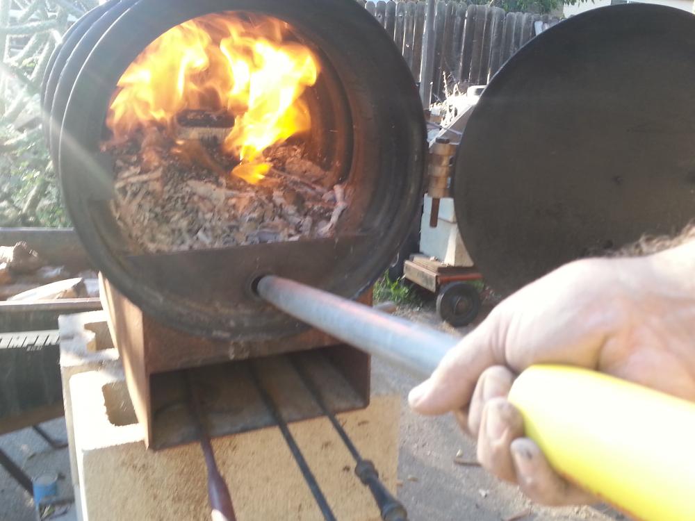

Anachronist58 Posted March 4, 2018 Share Posted March 4, 2018 This is me smelting iron ore with a hair dryer. The only major difference between your setup and mine, is that you don't have nearly enough fuel burning in yours. I started out with raw wood and just kept putting it in there until I had a PILE of coals (charcoal). Fill the thing up! (It can take quite a bit of wood, so just keep going). You can get results from THAT thing, but you will soon want to upgrade to one of the CHEAP and SIMPLE designs found right here on this forum. STUDY. Robert Taylor Quote Link to comment Share on other sites More sharing options...

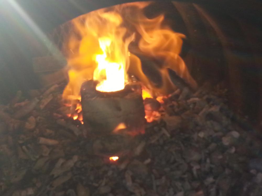

John in Oly, WA Posted March 5, 2018 Share Posted March 5, 2018 17 hours ago, AndrewB said: Hurry up and wait I guess. So, what are you waiting for exactly? A lot of people giving you good advice, but you've only posted one picture of charcoal briquettes burning. No pic of your air set up. No pic of trying to get your coal burning. Hard to help in any detailed way if we can't see what you're doing. You don't need to weld to get the air pipe set up - plumbing fittings screw together. And you don't want to weld galvanized pipe. I've never burned coal - I have a propane forge, but I know, one way or another, I'd get coal burning, if I were inclined to go that direction, even if I had to stick it in my propane forge to get it lit. LOL! Don't know what corner of Thurston County you're in, and I'd offer to help - I have tools, welders, etc., - but you'd have to take a more determined attitude to get it done than you've shown so far. If you have a truck and can haul your set up and coal over, I'm sure we could figure it out and get it going. And a small thing you should've already figured out - ear muffs or plugs for loud noises like shop vacs. Quote Link to comment Share on other sites More sharing options...
