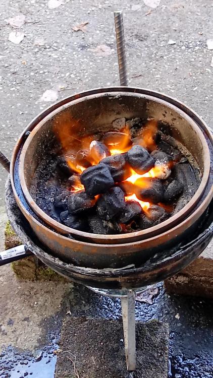

AndrewB Posted March 2, 2018 Share Posted March 2, 2018 So I am at a point where I'm just ready to completely give up. After I picked up my coal this morning and tongs I came home and set up my break drum forge. The air supply was fairly decent. I don't know if I just used too much coal or what not. But basically I've seen a lot of youtube videos on how to start a coal fire forge. I mean even I could figure this out. Should be fairly simple right. Figuratively speaking. How ever, this morning when I tried to light it. To no avail it failed me. So I went to the next step. I used a chunk of wood and some paper with a bit of lighter fluid. To that it simply just did not want to ignite. Before you jump to any conclusions yes I did put an air blast to it, while the wood was burning in a mix the coal. My coal is andecite or how ever you spell that. So as of right now I am just going to step back wait a while maybe it will light for me when it is warmer. Who knows. At this point I am completely frustrated. I didn't throw the forge like I do my keyboard when I get mad at my gaming. So I just calmly set everything aside I doused the coal with water to make sure it wouldn't ignite on me when I came inside. So if anybody has any thoughts on this it would be a good deal. Yes I've read everything I could read in the forums as well. So long story short, my problem is I couldn't get the danged thing light and running. I would have loved to been outside pounding on some metal. (Yes I filled the break drum with coal, which was probably dumb to do but I did it.) Any advice would be greatly appreciated. Quote Link to comment Share on other sites More sharing options...
Daswulf Posted March 2, 2018 Share Posted March 2, 2018 Anthracite coal Is hard to get started but "too much coal" doesn't stop it from burning, lack of airflow or getting a starter fire would. With anthracite coal you'll need to start a fire with some paper and kindling first or charcoal, get that going, start the air lower and build it up as you go and start adding some coal to it then more once that starts going. Then as long as it's burning it wouldn't matter how much coal is on the pile but it would just waste coal. Quote Link to comment Share on other sites More sharing options...

Charles R. Stevens Posted March 2, 2018 Share Posted March 2, 2018 Kingsford is a mix of coal, charcoal, sawdust and clay. And tho it might get the hard coal to light, I would suggest using kindling and just start a small wood fire, nurse it a bit with some larger fuel and then start bringing in the hard coal from the sides. As the wood converts to coals you can increase the air. Quote Link to comment Share on other sites More sharing options...
JHCC Posted March 2, 2018 Share Posted March 2, 2018 Kingsford is a brand, not a type of charcoal; if I recall correctly, they make about half a dozen different kinds. Briquettes can be made to work, but it's not going to work well. Weak airflow is actually good when you're using charcoal. Too strong a blast actually blows the heat right out of the forge, and you end up with lots of sparks and ash, but not much heat in your workpiece. One thing you might consider is getting a nice fire of briquettes (say, 6-8 of them) going, and then using that to get your anthracite started. 5 minutes ago, ThomasPowers said: 31 minutes ago, AndrewB said: How hot should the anthracite coal get once it gets going? hot enough to burn up steel. No, that's how hot anthracite can get, not how hot it should get. Like any forge fire, it should be hot enough to get your piece to the appropriate working temperature. Anthracite can handle the full range from much too cool to much too hot; your desired working temperature will be somewhere in between. Quote Link to comment Share on other sites More sharing options...

AndrewB Posted March 2, 2018 Author Share Posted March 2, 2018 Glenn - Today I think the forge beat me, just like baseball 3 strikes and your out. I had a great bed of coals and the dag gone anthracite coal still wouldnt ignite. So it beat me today, but as stubborn as I am I'm not going to give up on this. The sad thing too is I was a boyscout. Not to mention I am a full fledged pyro. I love fire. So of all people I would have thought I could simply get a fire going lol. Nope beat again. Plus it's a bit windy outside here so that probably wasn't a good idea to begin with. But I think I will take your suggestion and a lot of other suggestions and get some dry wood. I do have some 2 by 4s that I could quite litterally cut up and chunk up. But then I would have to break out my saws all. I didn't save any of the branches that were downed from the wind storms either. I'm now wishing that I would have saved them. Welp back to farming simulator for now and I'll try again with the forge tomorrow or sunday but I can provide a sample of what the forge looks like going. Yes it does get hot with the revamped airflow. Quote Link to comment Share on other sites More sharing options...
Charles R. Stevens Posted March 2, 2018 Share Posted March 2, 2018 You have to have a good blast to get the stuff to light, let the briquettes get white just like for cooking, shake them to get the ash off, add a handful of coals to the top, surround the briquettes with coal leaving plenty of room for flames to escape the top and as the coal starts to light pull more fuel in to the hot center. Takes a bit of patience. Quote Link to comment Share on other sites More sharing options...
John in Oly, WA Posted March 3, 2018 Share Posted March 3, 2018 Well, it looks like you have the start of a good fire going there, but where's the coal? You must only be a half-fledged pyro. A full-fledged pyro woulda stuck it out til it was burning coal. Quote Link to comment Share on other sites More sharing options...
