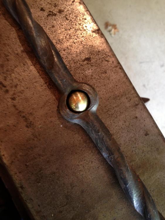

Jim Coke Posted February 11, 2018 Share Posted February 11, 2018 Greetings Mike, You indeed bit off quite a challenge. A few interesting points. The outer frame has very sharp edges . Cold rolled? It also looks like the frame has very sharp corners . Welded ? Would the stand off bend require bending last after assembly ? In the past I have done many pass through elements and have used an Allen set screw ( easily disguised ) to lock the element. I only have one picture of a brass ball set with an Allen but you get the idea. I would enjoy working with you on the build but I’m too far away and getting older. 74 yesterday. Forge on and make beautiful things Jim Quote Link to comment Share on other sites More sharing options...
