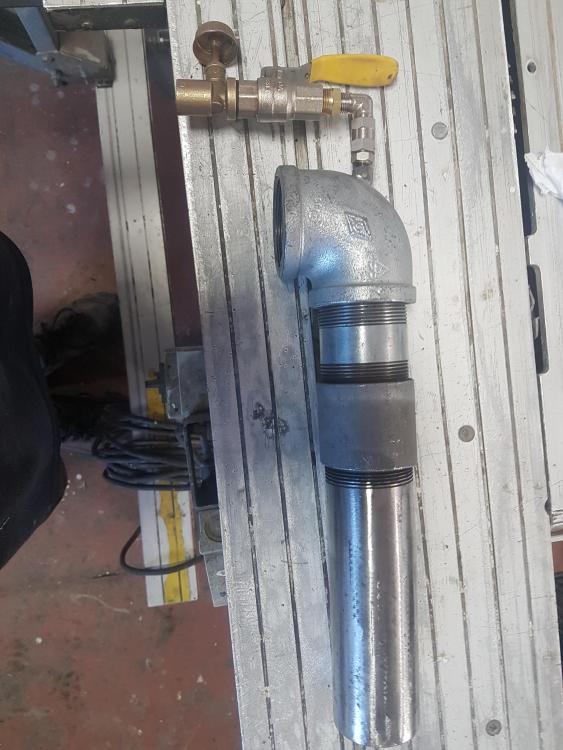

Hi all..
I just made a two inch forced air burner.... I followed the plans of hans peot except  that my gas comes into the tube slightly different ...... I have a 1/16 inch orifice.. .. all the metal tubes are two inch... I have a hair dry as a temporary air supply that blows warm air... I have welded rings that are three inch long at end of burner tube that are I had stainless steel wool at the top of the tube to aid the air gas mix.... the chamber is and I'm South African so it' in millimetres... . 300mm x 100mm x 70mm which I think is 210 cubic centimetres..... I run it at between 1psi and 5 psi with the blower adusting airflow according to gas pressure..... I think possibly the stainless wool might've melted a bit and blocked a bit of the flame holder as it was roaring and then I heard a sound and then it sounded different and when I took the burner out it looked like bits had been welded to the end... I shall attach pics and videos .... let me know if you need more info.... oh and the back door was closed with a cm gap a long the top and front door has a mouse hole..... thanks guys
It is not supposed to be burning inside the mixing tube. The flame holder rings in the one I built with Hans Peot looking over our shoulders were quite short.
I read this as "I built it exactly like the plans but changed them so I didn't build it exactly like the plans, where did I go wrong?"
Is that will not or cannot?
a burn is a balance between the rate the flame will propagate up the tube and the speed the gas/air travels down the pipe. The typical flare on the end of many burners thus creates a gradient of speeds so hopefully one will be stable for the flame.  If you are burning in the mixing tube the gas/air speed is too low. If it blows out off the end too high.

Attached is the plan I'm working too (now).... my question is it says a 2 inch coupling which I have then a 2 inch nipple.... is that the length of the nipple when it is screwed betweeb the coupler and the 90 set bend .... coz i have a 3 inch nipple but a two inch gap.... I haven't seen 2 inch nipples.... my other question is doesbthe position of the orifice matter to much as in how far into the burner it should go....  and should I knock the flame holder out and cut it shorter as @thomas powers 'mentioned

Attached is the plan I'm working too (now).... my question is it says a 2 inch coupling which I have then a 2 inch nipple.... is that the length of the nipple when it is screwed betweeb the coupler and the 90 set bend .... coz i have a 3 inch nipple but a two inch gap.... I haven't seen 2 inch nipples.... my other question is the position of the orifice matter to much as in how far into the burner should it go....  and should I knock the flame holder out and cut it shorter as @thomas powers 'mentioned

The hair dryer is just a temporary thing... my actual blower I am collecting tommorrow.... it' is a jumping castle blower that I'll add a valve to to adjust the flow.... designer didn' specify the steel wool ... someone else suggested it....the designer specified a 150cfm blower....  but I think bottom line is ... it is to big for my forge.... which is fine as I am sure I'll be building another one at some stage...  I did however today made some changes to it so now it is to the exact specs the designer specified .... I took the flame holder / rings out today and it actually melted the back end of the pipes ... this is with the adjustments.... needle valve and changed the entry positin of the gas... Will test in tommorrow morning 20180129_184039.thumb.jpg.436228a47640513e69a8ec23fff38586.jpg
I can' say for sure.... the steel wool is out.. . The gas is coming In at the 90deg bend.... i sand papered the tube to make it shine again now the bottom of the burner tube when I took it out from about 10 mins of burning....was hot but not red hot... and the steel for about 2 inches had gone that hot blue colour .... once it twice while I was adjusting things I would hear like a thump     the flame would go out and then I'd hear a sort of hollow echoey sound. .. I'd swith off gas then switch on and light again.. .. is the only way to tell if it' burning in the tube is when the tube starts to glow?

No the sound is very distinctive.   In my NA burners I can often back out the choke and give a big puff of air and push the burn out the end of the tube.  With my blown burner I was always able to open the gate to the blower to accomplish that.
It didn't happen when inside the forge but rather happened in the vise outside the forge....
