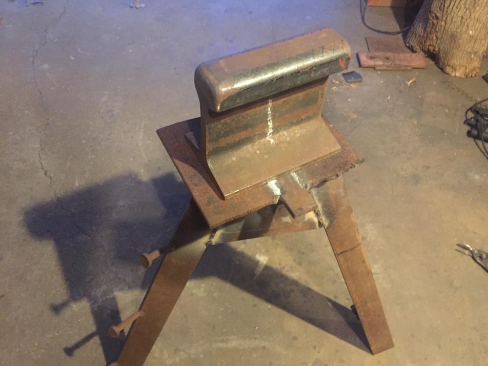

ThomasPowers Posted January 17, 2018 Share Posted January 17, 2018 50 pound chunk of Dozer? plate with 2 1" hardy holes 20 US cents a pound at the scrap yard Quote Link to comment Share on other sites More sharing options...

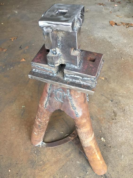

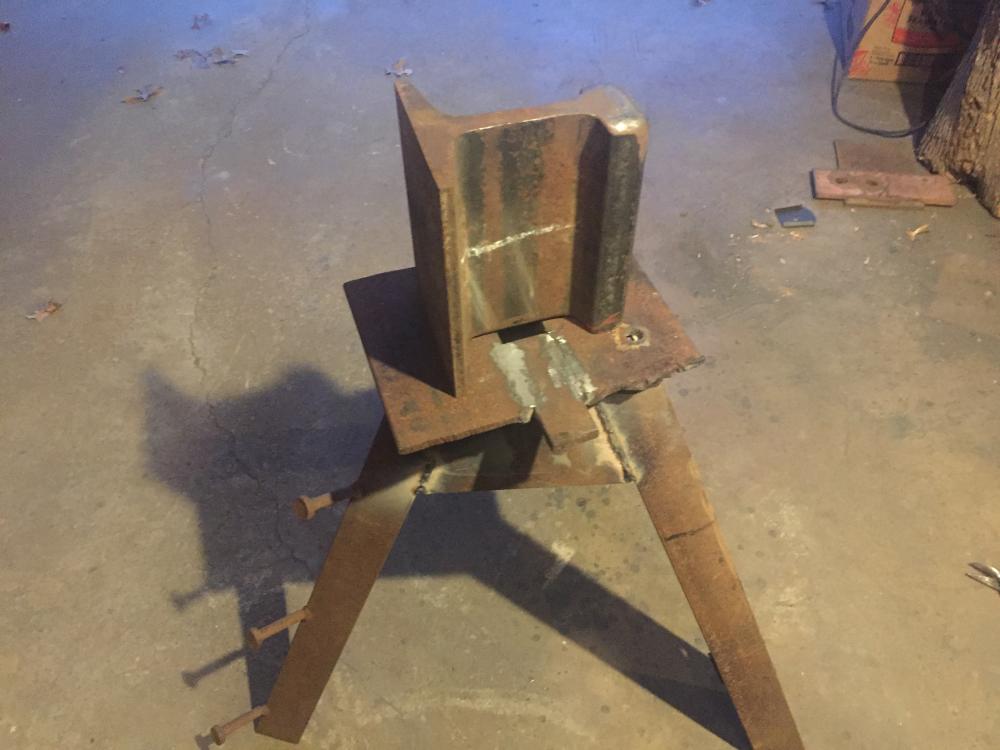

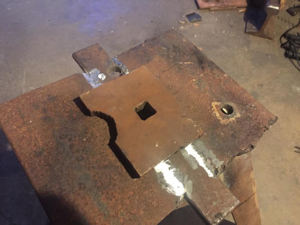

Jasent Posted January 17, 2018 Share Posted January 17, 2018 My first and second one is my striking anvil. Last is my anvil with home made hardy. 1" Quote Link to comment Share on other sites More sharing options...

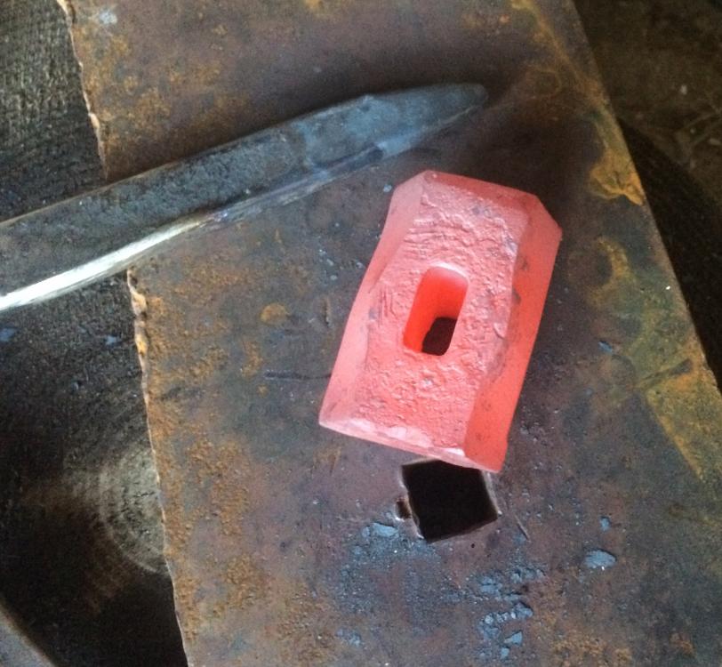

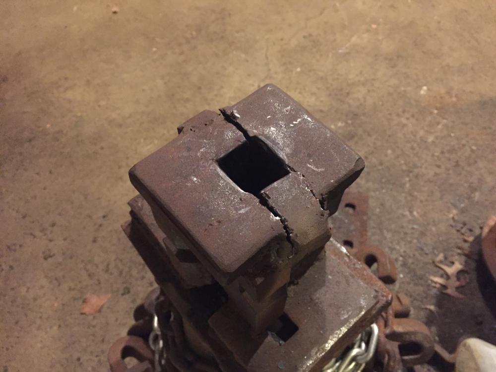

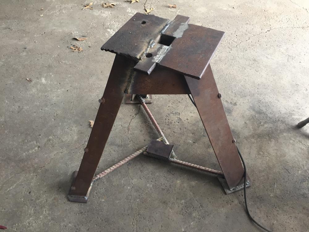

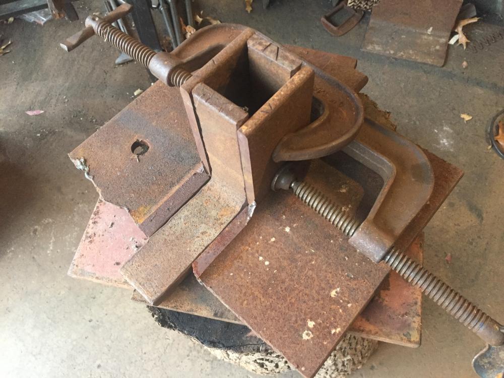

JHCC Posted January 17, 2018 Share Posted January 17, 2018 Here’s my first portable hole: It worked great for a while, and I made a upset a number of tools to use in my anvil: But the welds didn’t hold up. So I’m making a new one. The hole itself is four sections of heavy-duty angle iron welded together: It can hold an adapter for upsetting bottom tools: Or my guillotine tool: I also have a short section of track that can be mounted on top: (Once I finish the mounting brackets.) Quote Link to comment Share on other sites More sharing options...

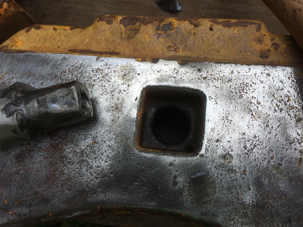

Tubalcain2 Posted January 17, 2018 Share Posted January 17, 2018 Here it the hole I put on my 185# striking anvil. Quote Link to comment Share on other sites More sharing options...
