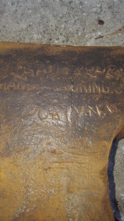

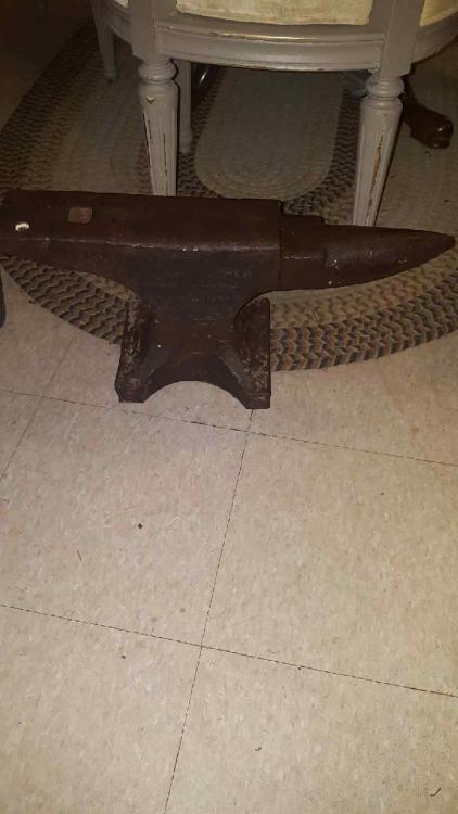

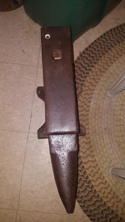

Robcar Posted January 14, 2018 Share Posted January 14, 2018 Looking at buying this anvil wanted to know if it is in good condition 100lb hay budden #10A709 any opinion would be greatly appreciated. The seller is asking $200. Quote Link to comment Share on other sites More sharing options...
Tommytaptap Posted January 14, 2018 Share Posted January 14, 2018 Don't wait-buy it NOW! Quote Link to comment Share on other sites More sharing options...
Glenn Posted January 14, 2018 Share Posted January 14, 2018 That price and condition, get in the car and go. Do a ring and bearing test before you finalize the deal. Quote Link to comment Share on other sites More sharing options...
Timber Ridge Forge Posted January 14, 2018 Share Posted January 14, 2018 one of the best anvil makers out there buy it now Quote Link to comment Share on other sites More sharing options...
Frozenforge Posted January 14, 2018 Share Posted January 14, 2018 Hopefully you already have paid for it and are planning a stand for it! Quote Link to comment Share on other sites More sharing options...
Daswulf Posted January 14, 2018 Share Posted January 14, 2018 Looks like a good anvil. If it passes the rebound test then it is good. Unless you really luck into a deal, $2.lb is a good price in my area. If you want it jump on it. Quote Link to comment Share on other sites More sharing options...
ThomasPowers Posted January 14, 2018 Share Posted January 14, 2018 Rebound and ring test and GRAB it! US$2 a pound is a good deal here in America and Australian $2 a pound is a great deal in Australia. I can't speak to the Hong Kong dollar..."The Dollar is the name of more than twenty currencies, including (ordered by population) those of the United States, Canada, Australia, Taiwan, Hong Kong, Singapore, New Zealand, Liberia, Jamaica, and Namibia..." wikipedia Which is why we suggest folks edit their profile to give a general location... Quote Link to comment Share on other sites More sharing options...
Robcar Posted January 15, 2018 Author Share Posted January 15, 2018 Thank you to all who commented on this post. Anvil passed hammer and ball bearing test giving clear tones and a rebound of 75% to 80% with three-quarter inch ball bearing. Picked up anvil this morning paid $175. Now I have to look at plans for building a stand. Thank you again!!!! Quote Link to comment Share on other sites More sharing options...

Irondragon Forge ClayWorks Posted January 15, 2018 Share Posted January 15, 2018 Ya done good... I'm sure you have already read about not using a grinder on the face of your new to you anvil. A wire wheel on an angle grinder will clean it up fine. From the pictures I don't think it will need that though. Hammer hot steel on it to polish the face. Quote Link to comment Share on other sites More sharing options...
