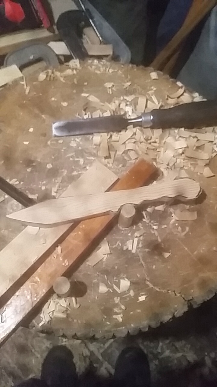

Andrew Golabek Posted January 1, 2018 Share Posted January 1, 2018 Starting from a wooden carving , to sand casting in bronze. 90% copper 10% tin Quote Link to comment Share on other sites More sharing options...
Nobody Special Posted January 7, 2018 Share Posted January 7, 2018 Well, it looks nifty, be interesting to see it finished, know how it works. I dunno, the right kind of bronze is supposed to be roughly hard as mild steel if work hardened. Wouldn't apply to cast though, and I wouldn't try some of the other traditional hardeners like arsenic. Where'd ya get the tin? Solder? Old pewter knicknacks? Quote Link to comment Share on other sites More sharing options...
Charles R. Stevens Posted January 7, 2018 Share Posted January 7, 2018 Their is a reason knives in the historical record are designed the way they are. It certainly is a thought process tho. I think you have made a good start with your experiments. Quote Link to comment Share on other sites More sharing options...
ThomasPowers Posted January 7, 2018 Share Posted January 7, 2018 I buy my tin nice and clean from rotometals.com The trick is to cast the shape that's ready for pounding out and work hardening rather than the shape of the finished piece. Quote Link to comment Share on other sites More sharing options...

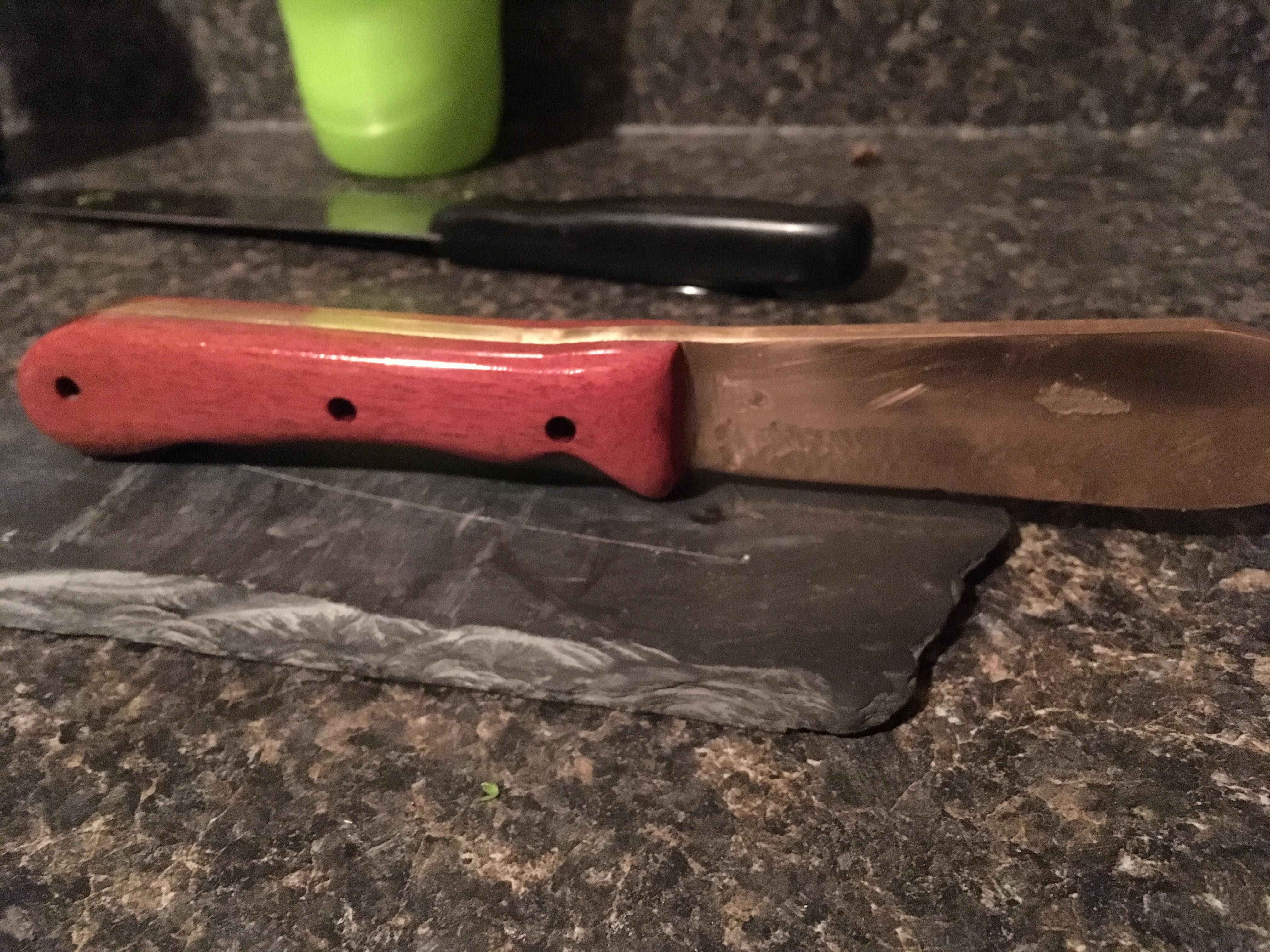

Andrew Golabek Posted January 12, 2018 Author Share Posted January 12, 2018 I got the copper from a nearby company which had pure copper scrap, and the tin from 97%tin solder 3% copper. The edge is work hardened, i made a little jug which you can hammer and slide the edge back and forth to get perfect hits. Im now finishing the handle (zapote) and planning the next one, with a very different blade shape. This one is a bit thick, weighs 318g for a 9.75inch knife. I wasnt sure how strong it would be and left some margin of error for casting. Quote Link to comment Share on other sites More sharing options...
Andrew Golabek Posted January 18, 2018 Author Share Posted January 18, 2018 Here it is, complete with the handle finished, peened 3/16 brass pins, I'm quite happy with it as my first knife of any sort, couple of things to improve for next time though. The edge should probably be further work hardened, I'm going to try 12% tin bronze to see how much harder it is, and maybe aluminium bronze eventually. The handle finishing and flattening the tang to fit the scales was the longest part of this project for sure without any grinder except an angle grinder which isn't ideal ( was flattened by hand). The edge is actually quite sharp, although sharpening by hand seems more difficult than steel- quick and easy to dull it accidentally, so far just been able to get it sharp enough to barely shave arm hair on a waterstone. Will try lansky to see if it's my technique Quote Link to comment Share on other sites More sharing options...

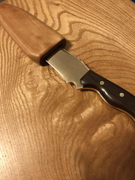

Andrew Golabek Posted March 5, 2018 Author Share Posted March 5, 2018 Just recently finished my second bronze knife, (bday gift for my gf). -increased tin content to 12.4%, is certainly harder and is slightly easier to sharpen - katalox wood handle -currently re-lining my forge/foundry , got some 3200f refractory (unicast 70c)- should be more durable Quote Link to comment Share on other sites More sharing options...

Andrew Golabek Posted November 20, 2018 Author Share Posted November 20, 2018 My latest knife has 13% tin, and 0.1% I think of zirconium added. The zirconium is a grain refiner for this type of copper alloy, and also increases hardness. my casting process has also improved quite a bit, there is zero visible porosity on the last knife. Quote Link to comment Share on other sites More sharing options...

Andrew Golabek Posted November 21, 2018 Author Share Posted November 21, 2018 I didn’t use a degasser, I followed some of the recommendations in the ASTM copper alloys handbook for casting bronze alloys with tin. Some of the most important things I make sure of -the sand must have the proper moisture content, just enough to lend the mold strength, but not enough to cause water and subsequent hydrogen and oxygen porosity -I use ground charcoal for deoxygenation, you can’t add too much. -better results may be obtained if it is the second time melting a piece of freshly alloyed metal (the first time from many small pieces seems to have more porosity) not sure if this is 100% true, but it might be. -cast quite hot, I think around 1100c, when you touch the surface of the bronze it should be shiny and very liquid not viscous and not with an oxide layer. This is very key to casting thin items. -I’ve also tried degassing with a green stick of pine. Not sure how this works but the handbook mentions it and it seems to work. -sprue and gate must be properly formed, follow the guidelines in the handbook, later I can update the exact measurements of mine. Here’s a picture of one mold half. 75 grit silica with 10% bentonite looking to get some 125-150 grit to add in as well for next casting Quote Link to comment Share on other sites More sharing options...
