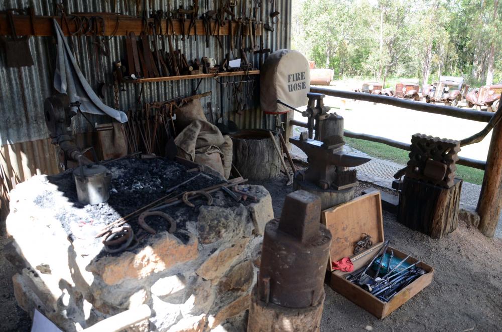

ausfire Posted December 29, 2017 Share Posted December 29, 2017 I have one of those old washing coppers that just happened to fit into a hollow log. Ideal. It's in the far corner of the forge in this pic: Quote Link to comment Share on other sites More sharing options...

stockmaker Posted December 29, 2017 Share Posted December 29, 2017 Ausfire I love your pictures this time of year, here I set today in the middle of an Ice Storm and a frozen quench bucket while you have green trees and sunshine. The old cars in the background are pleasing as well. I bought a 40mm ammo can last month for $15 for oil quenching. Quote Link to comment Share on other sites More sharing options...

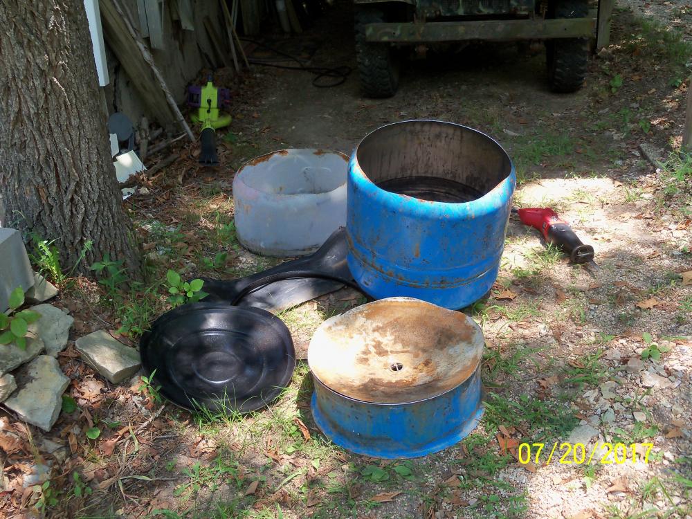

Ranchmanben Posted December 29, 2017 Share Posted December 29, 2017 I cut the top off of a beer keg that was give to me. They’re stainless and pretty easy to come by. Quote Link to comment Share on other sites More sharing options...
