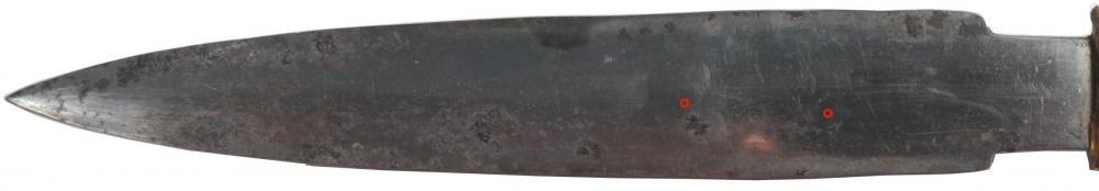

Tried a bit of google foo but no exray found.  article originally published in the Journal of Meteorics and Planetary Science.  you can get an abstract but not the full text without membership or an $1871 annual subscription.  did find a closeup of the blade though showing the two spots where they sampled it.  the abstract says the blade had almost 11% nickel and .5% cobalt.  how would this effect the final product compared to terrestrial iron1364972743_tutsdagger.thumb.jpg.6a3517e2a838bcb34a515077b99ba083.jpg
Well you can consider all terrestrial iron to be meteoritic in derivation; it's just been pre-processed perhaps many times through terrestrial processes...
The stuff that is "directly meteoritic"  is generally a mess to forge with iridium making it particularly hard to forge.  Nickel and Cobalt  are positive alloying elements but usually need to be used in conjunction with other elements to enhance their properties.  (Cobalt increases high temperature strength for instance and Nickel increases toughness---hence it's use in certain, modern, armor alloys)
I think the big item is what is NOT there and that is the ferrous silicates present in bloomery iron and so perhaps being a more homogeneous material.  Of course forging does destroy the Widmanstätten  patterns that are archtypical for iron based meteoritic materials

I know that this is a late addition to this thread but I have always wondered if these early iron objects were made by a process other than forging.  For example, stock removal or casting.  I know that many iron meteorites do not forge well but they may lend themselves to other technologies.  If bronze blades are made by casting and then polishing might some bronze worker have cranked up his furnace high enough to melt the odd lump which fell from the sky and poured it into the same mould as he used for bronze?  This might require some experimental archeology.
The Widmanstätten  patterns would remain if the blade were stock removal and it's been refined out of Tut's blade by forging.
A bronzesmith who could make a fire hot enough to cast nickle iron would've discovered how to make iron and steel. The crystallization from casting would be easily visible on the surface, even after grinding.
Tut's blade predates the bronze age.

IIRC the widmanstatten pattern reflects the crystal structure of the original meteorite.  Therefore, it might not show up unless a stock removal surface was etched by acid or time, just like pattern welded steel does not show its details until the surface is exposed to something to which the steels react differently.
