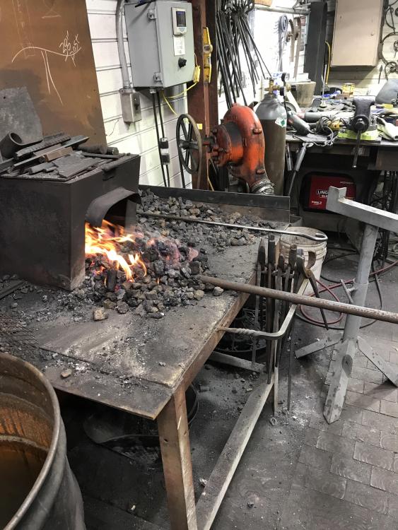

58er Posted November 26, 2017 Share Posted November 26, 2017 Looking to overhaul coal forge as I accumulated enough favors to have Mason buddies brick entire forge and I’d like to make some functional improvements as well. Would like guys opinions on two things. I currently have a 12x9 firepot but it seems small sometimes when I’m doing gates etc. what are the favorite sizes and why. I am doing more and more scrolling and like the coal forge as opposed to gas. Also. Would like to upgrade to a modern blower and would like thoughts on any models. Going to keep side draft hood as I have no complaints I’ve included pics of current setup. Thanks. Quote Link to comment Share on other sites More sharing options...

Charles R. Stevens Posted December 17, 2017 Share Posted December 17, 2017 30” square hearth with a 30” work table next to it, water cooled side last tuyere. Fill the hearth with ash and cinder. Walla, just mold your fire bowl to tast when you build a new fire You might find rearranging things so you work from where the open top drum stands to hep as well, at least when working long stock Quote Link to comment Share on other sites More sharing options...
jason0012 Posted December 20, 2017 Share Posted December 20, 2017 Here is my forge empty so you can see how it is constructed. I think the above suggestion of a side blast forge might be a good way to go. they are easy to build and use and very adaptable. I built this before I had ever encountered one, as you can see it has seen some use. the other two are the forge in the process of packing the bed. Here I am using a mix of old cinders and cat litter, with some fire bricks to fill in big spaces. I think the plans were in the fall/winter '89 Anvil's Ring. Quote Link to comment Share on other sites More sharing options...
