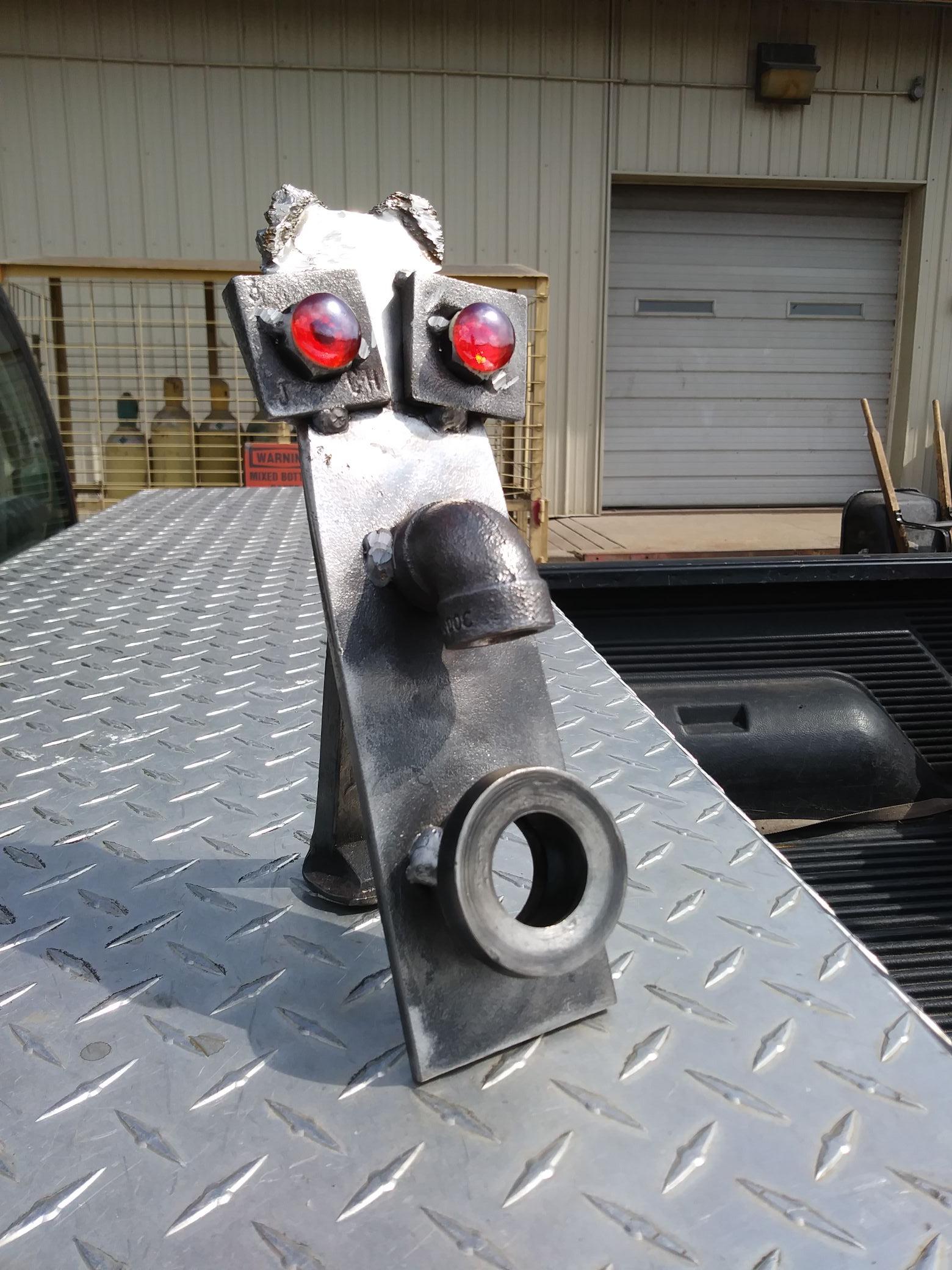

Scott NC Posted May 13, 2022 Share Posted May 13, 2022 If you look at the top of this "sculpture" you will see where something has been applied. It is a "hammer" or "knife" out of a hammer mill for ginding up soybean hulls. Lee, have you any idea what it would be and how it was applied? Quote Link to comment Share on other sites More sharing options...

LeeJustice Posted May 24, 2022 Share Posted May 24, 2022 NoDebt, sorry I did not see your photo and question until now. It looks like probably a hard=faced weld application. Thermal spray applications do not hold up too well to impact and not often exceed a thickness of a millimeter or two. Quote Link to comment Share on other sites More sharing options...
