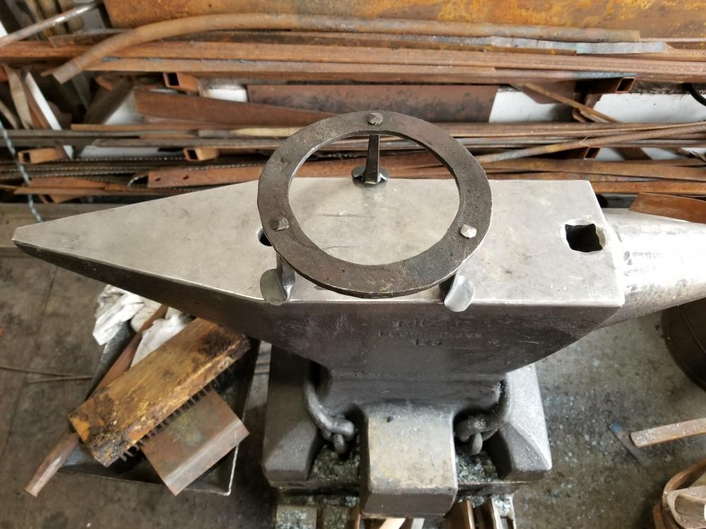

"New Video" How To forge a Non welded Ring, and make it into a trivet..
  • Replies 97
The video still had some editing mistakes in the titles when dealing with PIE Vs PI and 3.17 vs 3.14.. In an effort to correct and keep the information as correct as possible the original video was deleted and an edited version has been uploaded again..
After 60hrs of editing I was seeing double and just about sick of working on it..  Sadly the titles are done for the intro and exit at the very end of the editing process after watching it a few times so usually I'm so sick of watching the footage it's torture so just wanted it to be done..    The PIP takes so long to edit and then to add the formulas it just takes so LONG..
Took 1.5hrs to film and 60hrs to edit the 3 film streams to achieve the results shown.. The miss information was  not acceptable.. So here it is again..
Thanks be to the person who pointed out the errors though.. much appreciated because my eyes weren't seeing anything at this point..
Video link has been updated in the original post.
Or click here to go to the updated version.

Well as we expect a shoe to grow twice the width of the stock, I would expect a ring to grow 3 times

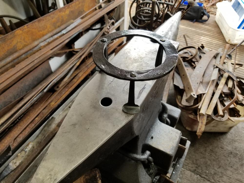

Of course a trivet does not need  a solid circle.  Lap the two ends and punch a sq hole through them and forge a sq tenon on the top of a leg and rivet it together. (square is not needed; really you could just drill a round hole through them and do a round tenon rivet....)
True that, but it would be a different video..
Correct I was just thinking of "How to simplify trivet making for a person with few tools or skills".
