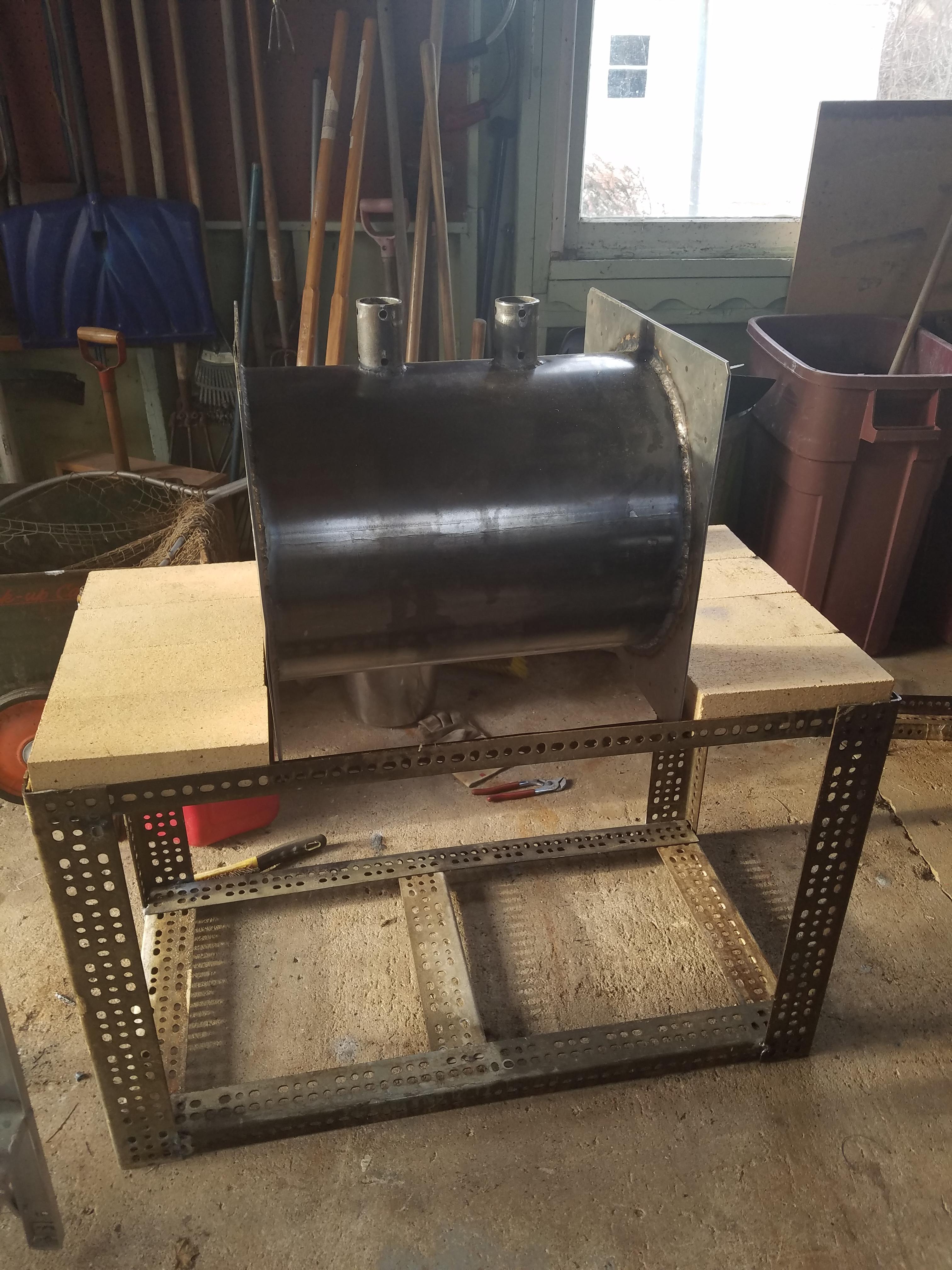

Will42805 Posted April 6, 2018 Author Share Posted April 6, 2018 Ok so i just got my 1" inswool htz. I am ordering Simwool Rigidizer Refractory coating which will be applied to each layer and allowed to dry before placing the 2nd and third layer. I have also decided to apply MIZZOU CASTABLE PLUS rather than satanite as the refractory liner. It seems to have a lot of good reviews from people. I was also thinking of using chicken wire to hold the inswool while its rigidized and as sort of a rebar effect when applying the refractory morter. Any thoughts or suggestions would be appreciated. Quote Link to comment Share on other sites More sharing options...

Will42805 Posted April 23, 2018 Author Share Posted April 23, 2018 Inswool htz 2in. front and back 3in. around and rigidized with simwool rigidizer sprayed on. Waiting on my bag of castolite 30 plus. How stiff should the rigidizer make the inswool. Thanks Quote Link to comment Share on other sites More sharing options...
Will42805 Posted April 23, 2018 Author Share Posted April 23, 2018 Also i have 1" id black pipe with stainless coupler inside. I was going to use modifide reil burner on top but might pick up stuff to make dual t burners and attatch valves to throttle incomming air. Thoughts This should also give me the option of running only 1 burner without chimney effect. Internal dimmentions of forge should be approz 7" diamiter and 14" long. Obviously a little less after coating with kastolite and pouring bubble alumina floor Quote Link to comment Share on other sites More sharing options...
Frosty Posted April 23, 2018 Share Posted April 23, 2018 Looks like a vault! Vertical burners will enjoy the chimney effect regardless unless they're running. Are the couplers visible inside the forge your burner nozzles? If so they need to be pulled back or they'll burn up in short order. They only need to be approx 1/2" inside the shell. And the ceramic blanket in the burner ports needs it's coating of Kastolite to protect it and YOU. This also lets you turn the 2" of liner into a tapered forge nozzle. Hmmm? I've stopped getting my calculator out to determine forge chamber volumes a while back so telling us the ID x length doesn't indicate how well your burner numbers or positions will work. I'd skyball estimate is as a bit over gunned but that's a good thing , you can turn them down. I recommend trimming and feathering the sides of a little ceramic blanket to make the floor and giving it a bit thicker coat of Kastolite, rigidized of course. This saves time and money, you'll have blanket trimmings that'll work perfectly well and not putting a lot of Kastolite on the floor will not only lighten your forge (for your back) and will crush the blanket under it less or not at all. The blanket being thicker directly under the burner means extra insulation right where it'll do the most good. All in all it looks like an excellent build. Well done. Frosty The Lucky. Quote Link to comment Share on other sites More sharing options...
Will42805 Posted April 23, 2018 Author Share Posted April 23, 2018 Thanks. I left the burners a little lower to account for the castolite coating to be applied but will recess them a little further. The burner tubes are snug to the inswool but i did rigidize inside. Should i pull the burners and enlarge them a little to also get kastolite to coat inside the burner holes. Also im not sure what you mean by feathering but i see how i could lift the bottom of the last layer and insert a small piece to flatten out the floor and add a little more insulating value where the burners will hit.. how firm should the wool be after being rigidized? Thanks Will Quote Link to comment Share on other sites More sharing options...

Frosty Posted April 23, 2018 Share Posted April 23, 2018 Pull the burner nozzles almost ALL the way back through the insulwool. Enlarge the ports (burner holes) enough to apply a layer of Kastolite or the flame will melt the insulwool in short. order. When spraying rigidizer on blanket spray it with water first so the rigidizer doesn't flash dry on first contact. This will prevent a thin crusty surface, you want the rigidizer to penetrate a ways. Feathering the edge means thinning it so it meets the wall smoothly. Same for spackling a wall repair or Bondo on a car, you don't want a sharp line at the edges. The wall or car you want invisible boundaries. In a forge you want a reasonably smooth flow in the flame. Sharp corners, wrinkles, etc. can cause flame shadows = cool spots. Make sense? Frosty The Lucky. Quote Link to comment Share on other sites More sharing options...

Will42805 Posted May 11, 2018 Author Share Posted May 11, 2018 Finally got my kast o lite. I havent found much info on the consistancy it shold be when applied. I assume the concistancy of moarter. Sort of like a McDonald's shake. So approx. What consistency should it be.. also i will be applying several thin layers. Quote Link to comment Share on other sites More sharing options...
Frosty Posted May 11, 2018 Share Posted May 11, 2018 The manufacturere's recommendations if you want to hunt them up on the website are really stiff but that's for max strength. We're not making industrial furnace walls to make it wet enough to work but don't get carried away. Mix it like you were kneeding dough, just stirring doesn't work very well, I used an old SS spoon and mashes it around, the more you mix it the wetter it behaves but it stiffens back up quickly. Kastolite isn't the easiest castable refractory I've ever used. Next time I'm casting it rather than plastering with it. Frosty The Lucky. Quote Link to comment Share on other sites More sharing options...
Will42805 Posted May 13, 2018 Author Share Posted May 13, 2018 Finally got my kast o lite. I havent found much info on the consistancy it shold be when applied. I assume the concistancy of moarter. Sort of like a McDonald's shake. So approx. What consistency should it be.. also i will be applying several thin layers. So much for the several layers. Its done. But approx 1/4 in layer. Ive run a wagner heat gun in it for about 15 min at a crack. About how long should i wait before fireing the burners for the first time? Quote Link to comment Share on other sites More sharing options...
jlblohm Posted May 13, 2018 Share Posted May 13, 2018 These were the instructions that came with my kast-o-lite from Wayne Coe. Not much to it just add a very little amount of water at a time. It really doesn't take as much water as you would think. Quote Link to comment Share on other sites More sharing options...
Idk Posted May 13, 2018 Share Posted May 13, 2018 Per manufacturer instructions it requires just over a gallon of water per 55 lbs. So, for 5 lb.’s, that would be right at 16oz’s of water. I’d only add 10-12oz,’s to start. Put some rubber gloves on and mix by hand thoroughly. Add the remaining 4-6 oz’s as needed. I stop adding water of the required amount once the KOL achieves a compressible form by hand. Holds together without falling apart. If you going to trowel on a 1/2” layer you’ll more than likely need the full amount of water required. Once it’s set up for 12-16 hours, pritz it w/ a spray bottle of water. I always let the stuff sit up for a few days after casting and unwrapping to allow whatever moisture still in it evaporate before firing. Just treat it like you would concrete. Per manufactures recommendations: It’s not to be cured out any faster than 104* for certain specified amounts of time but as long as you take it slow and easy you should be fine without any cracking developing. Side Note: KOL can be sanded and polished to a smooth finish if desired. Make sure you wear a respirator and do it outside with a good strong fan blowing the dust away from you and your shop. Quote Link to comment Share on other sites More sharing options...

Will42805 Posted May 14, 2018 Author Share Posted May 14, 2018 Quote Link to comment Share on other sites More sharing options...

MotoMike Posted May 14, 2018 Share Posted May 14, 2018 That is a beauty. built to a high standard. I had a mouse hole about that size, a bit bigger actually and found it too small for many of the things I wanted to do. your forge will be quite efficient with that much insulation. looking forward to seeing it up and running. you mentioned earlier that you were going to use Reil burners. what did you ultimately choose? Quote Link to comment Share on other sites More sharing options...
