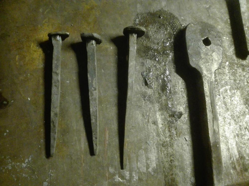

c.baum Posted October 30, 2017 Author Share Posted October 30, 2017 Successfully made some nails and a nail header today (you may now imagine me grunting like a real man). Still not sufficient, but i hope i'm getting better. Quote Link to comment Share on other sites More sharing options...
jlpservicesinc Posted October 30, 2017 Share Posted October 30, 2017 congrats.. You decided to drill than punch the header?... Quote Link to comment Share on other sites More sharing options...
c.baum Posted October 31, 2017 Author Share Posted October 31, 2017 Yes, i first drilled a hole and then punched it. Works too, but if you have a close look at the shank you see it. Additionally you have to keep in mind that you have to drill the hole smaller than the desired shank size. I did not. Next stept will be a nail header beeing punched completely. Lesson learned... Quote Link to comment Share on other sites More sharing options...
jlpservicesinc Posted October 31, 2017 Share Posted October 31, 2017 Nothing wrong with what you did. It's a functional tool.. Unles you drill way undersized that pesky rounded broached look won't go away.. Only way is to thru punch it like in the how to video.. Quote Link to comment Share on other sites More sharing options...

bigfootnampa Posted November 17, 2017 Share Posted November 17, 2017 Okay. Here’s a few of my nails. These are nothing special, just general stock. The longer ones are about 4”. I’m not a highly experienced (or therefore, skilled) nail maker. My nails do amaze me with their performance though! What I am saying is that there is no payoff for me in making many thousands of nails that are as swiftly made as I can do them... I’d still be working for pennies! When I can make nails that are able to function as permanent joinery for softwood furniture that also fit into a rustic design theme... NOW I’m being rewarded for my time! Sorry, I don’t have any of my special use nails at hand... they’ve all been used in the projects that they were custom forged for. I’ve posted some in the past but the files are buried now and I haven’t the time to dig them up. Quote Link to comment Share on other sites More sharing options...

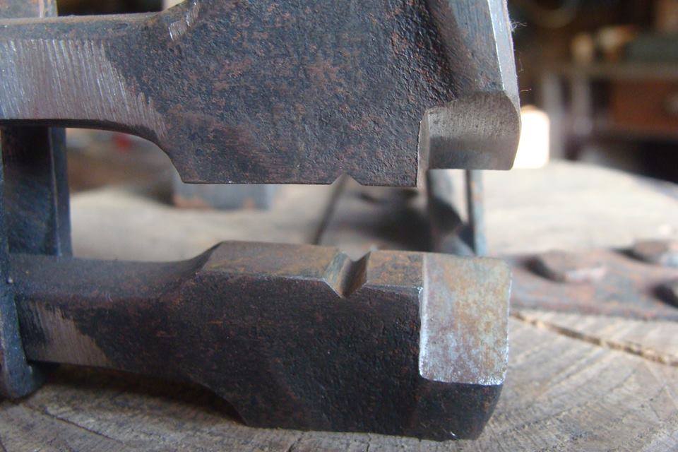

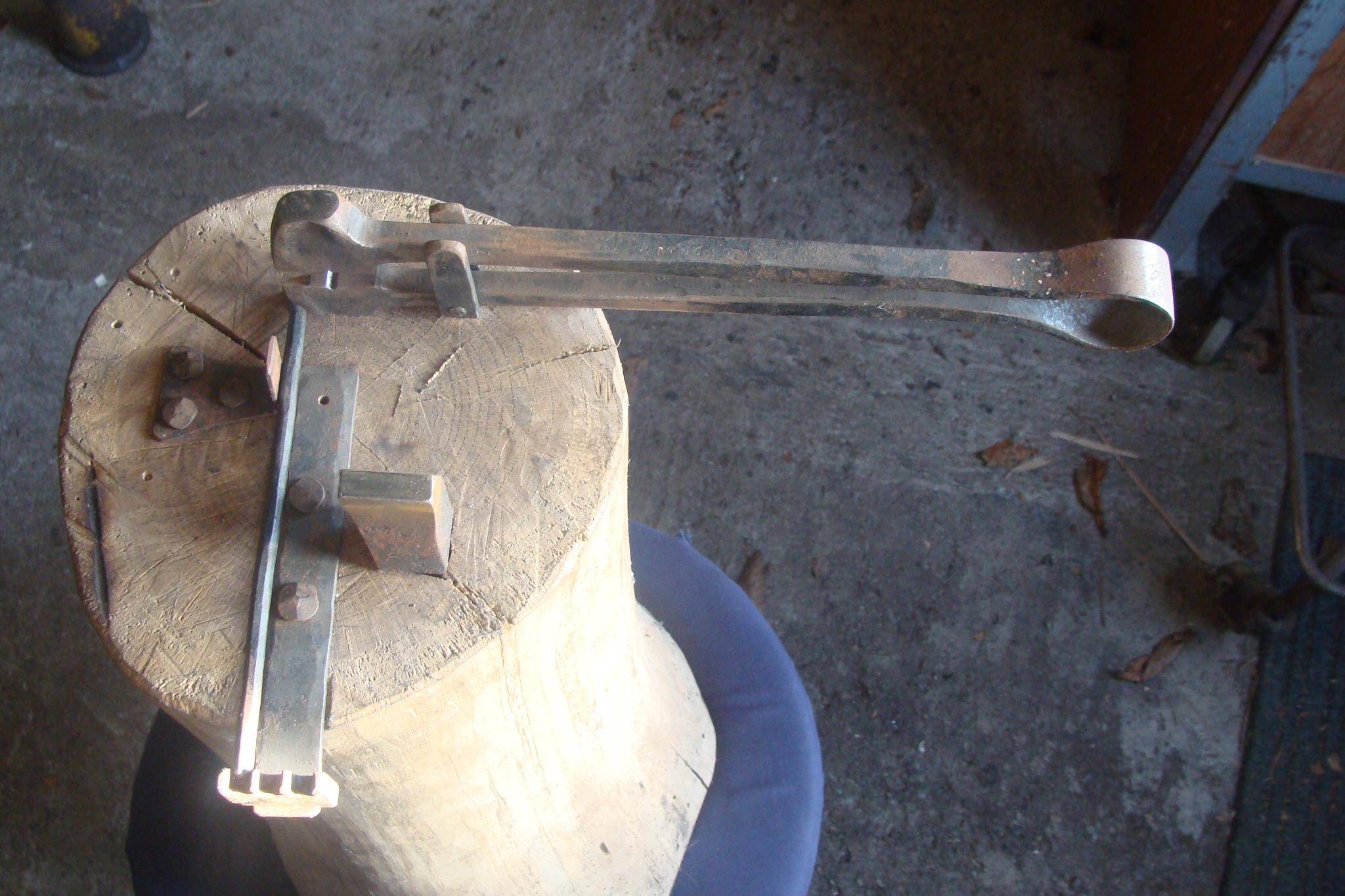

VaughnT Posted November 24, 2017 Share Posted November 24, 2017 The neat thing about making nails is that you can get good practice at a valuable skill (making tapers) for very little money invested. It's no wonder, JLP, that you found all those nails to be so perfectly matched since the person making them was likely a full-time maker of nails, or at least making nails as part of his duties at the smithy. When you've made several tons of something like that, you get to where you're very repetitive in motions and the resultant finished appearance. There's a fellow on FB that I follow, and he does some great work with making nails. The best part is the little jigs and such that he sets up so he can make nails rather uniform. I never thought about putting a rest on the stump to help control the bar stock you're using. Seems to me that it would make it a lot easier to control the length you're cutting at. And the two or three "dies" in the one little spring swage lets you go from raw stock to ready for heading in a blink or three. I'll try to find his page and put in a link so you can see all the various ways he goes about it. This spring swage seems sized for only making small hobnails for traditional footwear, but I'm sure it could be scaled up for other nail styles. Quote Link to comment Share on other sites More sharing options...
jlpservicesinc Posted November 24, 2017 Share Posted November 24, 2017 In the older days in the USA a good majority of the nails produced were as a cottage industry at piece work with Woman and children making a good majority of them.. They actually had a guy (Nail Monger) who would come around and supply you with a nail makers anvil with cutoff and a supply of materials.. the people would lease/rent this from the guy (I'm sure at a hefty price) and he would then pay them after the rental lease fee and leave more raw stock.. When in good forging shape a 10 penny 1.5" -2" length shank, 1/8" shank thickness takes a full minute to forge and head.. I used to run 3 to 4 bars at a time.. 1 heat per nail... Eventually you get good enough What really gets forgotten about nail making is they used to be made from wrought iron and since they were forged down into a small size the wrought was pretty well refined by the time it got to size.. so a a lot of the heading operations could be carried out in the black heat stage.. the majority of nails forged from wrought have the typical separation of the fibers in the heads on the edges unless the nail heads were swedged like slate nails, tacks, brads, horse shoe, oxen shoes, etc, etc.. There was of course a whole nail making industry in the UK, but they were a costly import and I think that is why the cottage industry took hold.. Eventually Benjamin Franklin produced and Iron slitting mill and this lowered the cost slightly as sheet could be cut into strips... Today, most modern hobbiest smiths don't really realize just how mundane the old blacksmiths job really was.. Most smiths in Rural new England (funny to think Ohio was the wild west) were part time unless they lived in larger industrial towns or were at a cross roads with lots of traffic and these guys would specialize in Farrier work and wagon repair as well as the other little jobs that came in.. When I was producing hardware in sets of 10 or more it really just became a grind.. Same thing over and over and over again. (this is how one gets good though). and then figure that for each thumblatch with escutcheon plates was 12 nails each.. 120 per order with 2 different sizes usually about 3/16 difference between latch and back group and length depending on door thickness. Being a full time smith like this takes some dedication to the craft because it's not a glorious profession and the only person who knows the quality of wears you are producing is the smith him/herself.. What I have seen happen is there are a lot of people who will use to good advantage spring swages, hardie swages etc, etc, in order to get to a consistent product in a fairly short order.. I understand this from a time stand point.. But being a purist at heart still leads me back to grunting it out at the anvil until it is mastered 100%.. At that point all the contraptions are no longer needed as it is just as fast to not need thees other things to produce what can be done with hammer and anvil... By the way.. back in my youth, I tried all sorts of schemes to make things quicker or better and since I didn't have anybody to tell me "No" that is foolish I tried it all.. found I was wasting a lot of time building machines and tooling only later to throw them into scrap.. The only tool that I found sped up any kind of production was a power hammer for the type of work I was doing and it saved a lot of yelling at the sledgers.. Which in some situations still work better than a power hammer.. there is a ton of interesting thoughts with people putting a lot of their thoughts into production.. More power to them.. This is going to sound corny... I am a blacksmith with a desire to forge metal by hand.. Using a power hammer can increase production and make it so I am not killing myself on larger sized stock.. This that said, i'd rather forge 99% of what I make to size by hand than to rely on a contraption to only save a few seconds at the anvil.. For people who embrace technology or contraptions they are at a different level.. for me it's anvil, hammer, vise and forge that I want to be at home with.. I'm really old though and long for a past live which never existed.. Quote Link to comment Share on other sites More sharing options...
