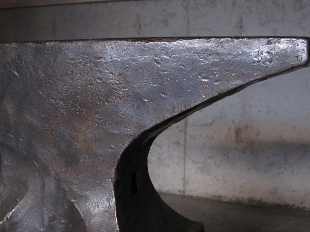

tagheuer Posted October 17, 2017 Author Share Posted October 17, 2017 As promised, below are photos which show damages on the face. At this moment I'm not too sure yet on what to do with this damages. I'm open to any advises you guys have. Thanks in advanced. Quote Link to comment Share on other sites More sharing options...
SLAG Posted October 17, 2017 Share Posted October 17, 2017 Use the anvil. Work around the damage. I presume that you did a rebound test on the anvil in many places and it is ok. SLAG. Quote Link to comment Share on other sites More sharing options...
