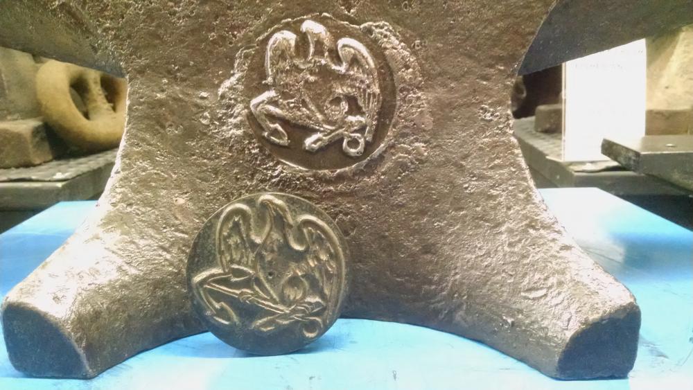

njanvilman Posted October 5, 2017 Share Posted October 5, 2017 Fisher was one of several companies over the years that made these anvils for the Blacker Hammer. The Fisher versions weigh just under 500 lbs. I have two in the Fisher & Norris Factory Museum here in central NJ, and the weights on both is about 485 lb. While intended for use with the power hammer, many people have repurposed them for general smithing. The only factors that make this a small challenge is the very thick heel area, and getting use to the notch. And at almost 500 lb, moving the anvil. Some Fisher Blacker hammers also had a serial number stamped in, usually to the left of the notch. If your has one, could you post a photo. I am trying to make sense of these numbers. You anvil was made in 1930 in Trenton, NJ. The dating was for their one year warranty. Fisher made these in the 1920's and early 1930's. The picture attached shows the complete Eagle logo, along with the bronze stamp used to make it in the mold. This stamp was probably used to make the logo on your anvil too. Depending where you are in NE Pa, you might want to take a ride down to the Fisher & Norris Factory Museum. I am about 100 miles south of Milford, Pa, near 07710 zip. It is an easy Sunday morning drive. Contact me here or at njanvilman@gmail.com. I am also on Facebook under Fisher & Norris Factory Museum. Link to comment Share on other sites More sharing options...
