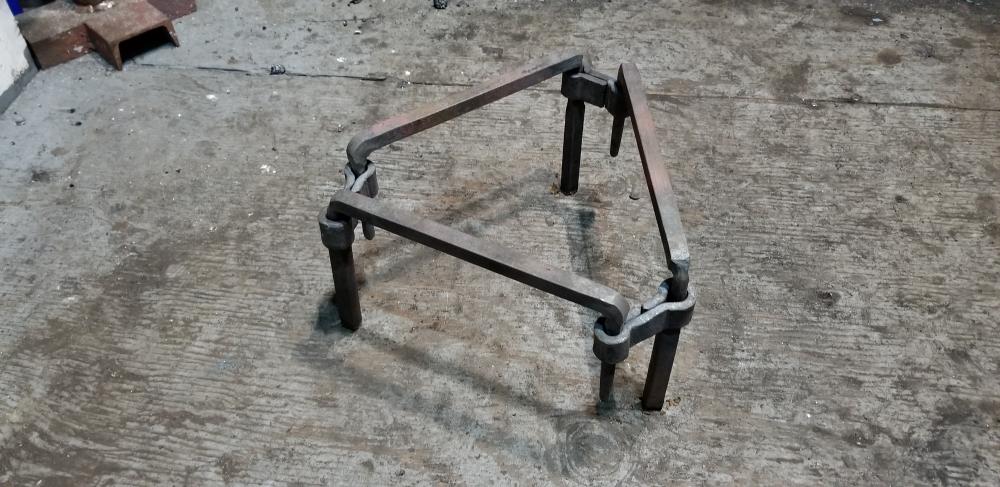

ThomasPowers Posted October 26, 2017 Share Posted October 26, 2017 I try to use forge welding to differentiate my stuff from folks that can't/won't. Especially as I do a lot of historical stuff where it would have been a common method. That's a lovely trivet example but the thin curls on the feet would erode pretty fast if used in a wood fire; better for stove or brick down hearth. I tend to "adjust" the legs and body with my screwpress. First I flatten the top to a plane and then I stack some heavy disks to the correct height and adjust the legs till they all make contact with the large disk on the bottom of the stack. Speeds up making a bunch of them as then flattening and adjustment can be done in one heat. Riveting the end of a tenon is a common method. More common than heat shrinking when used for items that may get heated in a fire---you may remember the old ball and ring experiment what when you heat both the ball will pass through the ring... Now I've used heat shrinking on items that will be kept at ambient---I have a war hammer I made about 25 years ago and heat shrunk the head on as an experiment---holding strong after a LOT of abuse when it was younger, (demolition, scrapped refrigerators/cars, etc) Now having protruding rivets on the face can be handy if the face of the trivet (or the base of the pan) is not dead flat as a 3 point support won't rock. Link to comment Share on other sites More sharing options...

ThomasPowers Posted October 26, 2017 Share Posted October 26, 2017 Yours is lovely and a great gift for a friend, I am sorry they didn't get longer to enjoy it. As mine are made for campfire cooking I don't have peg ends either but the ends are made heavier to resist eroding longer. I tend to upset or bend full crossection for the ends. If you were cooking on a brick hearth then this wouldn't matter as much...(There is a large historic kitchen in Rothenburg ODT in Germany that used to serve a Convent: it had a raised platform for the cooking fire so you could cook without bending over so much and could use it from all 4 sides, the ceiling of that section was a chimney too.) As the ones I described are forge welded and with practice the ends are close to the same length; I adjust them by adjusting the splay of the legs to have them sit level on a flat surface---which in use in a campfire will be an unusual occurrence! Have you seen the campfire cooking equipment show in the Opera of Bartolomeo Scappi! 1570 A.D? I have a number of books on historical cooking implements "Iron and Brass Implements of the English House" is another one I found interesting. Do you have any sources to share in this area? Link to comment Share on other sites More sharing options...

jlpservicesinc Posted October 27, 2017 Share Posted October 27, 2017 12 hours ago, GandalftheGold said: I defenitly latched onto the wrong part of this conversation but I absolutely loved Rothenberg. Probably one of my favorite places I have ever been in my life. I must have missed that particular kitchen though, or 18 year old me just wasn't paying attention. I had planned on making the outer ring of the cooking spiral, I cant really call it a trivet, just wider than the base of the largest pan I would use so the pan would never actually touch the rivets. I do really like the idea of upsetting the piece into a partially punched hole. I originally planned to use two pieces of steel as cross bars on the underside that the feet would be threaded through before being riveted to add rigidity. But I may just put a fifth leg in the dead center using the method you mentioned. What worries me with just the three feet over the fire is I would definitely knock it over and loose whatever I am cooking. Been there done that and upset a lot of campers. Oh wait, if you were saying it would rock because the four feet wouldn't make even contact with the ground, i always have and will always continue to have my first step of setting up a cooking grate be to give it a few good solid thwacks with a log to sink the feet down and give a nice stable base. Hence the need for cross bars. Ok, since this was an interesting idea. I spent a little time in the shop today and forged out a camp fire trivet.. It can fold up or it can be taken completely apart.. it's made from 1/2" sq steel, the side brackets are 1/4X 1".. I filmed the making of it so will set down and edit the footage sometime in the next few days.. Tomorrow I have demonstrations to do in town from 10am to 2pm so I doubt I will get to it tomorrow.. This could be made extra simple.. The bars could just be round stock or even rebar..((but I remember you saying you had some 1/2" square) I only have brand new rebar and it was buried in the steel pile from the move)) the swivel brackets could be made from a section of 2" black iron pipe.. then simply collapsed to form the same as what is shown.. To keep it from sliding down a could of wings could be forged just below it verse where I actually forged a round section into the square.. The secret on something like this is to keep the hinge areas tight.. It will hole 300lbs on it easily.. I would consider this project much easier than the frying pan.. Link to comment Share on other sites More sharing options...
GandalftheGold Posted October 28, 2017 Author Share Posted October 28, 2017 Oh that is actually really cool. I was trying to figure out how it was supposed to fold in half, I see now that I'd doesn't. In my mind i had the 90* bends parallel to the ground not perpendicular. The one you made is quite pretty and is defenitly something i think i can make. I doubt mine will be as pretty, more industrial bushcraft I think. But it looks like a fun project. I would personally say it is collapsible but that is me just being nitpicky for little reason. I don't think i quite have enough square to do that but just maybe. I def have enough rebar but the square looks really nice. Link to comment Share on other sites More sharing options...
jlpservicesinc Posted October 28, 2017 Share Posted October 28, 2017 2 hours ago, GandalftheGold said: Oh that is actually really cool. I was trying to figure out how it was supposed to fold in half, I see now that I'd doesn't. In my mind i had the 90* bends parallel to the ground not perpendicular. The one you made is quite pretty and is defenitly something i think i can make. I doubt mine will be as pretty, more industrial bushcraft I think. But it looks like a fun project. I would personally say it is collapsible but that is me just being nitpicky for little reason. I don't think i quite have enough square to do that but just maybe. I def have enough rebar but the square looks really nice. Thanks.. what is your definition of collapsible? If you mean nesting.. no it won't nest but it does fold up of comes apart easily to stack.. You can also see it will hold something as big as 16" down to just a few inches across. Fun right.. Link to comment Share on other sites More sharing options...
ThomasPowers Posted October 30, 2017 Share Posted October 30, 2017 I'm going to try a variation of that without the separate swivel brackets. I'm going to bend the end of a length over onto itself and forge weld it for a beefed up leg and then take the shorter section left unwelded and make the loop. I may get a chance to try it out next weekend. Perhaps with 3/8" sq stock, though now that I'm thinking about it using strap stock might be an interesting way to go about it...and punch and drift the loop and forge the end of the strap into a round to fit into the loop on the next leg. I've been looking through some of my old iron/kitchen stuff books and have seen a bunch of interesting trivets tonight. Link to comment Share on other sites More sharing options...
jlpservicesinc Posted October 30, 2017 Share Posted October 30, 2017 8 hours ago, ThomasPowers said: I've been looking through some of my old iron/kitchen stuff books and have seen a bunch of interesting trivets tonight. Nice.. post up a pic or 2-5 when you get it done.. The parameters were no forge welding.. and for ease of making 2" pipe cut the width of the forged slots with the centers forged in would work just as well.. One could all So bend up the feet as you pointed out and this would lock the swivel collar in place also.. What book did you find the drivers in? I'm always looking for more reference materials.. Oh one other thing about the trivet.. if you need more height you can slip 3/4" pipe on the legs the required height.. Link to comment Share on other sites More sharing options...
