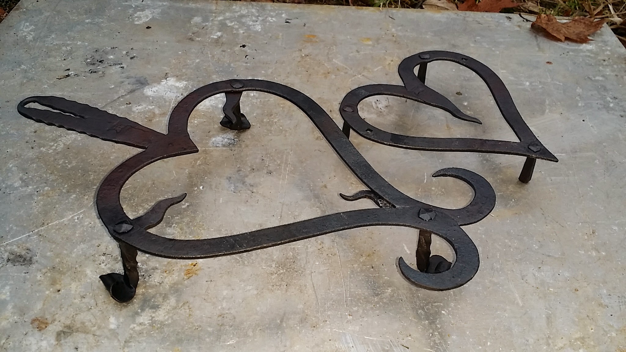

jlpservicesinc Posted October 25, 2017 Share Posted October 25, 2017 I will be doing a "How to" on trivet making in the next few weeks.. Maybe tomorrow I'll film it depending on the day.. I'll make a round one first, then a heart shaped one.. Quote Link to comment Share on other sites More sharing options...
ThomasPowers Posted October 26, 2017 Share Posted October 26, 2017 going to do one where you take 3 pieces of stock and forge weld 3+/-" on the end of two pieces and bend them apart and forge weld the 3rd piece to those ends and bend down for the feet? (heavier feet are good if they will be used in a wood cook fire...) I did a bunch like that over the years; but I up and sold or gave away all of them...sigh Quote Link to comment Share on other sites More sharing options...
GandalftheGold Posted October 26, 2017 Author Share Posted October 26, 2017 My current plan, which Ill try today if the rain lets up, was to take a six ish foot piece of rebar and roll it on itself leaving about an inch to two inches, I haven't decided yet, between the pieces of metal, punch four quarter inch holes on the outside and possibly a fifth dead center, take the small 12 inch rebar pieces I have draw out the ends thread them through the holes then upset the drawn out portion to basically rivet it in place. I'm pretty sure that isn't a trivet which is why I had used the prefix basically. If the upsetting doesn't work I was going to try a method of fixing I saw in a book which is to force the cold piece you want fixed into the cherry red hole and let it cool down, theoretically as it cools it should shrink and grip the rebar, especially with all the rough texture marks rebar is covered with. I'm sure you all know what that is, I just cant remember what it is called off the top of my head. I would like to one day make an actual set of trivets which will first require reading the section in two of my books, and watching a bunch of videos. Quote Link to comment Share on other sites More sharing options...
jlpservicesinc Posted October 26, 2017 Share Posted October 26, 2017 6 hours ago, ThomasPowers said: going to do one where you take 3 pieces of stock and forge weld 3+/-" on the end of two pieces and bend them apart and forge weld the 3rd piece to those ends and bend down for the feet? (heavier feet are good if they will be used in a wood cook fire...) I did a bunch like that over the years; but I up and sold or gave away all of them...sigh No, they will be riveted feet.. Trivets can be very elaborate both riveted and welded designs but have found that the riveted feet type to be more popular in the area.. (this type survived better) The simple welded feet triangle ones were or I should say popular I guess because of the ease to make.. (but you see a lot less) maybe I'll make 3 examples as they all take forge welding which for a lot can be a problem.. Collared trivets are much more popular today and is usually what is shown in examples in magazines and such.. I was thinking of a round trivet to start with as it only needs the one forge weld and even if the person can't weld they can still successfully put it together even if the weld doesn't take, simply because they can still punch the scarf and then rivet it together.. Quote Link to comment Share on other sites More sharing options...
GandalftheGold Posted October 26, 2017 Author Share Posted October 26, 2017 Those look really cool. I look forward to seeing that video. I have personally never tried forge welding yet but on the list it is. Quote Link to comment Share on other sites More sharing options...
jlpservicesinc Posted October 26, 2017 Share Posted October 26, 2017 10 minutes ago, GandalftheGold said: My current plan, which Ill try today if the rain lets up, was to take a six ish foot piece of rebar and roll it on itself leaving about an inch to two inches, I haven't decided yet, between the pieces of metal, punch four quarter inch holes on the outside and possibly a fifth dead center, take the small 12 inch rebar pieces I have draw out the ends thread them through the holes then upset the drawn out portion to basically rivet it in place. I'm pretty sure that isn't a trivet which is why I had used the prefix basically. If the upsetting doesn't work I was going to try a method of fixing I saw in a book which is to force the cold piece you want fixed into the cherry red hole and let it cool down, theoretically as it cools it should shrink and grip the rebar, especially with all the rough texture marks rebar is covered with. I'm sure you all know what that is, I just cant remember what it is called off the top of my head. I would like to one day make an actual set of trivets which will first require reading the section in two of my books, and watching a bunch of videos. Here is just some food for thought.. FYI, it certainly will work..and I'm not trying to talk you out of it, but that can be a lot of work.. A traditional trivet uses a minimal amount of material to get the job done.. You would be better off with using straight bars with a 90D bend at each end with collars on them.. If you forge a groove around each bar , just below the bend you can fit the collar into this and then it will make the trivet able to fold up for storage as well as add some uniqueness to the trivet.. if you didn't feel comfortable making collars you could forge down the ends and make it so one end of the bar has a short section which fits into a slot or collar and then you can take it completely apart.. Maybe I'll make one of these as there is no forge welding and it could be a fun project.. Quote Link to comment Share on other sites More sharing options...
GandalftheGold Posted October 26, 2017 Author Share Posted October 26, 2017 5 minutes ago, jlpservicesinc said: degwould be better off with using straight bars with a 90D bend at each end with collars on them.. If you forge a groove around each bar , just below the bend you can fit the collar into this and then it will make the trivet able to fold up for storage as well as add some uniqueness to the trivet.. if you didn't feel comfortable making collars you could forge down the ends and make it so one end of the bar has a short section which fits into a slot or collar and then you can take it completely apart.. Maybe I'll make one of these as there is no forge welding and it could be a fun project.. I'm pretty sure I get what you mean with the collar, Just a thin flat bar or thin stock wrapped around the sides of the pieces being held together. But as it is rather early I am having trouble envisioning how that would allow it to fold. Although I'm thinking about this with four collars but if you were saying two I can sort of envision it kind of. If I had square stock that didn't require an hour drive to go get I would totally do that. I have one long ish piece but I'm not sure if it will be quite long enough, Ill go measure it in a bit to see what can be done. Rolling the rebar may take forever, but It seems like a fun waste of time. I also really need practice with punching, the last time I did it I really screwed up what I was working on. I'm pretty sure I used a center punch by accident. I didn't really know what I was doing, I still don't, but I at least know the difference between all my punches now. I think it all just came together in my head. Were you saying use the square stock to make two halves of a square/ rectangle then 90 degree bend those ends outward and collar them together? I totally see how that can fold. Quote Link to comment Share on other sites More sharing options...
