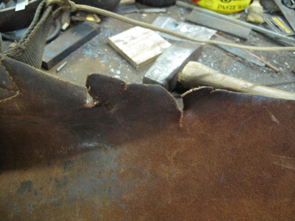

VaughnT Posted September 30, 2017 Share Posted September 30, 2017 There was once a time when I didn't wear an apron around the shop, but one day I tore a brand new shirt and that was that. A leather apron is hot, sure, but I bet I've saved over a thousand dollars in t-shirts since I started using one regularly. Even when you're not forging things, there are plenty of stuff that can destroy a shirt, so the apron really does help. Plus, I liken it to a uniform; when I put it on, I'm in work mode until I take it off. The other day, I left my hammer on the anvil overnight and the devil came in to play. I've never seen leather give way like this, but leave it up to me to find new and interesting ways to ruin something. All around the apron, the leather is getting hard and brittle wherever the sweat and grime was thickest. I guess I should have been more on the ball with washing the apron. Lesson learned..... To get me by until I can get a new apron, I used some roofing nails, gorilla glue and a bit of old leather to patch the strap. No telling how long the repair will last, but at least it's fixed for the time being. Looking around the internet, I'm seeing a few very nice aprons. None of them really catch my eye, though, because I was a bit spoiled by this Tilman apron. With a body that's 24"x48", she covers me all the way down to my instep. I had to rework the cross-back straps to make them actually functional. When I did, imagine my surprise when I found out that I didn't need the horizontal waistband! The way the straps tie into the sides of the apron is perfect for keeping the apron in place, so I cut free the waist strap and haven't missed it a bit. Even the cloth shoulder straps have proven better than leather straps of aprons past. They don't roll up, rot through, or get thick with gunk...... which makes me wonder why everyone else is using leather. Anyhow, all these little design points come up when I was shopping for a new apron and everyone seemed to be missing one thing. Maybe too short, or had too many pockets, or leather straps, or whatever. I like the Tilman, but don't want to spend the money on something that I'll have to immediately change (strap system) when it arrives in the mail. If it wasn't for that, I'd be okay with paying $50 for a new apron every few years. Since I can't get Tilman to change their design, I thought I'd go forward with making up my own apron design. There's a local fellow that does really nice leatherwork, but he's used to working on motorcycles, not blacksmith gear. He's open to helping, but we're stuck on what kind of leather to use. Obviously the Tilman apron isn't a good guide in this regard, so......? I'm thinking a good apron should be as thick as a nickel, or slightly under that thickness. And it should be oil-tanned so it's resistant to grease, grime and sweat. I sweat buckets, so all the help I can get is appreciated! Thoughts? Quote Link to comment Share on other sites More sharing options...

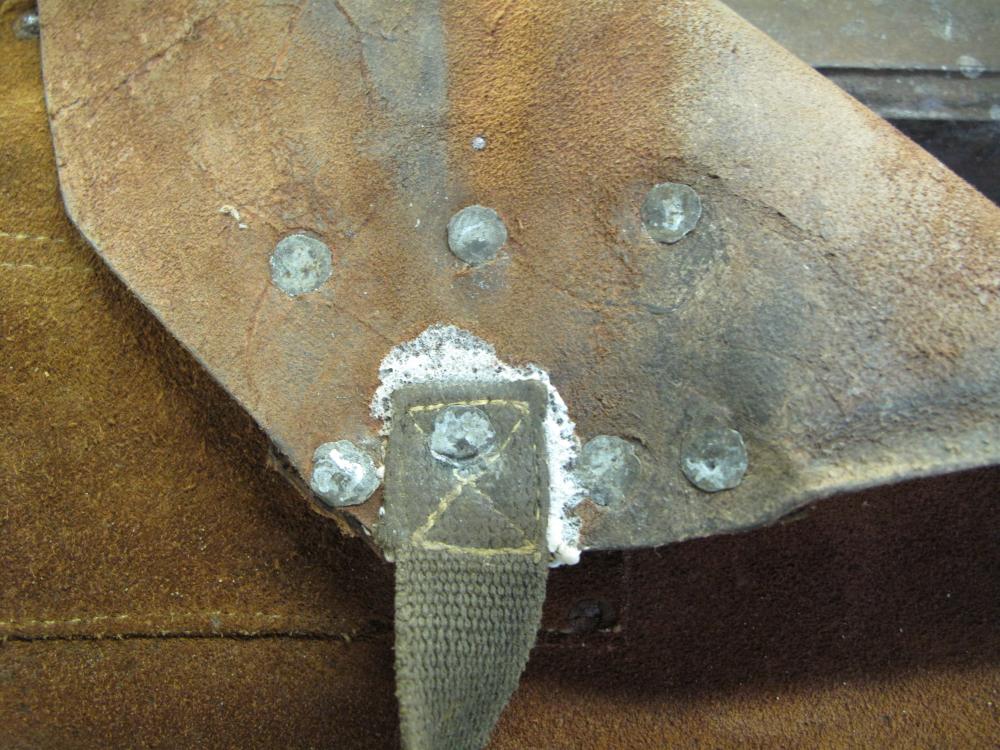

Charles R. Stevens Posted September 30, 2017 Share Posted September 30, 2017 So stitches are like perforations on a stamp. Any stitches across the line of pull are potential failed points, stick inline with the straps and rivet if you need to reinforce. Also saddle stich at 5 stitches per inch are stronger than lock stitches. Quote Link to comment Share on other sites More sharing options...

SLAG Posted September 30, 2017 Share Posted September 30, 2017 V.T., The leather dried out. Leather does that. Leather should be treated with products like saddle soap, or, as Mr. Hocking has suggested, neatsfoot oil. (which is what I use). The latter is a petroleum product. There is no such animal as a neat. The leather should be wiped with the oil every year or two years. Regards, SLAG. Quote Link to comment Share on other sites More sharing options...
JHCC Posted September 30, 2017 Share Posted September 30, 2017 The latter is a petroleum product. There is no such animal as a neat. Actually, "neat" is derived from the Old English for "cattle", and true neatsfoot oil is made from rendering the fat from cattle's hooves and lower legs. If the label says "neatsfoot oil compound" or "prime neatsfoot oil", then it probably has some petroleum product blended in. Quote Link to comment Share on other sites More sharing options...

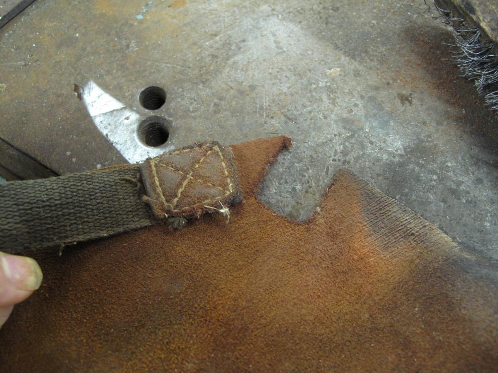

SLAG Posted October 1, 2017 Share Posted October 1, 2017 Dry leather soaks up a lot of neats foot oil. You just stop before there is a sheen on the leather surface. I have never had treated leather catch fire. I suspect that it would take a very hot propane fire to get it to even smoke let alone catch fire. JHCC thanks for the heads up concerning the petroleum origin of neats foot oil. SLAG. p. s. the apron looks like it can salvaged by sewing a leather patch on it. Tandy Leather sells leather scraps for such a repair. Quote Link to comment Share on other sites More sharing options...
JHCC Posted October 1, 2017 Share Posted October 1, 2017 I haven't been able to get brain tanning down yet. I've been working on tanning my brain for years. p. s. the apron looks like it can salvaged by sewing a leather patch on it. Tandy Leather sells leather scraps for such a repair. Or just cut a corner off the bottom of the apron. Quote Link to comment Share on other sites More sharing options...
VaughnT Posted October 1, 2017 Author Share Posted October 1, 2017 Well, I had some neatsfoot oil in the shop, so I dabbed a little on the leather where it was tearing or looked like it wanted to tear. Now I'll wait to see how it looks in the morning. It sure did soak up the oil quick! My worry, looking at it now, is that it will always have that oily feel. I don't know if the oil will leach out into my shirt after a day of sweating in the shop. The only damaged or dried out areas of the apron are by the arms and neck where the sweat gets heavy. On the bottom portion, the leather is in fantasy, almost-new condition. Maybe, if the oil dries a bit and doesn't feel too oily in the morning, I'll go ahead and oil the entire top half. I'm still looking at doing up a really nice apron that I won't be ashamed to be seen in public with. Quote Link to comment Share on other sites More sharing options...

Frosty Posted October 2, 2017 Share Posted October 2, 2017 A couple things come to mind Vaughn. The salt is REALLY hard on leather, saddle soap and mink oil regularly. (You sweaty dog you!) Those stitches are WAY too close so they're probably pulled too tight too. It's easy when the stitches are that close, the tension creeps up and gets too tight. If the end of the straps comes to a rounded point rather than cut square it'll be much less prone to ripping out like that. Rivets E washers are good. I had mine made from smooth out, moose hide, I don't remember the tan, split legs and a really nice strap and buckle arrangement I can't describe. I don't wear it all that often but a wipe down with mink oil every couple years has kept it supple for better than 20 years now. I'd have to really think about when I had it made. At the time I was told it was too thick and it is but I've had 9" Milwaukee disk grinder blades hit me in the chest twice and barely bruise me. I feel pretty bullet proof in it and it looks good. I'm really enjoying this thread, I've learned a bunch. Frosty The Lucky. Quote Link to comment Share on other sites More sharing options...
