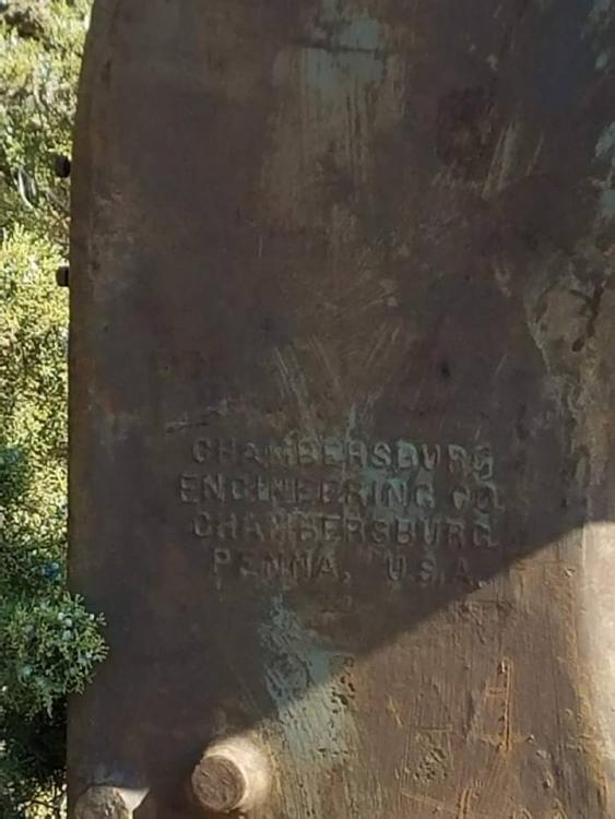

smokey07 Posted September 15, 2017 Share Posted September 15, 2017 That hammer is a Chambersburg utility, tag is missing so you cant tell the weight.But it is huge, probably around a 1500 lb or more. Link to comment Share on other sites More sharing options...

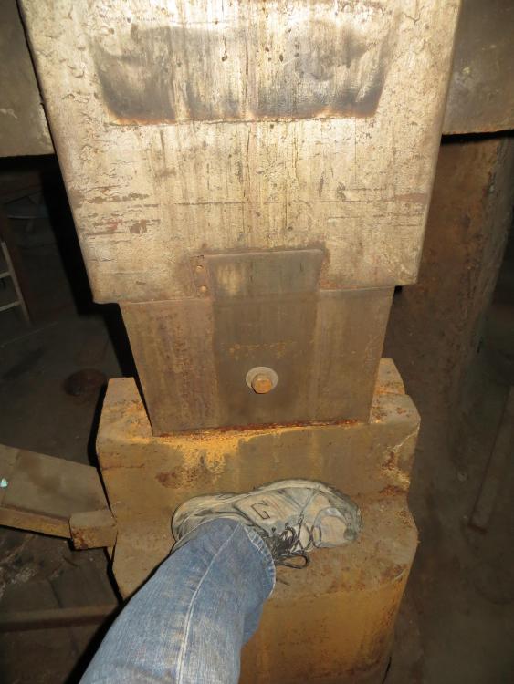

marcusb Posted September 16, 2017 Share Posted September 16, 2017 Dies on a 1500 pound ERIE, shoe is a size 14 Link to comment Share on other sites More sharing options...
Avadon Posted September 16, 2017 Author Share Posted September 16, 2017 Just found two other pics that my wife and I took that day. Should be able to give more reference Link to comment Share on other sites More sharing options...

marcusb Posted September 16, 2017 Share Posted September 16, 2017 This is for ERIE but should get you close to size estimation for that hammer. Link to comment Share on other sites More sharing options...

smokey07 Posted November 21, 2017 Share Posted November 21, 2017 Since i live about 5 miles from the scrapyard, i went over and took some measurements of the ram and height and other stuff.Compared those to the Erie chart here and some were the same and some were a little differnt, but overall this Chambersburg is a 800 lb hammer. !!11 ft tall and the floor base is 64x41 in. IT is sorta rough condition but would make good yard art. I asked if they would sell it and am waiting on a call back tomorrow. I dont want it but figured i would ask cause i deal with the yard on other stuff. dont know about total weight cause it wasnt on the above chart. Smokey Link to comment Share on other sites More sharing options...
smokey07 Posted November 22, 2017 Share Posted November 22, 2017 Talked to the boss at the scrap yard and they put it on the scale, 10280 lbs he wants 1250.oo which comes to about .12 cents a pound yard is Swift and Mccormick in Terrebonne OR 541 948 2652 ask for Dan. for anyone who is foaming at the mouth over it. Smokey Link to comment Share on other sites More sharing options...
