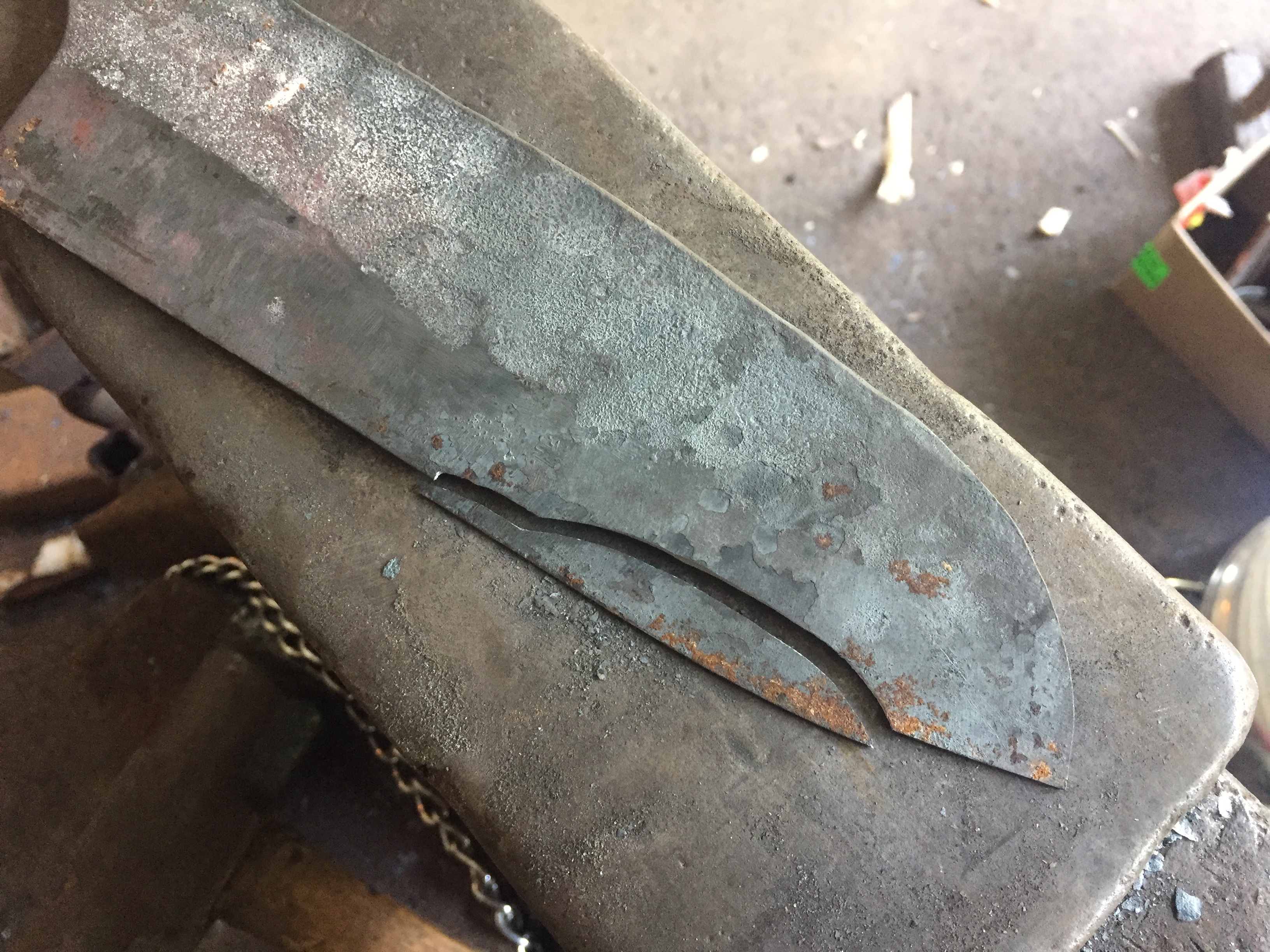

JHCC Posted September 10, 2017 Share Posted September 10, 2017 FYI, this just happened today. Imagine this flying through the air at high speed. What could go wrong? Quote Link to comment Share on other sites More sharing options...
