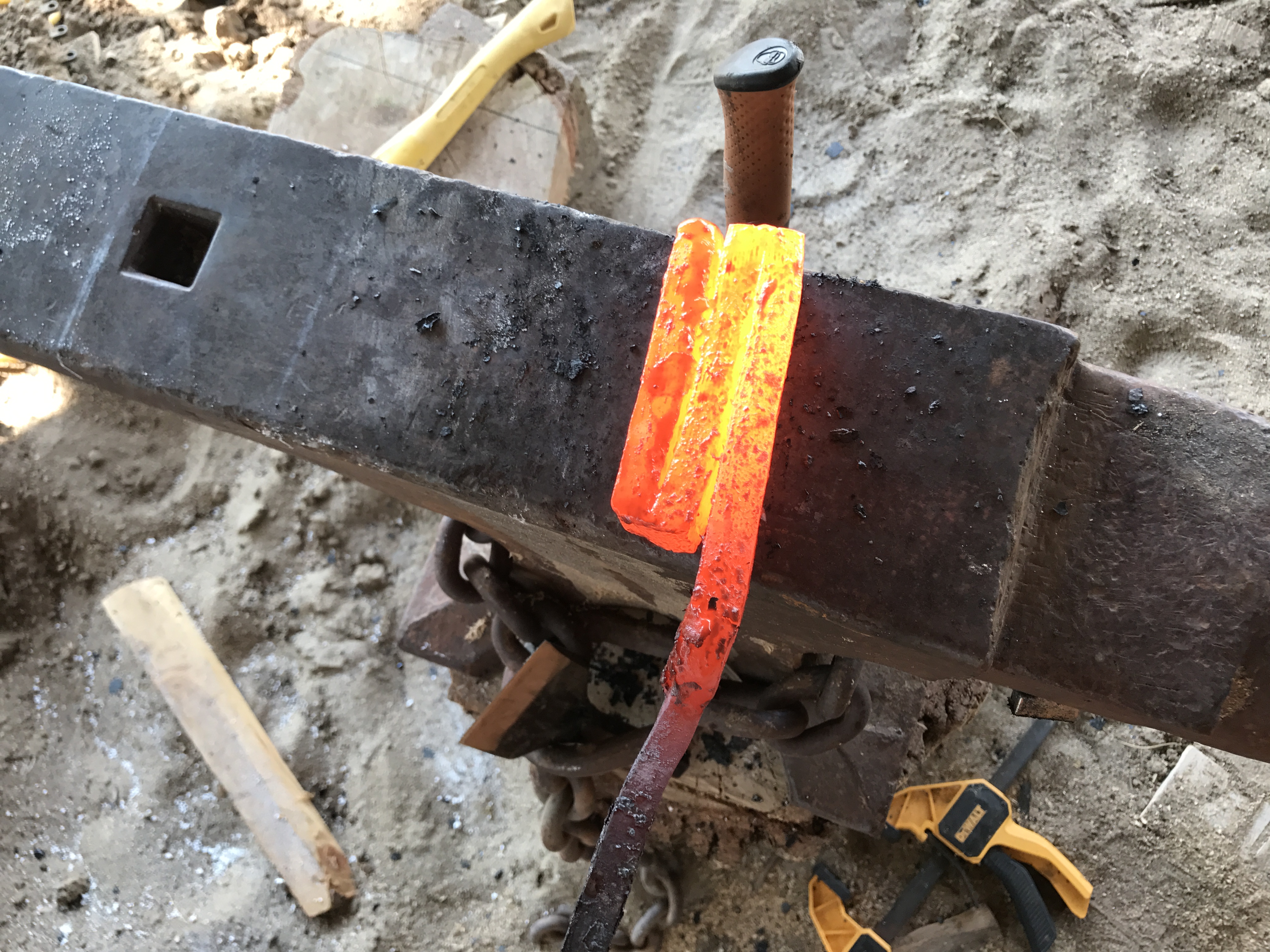

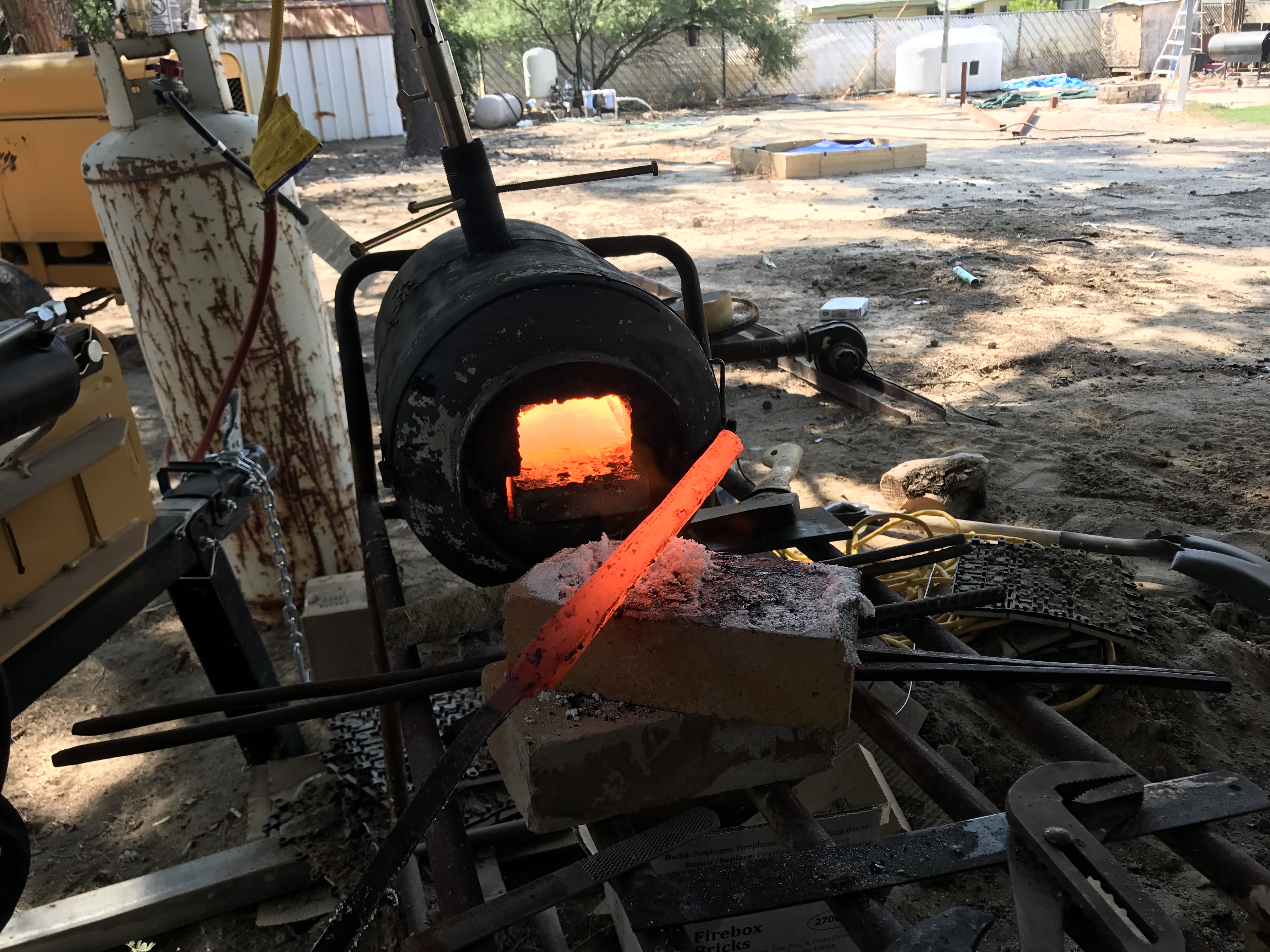

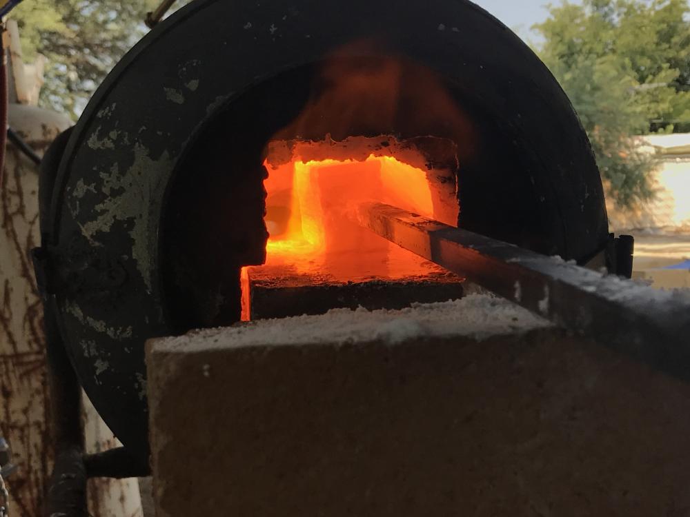

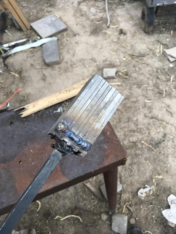

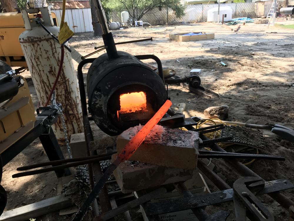

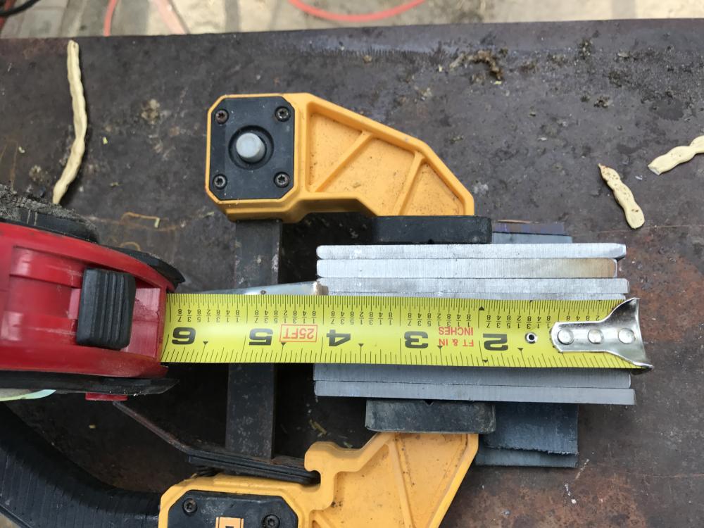

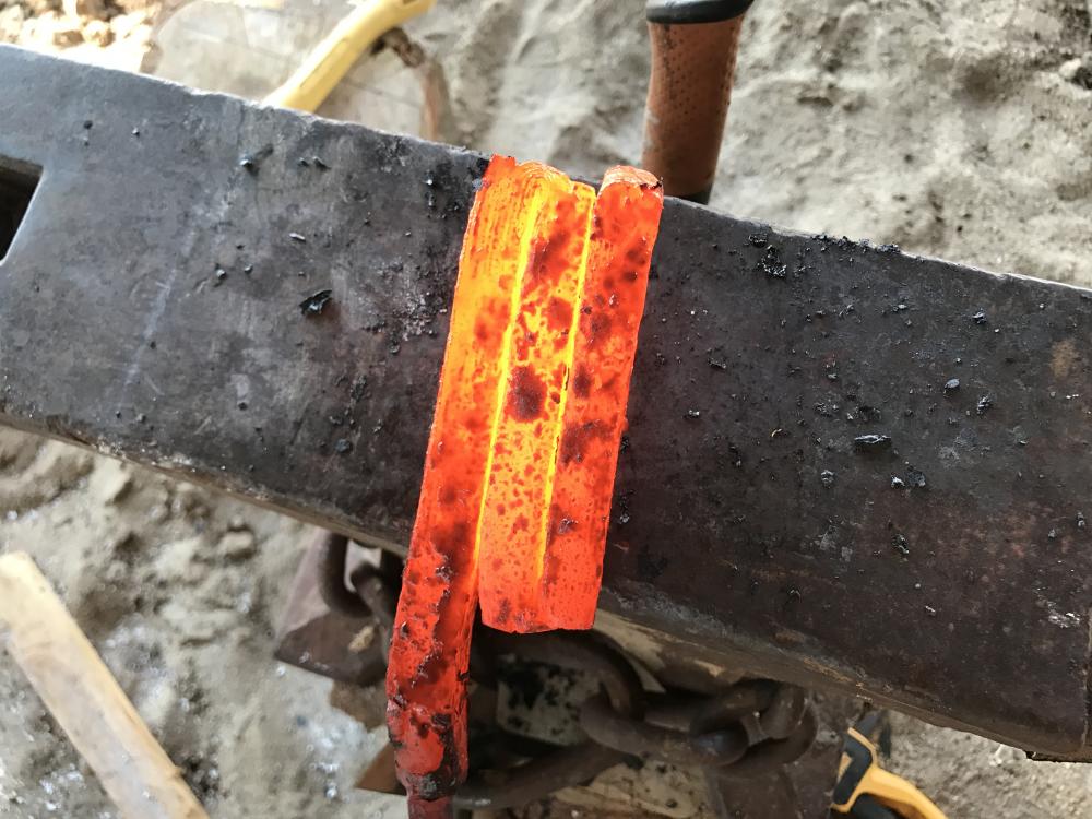

Jclonts82 Posted September 6, 2017 Share Posted September 6, 2017 I was tasked to make a skinning knife from W2 and 52100. At first I was unsure if it would (read I had skill enough to make it) even weld, then there were questions about contrast and heat treat, think I got the answers I needed for all that. But all the research I could do is secondary to the 'ole try. Enough chatter, bring on the pictures! initial billet: firing for first weld: 9 laters here, then I cut into 4 pieces, cleaned and stacked 9 layers to 33-36 layers drew out to 12" long, hot cut 80% of the way through at 4" up on 1 side, then at 8" up on the other side, folded to a "Z" cleaned then massively fluxed then back in the fire for the last weld. Yeilds 99-108 layers. (Call it 100) welded it up and drew it out. About a third was squezed a lot smaller than the rest in preparation for a twist. I cut that end-tip off to square it up and for a weld integrity and pattern check: looking good, 2 minutes in concentrated HCl, then a 15 second dip in FeCl3 Then I was tired and stopped for the day. More to come when I get the time! Link to comment Share on other sites More sharing options...

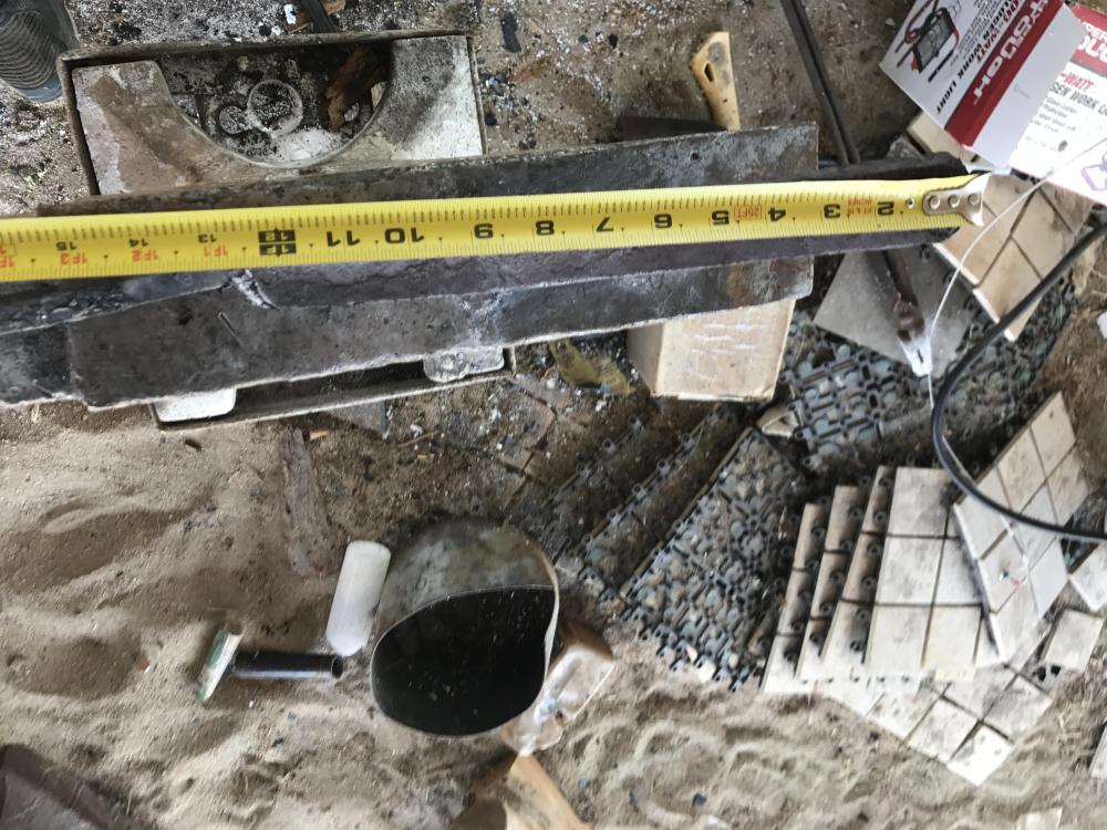

Jclonts82 Posted September 11, 2017 Author Share Posted September 11, 2017 So the forging is done, I decided to put a twist pattern in it. I have done one before with 1095 & 15n20 (5/8" thick) and it went off without a hitch, however this animal was something different. I had MUCH more resistance while twisting the stock, it was a little thicker (3/4 - 1") so I expected that, but it was requiring about 4 times the force to twist than the other. It made me nervous enough to stop at I think 2 full twists. Oh well, should look neat anyways. Sorry, at work no pics at the moment. I have started grind work. Cousin wants a fairly skinny handle on it, with a slight taper towards the blade, may be unconventional, but whatever! Question. What are the Forum's opinions on the edge geometry and / or grinding bevel angles for a skinning knife? I'm leaning towards a flat grind for the majority of the blade and a really acute angle for the edge bevel. Somewhere in the vicinity of 15-17 degrees? I would Really appreciate any thoughts and insights on the matter Link to comment Share on other sites More sharing options...
Will W. Posted September 11, 2017 Share Posted September 11, 2017 1 hour ago, Jclonts82 said: I'm leaning towards a flat grind for the majority of the blade and a really acute angle for the edge bevel. Somewhere in the vicinity of 15-17 degrees? I would Really appreciate any thoughts and insights on the matter What you have planned sounds good to me. I've done skinners basically to exactly those specs, and they come out very sharp, plenty enough to skin. Link to comment Share on other sites More sharing options...

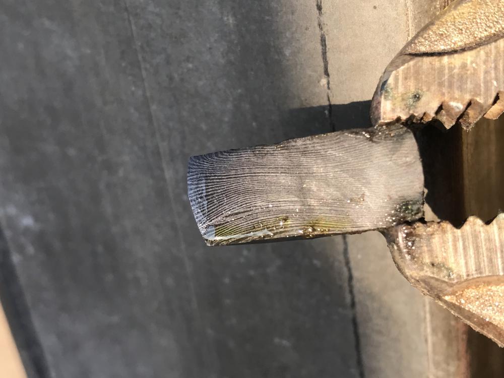

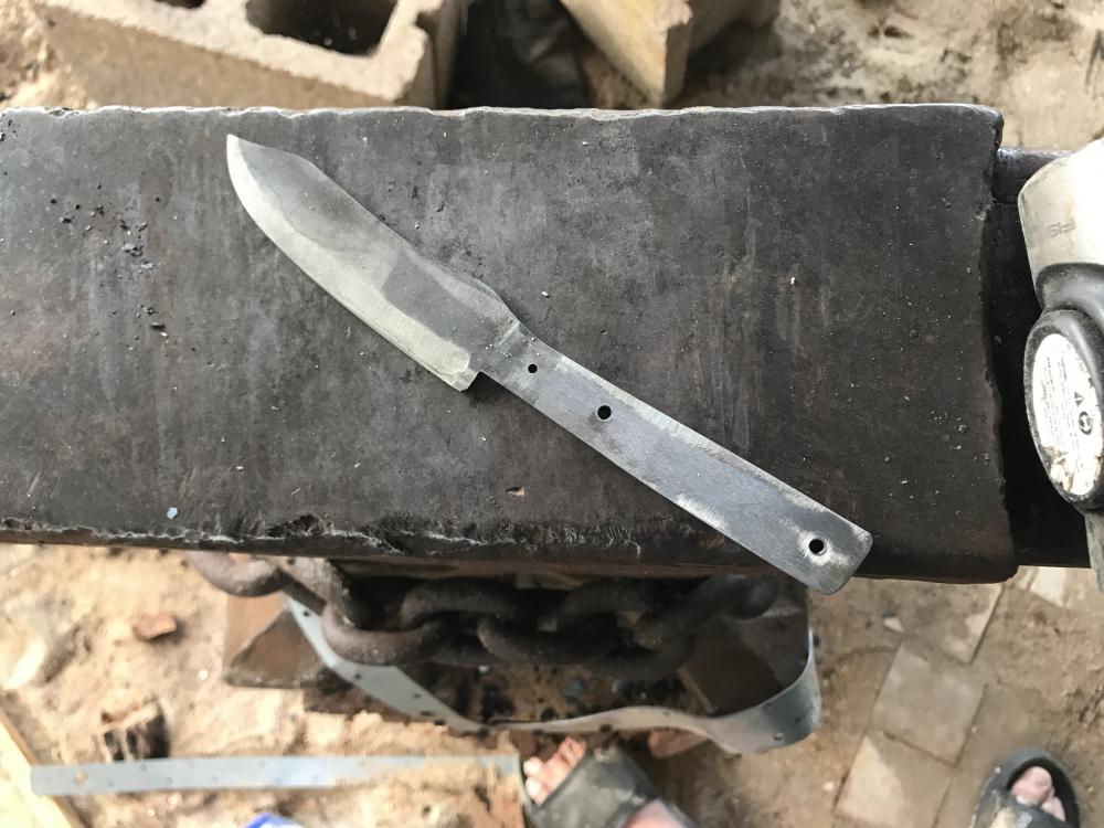

Jclonts82 Posted September 14, 2017 Author Share Posted September 14, 2017 Good progress made. Forged then ground to shape, don't know if I like the thicker point by the tip, may grind it out. Interestingly while drilling holes for the tang it was extremely hard. I have a set of new cobalt drill bits and they just squealed on the tang. When I was done with forging, i left in the the forge, bricked the opening up and turned off the gas. The next morning it was still warm. I thought that would have left it plenty soft but you never know i guess. Had to drill in 1/16th increments just to get through it, while breaking 2 bits in the process. This pic was just before the heat treat While grinding, Horray, no cracks/delams/bad welds that I could see. Heat treat went well, preheated forge to 1500 +/- and heated until the color stopped changing on the blade about 15 minutes total, then immediately quenched in vegetable oil. No warping, no bad sounds. Immediately tempered to 340 (as close as I could set the toaster oven to 350 and have it stay there) for 1 hour. Repeated temper the next day. Just sarted finishing grind work and edge bevel. Also the manzanita wood for the handle is in the vacuum chamber with cactus juice as I type. Its a really hard & dense wood to begin with, but has a tendency to crack... thought why not try and stabilize it and see if that works? more pics to come as work progresses. Link to comment Share on other sites More sharing options...

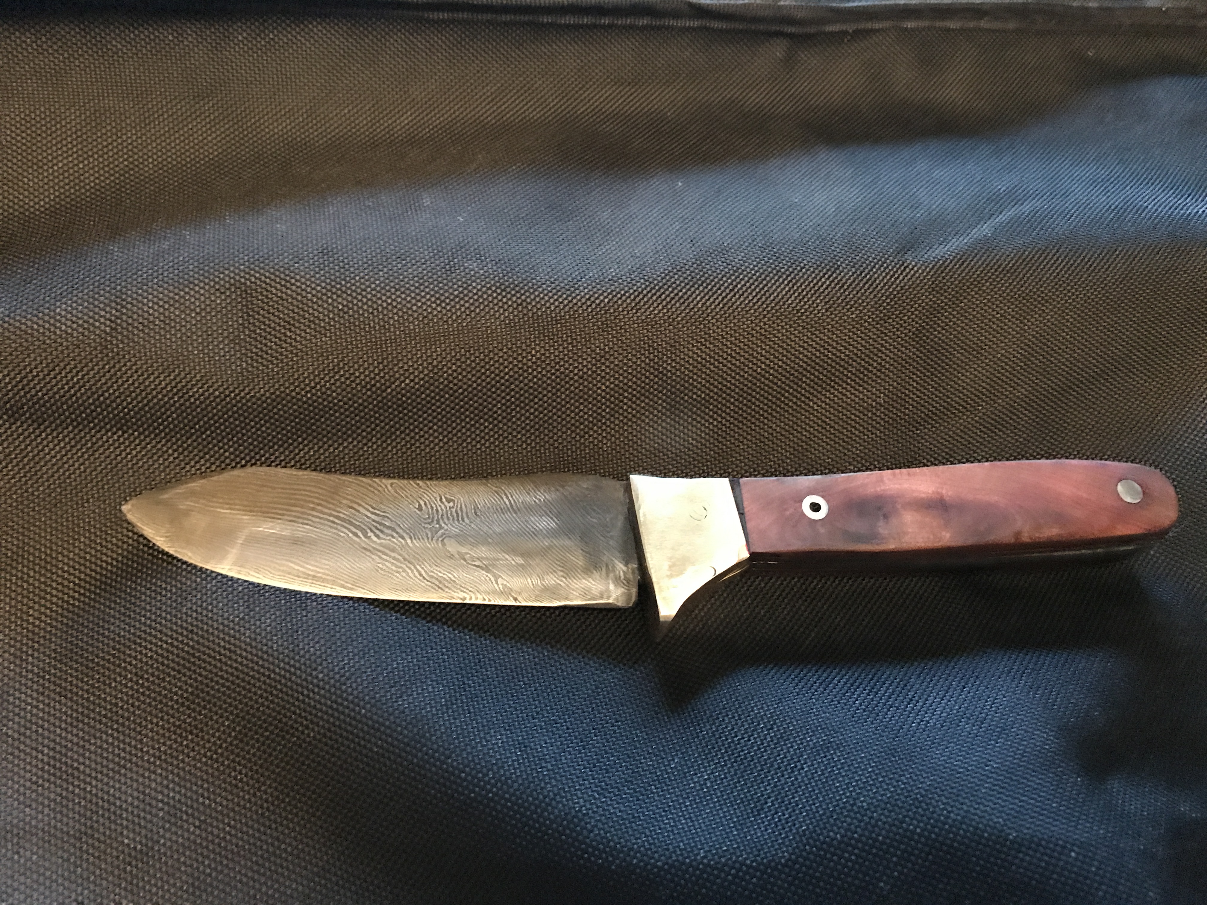

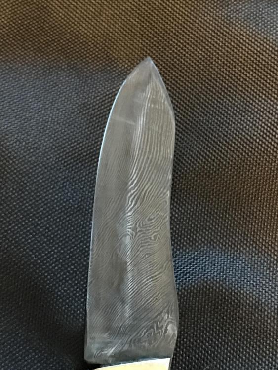

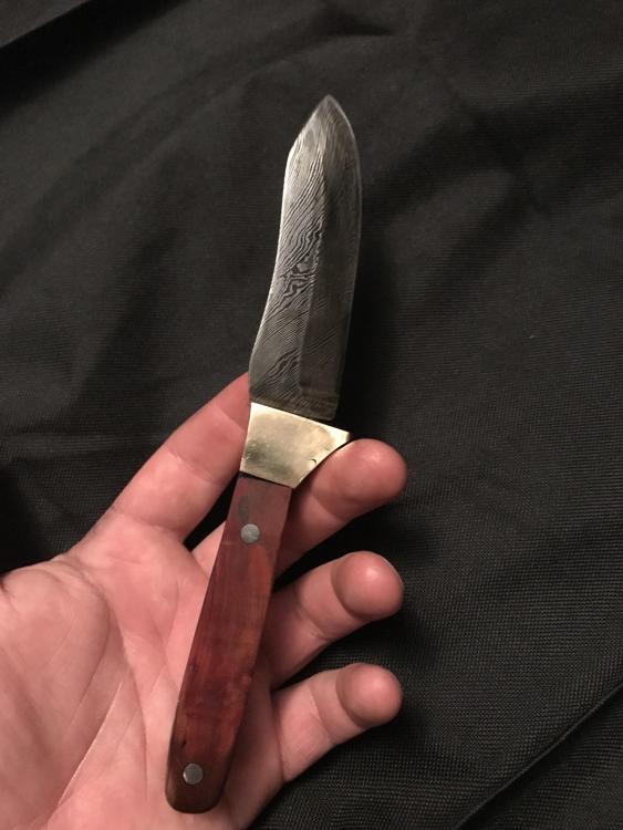

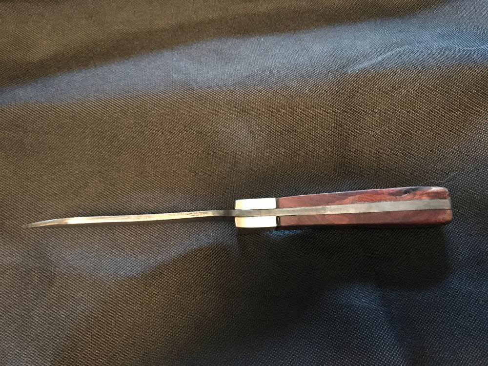

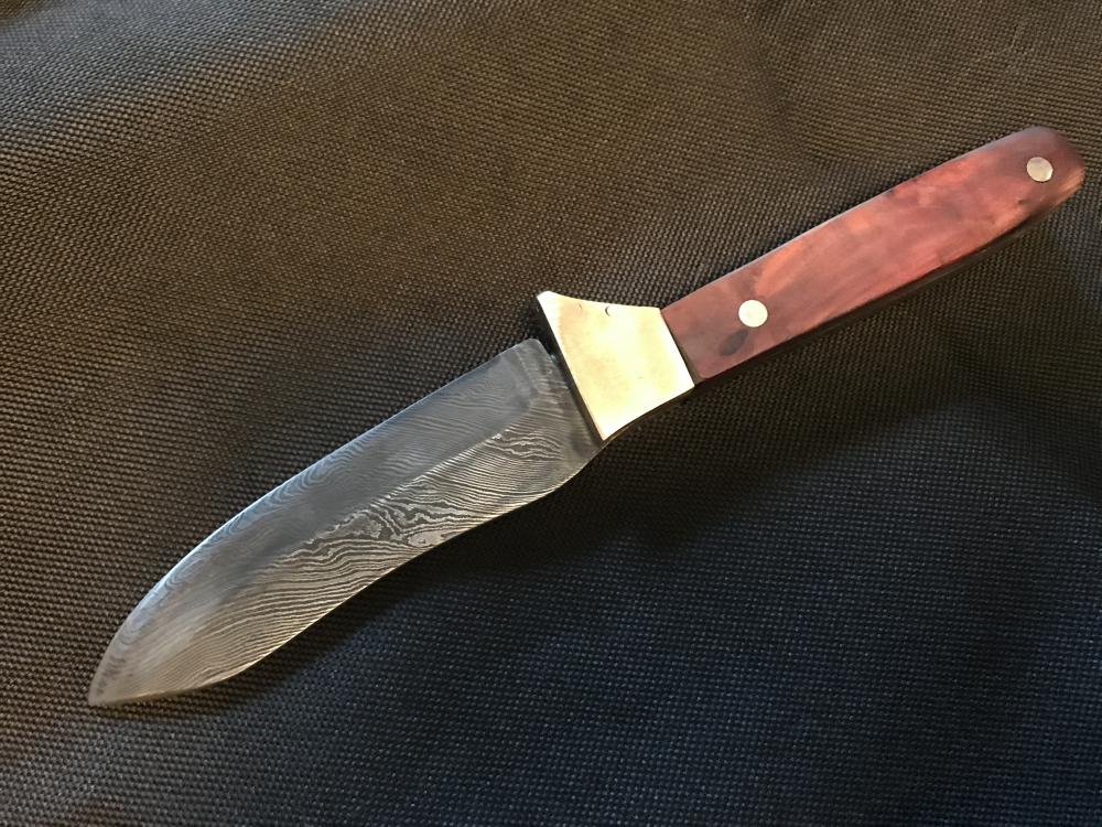

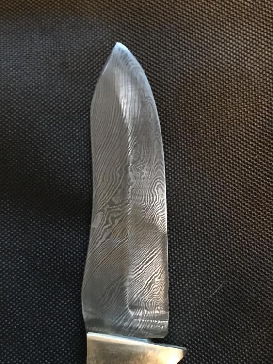

Jclonts82 Posted September 21, 2017 Author Share Posted September 21, 2017 Whelp. I'm more/less done. I will light sand then do one last quick dip in the acid to even out the pattern. I decided my handle work needs more practice. But overall I'm satisfied with my work. I filled a gap from an oops in my handle. The guard is not 100% square to the tang so I had to sand the front of the scale at an angle... measured correctly, just sanded it opposite, so it left a gap. First guard I've ever made. Could be better, could be a lot worse. Enjoy. feedback, constructive criticism is welcome. Link to comment Share on other sites More sharing options...
JHCC Posted September 21, 2017 Share Posted September 21, 2017 The blade steel is lovely, and the overall shape and proportions are nice. The guard is jarring -- it looks like it got knocked loose and was carelessly epoxied back in place. The mismatch between the back of the blade and the back of the tang looks sloppy. The corners of the guard and the handle look pretty sharp, and both look and function would probably be improved by rounding over any edge that will be in contact with the hand. In the antepenultimate photo, there's a black dot in the middle of one of the rivets; is that supposed to be there, or is it some kind of marking or camera artifact? In short, the blade looks great and the handle design is nice, but the handle execution is a letdown. Link to comment Share on other sites More sharing options...
Jclonts82 Posted September 21, 2017 Author Share Posted September 21, 2017 ...corners of the guard and the handle look pretty sharp, and both look and function would probably be improved by rounding over any edge that will be in contact with the hand. In the antepenultimate photo, there's a black dot in the middle of one of the rivets; is that supposed to be there, or is it some kind of marking or camera artifact? In short, the blade looks great and the handle design is nice, but the handle execution is a letdown. Couldn't agree more! I've for sure learned to rethink my approach to guards, and definitely need to take more time to line things up properly before drilling the pin holes that match the tang. Thank you for the honesty. All corners are rounded slightly, so there are no sharp points where the hand touches them, photos just don't convey that very well. Aesthetically it would be much better to really round and make the lines flow. I agree. Black point is actually a sharpie dot, I was considering some design or etch dark on the pins, decided not to, wiped the dot off. Link to comment Share on other sites More sharing options...
Buzzkill Posted September 21, 2017 Share Posted September 21, 2017 For small gaps between components you can usually take some sanding/grinding dust from the material you were working with and mix it with epoxy to make the spaces less noticeable. I agree with JHCC on pretty much everything he said. On the guard I would take a round file, half round file, or a small contact wheel on a grinder and put more of an inside curve where your index finger would be in use. If you do that and radius the edges a little afterwards it should both look and feel a little bit better. Link to comment Share on other sites More sharing options...
Jclonts82 Posted September 21, 2017 Author Share Posted September 21, 2017 Maybe I should practice with cheap pine 2X4s making handles and guards to get a better feel for it, make less mistakes in wood that counts. This wood is Manzanita shrub, and very hard to come by where I'm at, but I really like the way it looks. That and its hard as nails, I have a cutting from a branch thats 1/4 inch thick 1 inch wide, and about 6 inches long. you cannot break or bend it by hand. I've had 4-5 burly guys try and no luck. I appreciate the comments and critique, it will help me be a better maker. Thank you Link to comment Share on other sites More sharing options...
SLAG Posted September 21, 2017 Share Posted September 21, 2017 JCL., Using an epoxy mixture with grindings or sanding dust is a good idea. But if a consistent dark color is desired, I have used graphite powder in the epoxy. Graphite is available for sale in most hardware stores and also auto supply stores. (it is used as a lubricant). Failing that, you can make carbon powder by using a lit candle and holding a cup filled with water just above the candle flame. That set up allows for incomplete combustion of the candle wax and carbon is deposited on the glass underside. The carbon can then be scraped off the glass. Other filler colors can be produced by sanding various woods. (like Gaboon ebony, black wood, black walnut etc.). Small off cuts can be used for that purpose. Those bits can be salvaged from a store's garbage or their pile of wood ends. You can use wood powder made form the knife scales for a color match SLAG. Link to comment Share on other sites More sharing options...
Jclonts82 Posted September 21, 2017 Author Share Posted September 21, 2017 graphite powder in the epoxy Awesome, I've never thought of that, will remember that for the future. Hopefully I will take more time setting things up, doing it right, and not need it. I only get about 1.5 hrs 2-3 days a week after I put the toddler to bed so I kinda rushed finishing this knife. I'm delivering it to him tomorrow. To fill the gap I mixed up a few test batches of: wood glue with dust wood glue with red alumilite dye wood glue with dust and dye epoxy with dye epoxy with dust epoxy with dye and dust let em dry and hit with 400 grit sand paper. I liked the dye and dust with epoxy the best and that's what I used in the end. Link to comment Share on other sites More sharing options...
JHCC Posted September 21, 2017 Share Posted September 21, 2017 Using an epoxy mixture with grindings or sanding dust is a good idea. But if a consistent dark color is desired, I have used graphite powder in the epoxy. Graphite is available for sale in most hardware stores and also auto supply stores. (it is used as a lubricant). A good inexpensive source (especially if you're in an agricultural area) is graphite seed lubricant. Anything you don't use to tint epoxy can be used as punching lubricant (when mixed with beeswax or some other carrier; see IFI threads on punching lube). Link to comment Share on other sites More sharing options...
Jclonts82 Posted September 21, 2017 Author Share Posted September 21, 2017 graphite seed lubricant Grew up as a cotton, wheat, alfalfa Farmer, that was my first thought when slag mentioned graphite. Link to comment Share on other sites More sharing options...
Buzzkill Posted September 21, 2017 Share Posted September 21, 2017 To fill the gap I mixed up a few test batches of: wood glue with dust wood glue with red alumilite dye wood glue with dust and dye epoxy with dye epoxy with dust epoxy with dye and dust let em dry and hit with 400 grit sand paper. I liked the dye and dust with epoxy the best and that's what I used in the end. I've had pretty good results from sprinkling/pressing sawdust or very small chunks into the epoxy while it's still sticky and then sanding it off after it sets. I don't usually mix it into the epoxy originally. These gaps are usually no more than about a millimeter wide though. Looking back through your pics I'd guess that knife is a little handle heavy. The tang appears to be noticeably thicker at the end than the blade. It's a personal preference thing I suppose, but I usually taper the tang thinner from the ricasso back on the tang and also forward to the point of the knife. For me this seems to produce a better balance and a lighter knife overall. Link to comment Share on other sites More sharing options...
