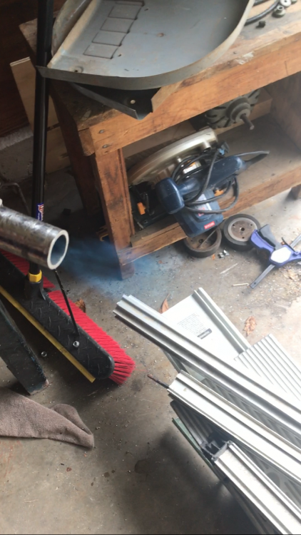

81pistolsfiring Posted September 26, 2017 Author Share Posted September 26, 2017 So I think I'm enjoying myself more than I thought I would. I have played around with several designs for burner and I have found the larger mig tip I was a 1" pipe using was producing to much forced gas. I used a 3/4" tube and made air holes for it. Seems to be working well I just need to get a longer pipe and a flare which I think I'm going to have to order online cause I have no way of finding one or making one myself that is properly sized. This is a 0.30 tip in the video. Pipe is only 6" long right now. Open to suggestions if you guys would be so kind. IMG_7021.MOV Quote Link to comment Share on other sites More sharing options...
Frosty Posted September 26, 2017 Share Posted September 26, 2017 Embedding videos means just too large a file size to load. Nobody can give a meaningful opinion from what little information you've provided. Who's plans are you following or are you winging it? Post a parts list and pictures, not videos pictures and we might be able to help. Right now all I can say is; in general a 0.030" mig tip in a 3/4" x 6" burner is unlikely to be very tunable. In the last 6 months I've been wrong enough times you could surprise me. Frosty The Lucky. Quote Link to comment Share on other sites More sharing options...
81pistolsfiring Posted September 26, 2017 Author Share Posted September 26, 2017 I saw a video on the you tube by Dave Hammer and he demonstrated how to build one of Steve Genshiemer's burners. Looked simple enough and I had the parts for it... kind of. The design calls for a street elbow which I don't have avalible (of course I can pick one up) so I went straight into the burner with the mig tip and have it set with a couple of bolts to hold it in place Which these are temporary too. Like I said before I don't have a flare yet which is a big part of the tuning process with this type of burner but I was just happy I got a steady flame and wanted to share. I do think this burner tube is to short with how hot it is going to get. Hopefully these pictures work better than the video attempt. Oh and it's light out in these pictures so it is a little hard to see the flame. Let me know what you guys think. Quote Link to comment Share on other sites More sharing options...
