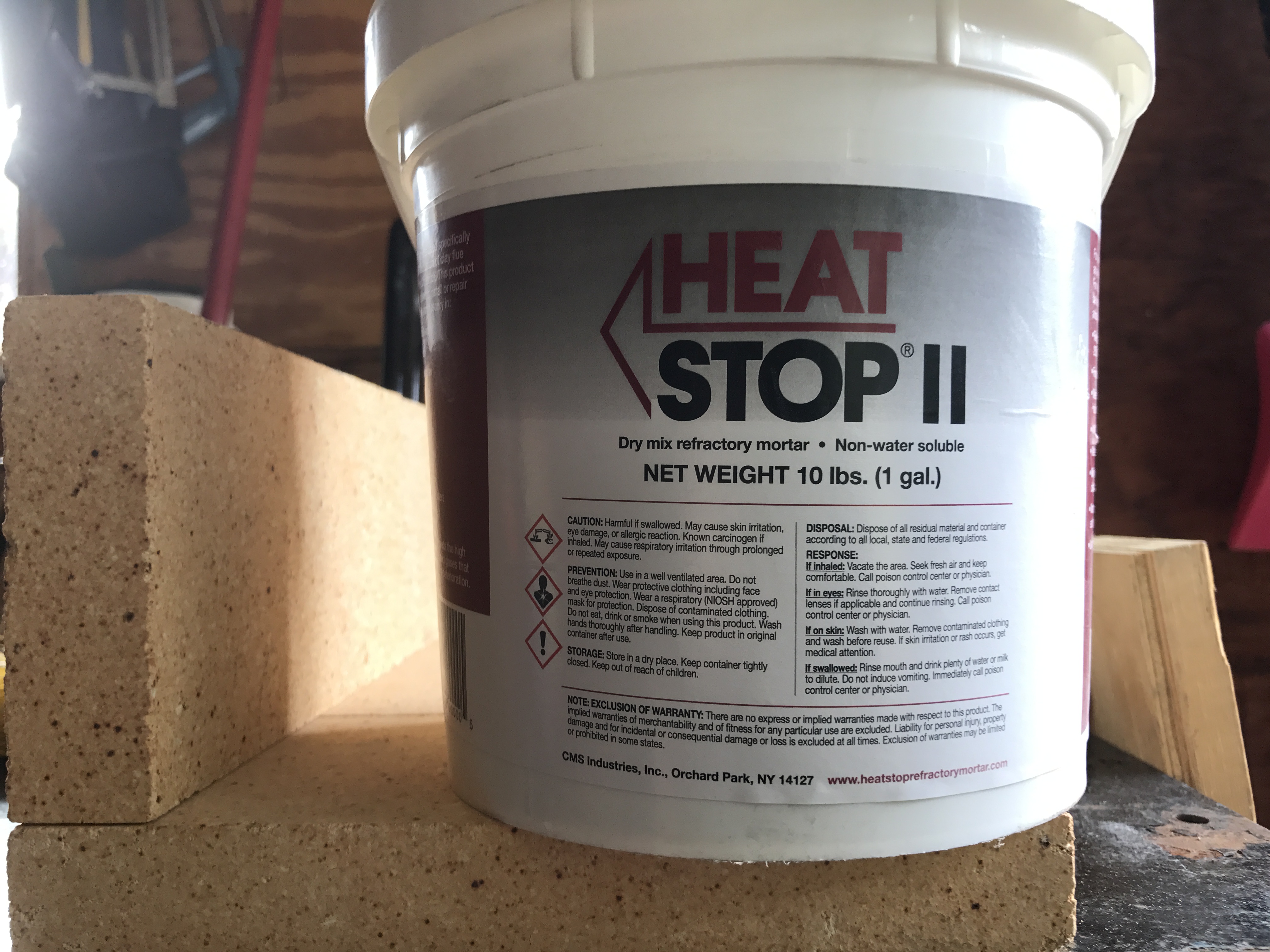

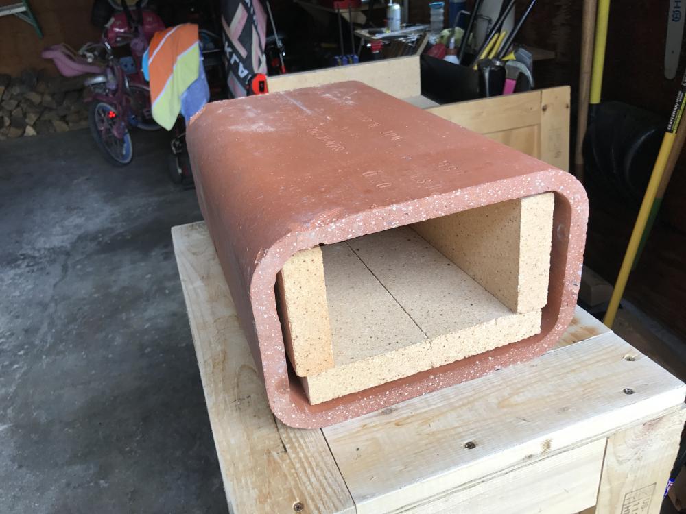

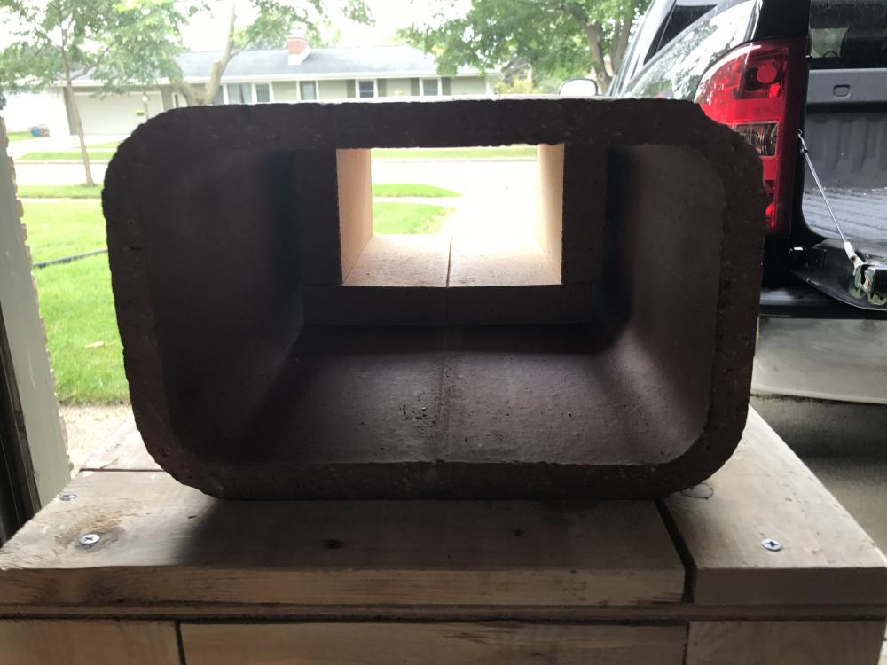

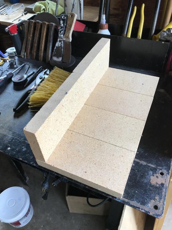

81pistolsfiring Posted September 5, 2017 Share Posted September 5, 2017 Hello, new here. Just joined. Need advice building a forge. This is what I have so far. (Pics below) limited knowledge but gotta start somewhere. Just insterested in knife making for now. Debating where to utilize this chimney flue for added heat barrier. Or just go with the brick and angle iron for support. No welder... yet. Plan on using propane as my heat source. Any advice or tell me I'm all wrong... I'm ok with that too. Thanks Quote Link to comment Share on other sites More sharing options...
ThomasPowers Posted September 5, 2017 Share Posted September 5, 2017 Looks to be a real fuel hog and will run through enough propane to pay for a more insulative refractory in a short amount of time. Is this based on a design posted somewhere; or are you designing it without the background in smithing needed? (Would you drive a car designed by someone who has never driven one?) There is a thread of forge building for propane forges: under Forges, Gas Forges, Forges 101; may I commend it to your attention before you go any farther? (the firebrick splits will make doors and maybe a wear plate for the bottom of the forge, (kiln shelf is better for the floor though). If you were in the USA you could try to find a local ABANA Affiliate and attend some meetings and ask to see various proven in forge designs. There is an association in Canada and the UK as well. Quote Link to comment Share on other sites More sharing options...

Charles R. Stevens Posted September 5, 2017 Share Posted September 5, 2017 We are not trying to pick on you, 81. We have just been around the block a few times. I acualy think the clay flue has a cool factor as a forge body, but as pointed out your combination for a forge that will not be running 24/7 is not effecent. First, for raging knives a single burner about 8" deep is what you need, for heat treatment a longer forge, but many knifemakers are recommending single burner vertical forges for that. Quote Link to comment Share on other sites More sharing options...

Frosty Posted September 5, 2017 Share Posted September 5, 2017 Welcome aboard 81, glad to have you. If you'll put your general location in the header you might be surprised how many of the Iforge gang live within visiting distance. In general brick pile forges are useful for testing: shape, size, burner alignments or as quick expedient forges. In general hard fire brick has an insulating value of an equal thickness of lime stone. R1= 1 foot of limestone. It's the basis of the R Value numbers . Anyway, hard brick is a serious heat sink, it takes a lot of fuel to bring to the desired temperature, say mid yellow around 2,600f. The heat will be conducted through and radiate or conduct away on the outside. Light, insulating fire brick is significantly better insulation and not so much of a heat sink but it's fragile and only takes a few thermal cycles before starting to degrade. (crumbles) Recently Mike posted information about a high temperature insulating refractory ceramic that looks very promising. I haven't tried it and am waiting for people to use it and report in. Your current post just came in. I'm not the Dwarf but AM known as a butttinsky on occasion. Were I you I'd take a breath and do some reading. It's good to jump into new things but its even better to know which end of the pool you're diving into and how deep it is. Rushing is how I make my worst mistakes, that and making decisions when angry. Anyway, take some time, do some reading and things will work out better. Patience will be rewarded. I'd keep the split brick handy, I have a box of hard and a box of soft fire brick close to my forge in case. Some things just need a fire brick and nothing else will do. You can bolt screw and rivet most everything necessary for a gas forge. Welders are nice but not necessary. Charles is exactly right, you can only forge a few inches at a time, 6" is a good number. Heating more than you can work is that extra steel suffering high temp changes without being refined under the hammer. Heated above critical and steel starts to crystalize, common term is (grain growth) and crystal boundaries are weak points that make steel brittle. Heat treating blades is a matter of watching the steel in the forge and moving it back and forth to keep the temperature even. A short forge works as well as a long one and it's much easier to keep even heat in a short forge. Thomas just posted, good. Check out Wayne's site if nothing else he sells reasonable amounts of the materials you need to build a gas forge. The plans on his site are sound and proven good designs. Reading will not only give you a handle on forges but will give you a handle on the craft jargon so you can ask good questions and understand the answers. We'll be around and answer questions. They've been answered already, many times but I'm hanging around. Frosty The Lucky. Quote Link to comment Share on other sites More sharing options...

81pistolsfiring Posted September 5, 2017 Author Share Posted September 5, 2017 You guys think if I made a small one out of just the brick I have and lined the inside with koawoll it would work ok? I realize now I purchased the wrong fire brick Quote Link to comment Share on other sites More sharing options...

Binesman Posted September 6, 2017 Share Posted September 6, 2017 1 hour ago, 81pistolsfiring said: You guys think if I made a small one out of just the brick I have and lined the inside with koawoll it would work ok? I realize now I purchased the wrong fire brick I can only speak to this as theoretical as i have not done so personally. My understanding from research is that with 2 to 3 inches of insowool the outer shell is somewhat irrelevant (other then staying away from anyrhing with zinc). I have seen videos of people rolling insowool up holding it in place with a piece of wire and using it as a forge. Again this is theory and if im qrong hopefully someone with experience will correct me. Either way be sure to rigidize the wool before use. Quote Link to comment Share on other sites More sharing options...
