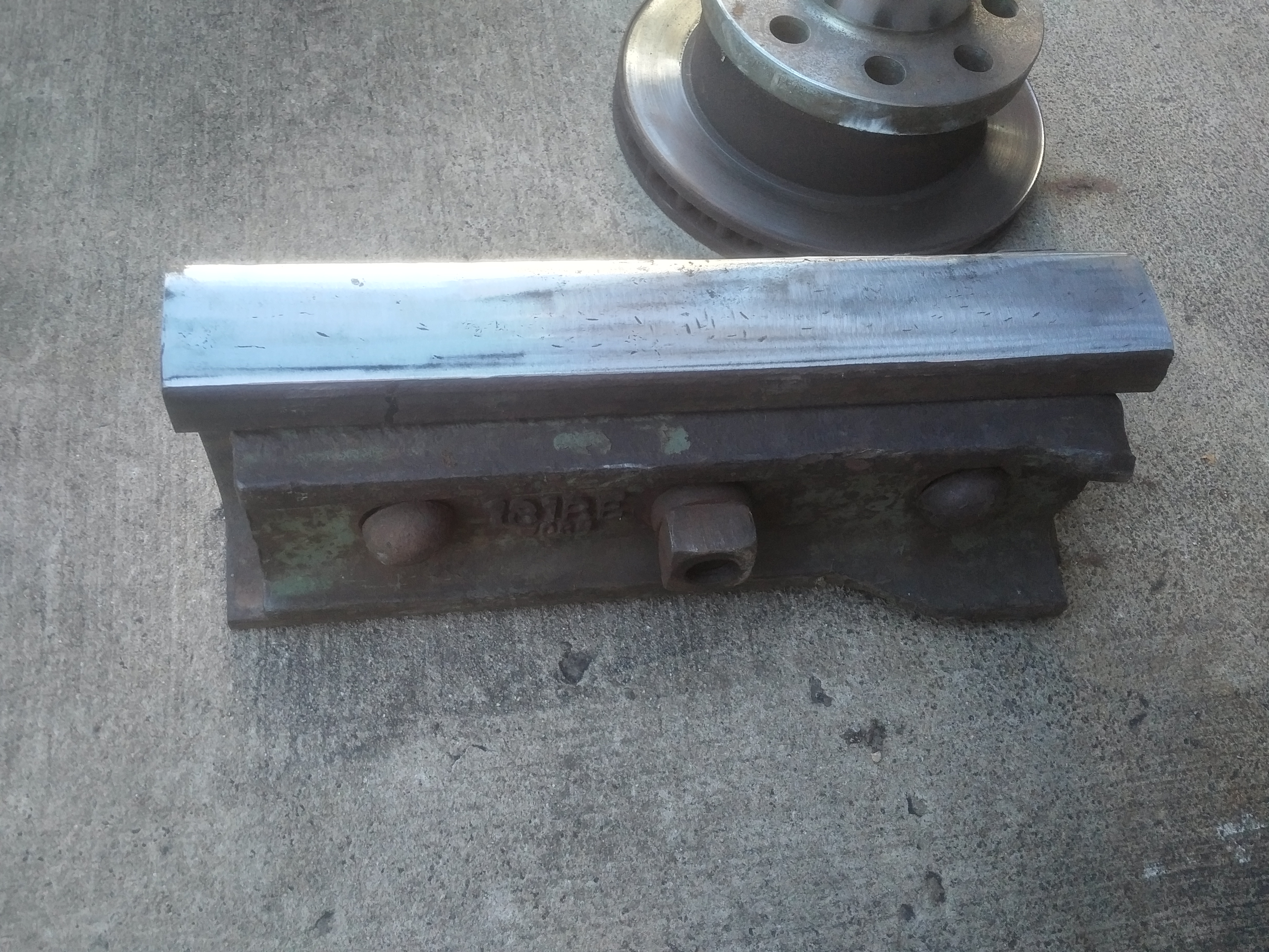

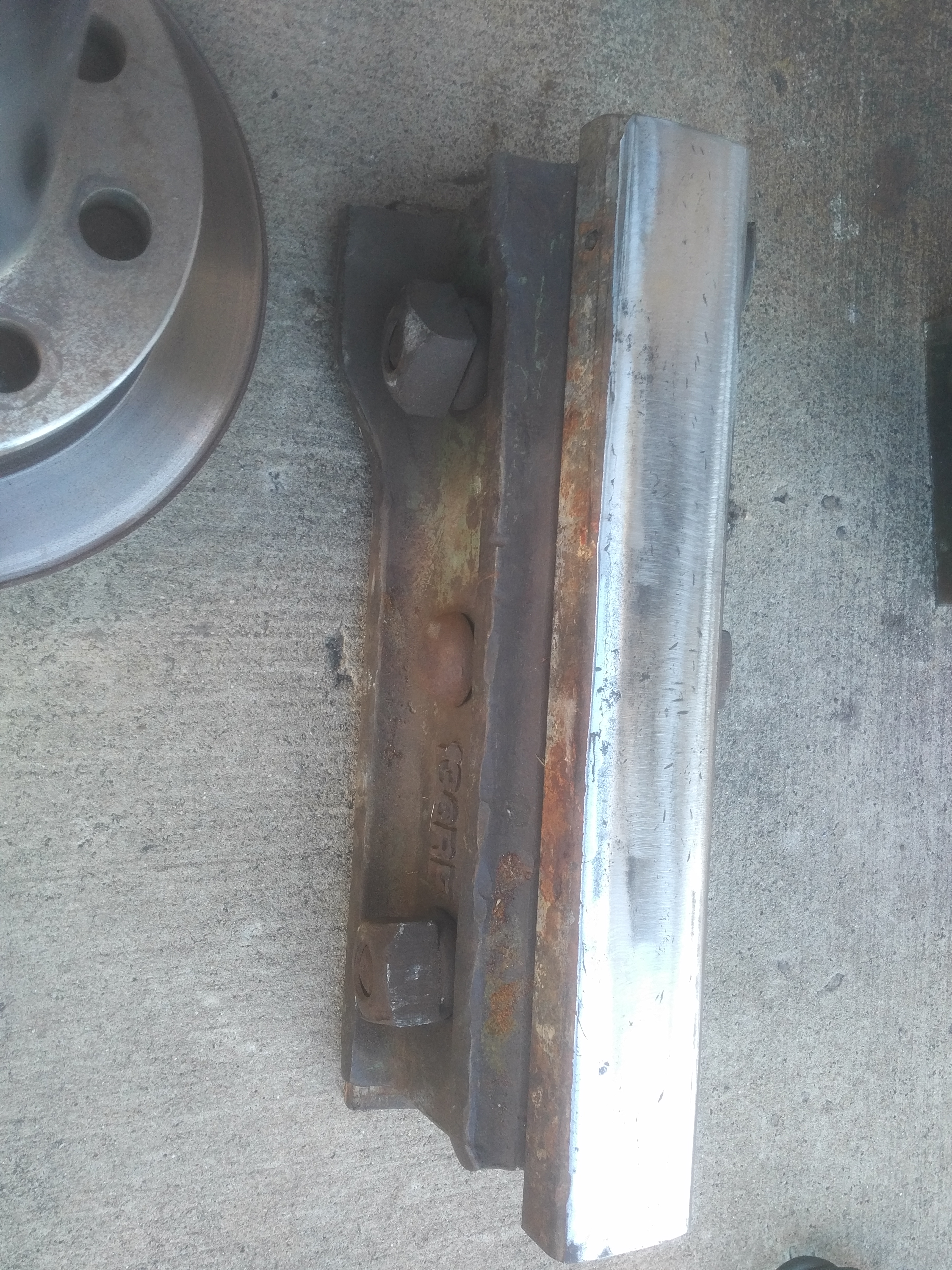

FlatLiner Posted June 2, 2018 Share Posted June 2, 2018 Here is my collection of improvised anvils. The fork lift tine anvil is made out of 2 forks that where 8 inches wide and 2 inches thick. My inspiration was the old mideval German hornless anvils mixed with Brian Brazeal. I wanted an anvil I could use in multiple ways, and I hadn't seen one made exactly like this. It weighs somewhere between 435 -450 lbs. It's final dimensions are the face is 8 inches wide, 2 inches thick, and 26 inches long, it is 12 inches tall. The Brian Brazeal style riser/ horn is 4 inches high. It is completely reversible. Total cost was $50 for the used tines and $25 for cutting wheels, flap wheels, and welding rod. Total $75. The post anvil is 20.5 inches high and 5 inches in diameter. I was told that it was the ram off an oil drilling rig and that it was made of some Chinese super steel that I can't remember what it was, it's weight is about 120 lbs. The rail road track is 19.5 inches long and is supported by a fish plate cut in half and bolted back on to help keep the middle Web vibrations down. I got the inspiration for this one from Moose Forge, it's weight is 136 lbs. I bought the post anvil and track from a blacksmith who was moving. The cost for these two where $62. I put my 125 lb soderfors in front of them for size reference. Quote Link to comment Share on other sites More sharing options...

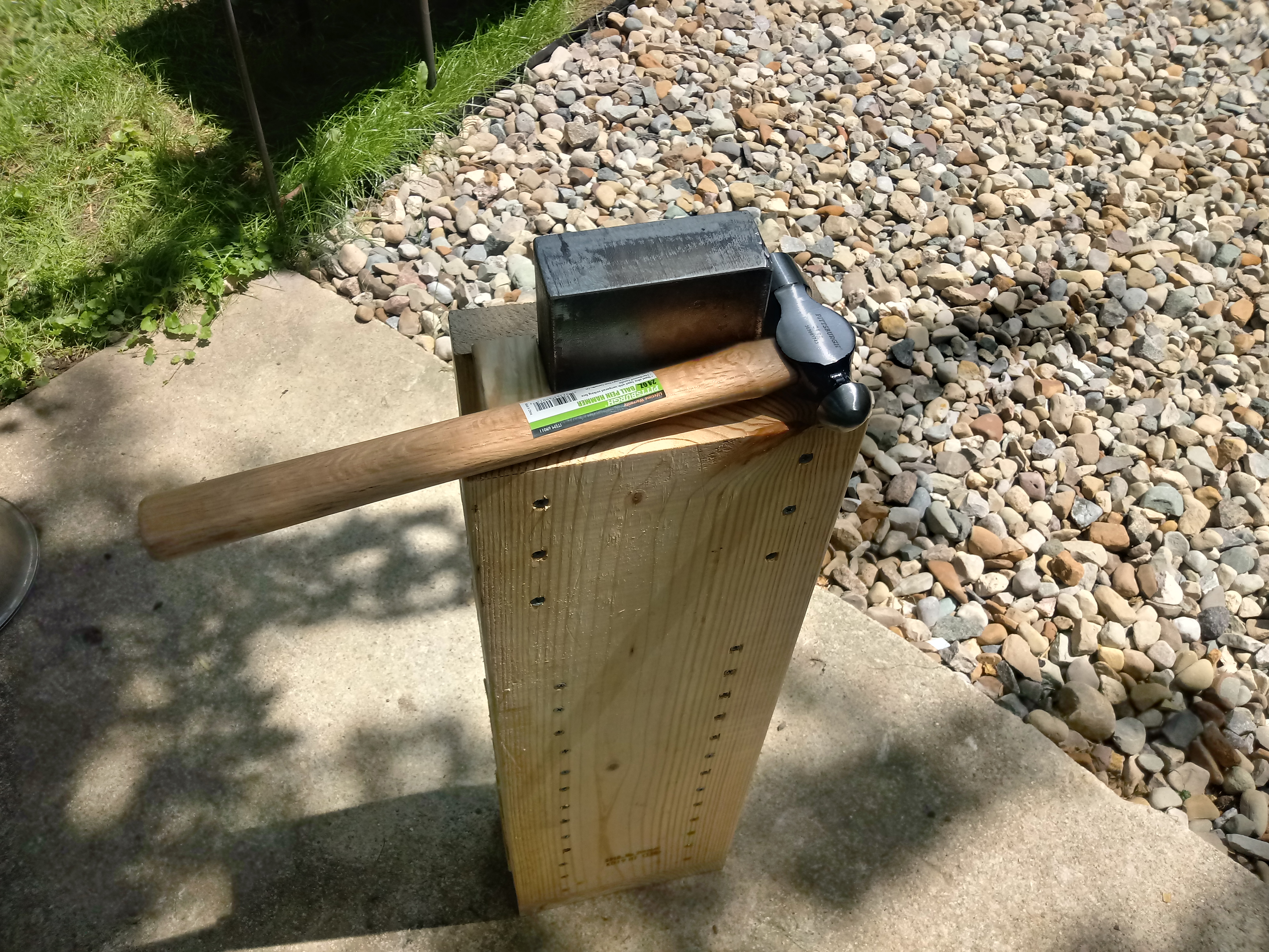

Bob Lebo Posted June 24, 2018 Share Posted June 24, 2018 First project related to setting up my low-budget beginner forge - the anvil/stand. Being improvised, I figured this would be the right place to put this. The anvil was an ebay find - ~34 lb piece of forklift tine (2"x5"x12"). I made the stand out of a single 8ft board of 2"x10". I may add to the base to build up more stability, or at very least put it between a couple solid concrete blocks. I've got another board for making a jabod- so hopefully I'll be hitting hot steel next weekend. And, if I ever get a more traditional anvil, this could easily be put on it's flat side to be reborn as a striking anvil. Quote Link to comment Share on other sites More sharing options...
Charles R. Stevens Posted June 25, 2018 Author Share Posted June 25, 2018 Looks like an anvil to me Quote Link to comment Share on other sites More sharing options...
