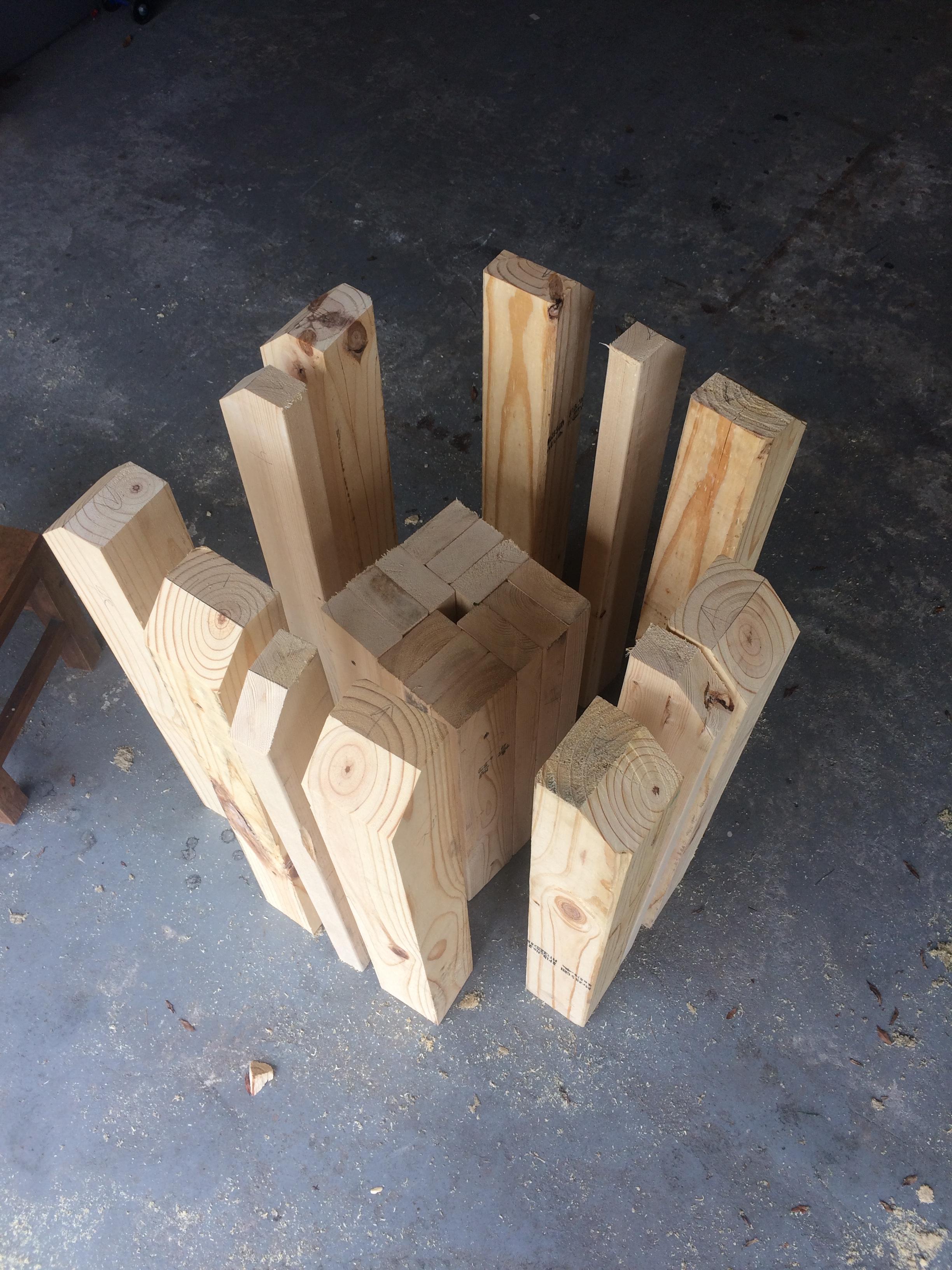

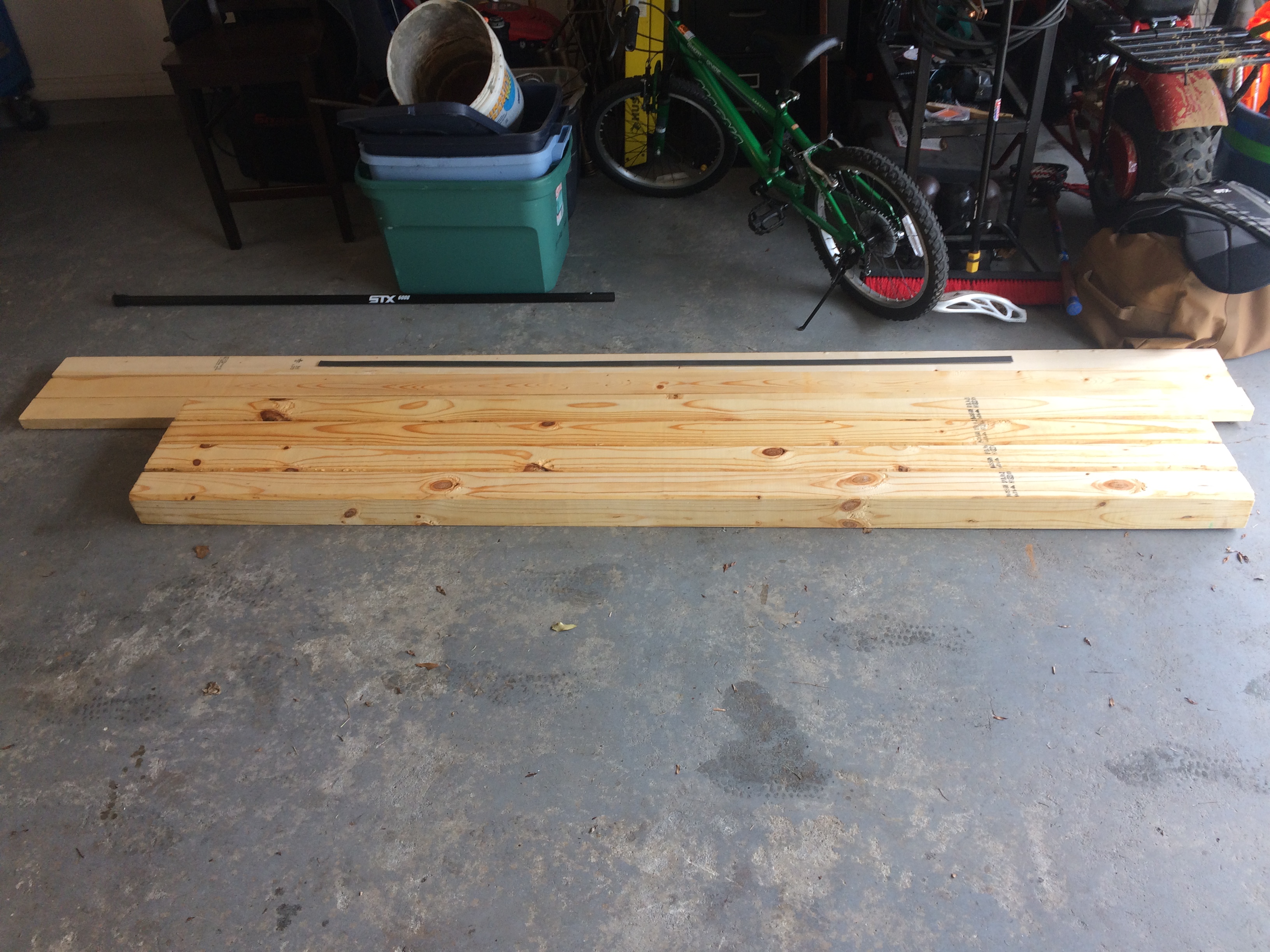

KC-130J Posted March 18, 2018 Share Posted March 18, 2018 Thanks for everyone’s insight. It seems like it’d be too much trouble to attempt to harden my mystery metal. Now I thought I’d show the stand that I made. In the first picture I started with (3) 10’ 2x4s, (4) 8’ 4x4s, a 6’ piece of 1” wide steel, a box of 3” screws, (24) 4” lag screws, and a coulple tubes of liquid nails. Next I cut (12) 20” long pieces of 2x4, (4) 28” long pieces of 2x4, (12) 28” long pieces of 4x4, and (4) 18” pieces of steel. I glued and screwed together the 20” long pieces of 2x4s. This is what my metal will directly sit on. I knocked a quick 45 degree cut on the top of each piece of 28” 2x4s and 4x4s. These are places around my 20” tall block to make a pocket for my steel to be supported laterally and make a wide base. Glued, counter sunk and predrilled for the lag screws to hold everything together. Finally I added corner 4x4s and bent the steel to bolt it all together. I may add another steel band on it in the future. Now all I have to do is add some wheels to it so I can move it around. Quote Link to comment Share on other sites More sharing options...
Charles R. Stevens Posted March 18, 2018 Author Share Posted March 18, 2018 All that maters is it works and is safe. Looks good on both fronts Quote Link to comment Share on other sites More sharing options...

NoName Posted March 19, 2018 Share Posted March 19, 2018 3 hours ago, KC-130J said: Now all I have to do is add some wheels to it so I can move it around Wheels, may be the a weak link? Adding a round base may help it roll, when tipped at an angle. N.N.F. Beautiful, Manchester, Michigan. USA Quote Link to comment Share on other sites More sharing options...
Charles R. Stevens Posted March 19, 2018 Author Share Posted March 19, 2018 A threaded stud would work, tread it in the anvil and drill a slightly undersized hole to drive the pin into as to wheels, mount them in the side so the weight rests not on them but the stump, tilt the stump back on the wheels to move. Think of it as a utility dolly or appliance truck. Quote Link to comment Share on other sites More sharing options...
KC-130J Posted March 19, 2018 Share Posted March 19, 2018 On 3/18/2018 at 9:24 PM, Charles R. Stevens said: as to wheels, mount them in the side so the weight rests not on them but the stump, tilt the stump back on the wheels to move. Think of it as a utility dolly or appliance truck. That’s exactly what I was imagining. Since my utility dolly is presently being used as my oxy/acetylene dolly I was just going to add some wheels to one side and about 1/2” off the ground. Then all I have to do is tip it back onto the wheels and I’m not dragging 275 lbs of wood and metal around on the ground. Quote Link to comment Share on other sites More sharing options...
Charles R. Stevens Posted March 19, 2018 Author Share Posted March 19, 2018 They don’t even meet to be off the ground, just not under the stump. If you are using fixed dolly wheels (as a posed to the casters) then set up the stump and anvil, position the wheels on the ground “behind” the stump and attach them. If you are using somthing with an axle like alliance solids use then of corse you mount them a bit difrent but the wheels still touch. Quote Link to comment Share on other sites More sharing options...
