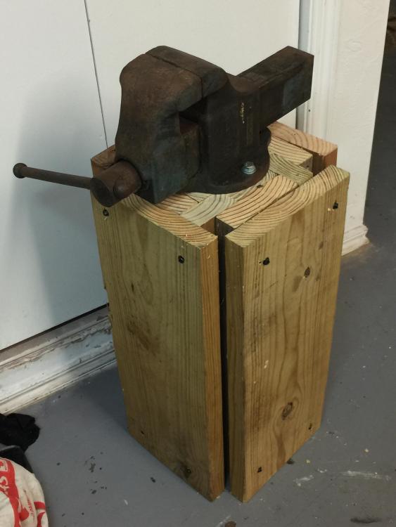

My first project basically chose itself because it was something that I already felt I had the materials for laying around my house.
The Anvil block:
Note: all the wood in this was farmed from my own scrap pile at the back of my property.
However, when I started hogging out the hole for my anvil to recess down into, I quickly noticed the critical downfall to my design. The 8" lag bolts I used to suck it all together intersected at the middle and prevented me from going down any further than 1 1/2" and I needed to go down 4". So a little brainstorming, and a little frustration resulted in me repurposing my "anvil block" and making it a "Vice block" as I do not currently possess a work bench to mount a vice to

That is a good idea. I need to measure jaw height and compare it to my plans for my new anvil setup. May have to put a spacer to raise the vice.
That vice is an old Columbia that my great grand father bought and passed to my grandfather, then to my dad, and now to me. It's marked NO 504. Don't think a lot of monetary value but priceless to me considering it's one of just a small handful of things that my family has passed down through 4 generations.
Yeah, based on the feed back I got in another post about my block, I've decided to actually cut those outside boards flush with the next layer in to alleviate that partially closed off gap. I originally put those 4 gaps in on purpose to use as accessory holes but I can definitely see the design flaw there.
