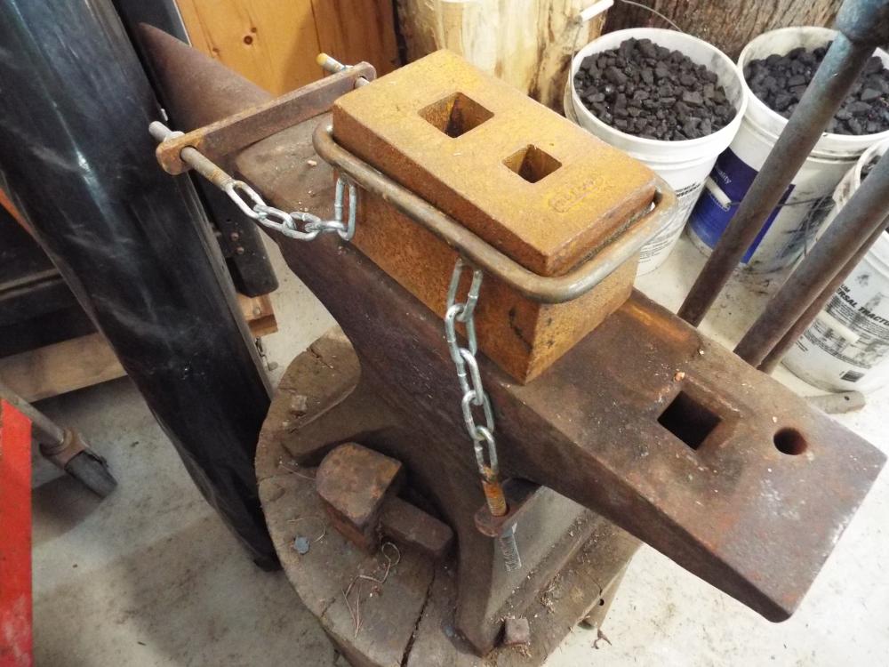

@notownkid has a portable hole that bolts to the top of the anvil; maybe we can get him to post a photo.
this is what I have, won it in a drawing at NEBs not sure if they still have?
I don't see it on the website, but maybe @Judson Yaggy knows more.
 A while back, I saw a video of someone (was it Mark Aspery?) using one of these to upset the blank for a hardy tool. One thing that struck me was how its thickness put the workpiece very high up, almost too high for comfortable striking.
Bob Menard of Ball and Chain Forge in Portland Maine sells those, google for contact details.  I don't believe they are technically NEB product, but since Bob runs our casting program and has these made for himself, and often donates one to the raffle, that is perhaps a distinction without a difference.

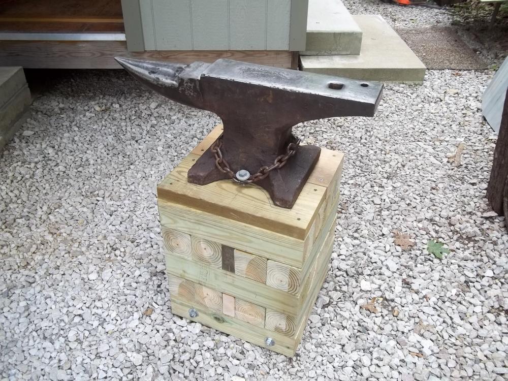

Anthony, when you assemble your anvil stand from the dimensional lumber, I would strongly recommend either screwing or bolting the individual pieces to each other in addition to any gluing and straping.  Better still, run some allthread through them as best as possible.  You would be surprised with heaving hammering, how soon the unsecured individual boards will work loose.  If you can get several 4x4's they work great as well.  Some folks bolt them vertical, some horizontal like this.  These are all bolted together with 6" lag bolts (not visible).  This was made square so I can move it around easily with a hand cart.  This one is now several years old and solid as a rock.
Off the top of my head I don't know the names, the scrap yard is down the tracks from the viadoc, north of the fairgrounds, past the animal shelter. The rail maintinance yard is a couple of miles north of the county courthouse. As to steel yards, the one in chickasha (acualy east of it) is out last Chickasha meat procesing.
All the lumber was cut from scraps that I had left over from a deck project that I did. Most of them have bows and bends in them so I was planning the slather it up with wood glue and then use clamps to pull each piece straight before being screwed together. I'll start with the 4x4 In the middle and work my way out until they are all one piece at which point I am planning to run 2 pieces of all thread from each direction and finish with steel straps accompanied by a hearty coat of poly as this will probably spend a lot of time outside.

I was given the old oak boards from a junked horse trailer, cut them to size and then took a piece of I beam and lined them up on it and clamped them solid with pipe clamps and drilled several holes in them using an electrician's drill bit designed to drill holes in a stud wall and ran bolts from utility poles and guardrails---plenty strong!---through them and snugged them tight.  No glue, no fancy; been working fine for several years---even the last one I did using a heavily worn board that is "rustic" in the extreme!  They stay under a dry roof though, (and finally got all my using anvils enstumped! Made getting the teaching anvils to class a lot simpler when I didn't have to go round stealing stumps from shop anvils, the shop anvils being considerably heavier than the travel anvils...)

Horizontal stacking tends to lose energy in all the interfaces compared to vertical stacking.  As the amount of wood used is the same either way, I suggest doing a vertical assembly!
Ya know...after I built that stand several years ago, I read the same thing; that it was better to stack the 4x4's vertical...too late now!!  Ain't about to take that bugger apart!!!  Maybe on the next one.  I think there is more lost energy in these old arms than there is in the anvil stand!!!!!!!!!!
I did notice one thing though, that I originally had the anvil on a stump about the same diameter as the block construction is wide and found that the block was more stable, even not being buried in the soil but rather riding on gravel.

Well I've been up all night working on it. I decided if I was going after an anvil object this weekend, then my block needed to be ready to mount up... so here it is. Each board is glued and screwed to the boards touching it and then 4x 8" lag bolts from each side. All that's left is to smooth out the top with a quick belt sander pass and to slather it up with polyurethane to weather proof it and fill any cracks. What do you guys think? I know it isn't perfect, each piece was cut from scrap that's been under my deck for almost a year so a lot of work went into pulling all the bends and bows straight.
Regarding the holes at each corner, I'm planning to drive a piece of 1/2" pipe down each hole to use for accessory holes (like a Hardie?)
I'd put short pieces of square tubing to hold hardies handy,  cut the corners an inch or so down and fold out the tabs and maybe cut off the tabs that would overlap.
I've no problem going fancy save when it interferes with folks getting off the internet and on the anvil!
I would've suggested a less fancy pattern but it'll work fine just don't get all carried away making it "perfect." Ain't no perfect out there in human land, good enough for an anvil stand is solid, the right height and doesn't rock. Securing the anvil to it is just a matter of picking a method and applying it, just a finish detail really.
