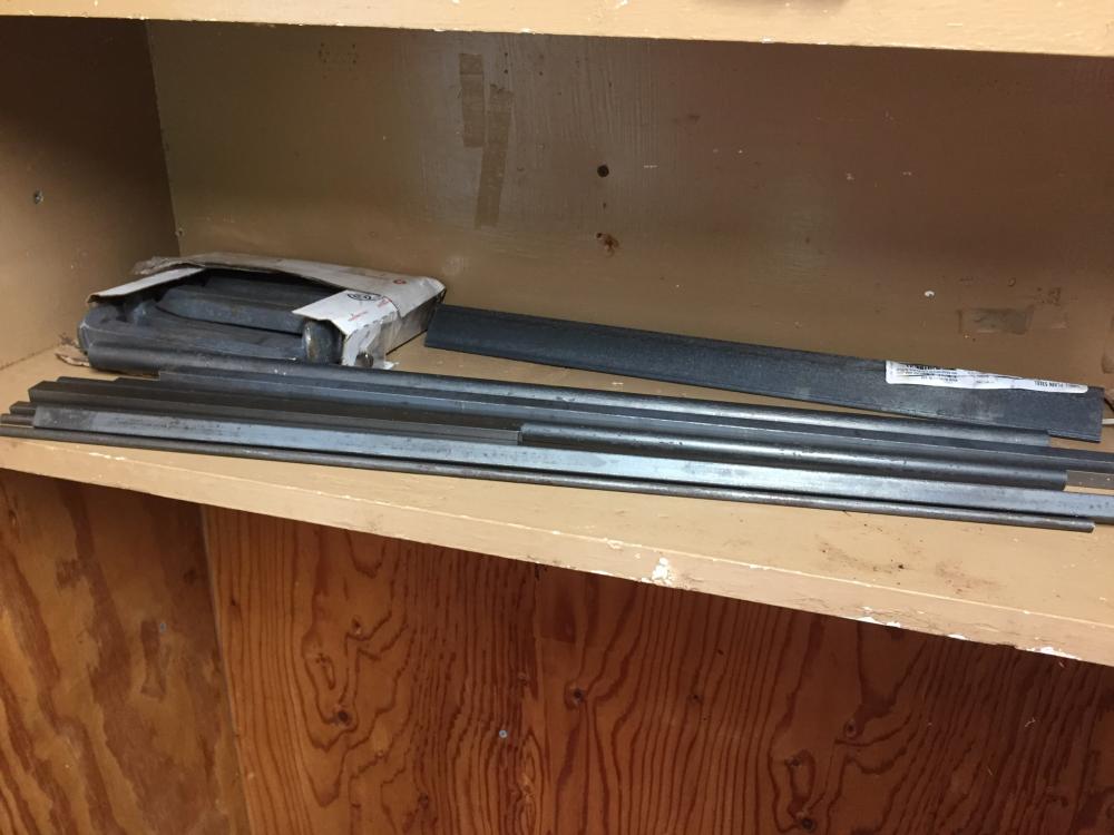

CHUCK M Posted August 5, 2017 Author Share Posted August 5, 2017 So tonight's the night, going to be swinging the hammer for the first time!!! Here is some pics of the 95% competed work area, maybe went a little over board but starting out good. I added a harbor freight special 1 x 30 grinder that I got for $40 that works better than I expected, tested it on the angle iron I used for securing the anvil. Have a good variety of steel to start with and some railroad spikes, also bought a set of "rapid tongs" off eBay that just require some modifications and shaping, seemed like good practice at a fair price. Lit the forge up once to soap the fittings and checked for leaks, after taping threads and assembling....flame seemed rough, I haven't done much research on tuning yet. Going to start out with the standard j hook and s hooks. Will post a thread in the project section if anyone is interested in following, again thank you everybody for the advice, and will add to this thread as the shop changes. Quote Link to comment Share on other sites More sharing options...

CHUCK M Posted August 5, 2017 Author Share Posted August 5, 2017 38 minutes ago, mutant said: Looks like a great smithy! Enjoy your new setup and let me know how you do with the rapid tongs. I've been debating getting a set. Will do, going to wait a little so I don't screw them up. On another note I feel like in am going to run into the same issue you had with the raised wooden floor, no pad underneath and have suspicion that there is several inches of nothing between the ground and floor. Quote Link to comment Share on other sites More sharing options...
51 Papy Posted August 6, 2017 Share Posted August 6, 2017 Chuck You might want to think about moving your vise out to the edge of your bench. That allows you to put a long piece of metal straight up and down...guess what I did today. Great smithy! Enjoy Quote Link to comment Share on other sites More sharing options...
mutant Posted August 6, 2017 Share Posted August 6, 2017 4 hours ago, CHUCK M said: Will do, going to wait a little so I don't screw them up. On another note I feel like in am going to run into the same issue you had with the raised wooden floor, no pad underneath and have suspicion that there is several inches of nothing between the ground and floor. I get a lot of comments saying that I should cut a hole in the floor and place my anvil stand through it and also several feet into the ground. That's probably the best solution but I didn't want to do that. Instead, I was able to get a few 18x18 pavers wedge between the floor joists and the ground. It did help. I also made a hollow anvil stand and it's filled with sand. Quote Link to comment Share on other sites More sharing options...
CHUCK M Posted August 6, 2017 Author Share Posted August 6, 2017 9 hours ago, 51 Papy said: Chuck You might want to think about moving your vise out to the edge of your bench. That allows you to put a long piece of metal straight up and down...guess what I did today. Great smithy! Enjoy Yea I thought about this after the fact, I made a spacer out of scrap wood and angle iron to solve this problem temporarily. 7 hours ago, mutant said: I get a lot of comments saying that I should cut a hole in the floor and place my anvil stand through it and also several feet into the ground. That's probably the best solution but I didn't want to do that. Instead, I was able to get a few 18x18 pavers wedge between the floor joists and the ground. It did help. I also made a hollow anvil stand and it's filled with sand. Exploring all options at this point but going to be a while before I do anything about it right now, thought about cutting the hole making the stand off the ground and also putting in a concrete pad, we'll see. Quote Link to comment Share on other sites More sharing options...
