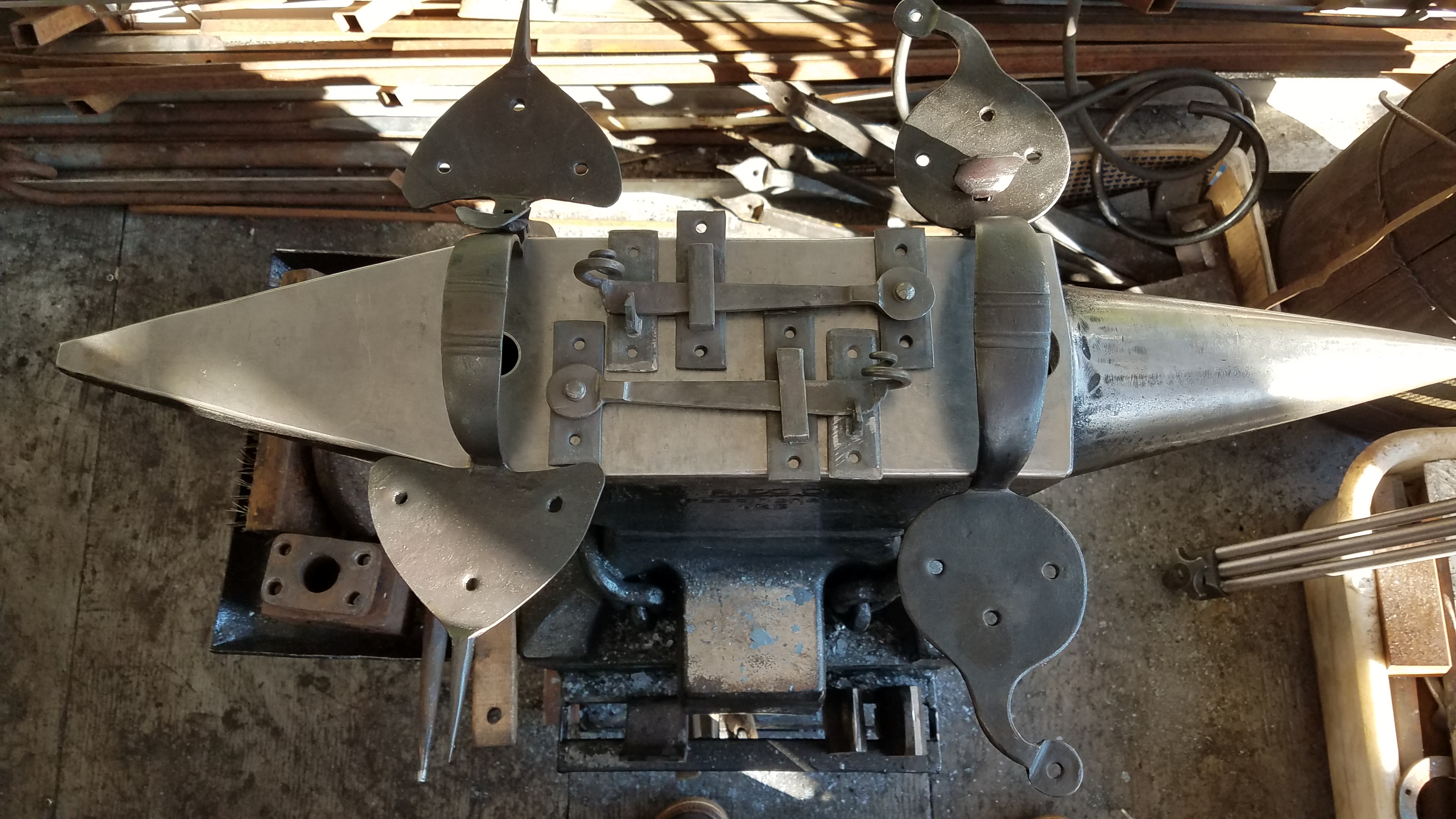

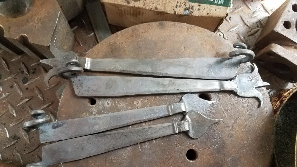

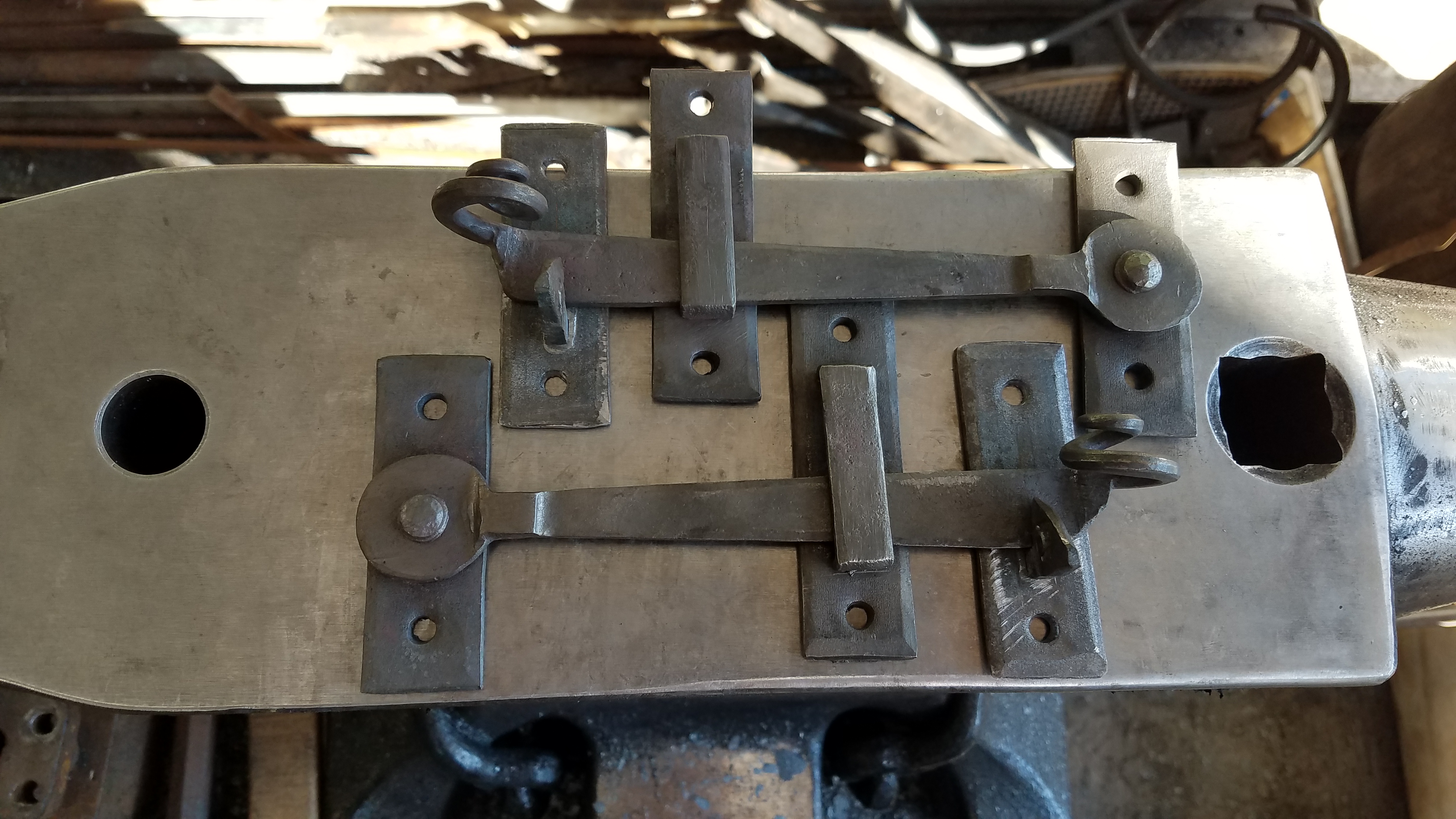

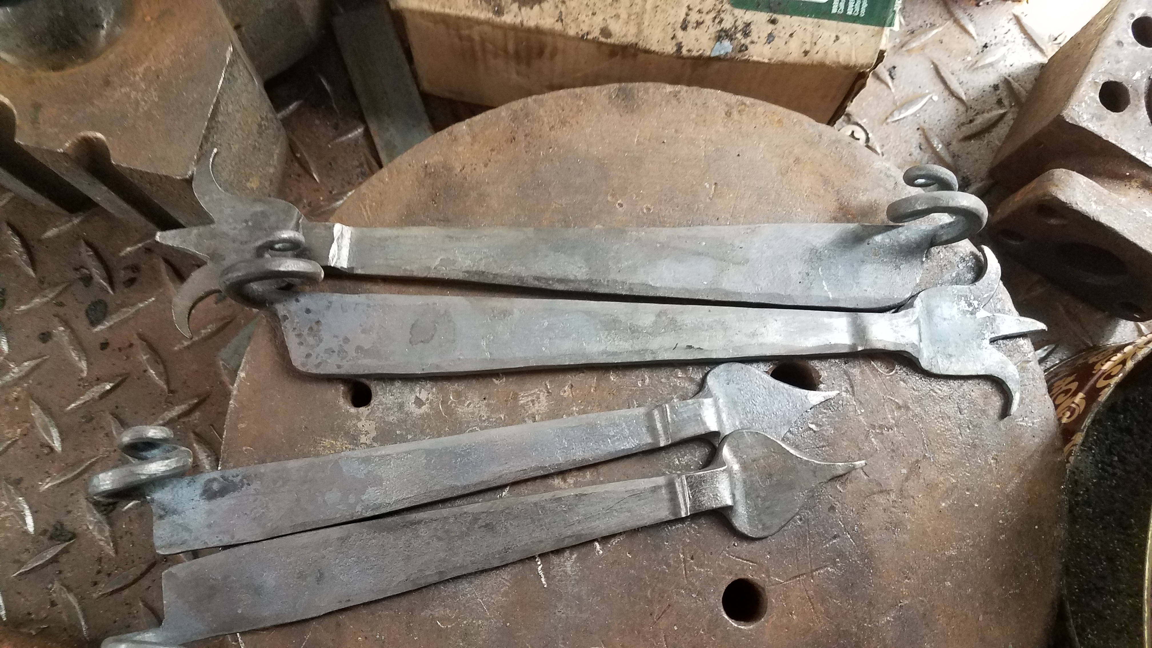

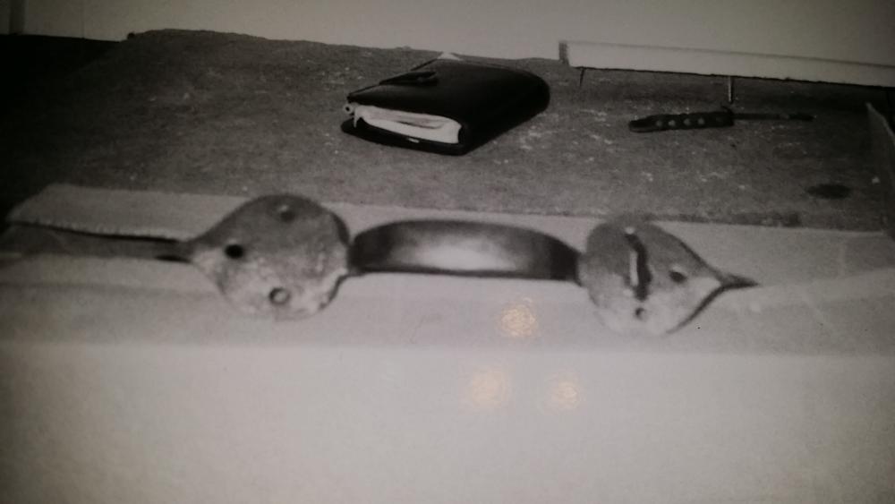

jlpservicesinc Posted July 10, 2017 Share Posted July 10, 2017 Skill set and hand eye slowly coming back.. Still some mistakes here and there, but it's nice to see progress being made.. "Works in progress".. So, I need some items for the table at demo's and such. And had an order come in for the hinges and the set of back group with escutcheon plates shown with the thumb latches.. I was asked to come to another demo.. Still now sure which ones I want to do.. But had 2 sets of hinges at the last show and now they both will be gone to their homes so have to start making replacement pieces.. Quote Link to comment Share on other sites More sharing options...

bluesman7 Posted July 14, 2017 Share Posted July 14, 2017 Very nice. I wish I could see the pieces in hand. Quote Link to comment Share on other sites More sharing options...
jlpservicesinc Posted July 14, 2017 Author Share Posted July 14, 2017 3 hours ago, bluesman7 said: Very nice. I wish I could see the pieces in hand. Thanks. Do you mean personally, or for measurements/comparison with a hand? The anvil is 5.5" wide. Not sure if that helps. Quote Link to comment Share on other sites More sharing options...

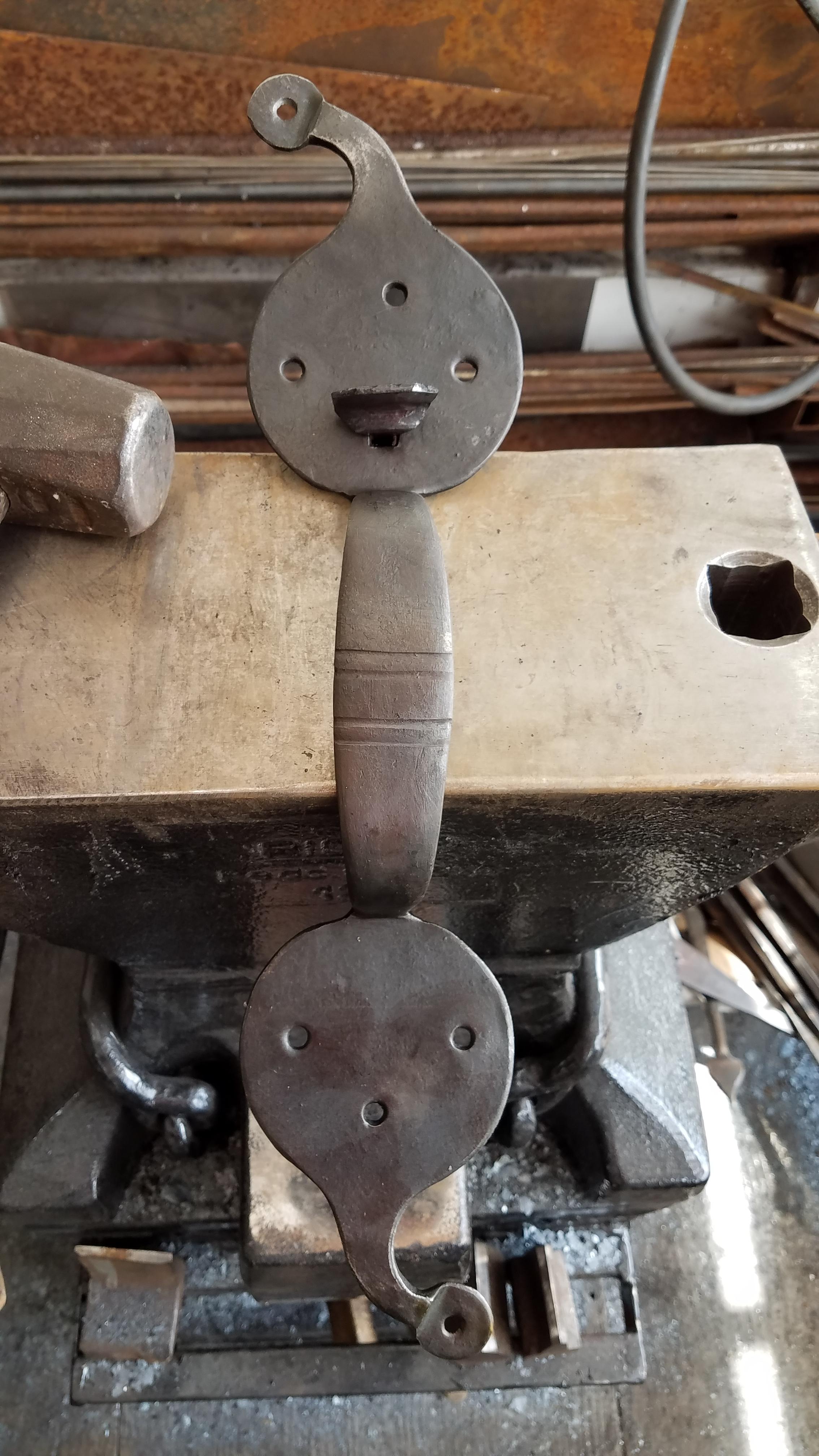

Lou L Posted July 14, 2017 Share Posted July 14, 2017 That's beautiful work. Being selfish, I sure would appreciate a video on how you make that handle hardware. It has excellent symmetry. Do you use jigs or hammer it all by eye? Quote Link to comment Share on other sites More sharing options...

jlpservicesinc Posted July 14, 2017 Author Share Posted July 14, 2017 2 hours ago, Lou L said: That's beautiful work. Being selfish, I sure would appreciate a video on how you make that handle hardware. It has excellent symmetry. Do you use jigs or hammer it all by eye? Thanks, for custom pieces like these they are all done by hammer and eye on the first cusp.. Then done by eye on the second cusp till about 98%.. The last 2% is done to a sketch of the first cusp laid out on the anvil.. I might put out a video on the process at some point but the filming is problematic.. Anytime I have to add in vise work it really just changes the whole filming and editing.. I did film footage of making a bar and while it takes about 10minutes to make a bar, It took 30minutes to film a how to on it. I've reached a point where I should probably make a script.. I've simply been filming as I work which is what I like to do, but on stuff like this where there is a lot of fitting, punching things I normally take at full speed have to be slowed down and exaggerated so others can see what is going on.. I'll keep this in mind and might visit... Quote Link to comment Share on other sites More sharing options...

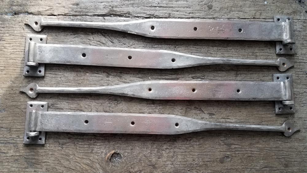

arkie Posted July 15, 2017 Share Posted July 15, 2017 Jennifer, beautiful work on the hinges, latches, handles... Question: kinda hard to tell from the photos, but did you peen the upper tip of the hinge pin on the hinges to keep them from sliding off? Quote Link to comment Share on other sites More sharing options...
jlpservicesinc Posted July 15, 2017 Author Share Posted July 15, 2017 47 minutes ago, arkie said: Jennifer, beautiful work on the hinges, latches, handles... Question: kinda hard to tell from the photos, but did you peen the upper tip of the hinge pin on the hinges to keep them from sliding off? Thanks. No on riveting of the hinge to the pintle pins. Traditionally they were designed to slide off the pintles if the door is open.. The pintles are welded into the bottom boss so will never fail from the bottom.. and when closed the jamb encapsulates the door so it won't ever come off that way.. These hinges were made for interior doors which is different but that is what the customer wanted so everything had to be scaled to look proper in the location.. I'll post pictures of the hardware once it's installed.. Quote Link to comment Share on other sites More sharing options...

arkie Posted July 16, 2017 Share Posted July 16, 2017 9 hours ago, jlpservicesinc said: Thanks. No on riveting of the hinge to the pintle pins. Traditionally they were designed to slide off the pintles if the door is open.. The pintles are welded into the bottom boss so will never fail from the bottom.. and when closed the jamb encapsulates the door so it won't ever come off that way.. These hinges were made for interior doors which is different but that is what the customer wanted so everything had to be scaled to look proper in the location.. I'll post pictures of the hardware once it's installed.. Ok, thanks for the explanation. Quote Link to comment Share on other sites More sharing options...
gote Posted July 16, 2017 Share Posted July 16, 2017 Beautiful Jennifer (Yes you too ) In my part of the world all doors and windows are designed like that so they can be lifted off when open. Some peple used to take out the inner leaf of double doors and windows in the summer but this seems to be history today. Quote Link to comment Share on other sites More sharing options...
