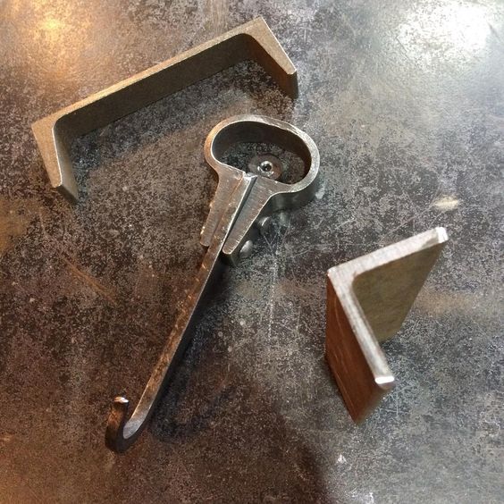

Went to a barn sale today, bought a few hand made tongs and then made a little coal rake from a piece of mystery steel a little smaller than a rr spike. Overall was a good way to spend a morning! Wish I started with a bigger piece of steel to make the rake a bit longer, but I'm still new so it was good practice if nothing else.
You can always make a decorative handle and rivet it onto the rake.  Everyone seems to get stuck on the notion that everything has to be forge-welded and the like, but rivets have been around for ages.
Take a piece of 1/8"x1/2", bend it into a U shape, drill some holes on the ends so you can pass the rivets through....  and you've got a nice clean "stay cool" handle design that also acts as a loop to hang the rake by.
Your coal rake is a fine length, turn off the blower when you rake and you won't get too close to the fire. I'd put a little point on the end and bend it closer to a 90, a little curve is helpful as well. However, a cool handle is a good addition as are decorative twists. The blacksmith's tools often have decorative touches. Coal rakes are often one of our first projects and a good place to experiment.

The bend I believe is a 90 degree, or real close to it, doesn't seem to look like it in the picture tho. Only reason I didn't put a twist in it because everything I make has a twist haha. Does look a little plain the way it is though. Original plan was to put a loop in the end but I didn't want to make it any shorter. Hmmm maybe I'll go put a couple more finishing touches on it today.

I see your handle laying right next to the rake. It looks like an earlier project with a twist and sort of hooks on each end. Draw the longer end to round then wrap it around the end of the rake then secure it with a single rivet at the end.
Irondragon that's a good idea. I should try making projects thatre useful not just practicing drawing out rr spikes and twisting and bending them. I've never tried riveting anything yet so that'll be another good learning experience.
