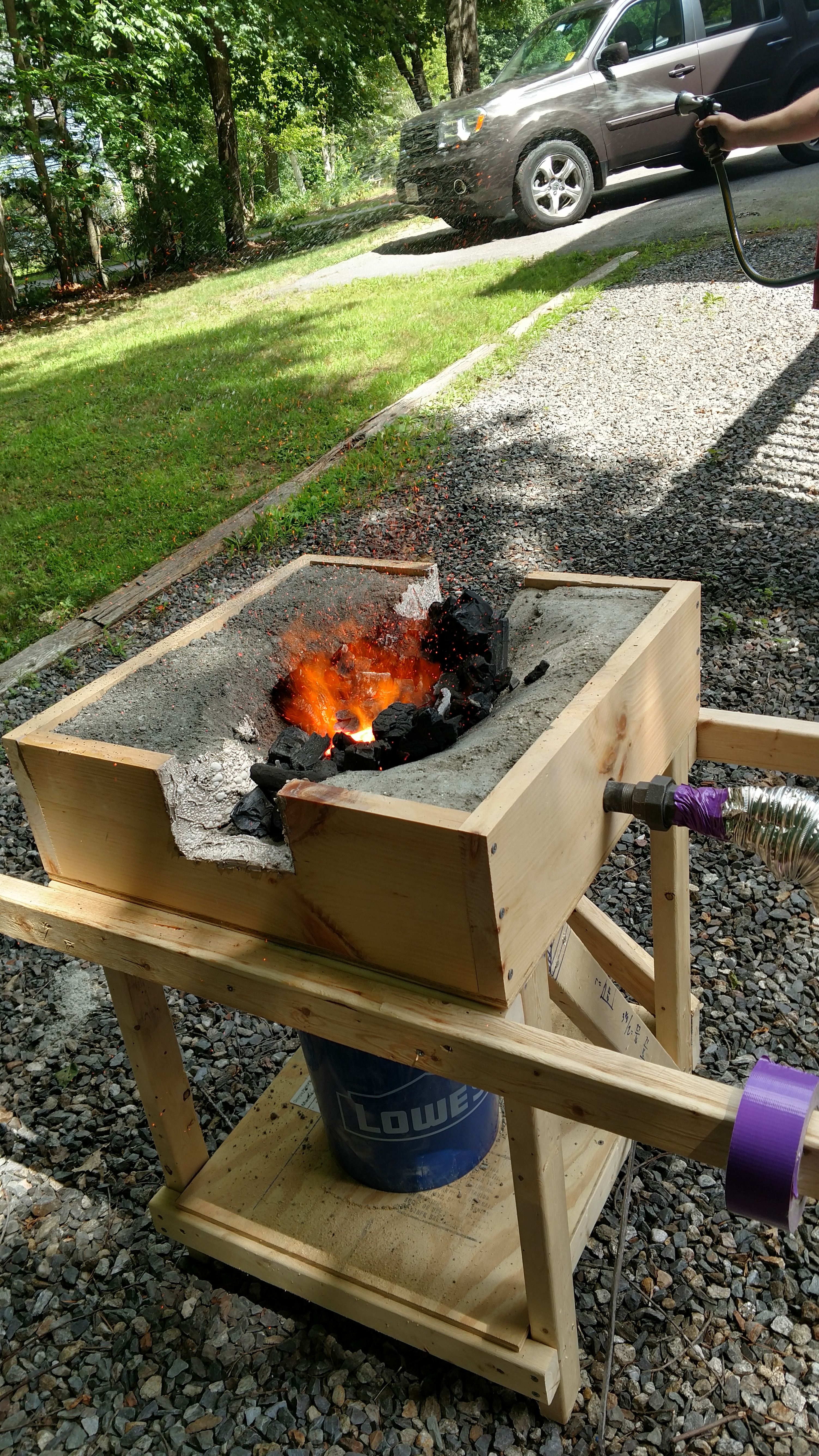

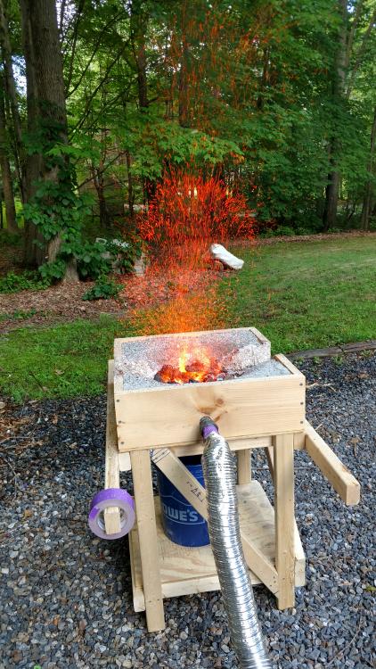

Cappygold Posted July 8, 2017 Share Posted July 8, 2017 (edited) So I basically designed this off of a JABOD forge but used a high heat fireclay as the base foot the mix. It ended up being mostly a mix of 2:1:1 fireclay to sand to perlite. I used Portland cement and more sand for the layer past the 'fire pot' because I needed more volume. Also reinforced the edges or crumbling bits with store bought Hercules heavy body sodium silicate which works like a charm for those curious. I used lump charcoal and it got decently hot but threw Sparks like a xxxx. Currently working on an insulating and spark trapping dome. Link to pics on drive because chrome doesn't like me today: https://drive.google.com/folderview?id=0B69b0Z0wuf7xSkZfMGNWSENYZ3M Edited July 8, 2017 by Mod34 Edited for inappropriate language Quote Link to comment Share on other sites More sharing options...
Dave51B Posted July 8, 2017 Share Posted July 8, 2017 Looks like way to much air......work on air control and the sparks will take care of themselves . Just my thoughts. Dave Quote Link to comment Share on other sites More sharing options...
Cappygold Posted July 8, 2017 Author Share Posted July 8, 2017 @Dave51B how would you recommend that, I will be basically sealing the thing in with a dome/air hangar looking structure of steel sheet and the sodium silicate refractory. Is the blow dryer to much potentially Quote Link to comment Share on other sites More sharing options...
Dave51B Posted July 8, 2017 Share Posted July 8, 2017 Basically, Either add a gate valve or just point the hair drier at the air supply tube. Charcoal needs very little air supply. There should be plenty of info on the site about this very thing..... enjoy the ride Dave Quote Link to comment Share on other sites More sharing options...
ThomasPowers Posted July 8, 2017 Share Posted July 8, 2017 Blow driers are generally too much for coal forges and charcoal needs a lighter touch. It will always throw off more sparks; especially if the charcoal is damp; but controlling the air will help a LOT! Quote Link to comment Share on other sites More sharing options...

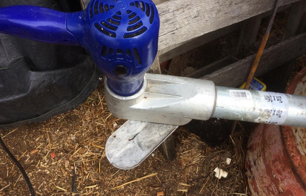

Jasent Posted July 8, 2017 Share Posted July 8, 2017 Simple air gate I use Quote Link to comment Share on other sites More sharing options...
rockstar.esq Posted August 1, 2017 Share Posted August 1, 2017 FYI that's an electrical conduit body, they are properly called a 2" LB. Quote Link to comment Share on other sites More sharing options...
Charles R. Stevens Posted August 1, 2017 Share Posted August 1, 2017 I leVe a gap on my wood fueled forge, a "T"and a ball valve on the mark II JABOD forge and a double acting bed pump on the mark I. You have way much air there, 10-30% clay and 70-90% sand would be just fine and way cheeaper Quote Link to comment Share on other sites More sharing options...
