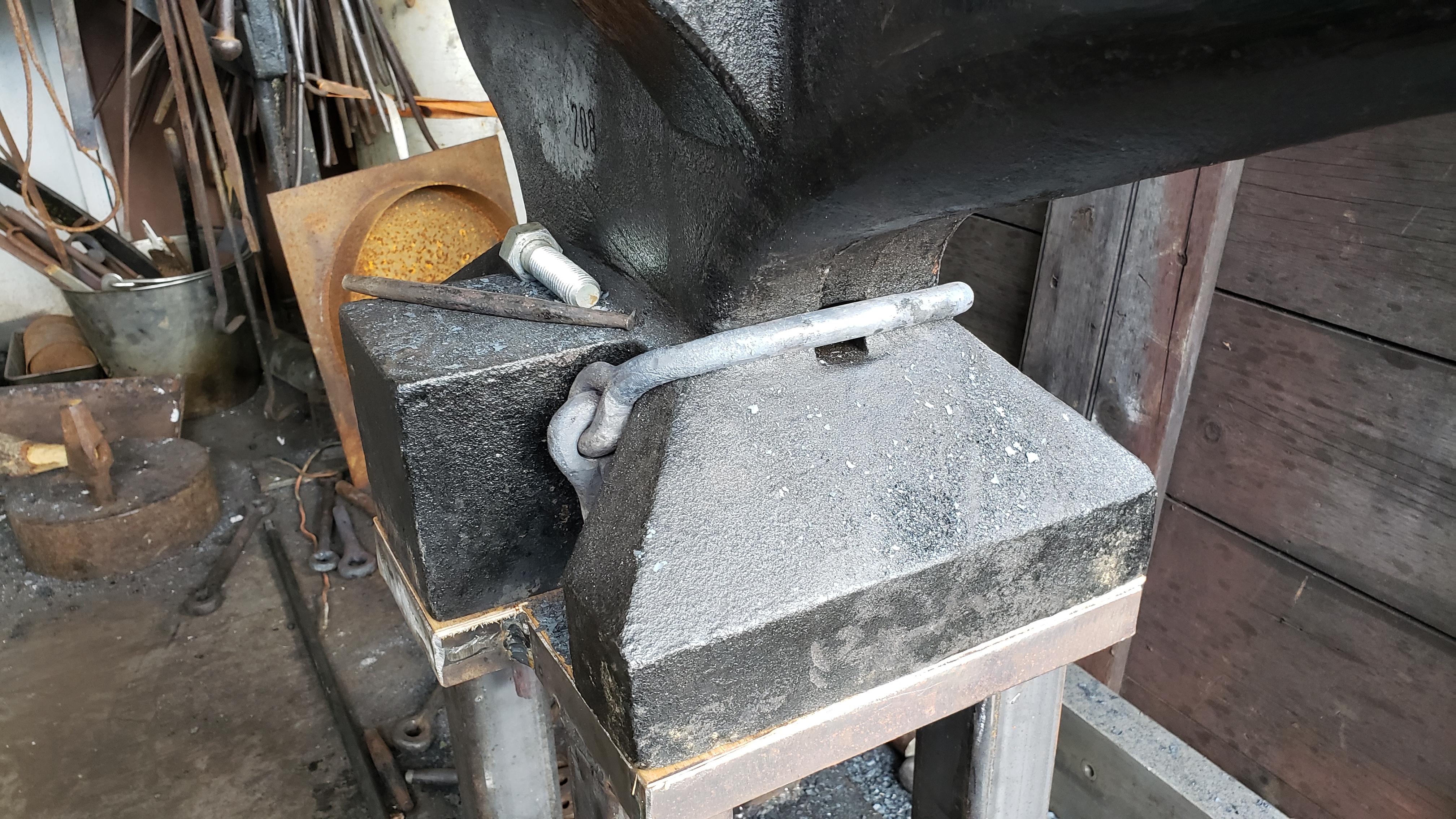

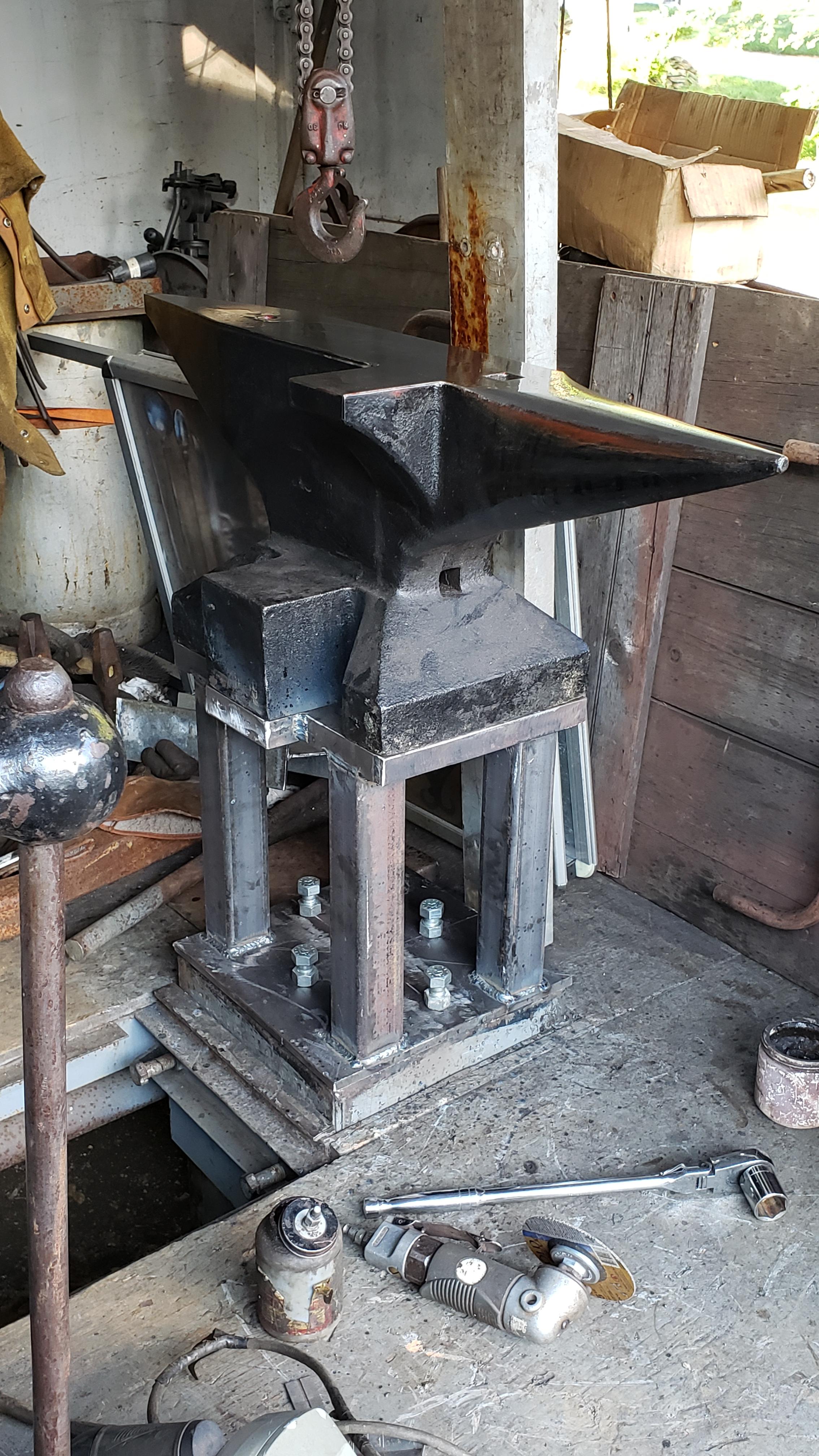

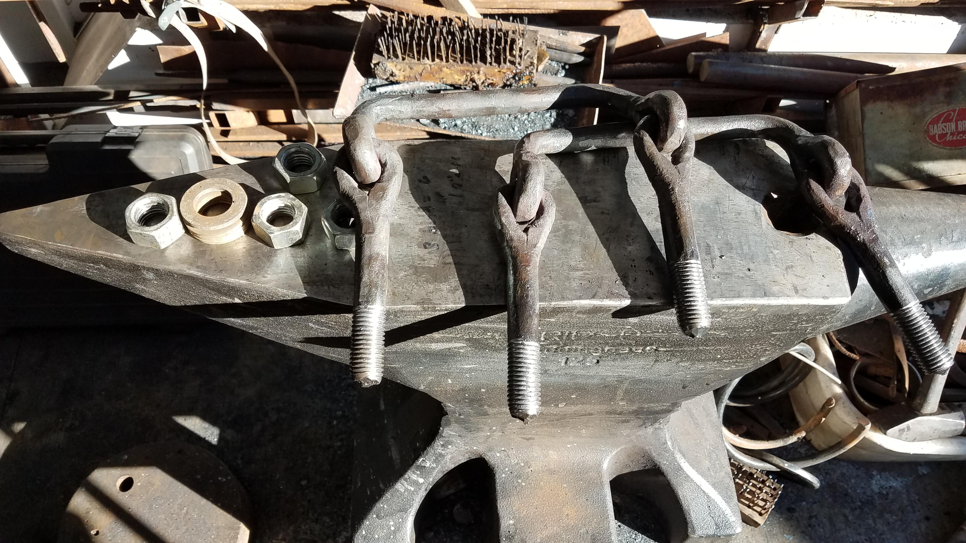

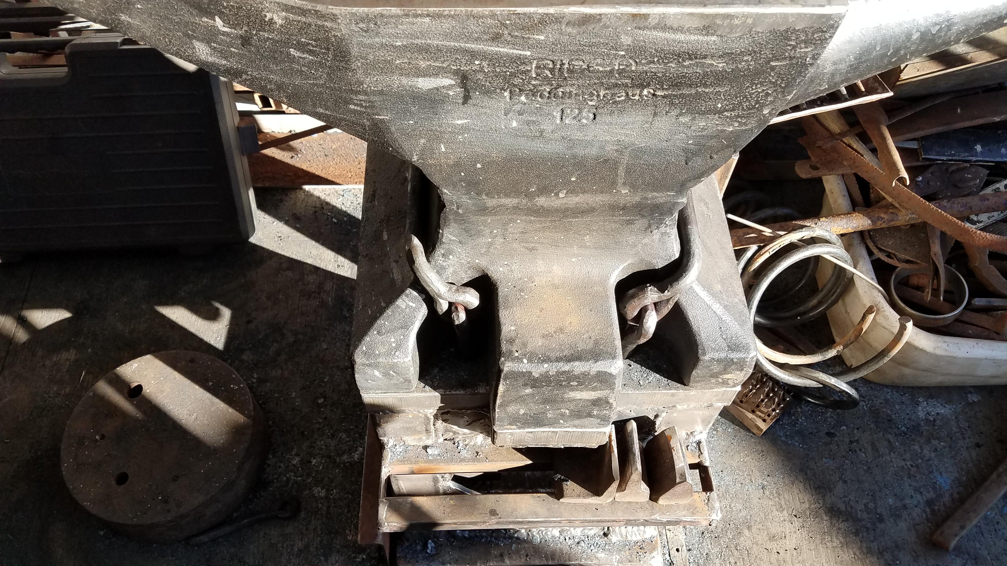

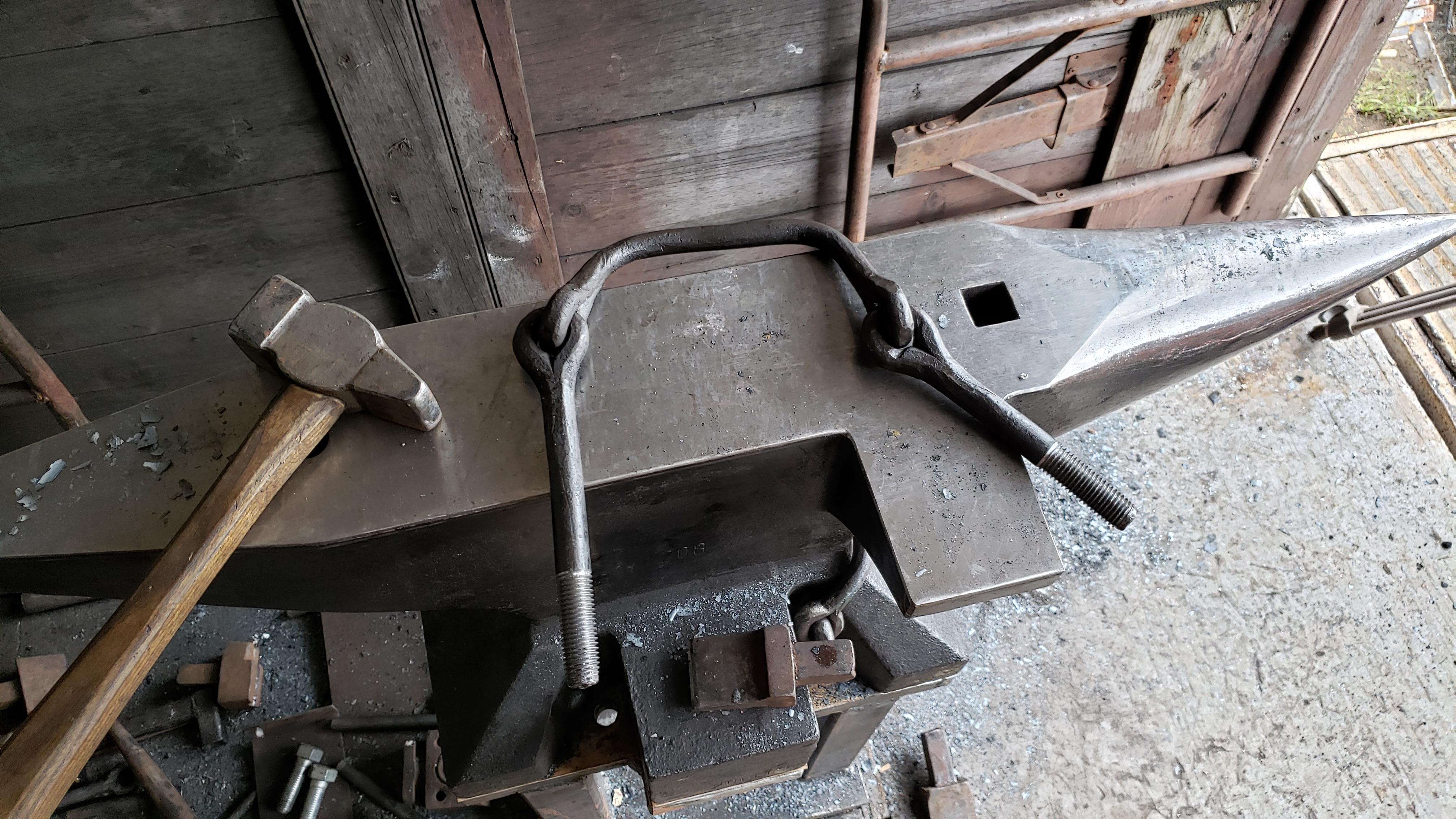

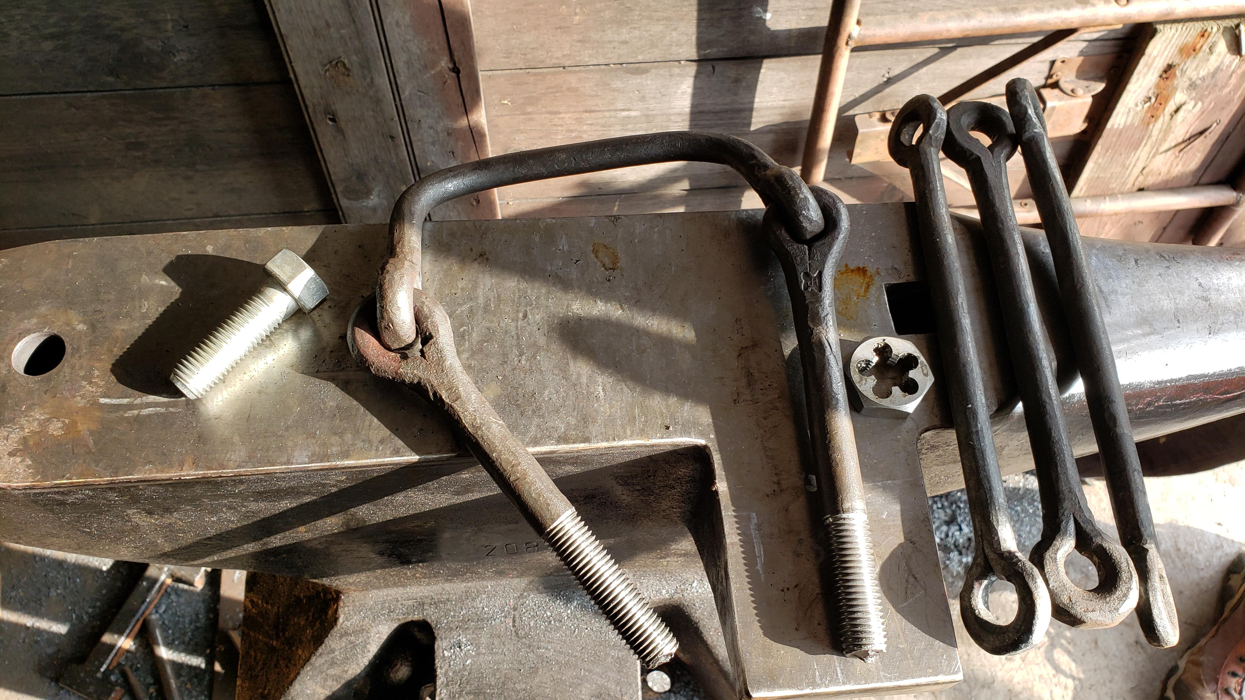

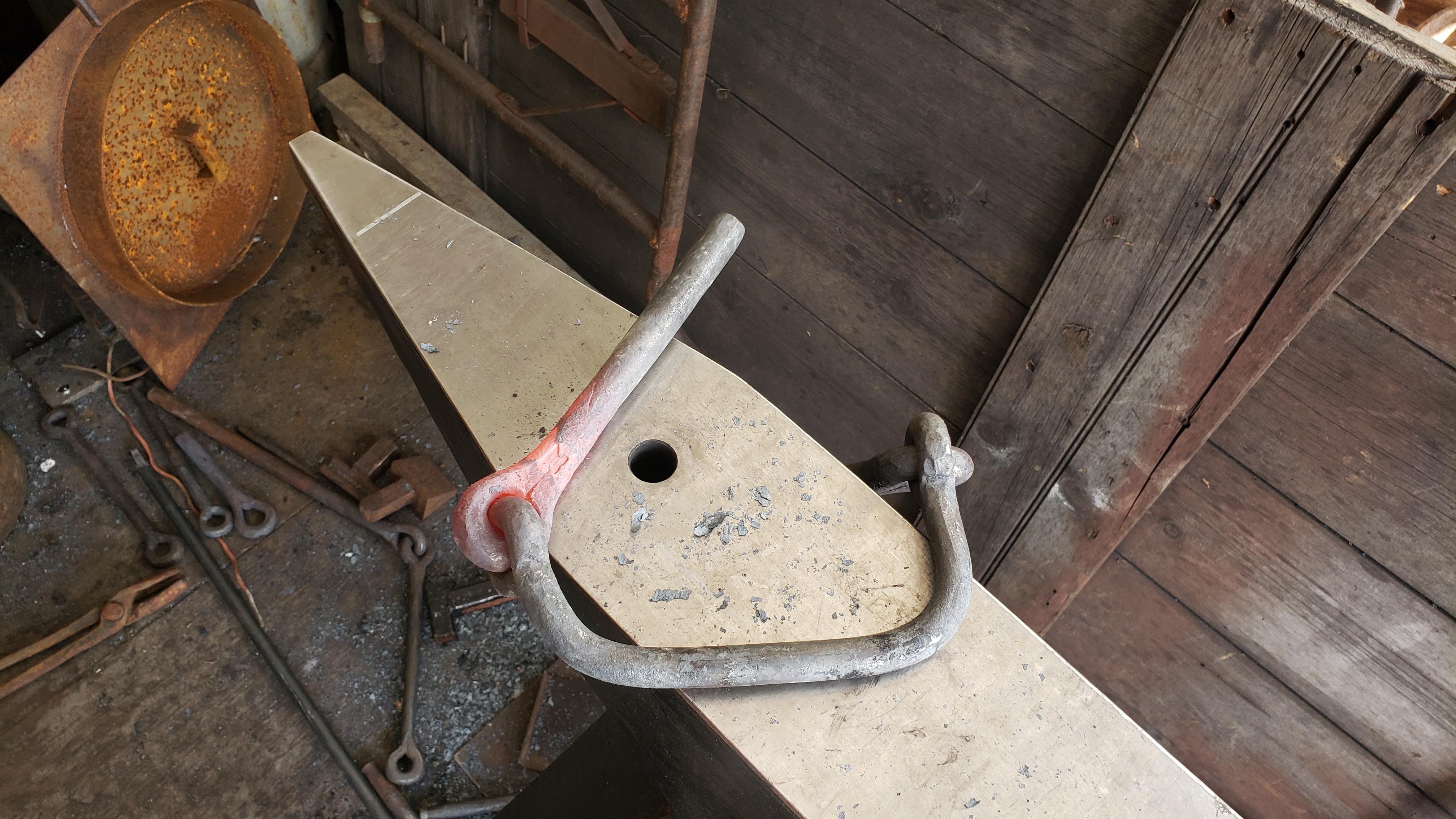

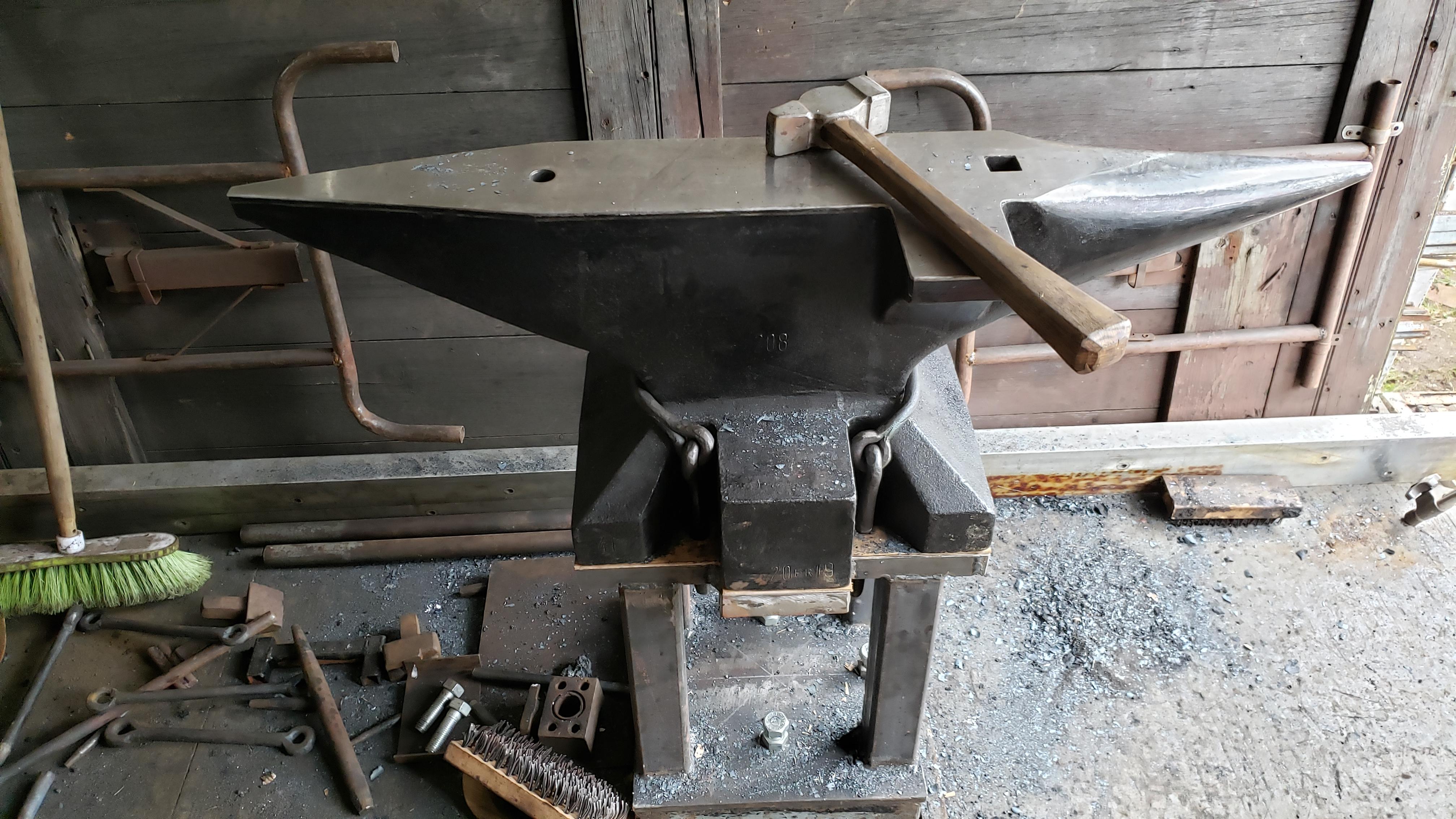

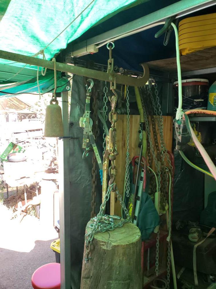

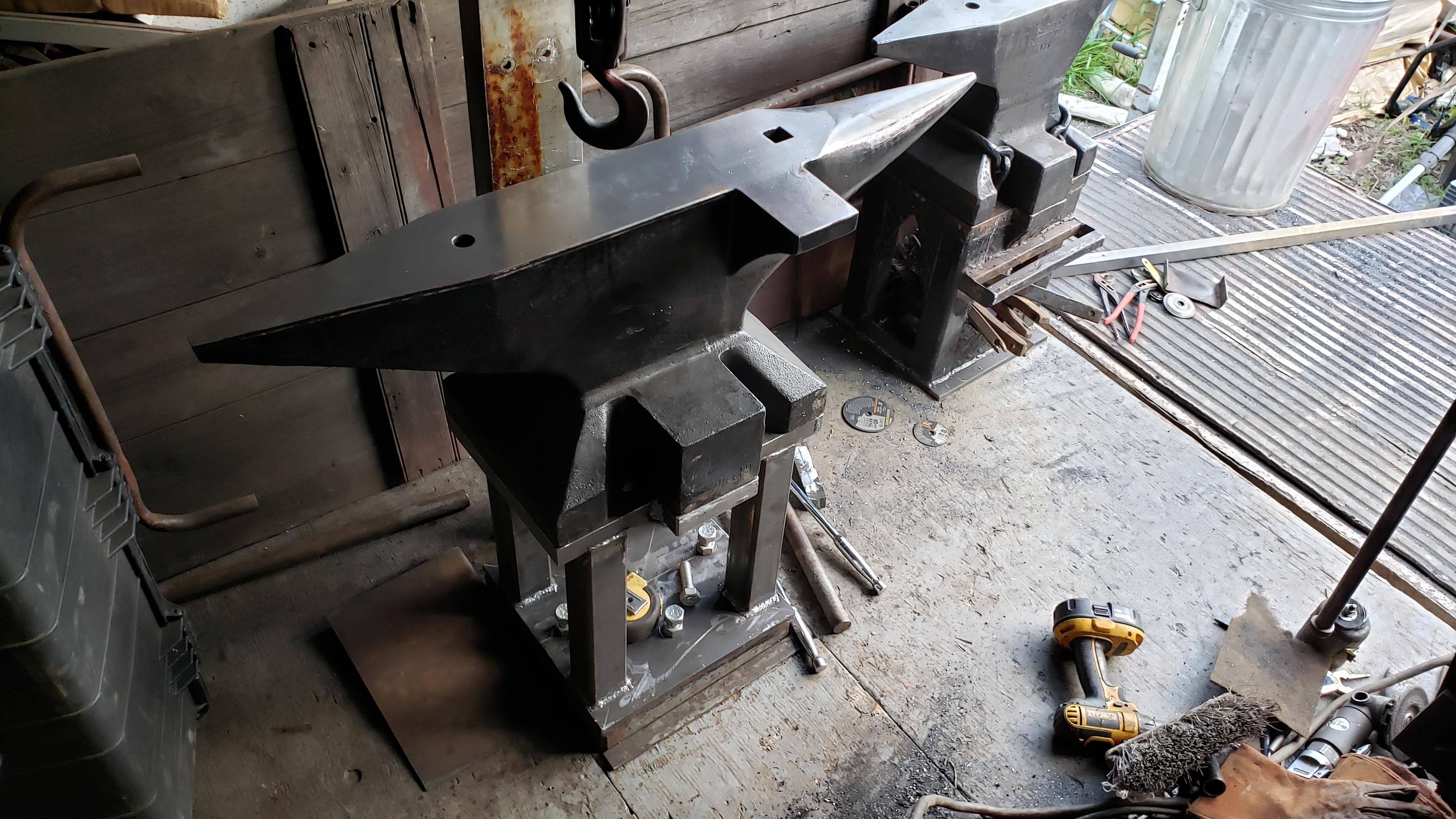

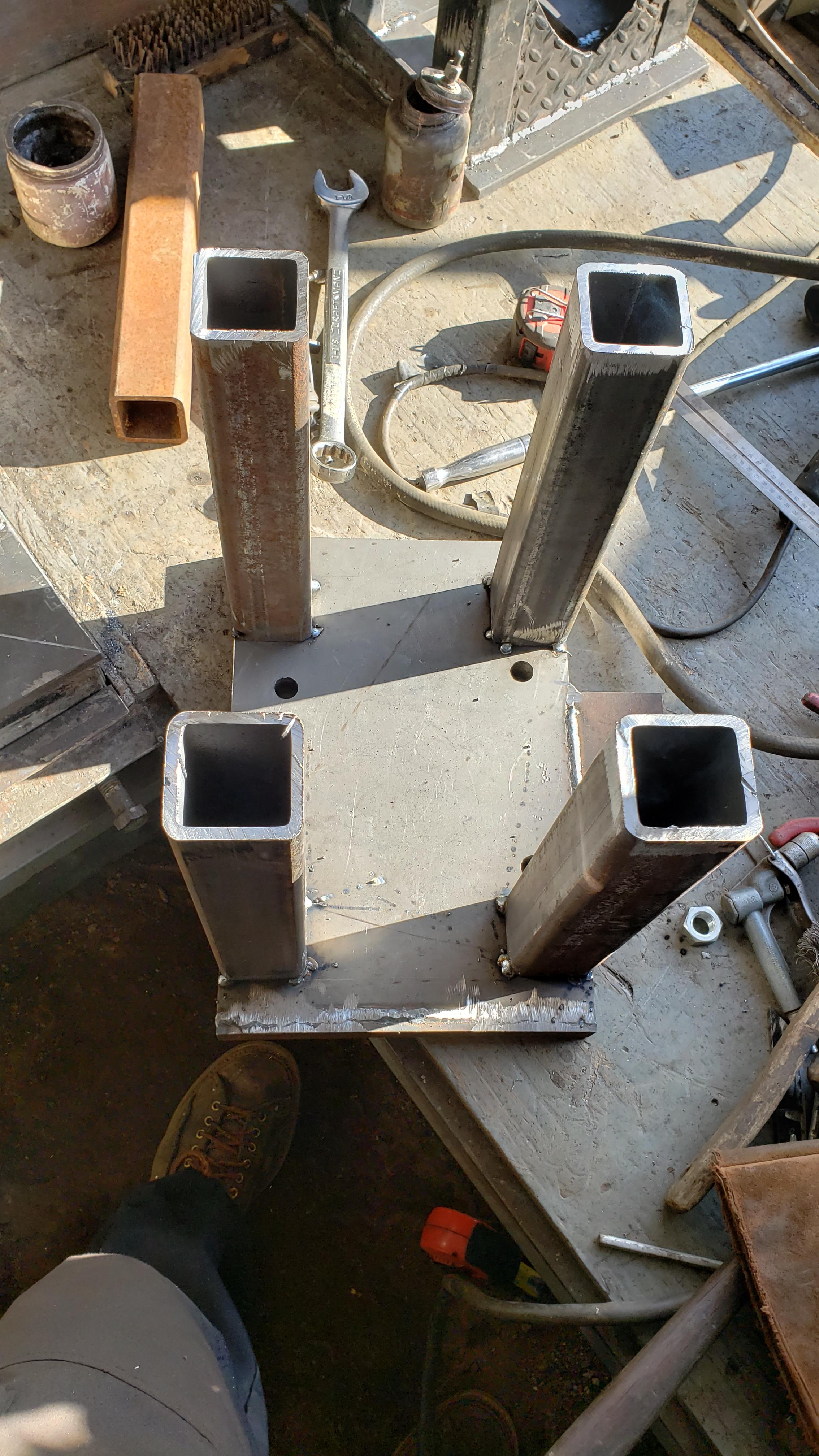

here are the methods I have used in the past.. There are other variations but the heavier ways always work the best for me.  The last picture was maybe my most brilliant.
  • Replies 1k
I agree. It conceptually , I thought was a master stroke of genius.
Lol.  It later dawned on me, the last example would offer all the same strength in a much simpler, faster way of doing it.
Photo 9  is in no way as classical or inducing that "say what " vs number3 but..  ;)
Yes, but Number 9 satisfies all necessary application criteria in its elegance.....
There is a Stand Pipe (water tower) still standing in San Diego, I will dig up those images. when you see them, you will understand my what I finnd so appealing about Number 3...!

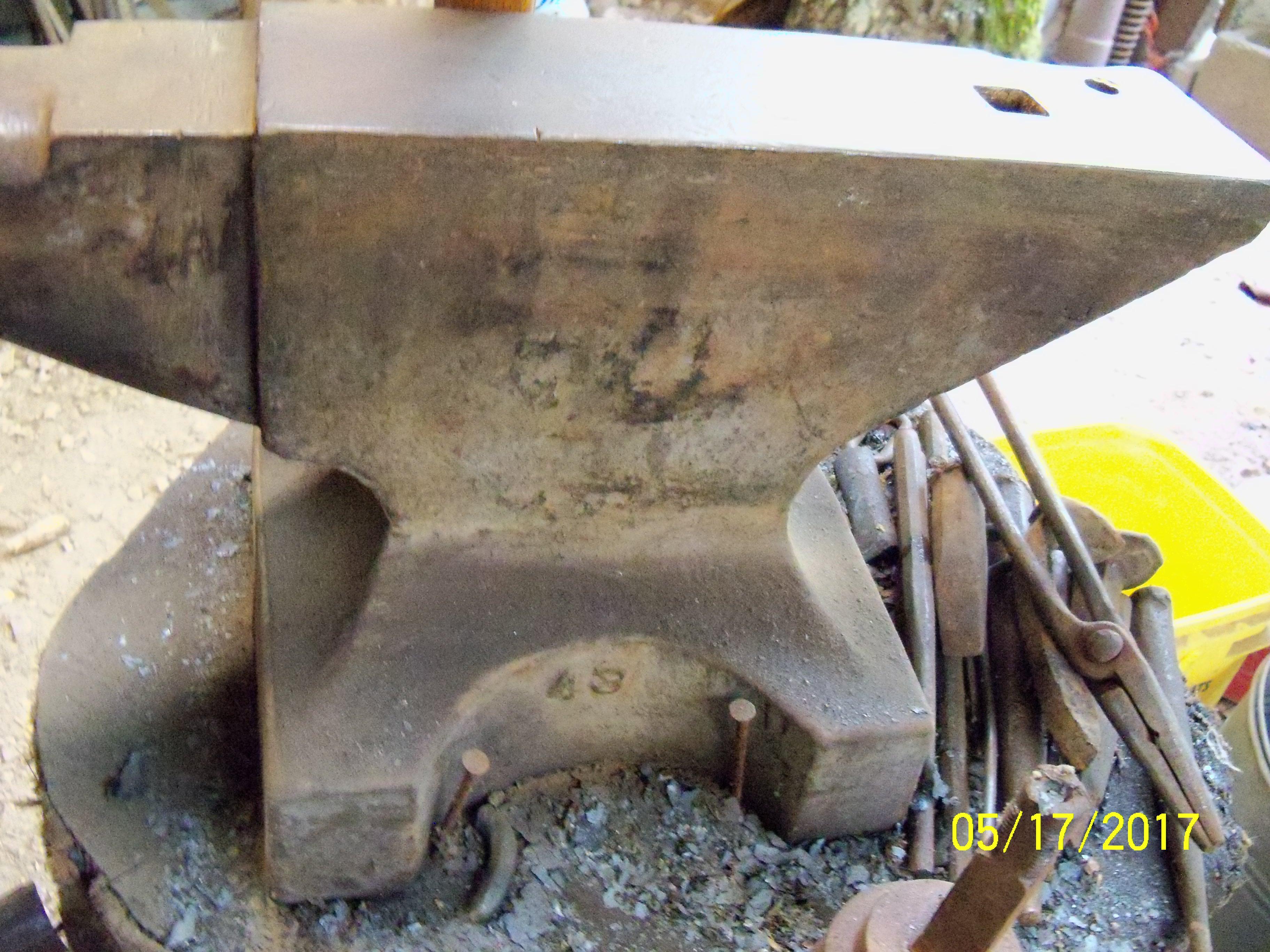

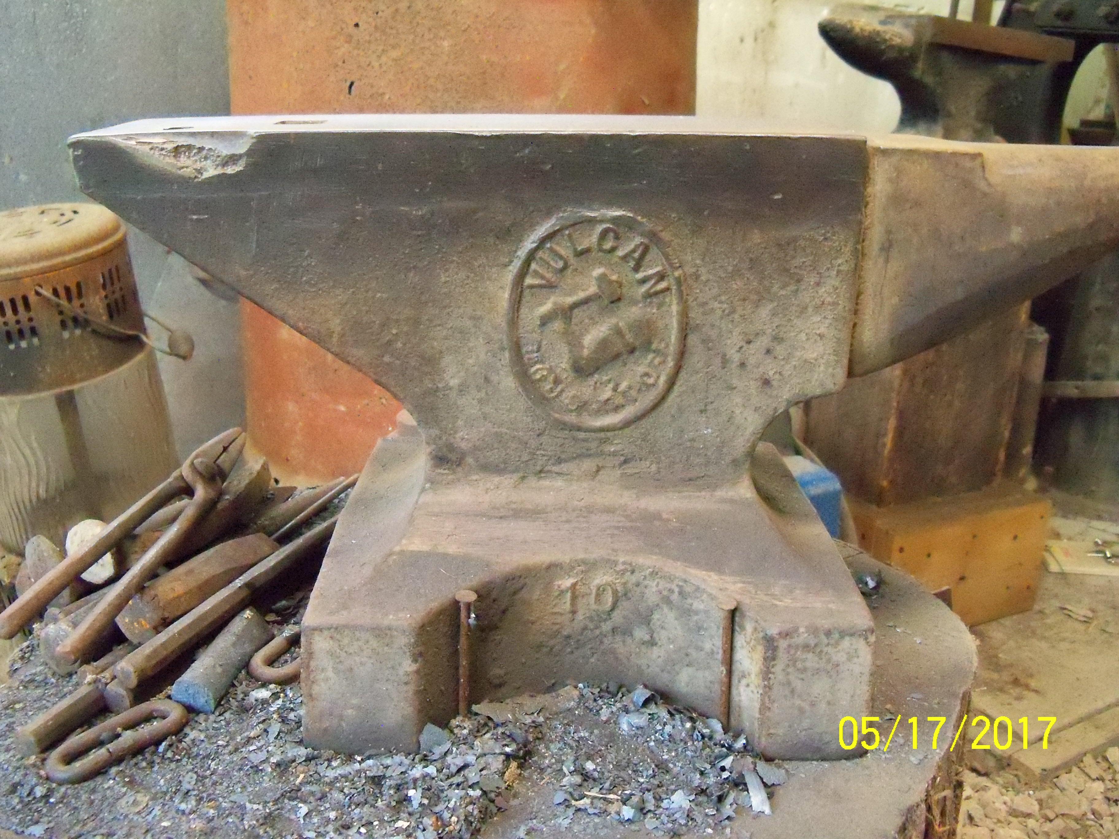

I have a 1943 # 10 Vulcan 110 pounds that I use a lot and really like it and it's been in use since the early 80s in our shop even though we have 3 other anvils it's still my favorite. The other side is marked 43 for the year, a year younger than I.:)

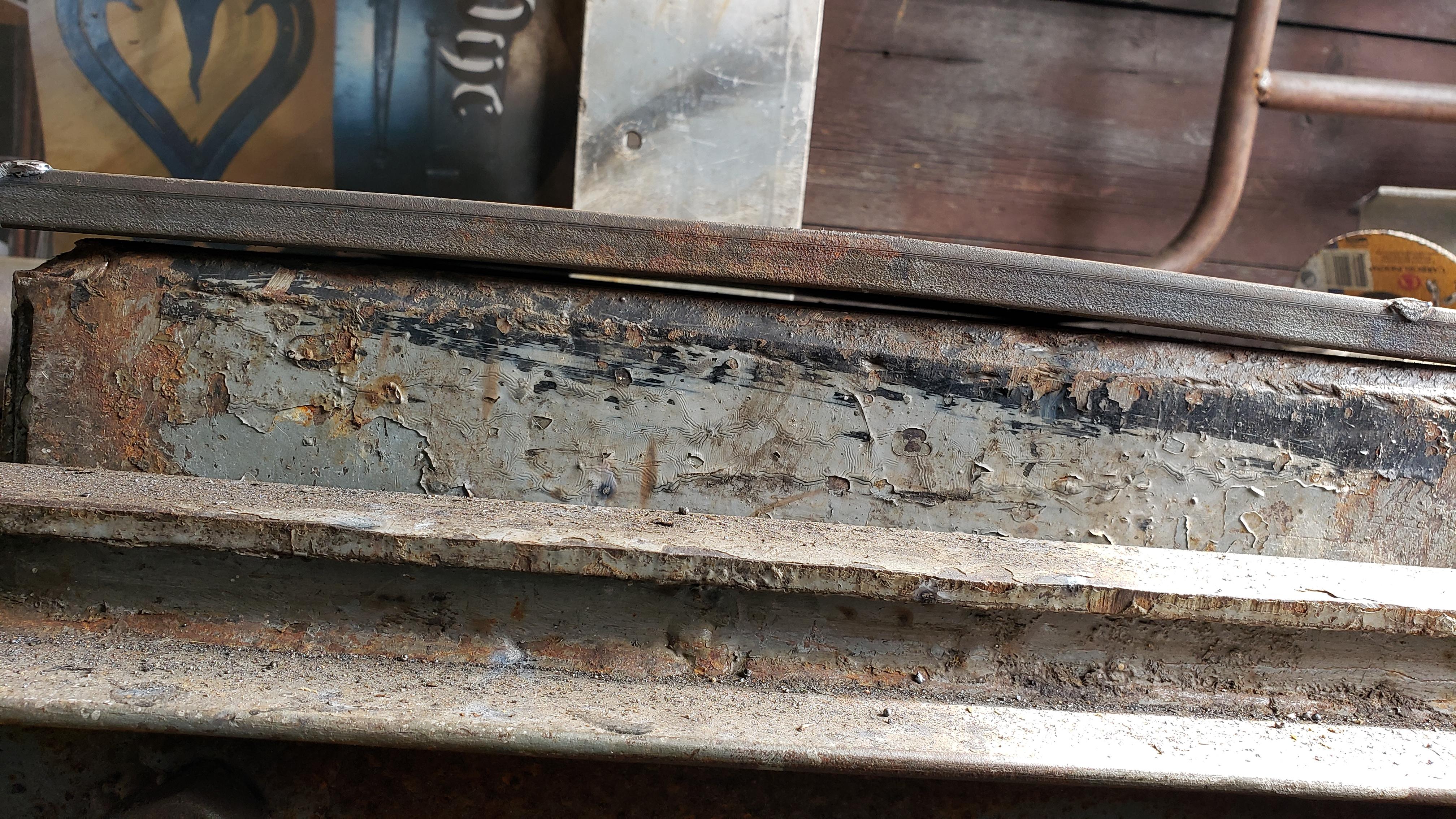

I thought it had a thick plate until someone  pointed out, although the plate looks thick it really isn't, just the way Vulcan welded the plates on. You can see here after I did an etch to remove the rust/patina where a miss strike chipped it the actual hardened plate is rather thin. You can see the line below the chip that I was told it was a thick plate but the hardened plate is the smooth area above the cast iron break. Still a good anvil in my opinion because it is so quiet.
BTW Welcome to IFI...
As you can see my Vulcan has been happy all those years on it's oak stump.

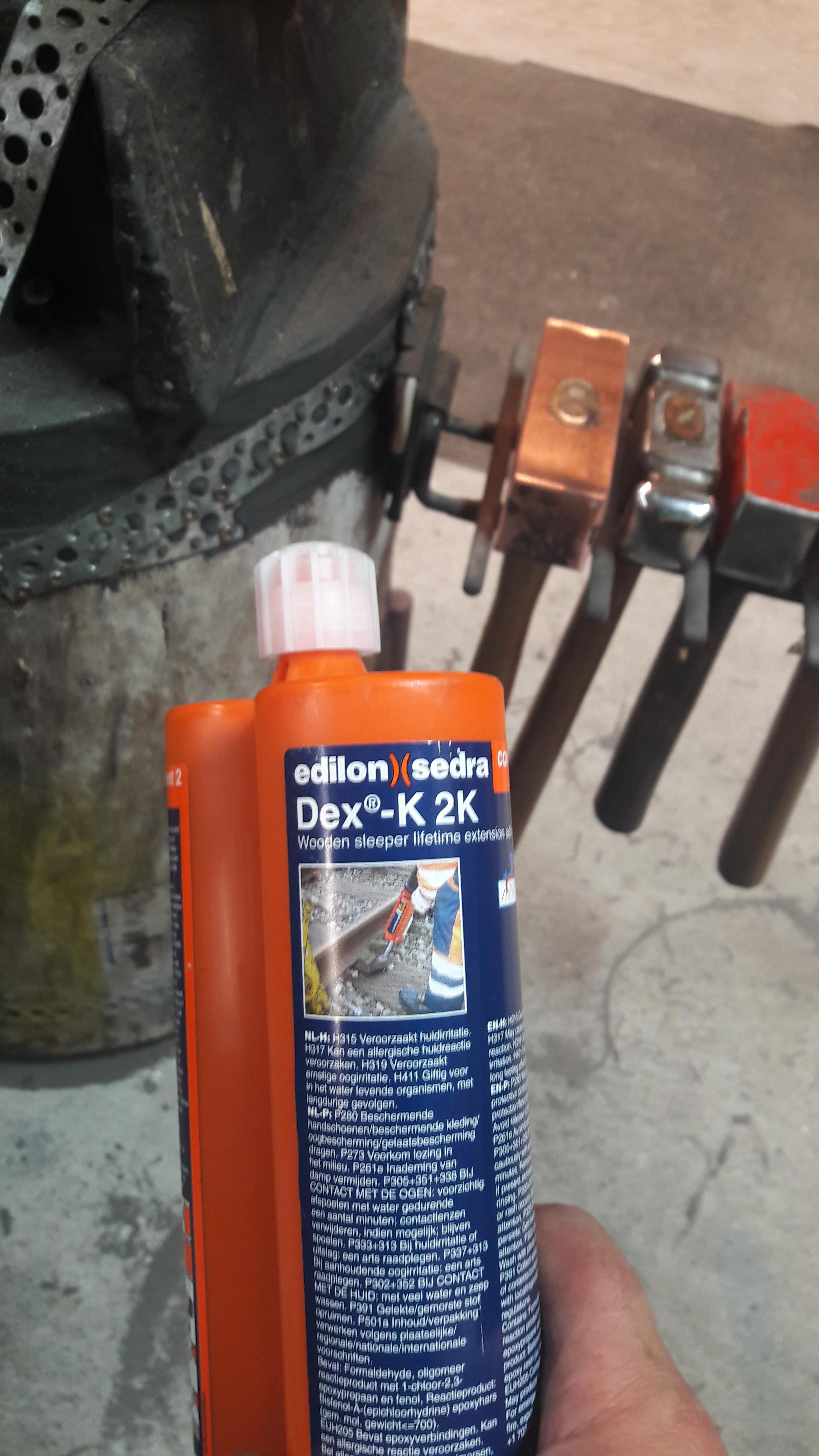

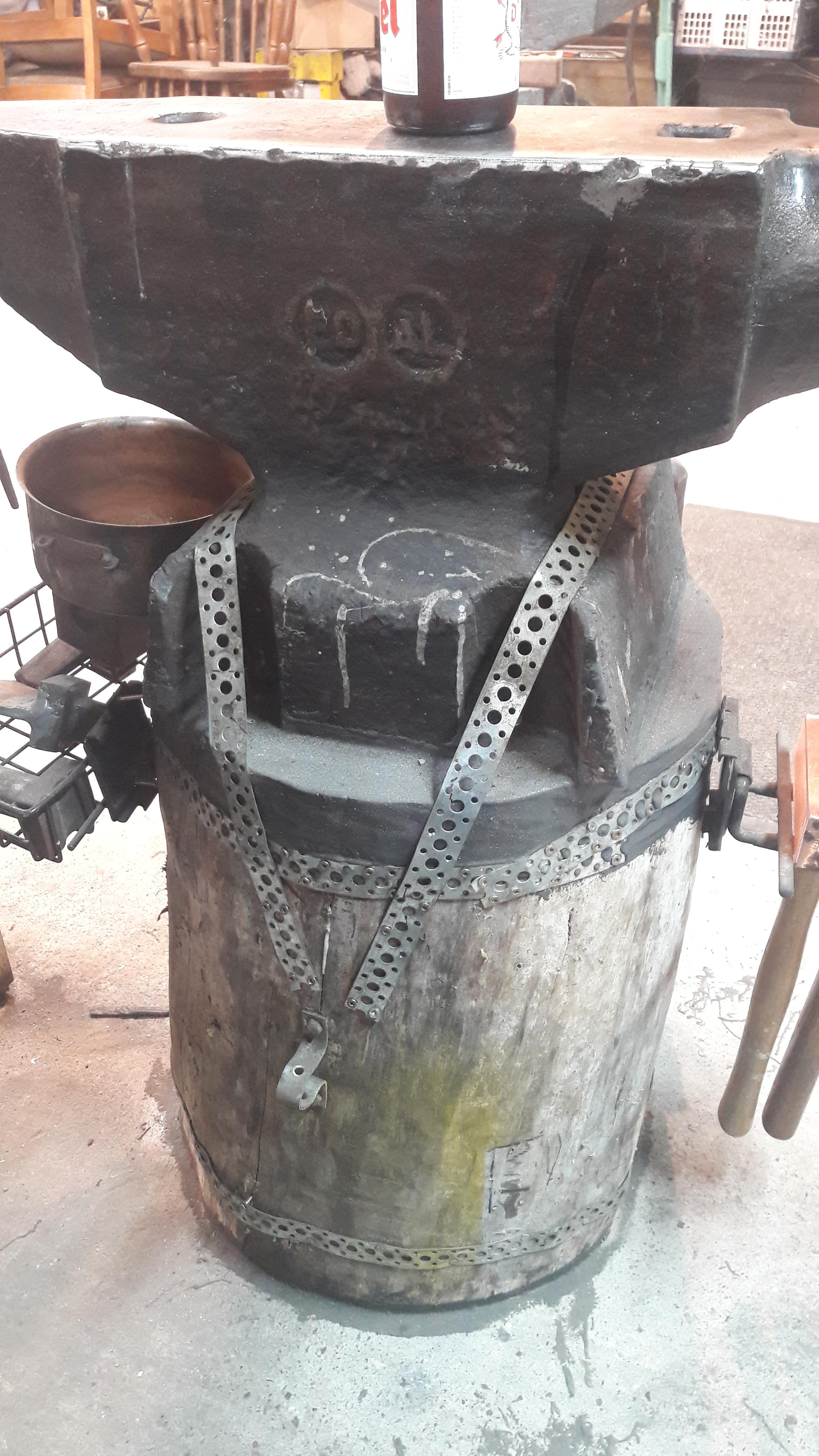

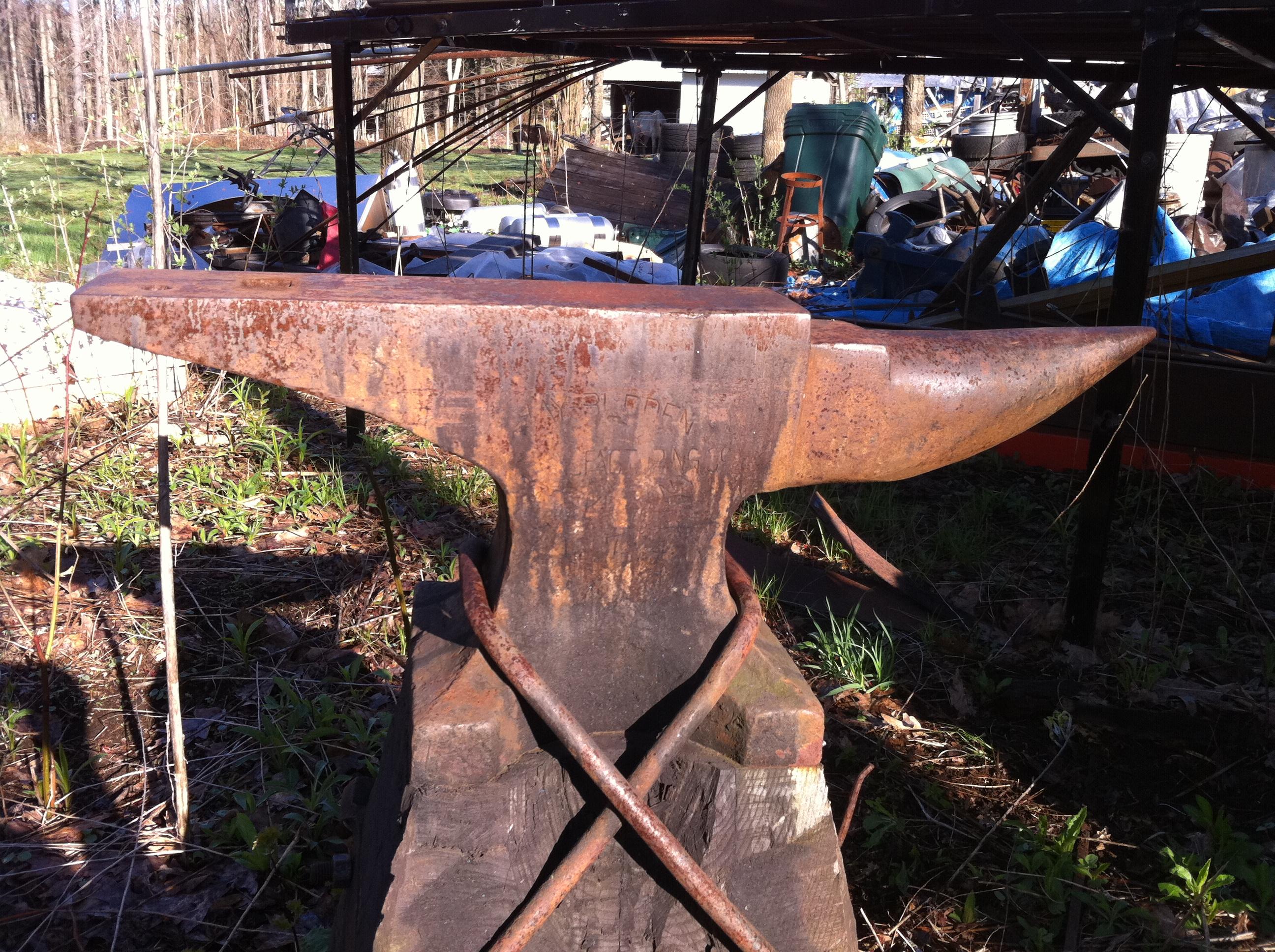

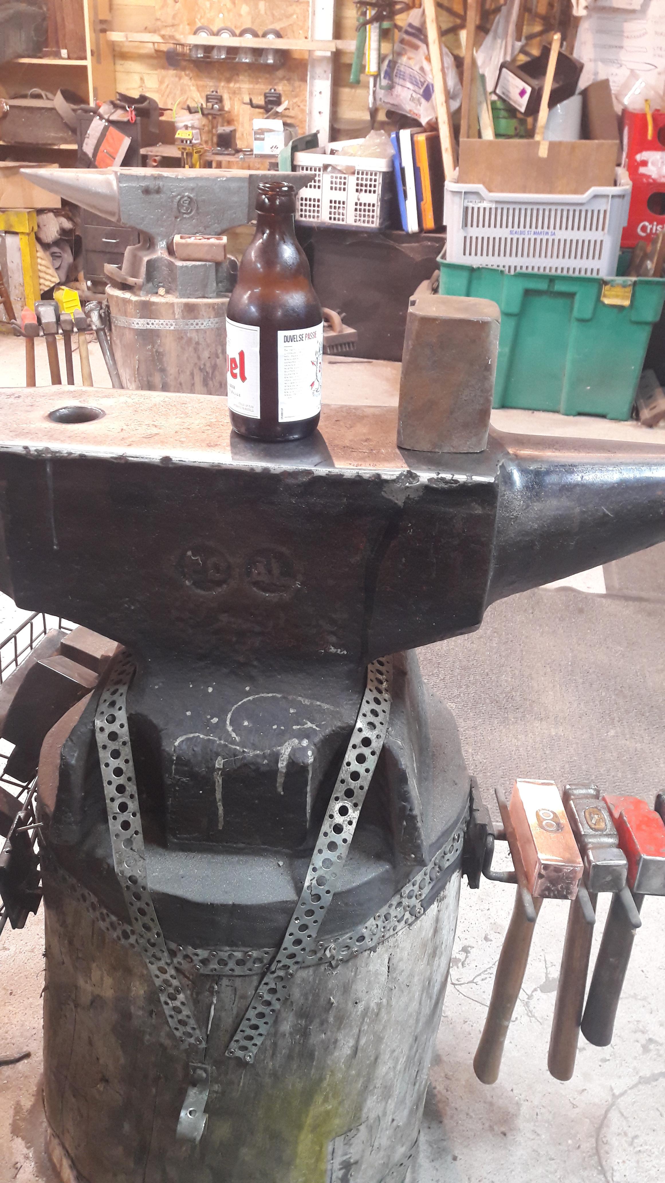

Here's my new stand. I complained the glue wasn't really heat-resistant (the hot scales tend to give the previous one a epoxy-resin smell); they told me to mix some fine white sand in the glue; and when curing; spray it with ashes. And so I did. The block of wood is 20 year old dry larix (hard woord). The block is glued to the floor; and the anvil is glued to the block. the straps are for security (the other one doesn't have straps) and preventing splitting. This anvil is a solid one piece really tool steel, and it used to be a real ear-buster; with the absolute immobility towards the ground; it has become very dead; even in the horns. You do feel it in your feet when you are whaling away at it with a sledgehammer; probably the concrete below transferring the shock. I added a pic of the glue itself (check the actual use-case of that stuff :D ). and I added a picture of my upsetting block; which is mostly in use because of it's nice square corners.
The beer is optional :D

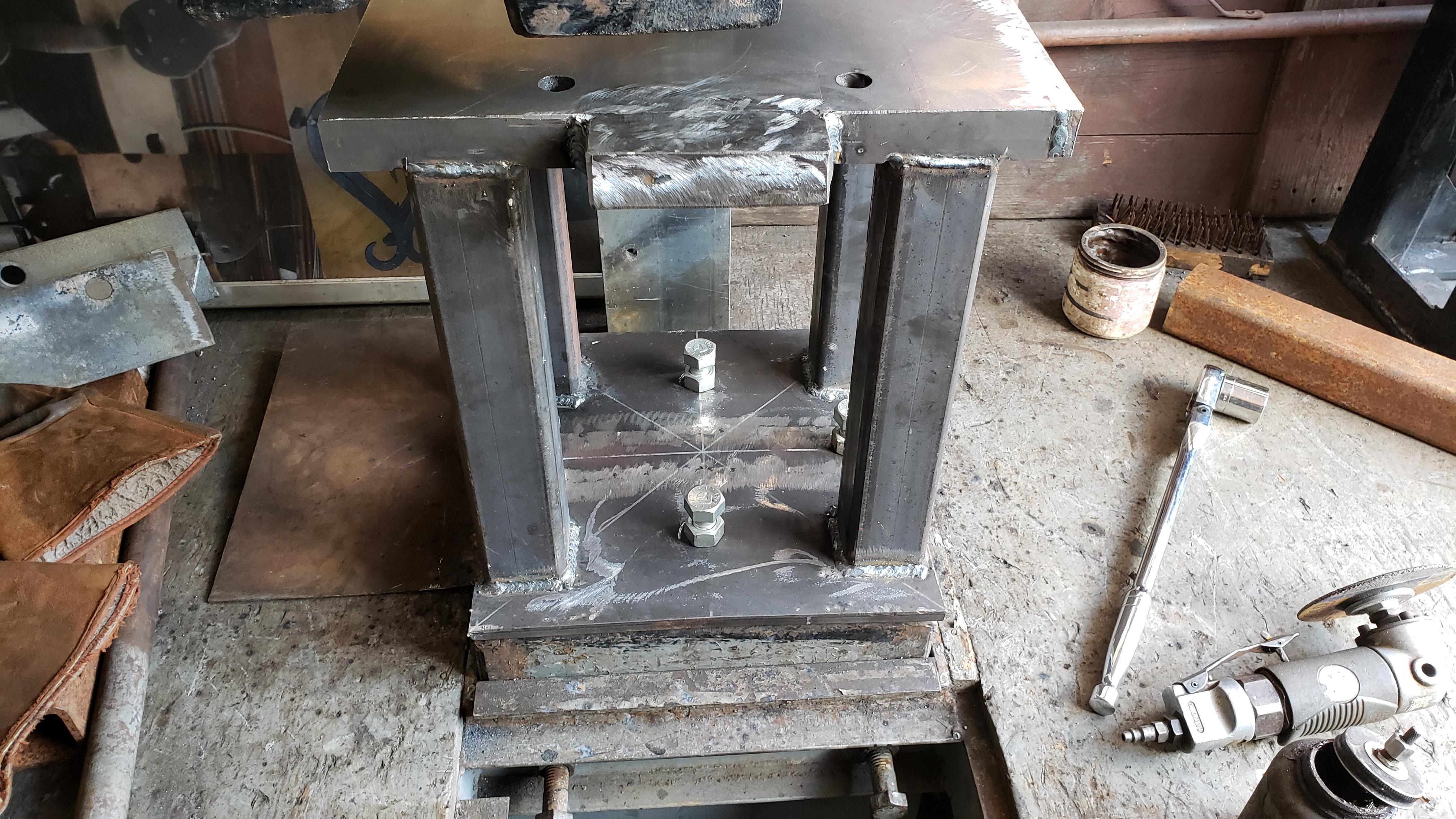

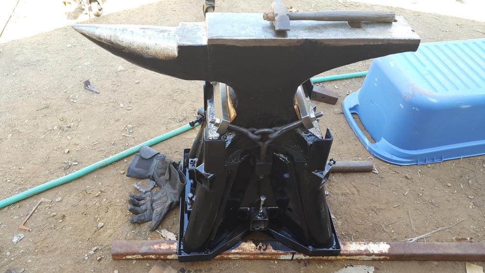

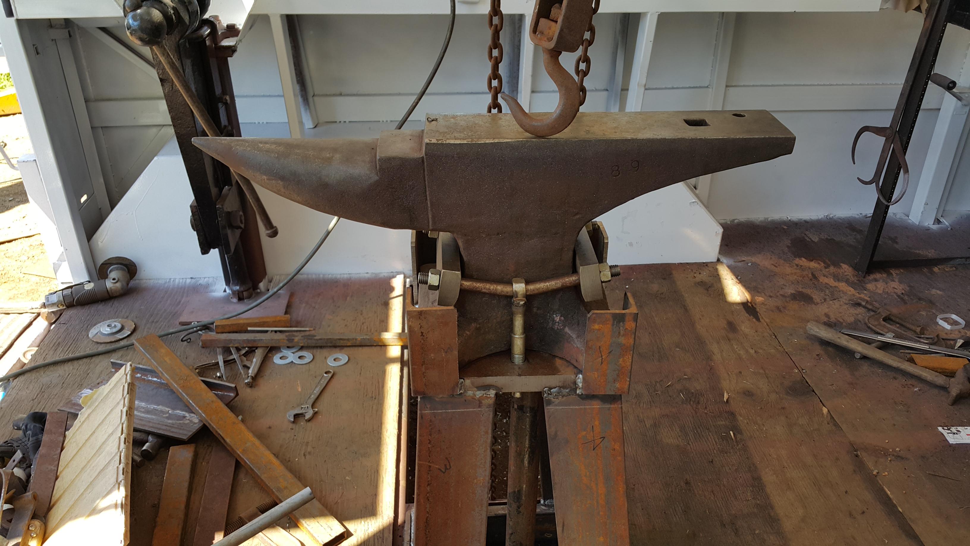

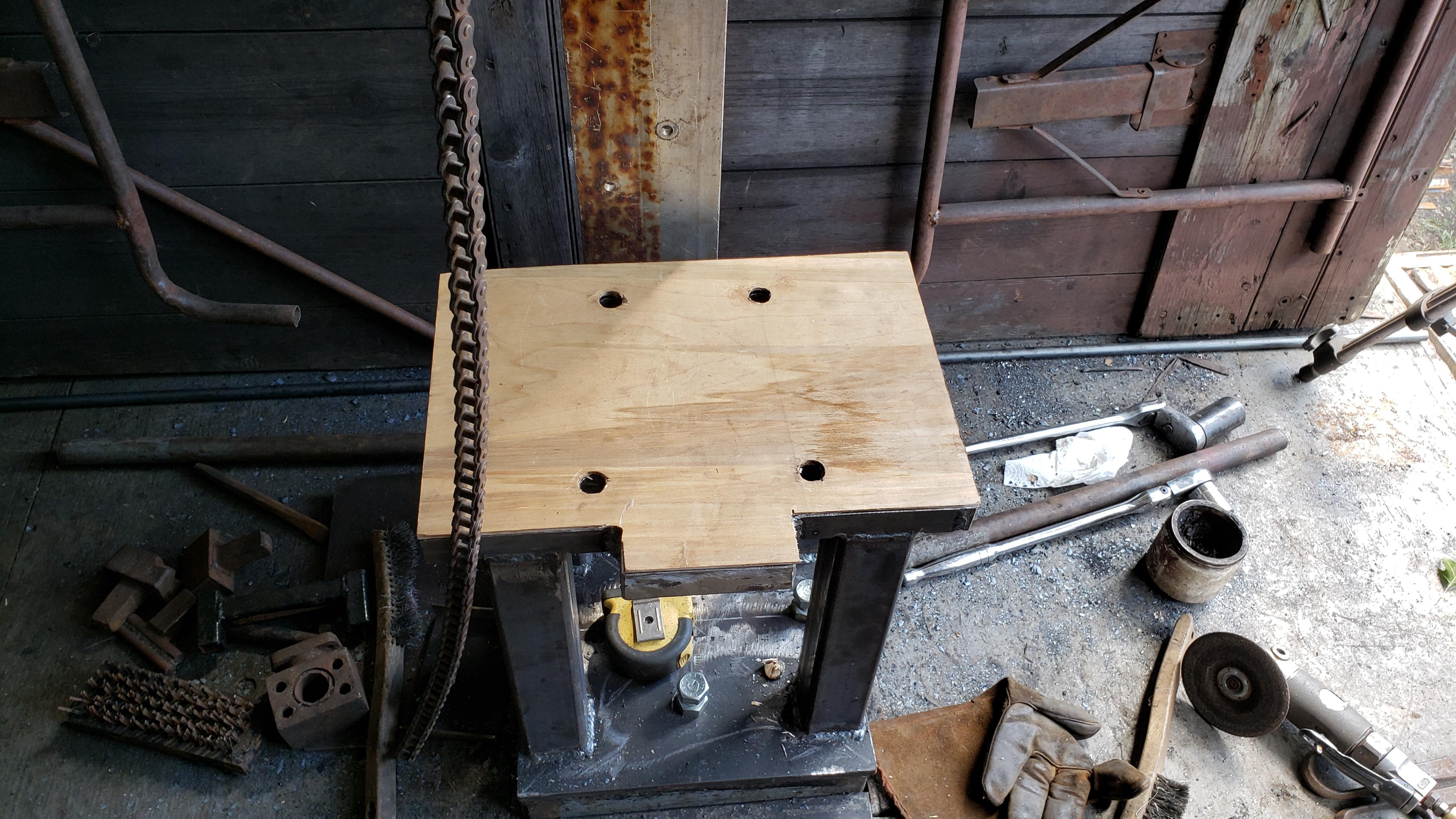

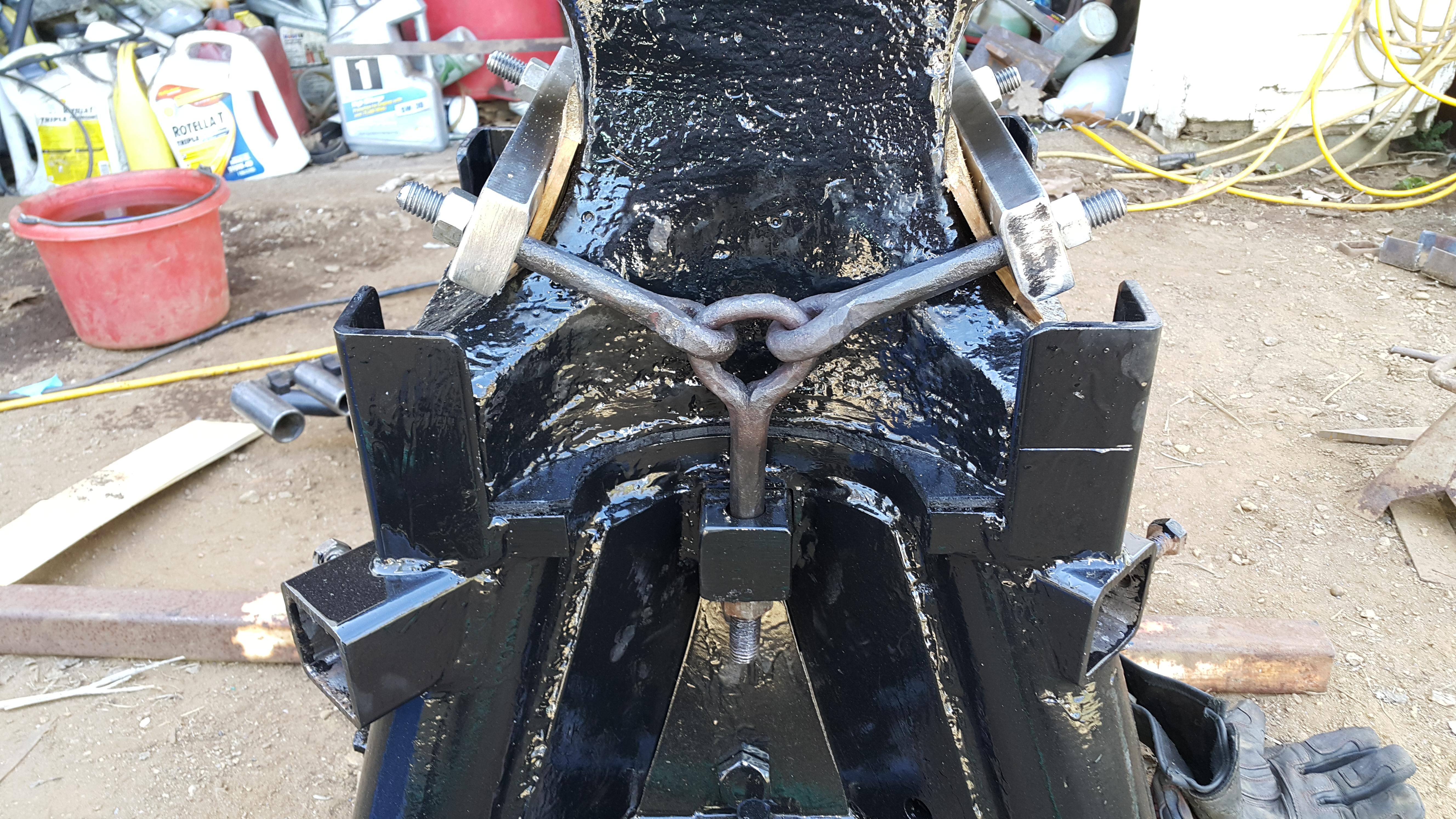

My idea is a steel frame, 1/4 inch thick material, welded together with a base. Capped with a removable 1/4 inch plate/box, the anvil "footprint" cut-out in the plate should captivate the anvil. The anvil will contact the wood, with hold-downs threaded into the cap plate. The hold-downs should pull the anvil into the wood and steel frame.
